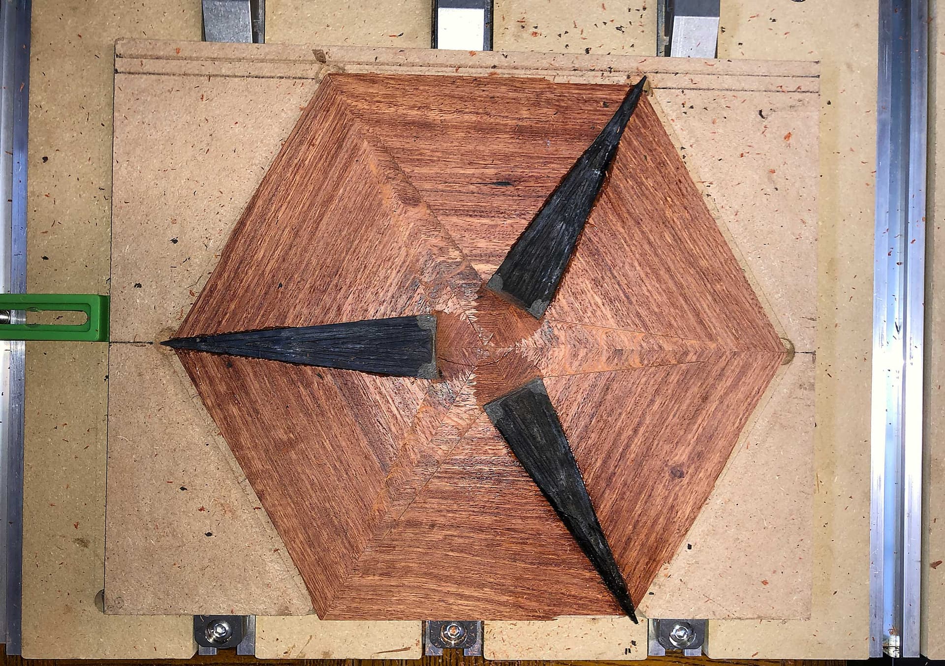

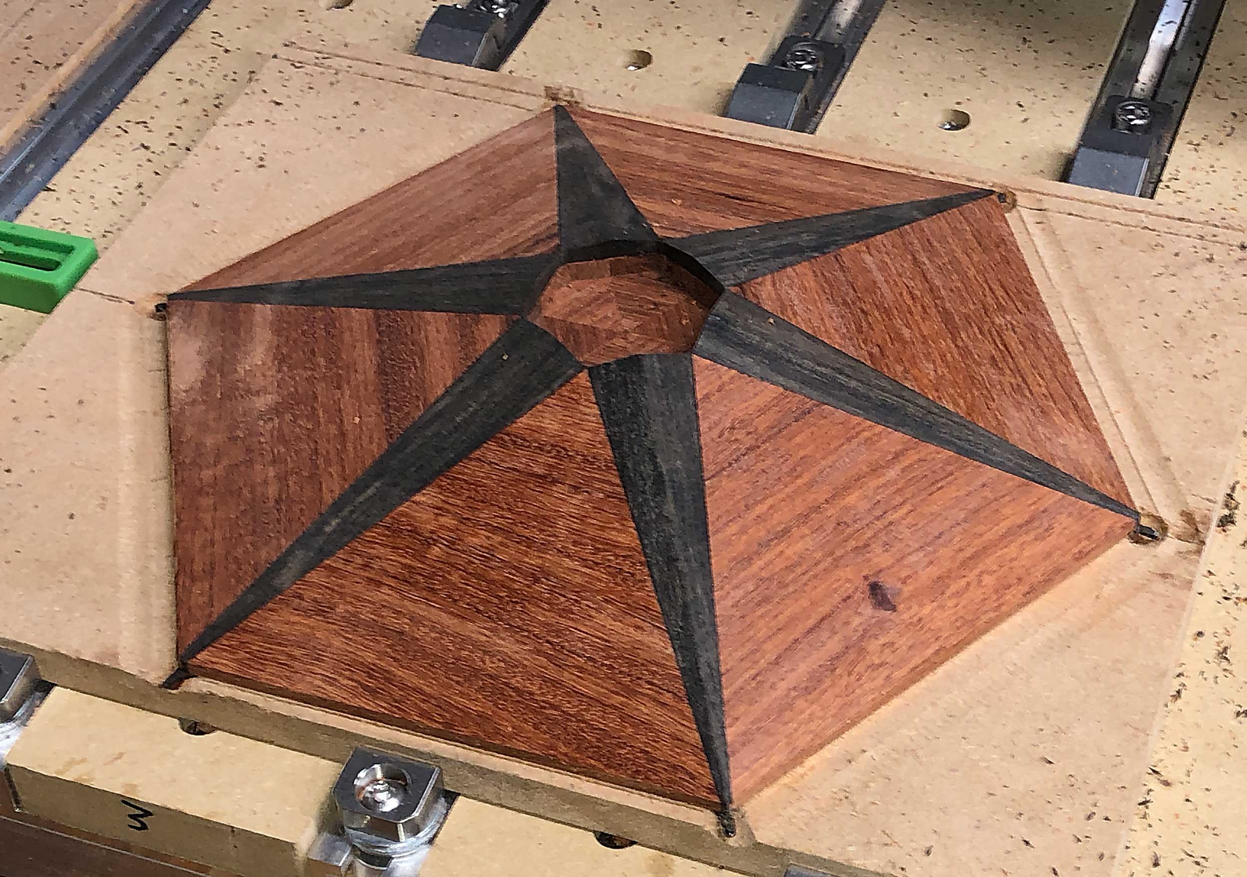

And, I cut another topper. Here’s with the first 3 wedges glued in and second set of pockets cut:
Close up of the previous problem area:
Looks scary, but it’s all good. Essentially, the second set of pocket cuts goes down to the previous adaptive clearing, so no harm done.
And here’s after the second set of wedges glued in:
And the close-up:

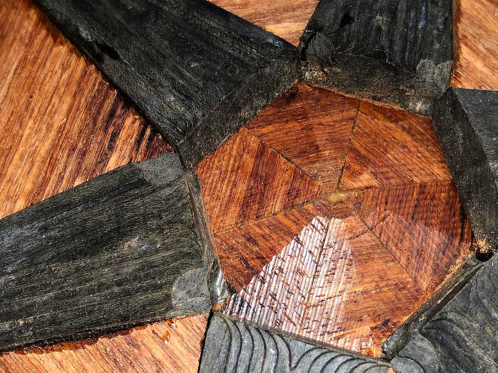

And, here’s with a rough pass on the outside ramp to even up the wedges:
And the close-up of the center:

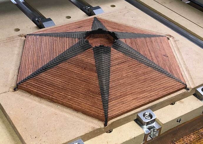

I did change the finish pass with the big core box bit to be spiral. Here’s what it looks like most of the way done:
For some reason, once it can no longer touch the model all the way around, it lifts the bit after doing a couple/few passes at each corner to get to the next corner. This is probably from the “do all depths” at the same time combined with some logic about always raising the bit when moving and not cutting. It’s non-optimal, but heck.

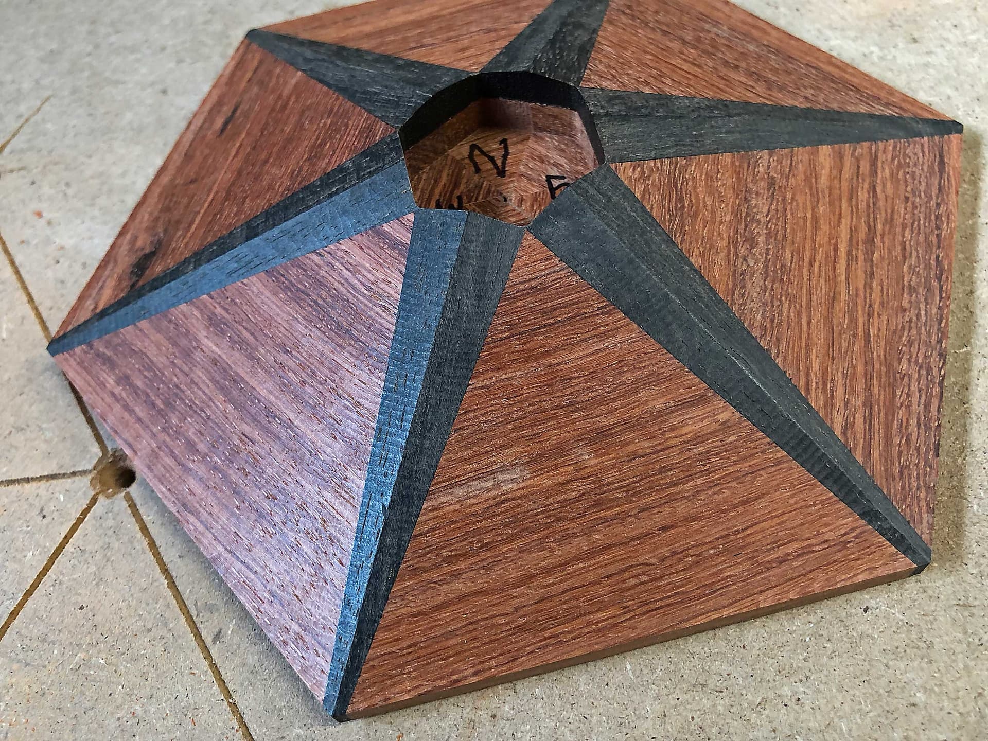

Here’s the hex after the final pass:

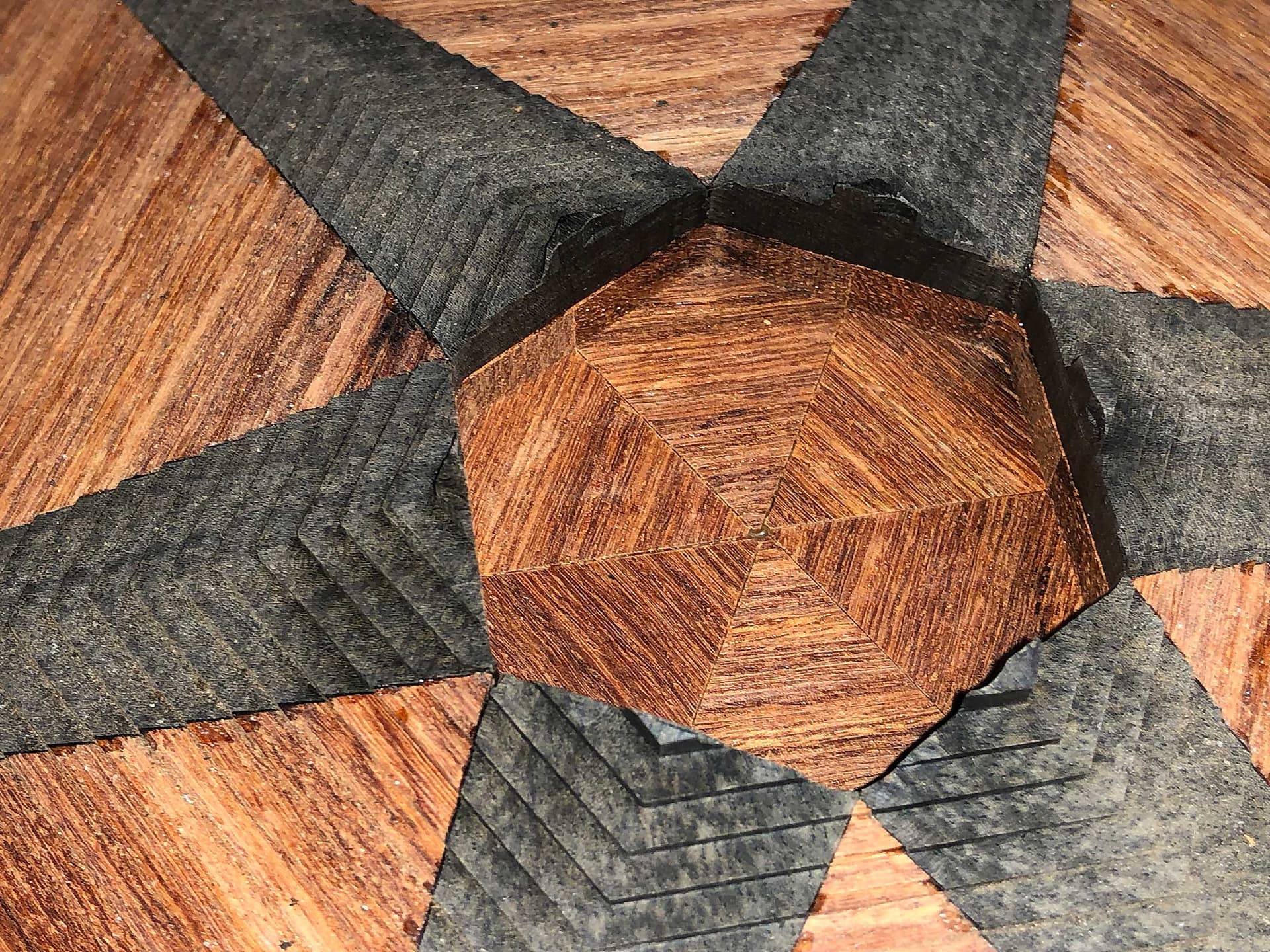

And here are a couple close-ups with different lighting so you can see the quality of the surfaces:
It’s actually pretty nice in the middle and upper portions since the cutting direction is mostly with the grain. The ebony is so tight it doesn’t really care. This surface sands smooth starting with 150 grit up through over 600 pretty quickly since all I’m doing is removing tool marks and then removing the scratches from the previous grit.

Brag and gag time:
Quite a journey to get here, but considering for my first project I took on something of this complexity, had to learn CNCing, learn Fusion360, it wasn’t too bad at all. I’m obviously really stoked how well it came out.

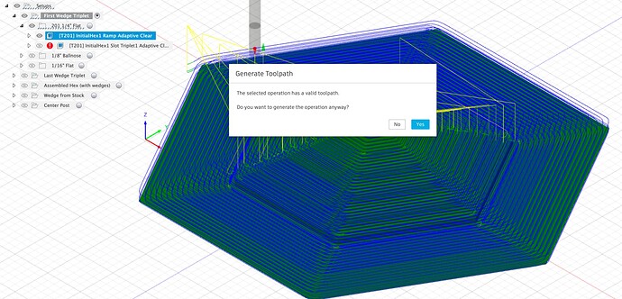

Doing the middle-sized newels now. Changed the parameters and went into Manufacture and things don’t look right:
Looks like it’s using the old stock size. So I open the Setup up and hit OK. But, I didn’t change anything, so Fusion thinks the toolpaths are all up to date:
I force the update and all appears well:
All this is more than a little bit disconcerting now. It means that some of my changes to parameters when I was working on the larger newel were not reflected in the Manufacture setups. I know that I changed the raw stock size (especially the extra radius and pre-cut angle), but apparently those would not be reflected in the new toolpaths unless I THEN went into each setup and re-OK’d it. Fusion bug?
I don’t know if it’s a bug or just a really bad bit of UX, when I’ve made changes, especially to user parameters I go back to manufacture, right click on the setup and select “Generate” and then say “Yes” to the dialog asking if I really want to regenerate all of them.
My recollection (which I can verify if you want) was that just generating the toolpaths wasn’t enough. I had to go and resave the Setup first.
You mean after changing the stock size?
I’ve just done that in the model I’m machining and my toolpaths updated, including things like adaptive clear which is stock size driven.
If you can produce a repeatable error then it’s worth going and posting it on the Fusion 360 forums so they can fix the bug.

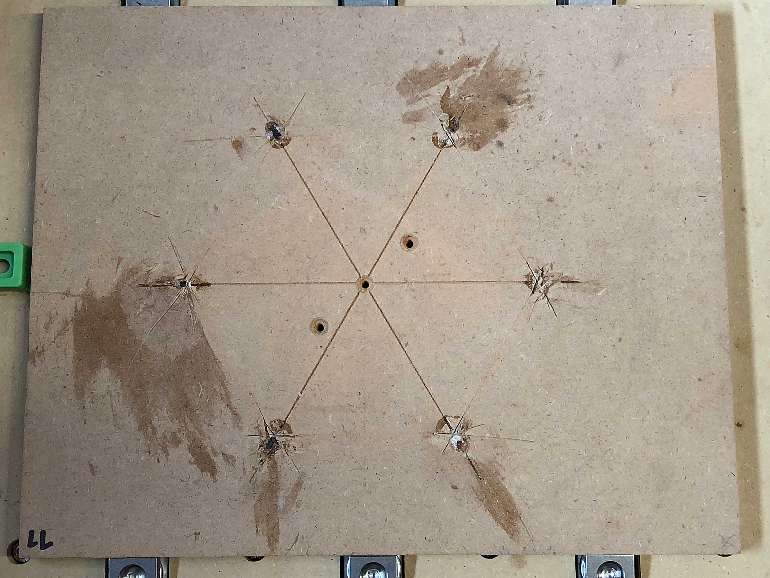

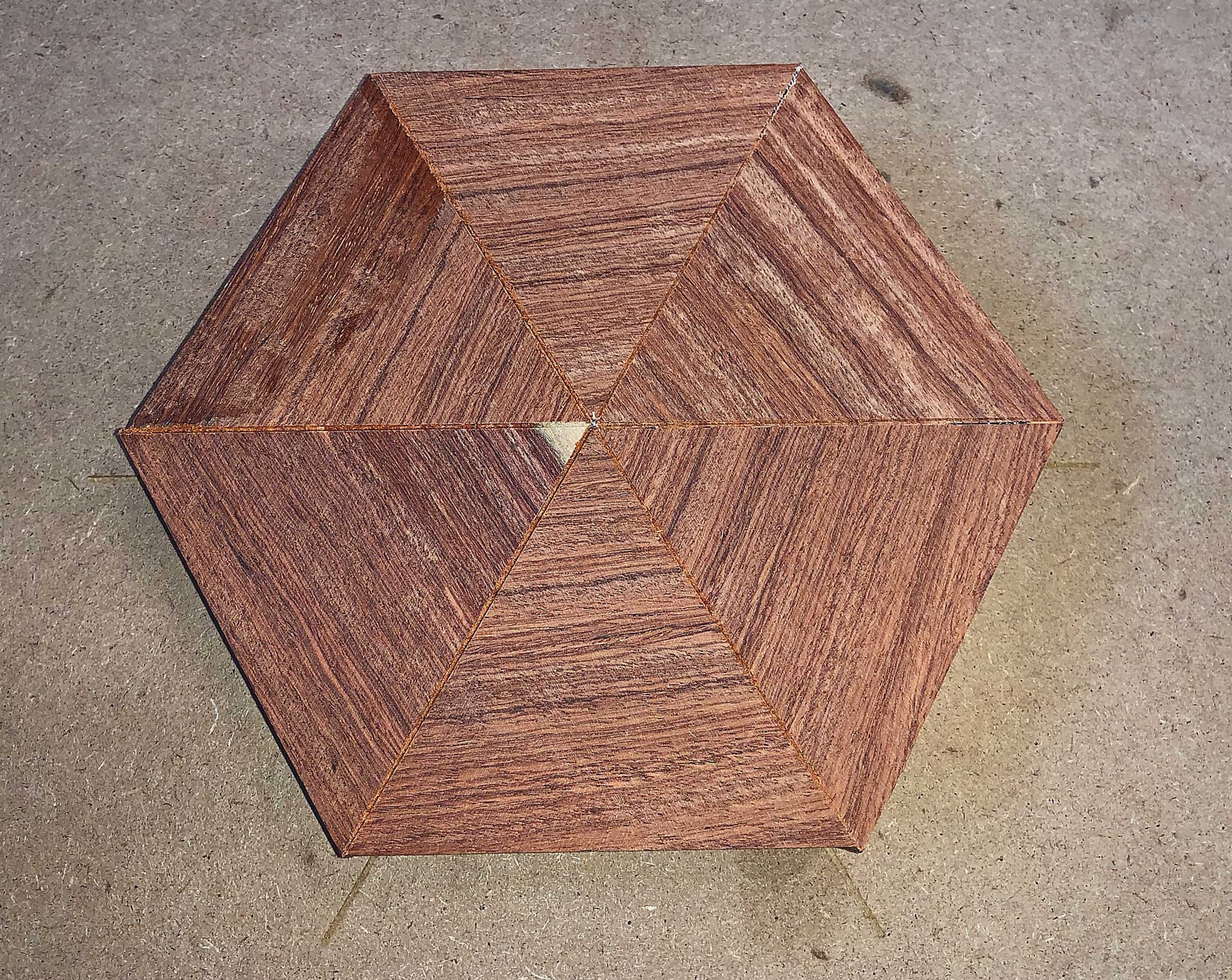

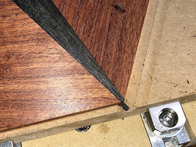

So, I had an issue with alignment on the medium-sized toppers. Since the wedges taper down to around 3/32" (2mm), it’s important that the blanks I glue up from equilateral triangles have their glue lines fall within the wedge. Maybe I was getting sloppy building blanks. I ended up addressing the issue by creating a radial hex line toolpath in Carbide Create and using that to etch the wasteboard so that I could line up the blank’s glue lines:
Then as a double-check I ran the etch program on top of the blank (since that gets cut away anyway):
I actually moved center a tiny bit in both X and Y after the blank was mounted to get center just right. One advantage to this technique is that I didn’t have to worry about the outside edges of the blank at all, as you can see.

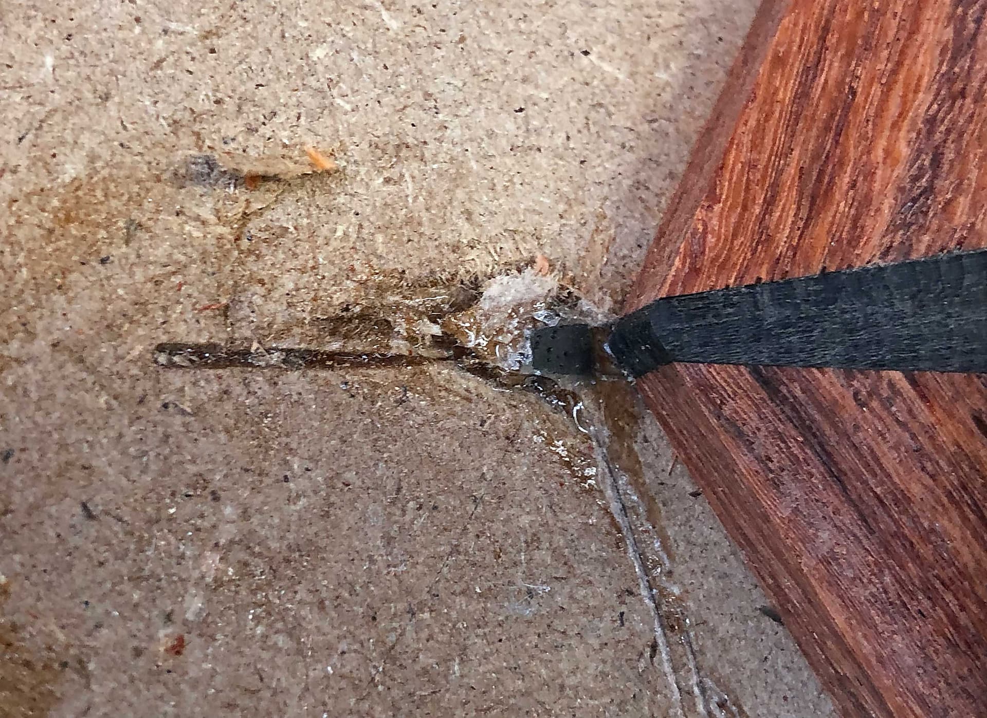

The other thing I’m doing is glueing the wedges in while the blank stays mounted to the wasteboard and the wasteboard is mounted to the spoilboard. This means I have to manually chop clearance notches in the wasteboard so the excess wedge has some place to go. Kind of a pain, and it ruins the wasteboard so I have to resurface it for each new topper, but for me that’s the price of alignment.
Here you can see what the wedge glued and trimmed looks like on the wasteboard:
It’s actually gluing the topper to the wasteboard, so after I’m all done I have to chop away at the wedge in the wasteboard to free it. Here’s what the wasteboard looks like when I’m done:
You can still see the alignment lines, but they’re ruined at the critical corners so I can’t use it as is for the next topper.

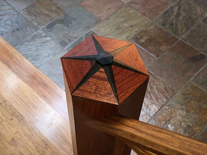

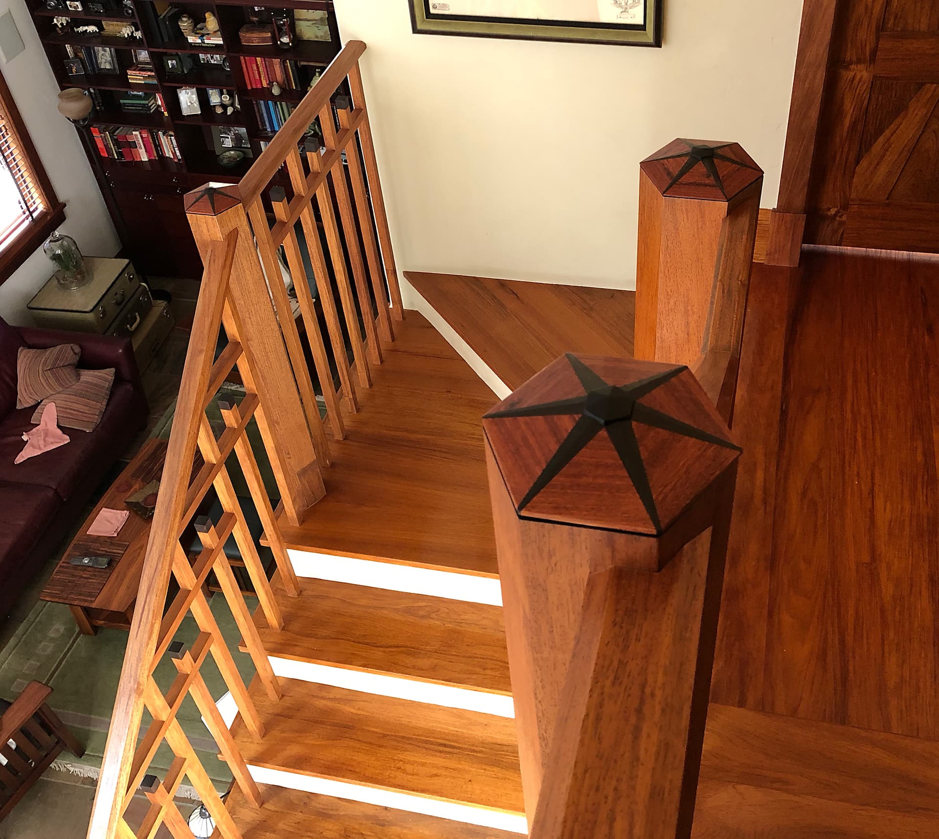

Here’s a shot of the completed staircase:
I still have two more toppers to make for a balcony. Securing the small pieces of ebony for the wedges on these smaller toppers is becoming a challenge. I may have to resort to tabs and using larger pieces than I need to in order to have more securing area.
That looks great, really good to see those CAD shapes in real wood and in context with the rest of your work, the patterns in the balusters are a really nice change from the normal too.
