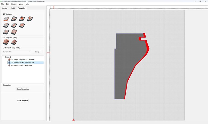

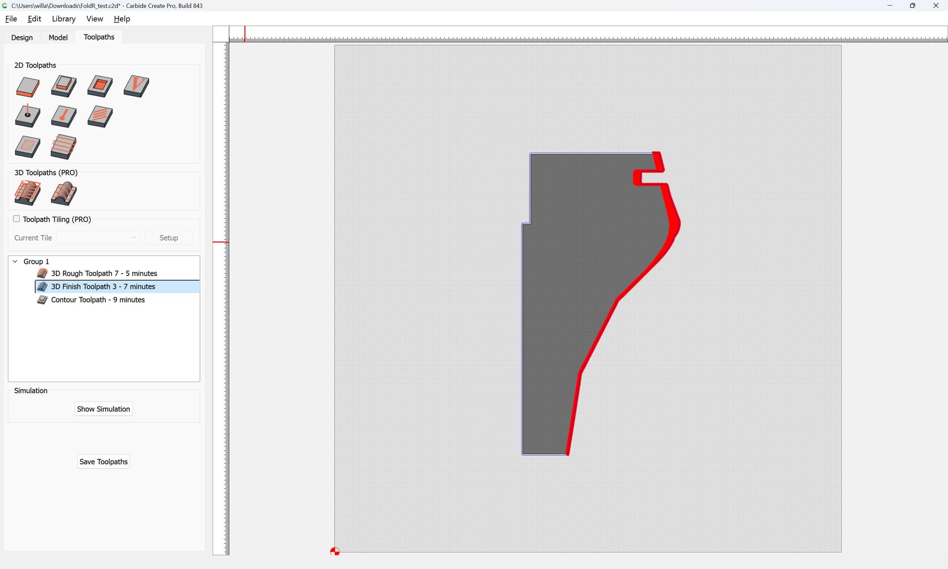

Hi there,

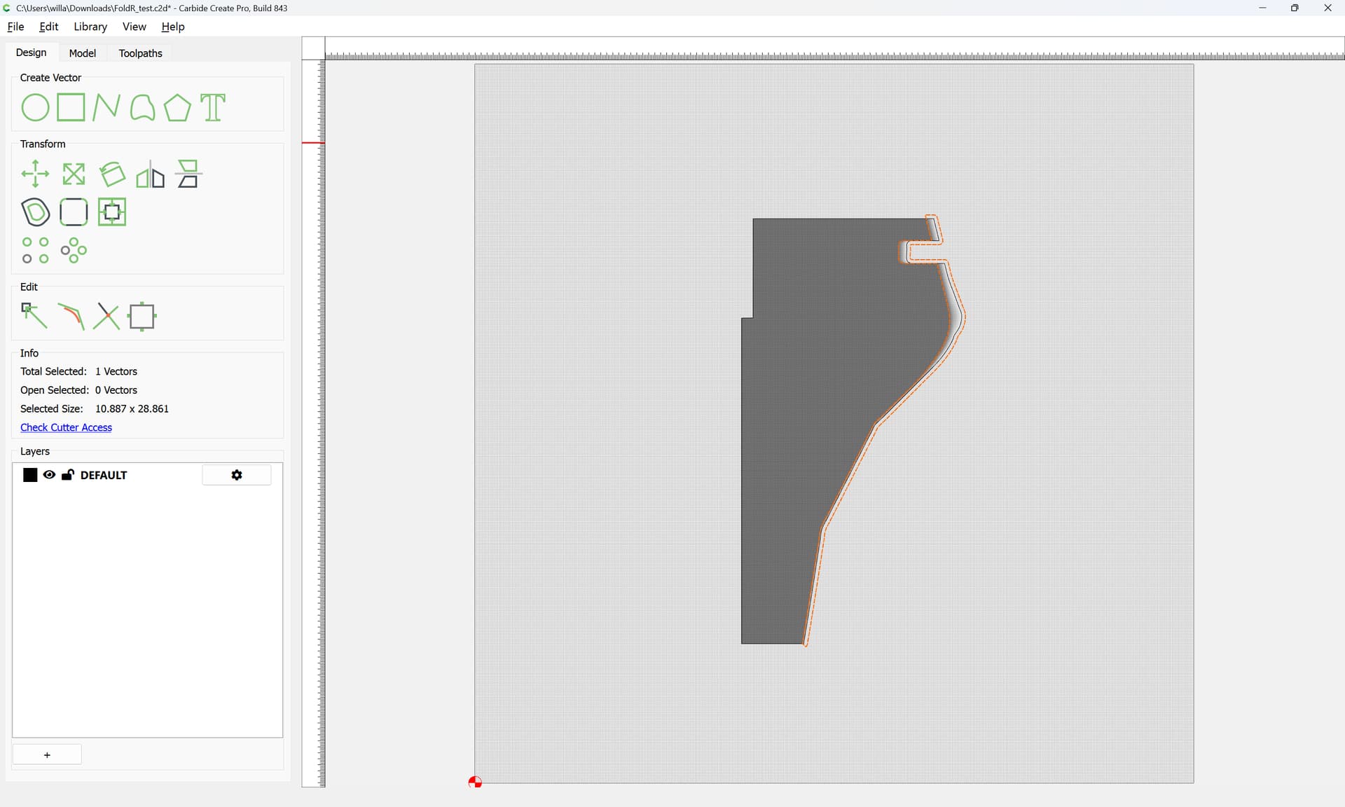

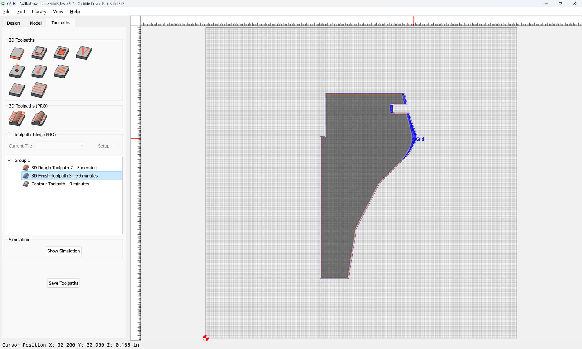

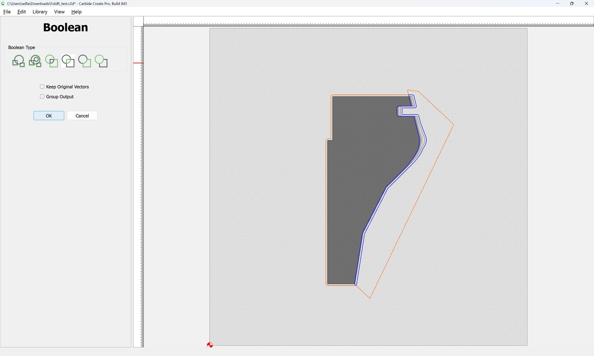

I’m trying to figure out how to set up my file in carbide create (Pro) to cut out an STL from a sheet of plywood. I’ve researched online and got my c2d file 90% there, but can’t figure out how to avoid having the finishing toolpath run across the whole surface of the piece. I want it just to clean up the area that is being cut in the roughing toolpath (i.e. leave the rest of the top surface alone).

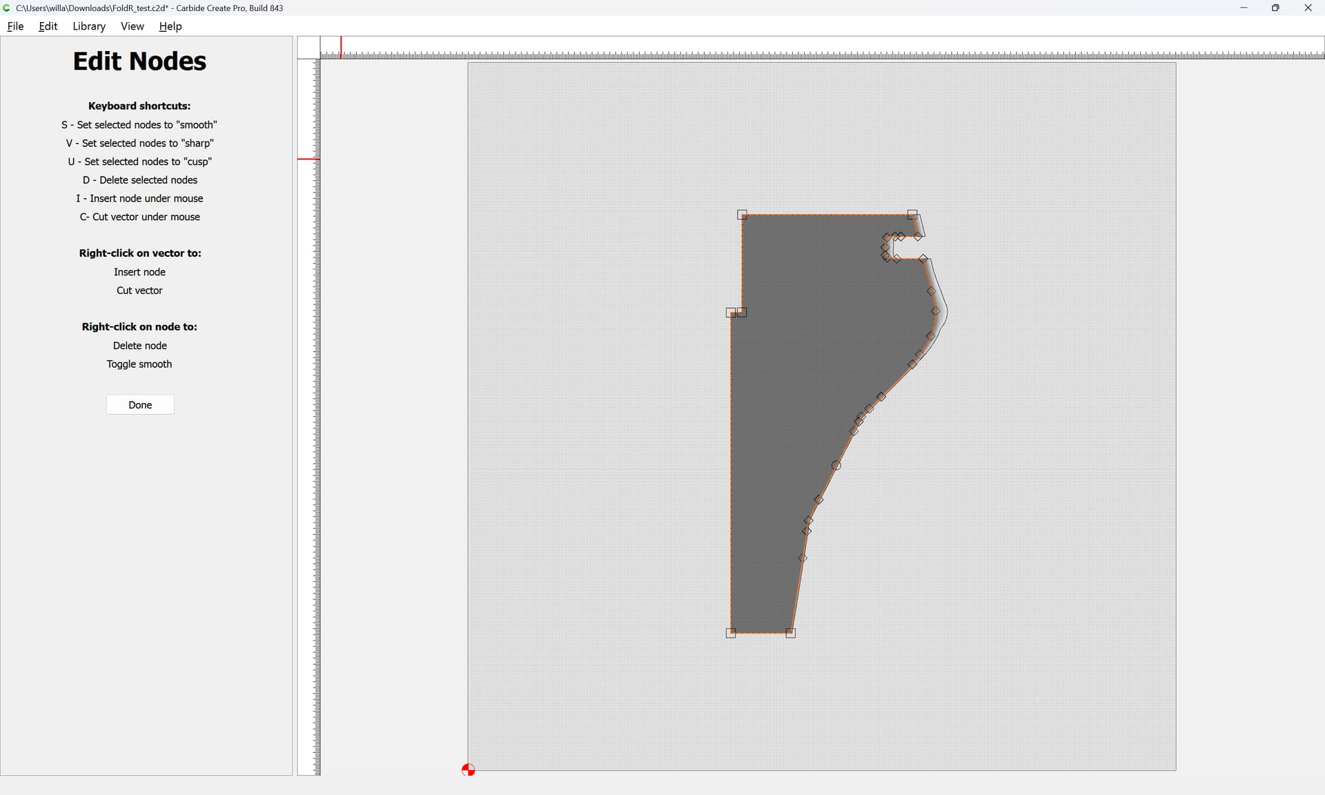

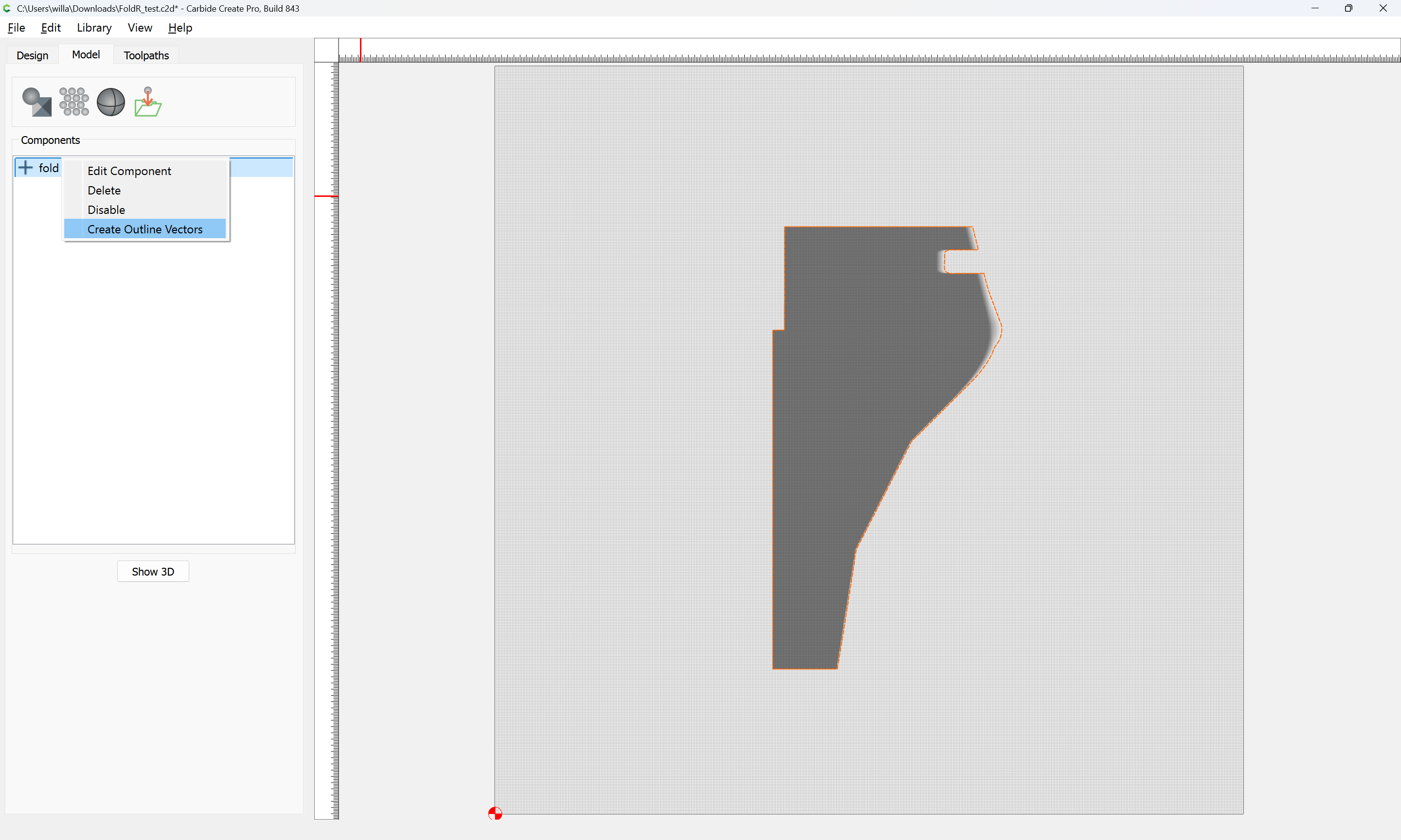

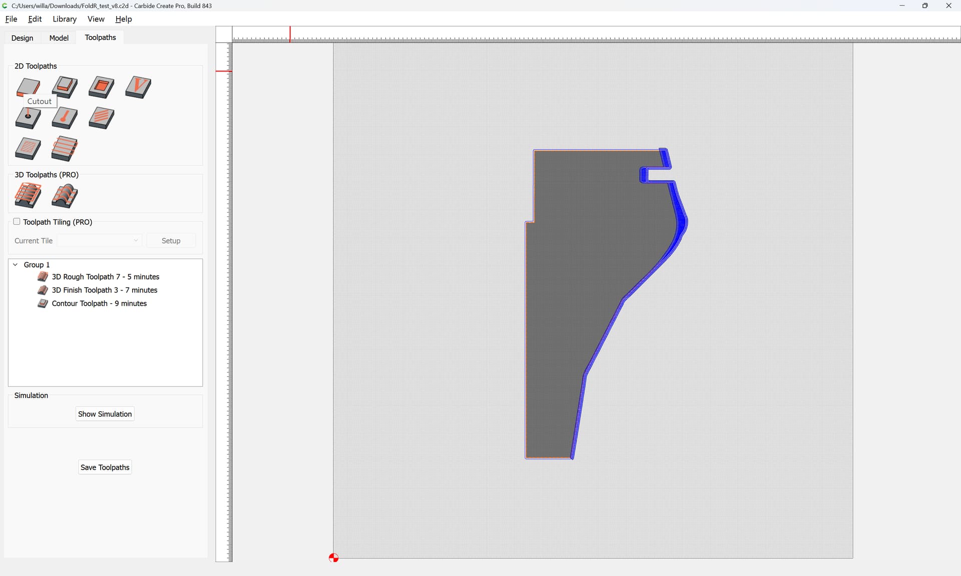

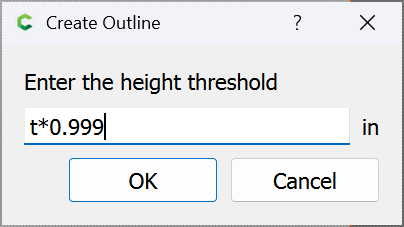

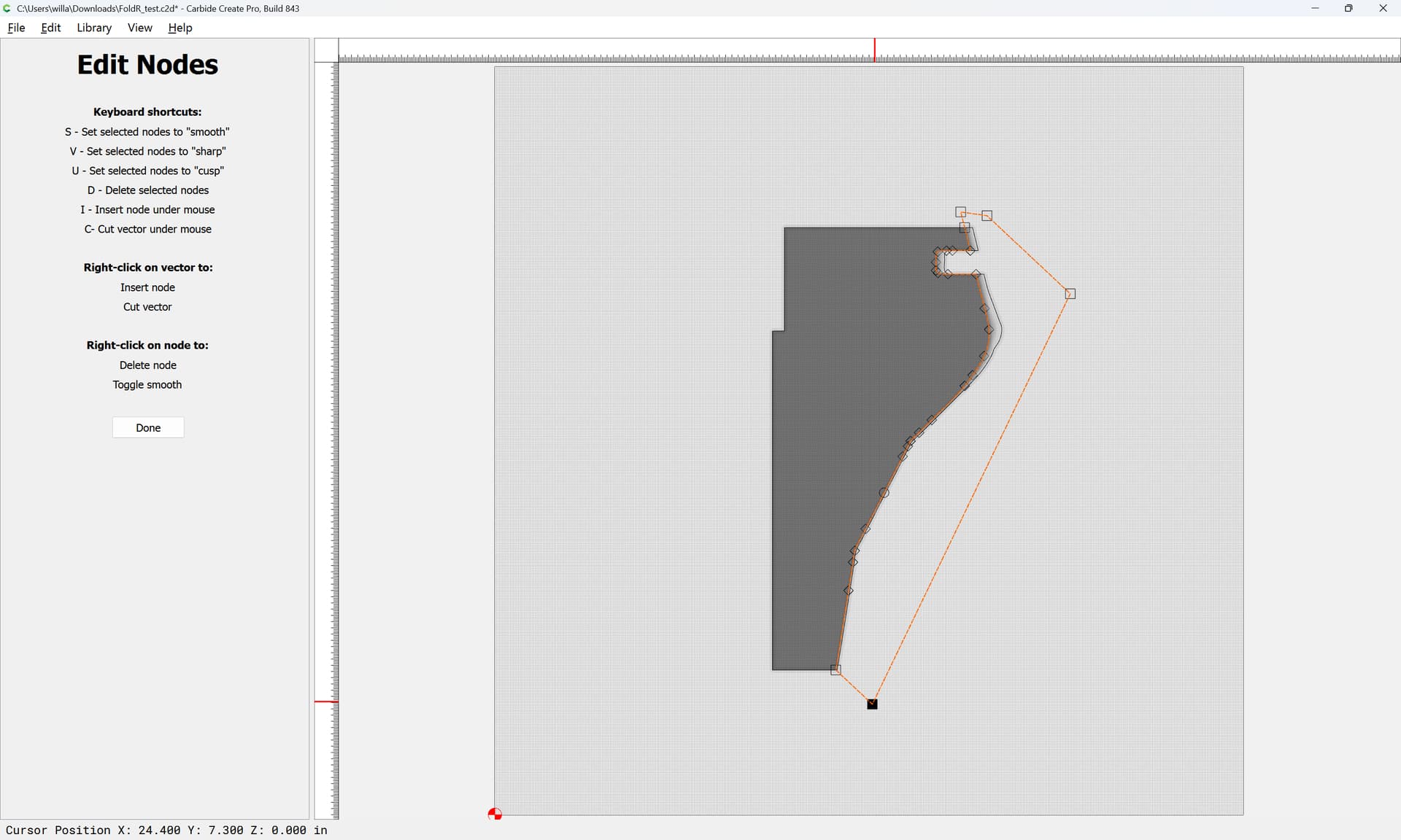

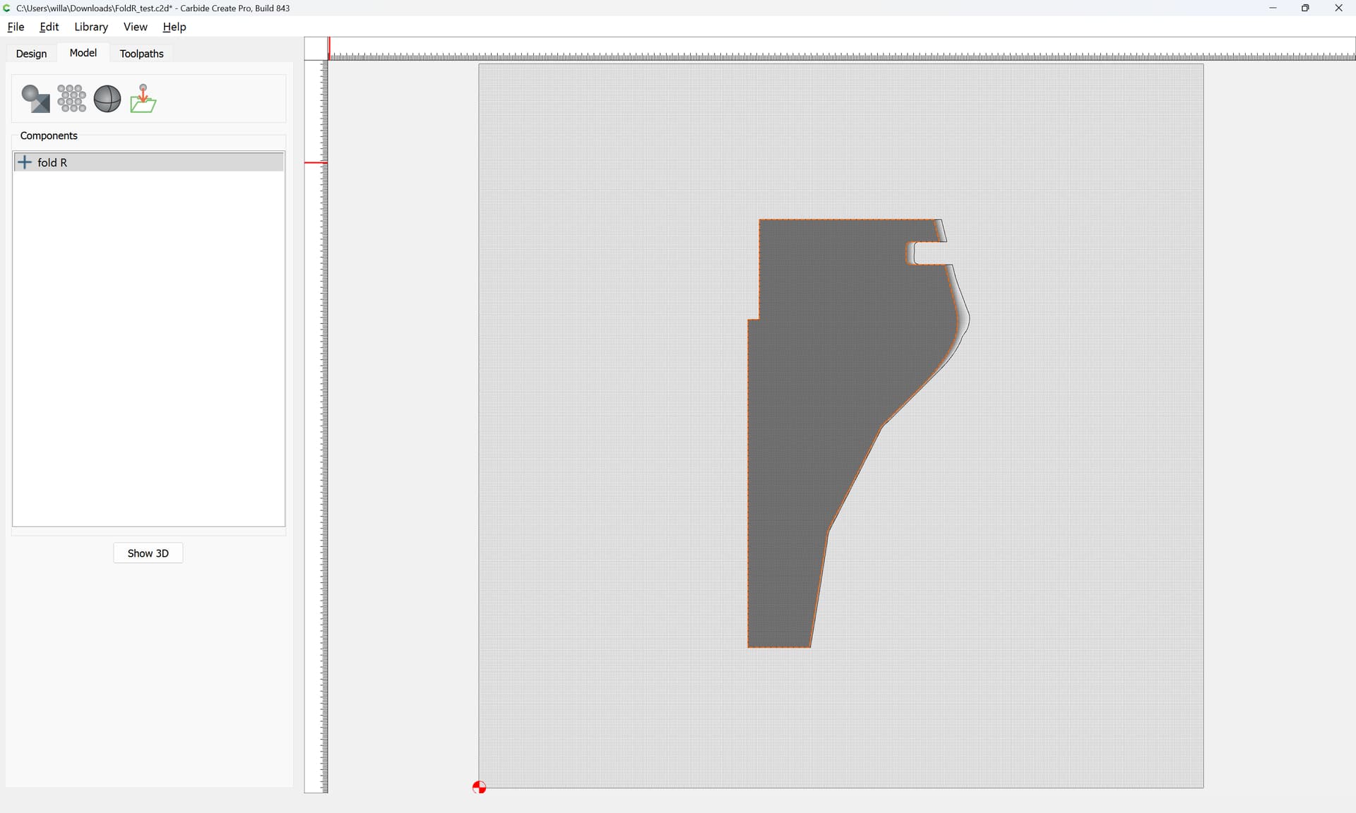

Carbide Create Pro has a facility for tracing a design which you seem to have used:

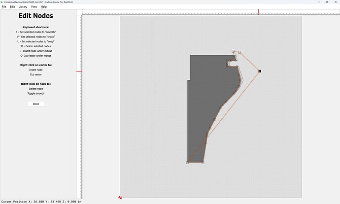

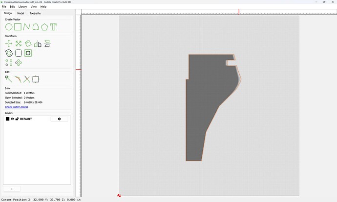

In order to further limit the area used for a toolpath you will need to trace again:
and then turn that inside out:
Done

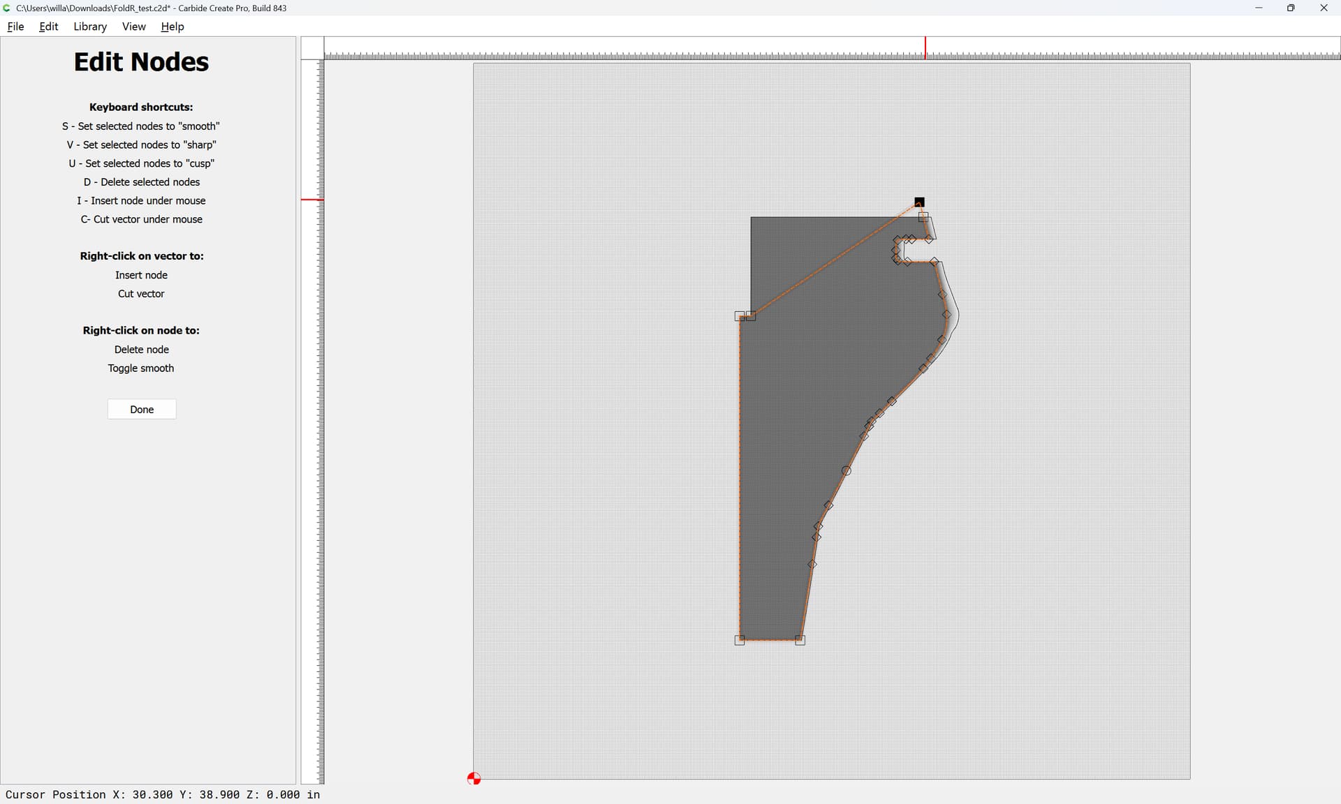

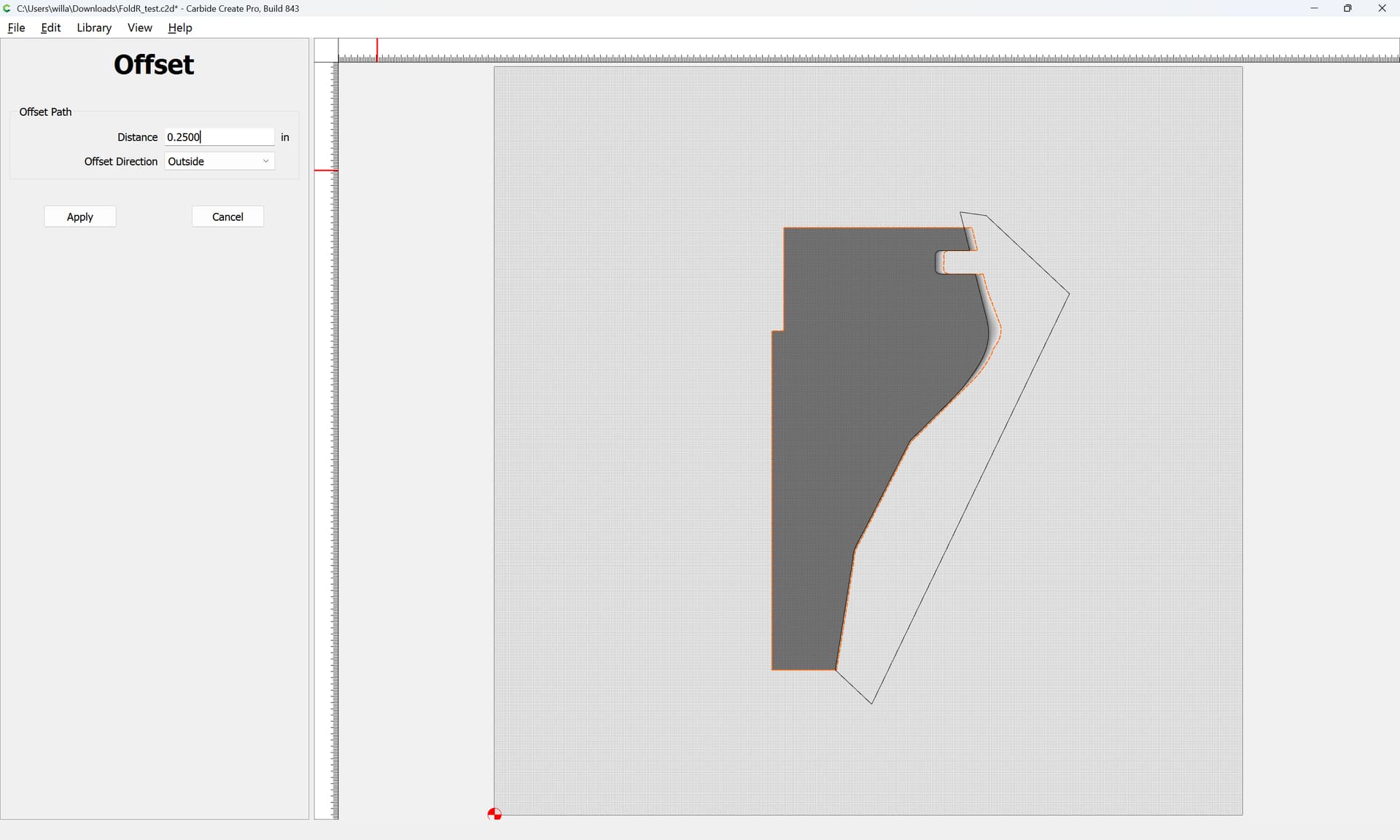

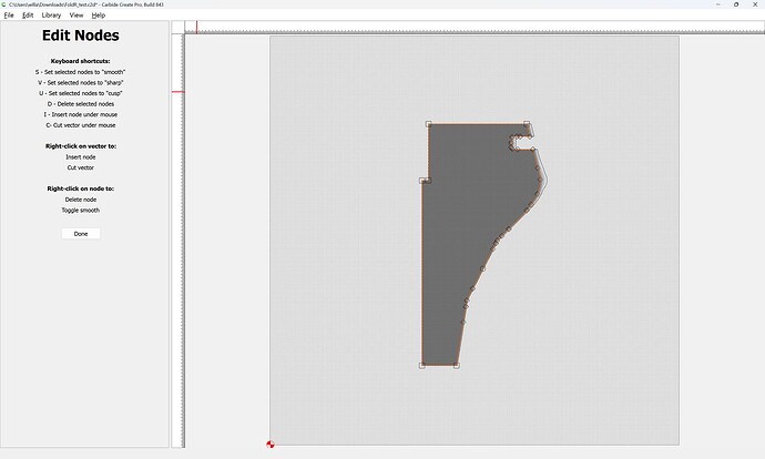

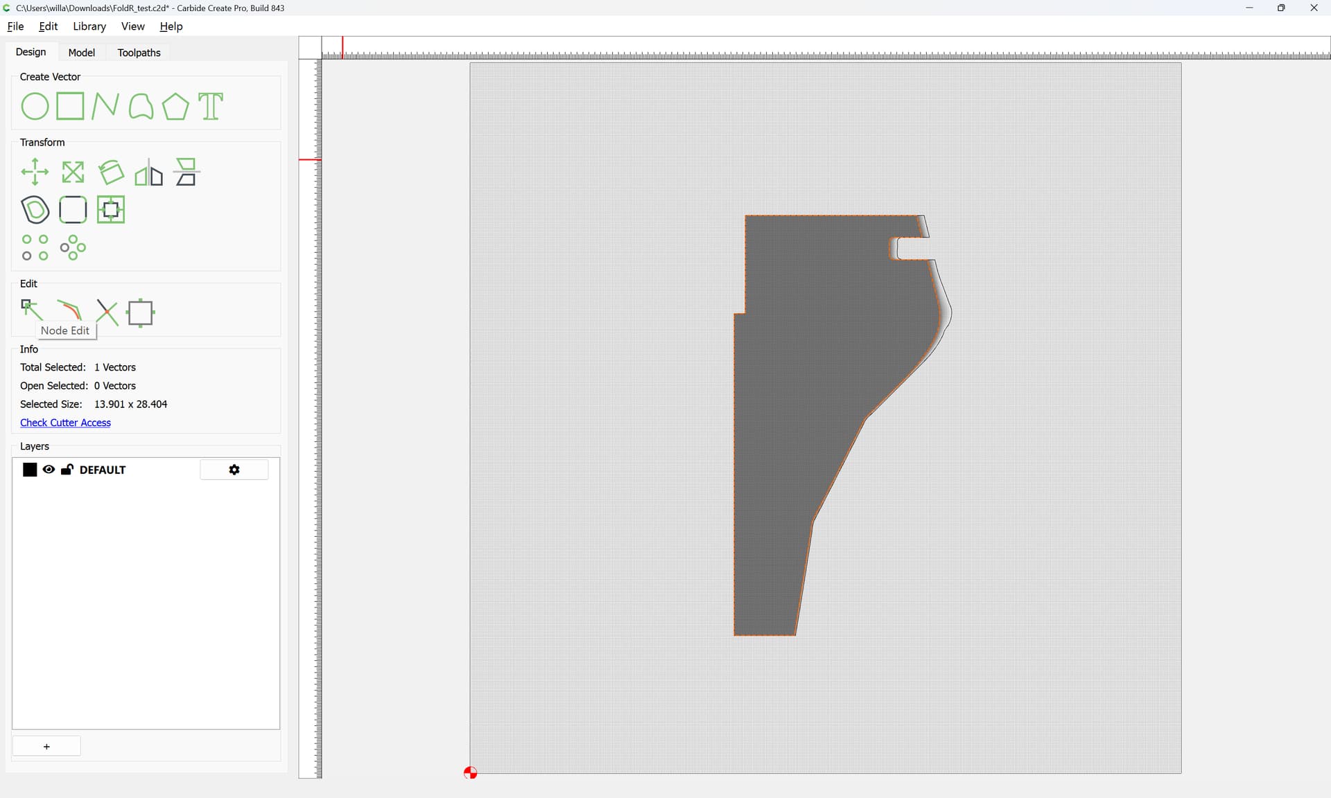

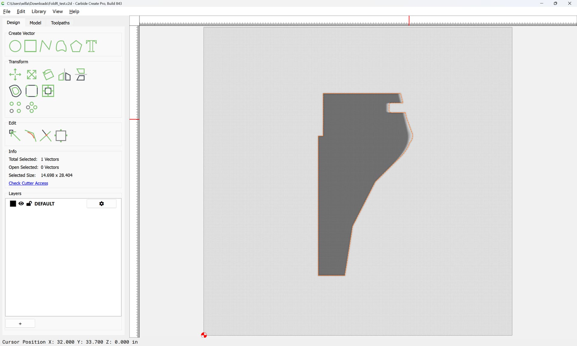

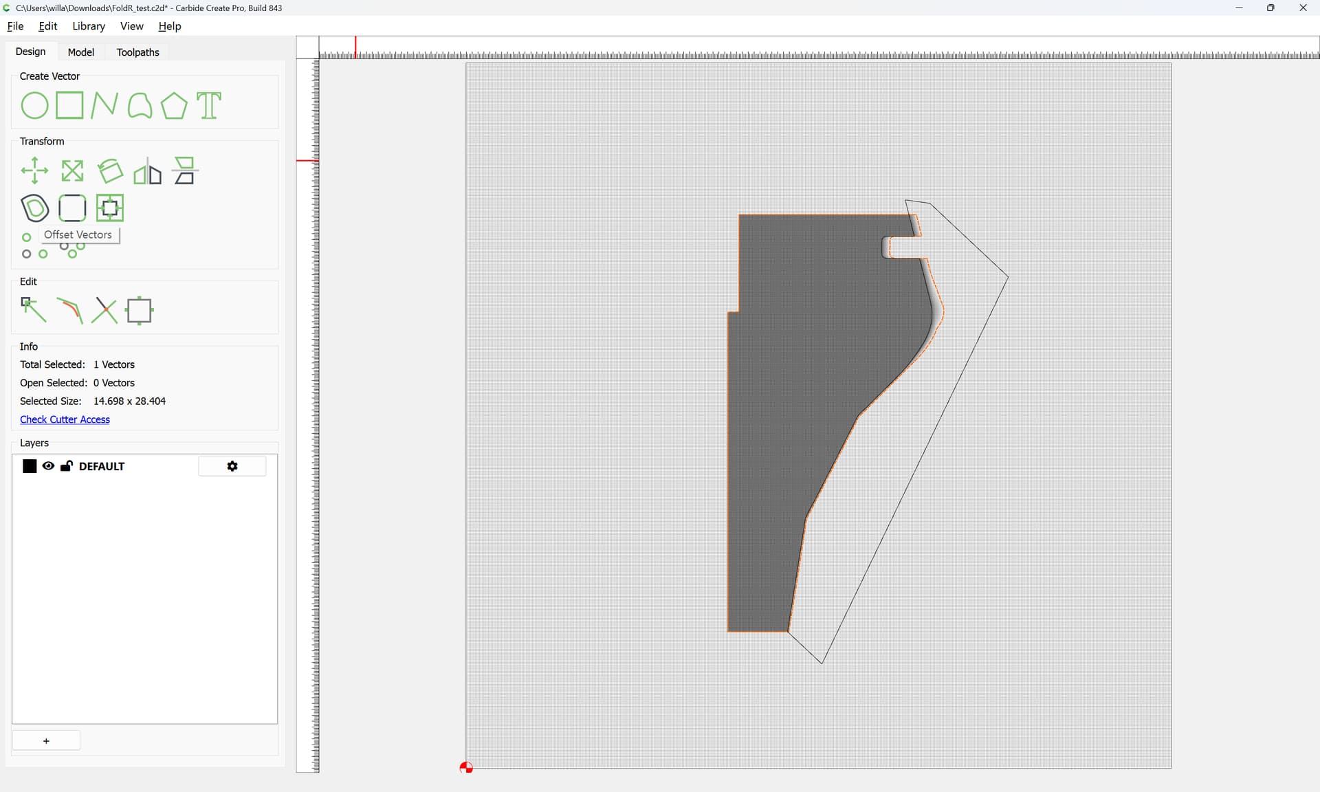

Then offset the bottom traced geometry
by the radius of the tool which you will be using:

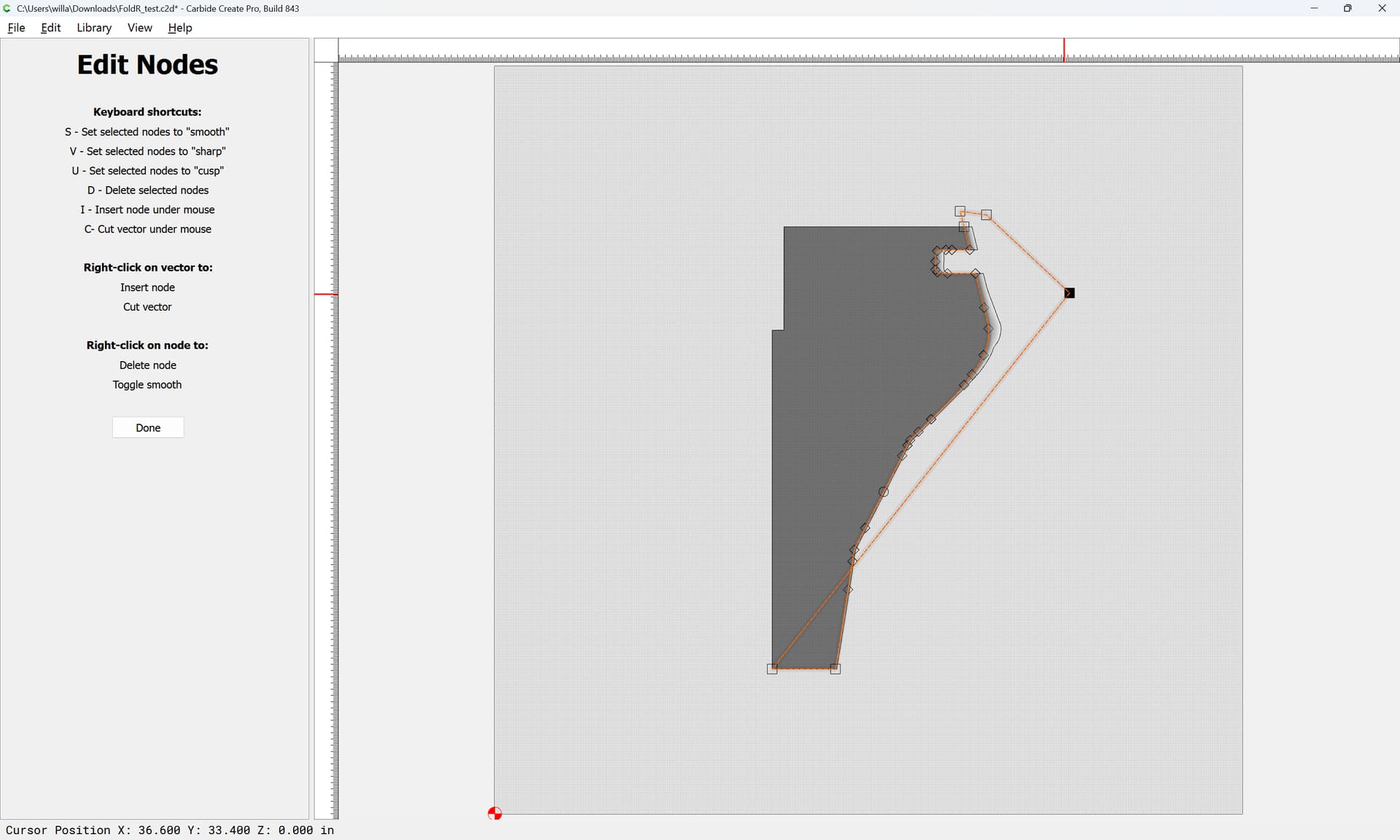

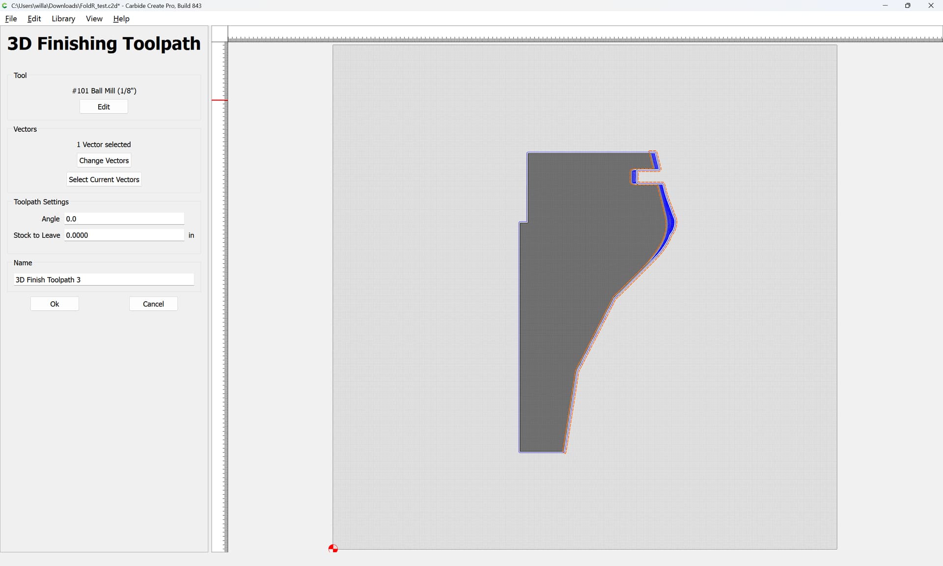

Then get the Boolean Intersection of the two regions:
then associate this geometry with the 3D Finishing toolpath:
Note that the Stock Thickness matches the Cutting Flute Length of the tool in question — you’ll want to be careful of rubbing the collet against the top surface.

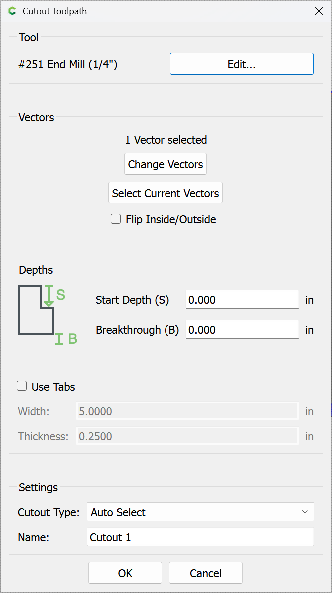

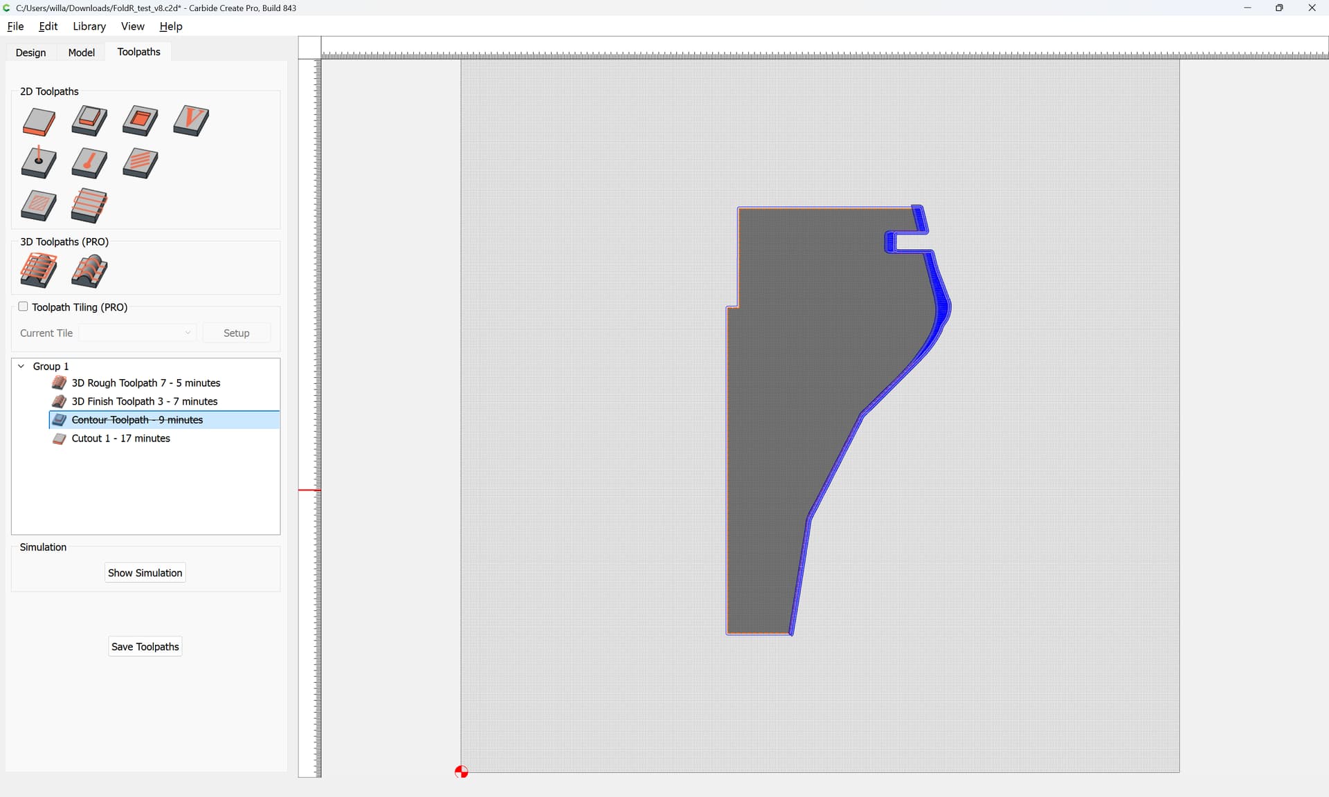

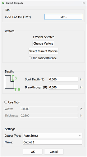

Further, I’d suggest using the new “Cutout” toolpath:
for cutting the perimeter:
Attached as a v8 file.

Note that you will need to use the new beta:
That’s great, I would not have thought to use the inverse/boolean actions. Thank you so much! I will now investigate the Cutout toolpath.
