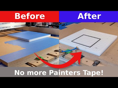

I designed and built this fixture as a fast, clean alternative to painters tape. It doubles as a jig for double-sided cuts. This video walks through testing and using it.
Nice,
What material did you machine the vac plate from?
Is that a single ring gasket or an adjustable length?
One of the problems with vacuum fixtures is the “leakage” in the areas outside of the gasket. This reduces the hold in the area inside of the gasket.
You could reduce this effect by making isolated channels in your fixture that only connect at the vacuum input.
You could add a vacuum manifold to make connecting to these multiple channels easier.
You could add a vacuum reservoir (tank) to hold the piece in case your air/vacuum goes down (power outage.)
We didn’t get to see the finished ash tray!
Added: Never mind. I see you’ve already created a vid for the “cigar bowl.” Making a Cigar Bowl - From Design to Finish - YouTube
Its gasket cord so you can layout any pattern you want as long as you mate the two ends to complete the loop. Basically a butt joint with a tiny overlap so the two ends push against each other to seal the gap.
I’ve used this for a couple months and had zero problems with leakage in any job or test I ran. If you’ve used a system with the problem you described, its either not machined correctly (channels have voids or ramps) or there’s you’re using a bad gasket material (wrong material, cracked gasket…take your pick).
What are you using for a vacuum pump?
Its a vacuum generator driven by compressed air (the device I’m holding in my had at minute 2:04 in the video). You could use a shopvac as well but this is way more convenient since I can switch on/off the vacuum at the fixture (see that at minute 3:00) it sips air so most of the running time, its running on the compressor reserve tank. The generator can run from as low as 30 psi air pressure and consumes around 0.735 CFM of air (so, very little air flow from the compressor).
I did a test just before recording this video, where I ran the vacuum fixture with a piece of stock attached, from 90 psi (max working pressure) all the way down to 30 psi (lowest reliable pressure I could get from the compressor). It worked throughout that process.
Its also simple to expand the machinable area by connecting multiple fixtures together. That’s one new feature I’ve already designed and will be machining today once I get some parts I’m waiting on.
Bonus, the vacuum generator frees up my shopvac for other duties (e.g. dust removal).

That’s exactly why I built this; to speed up production runs. Most of my parts are double-sided cuts as well so I solves that problem at the same time. Now I don’t need to redrill holes or fiddle with setting zero on an existing hole everytime I want to machine the second side. Zeroing on the dowel pins gives great accuracy for two-sided cuts.
I will be offering this for sale in a full kit (dowel pins, vacuum generator, hose, gasket); though the final version will be a different material. HDPE warps and dents easily so its great for a prototype but would not hold up over time. I also redesigned it to add a few features that make it easy to mount and expand.
