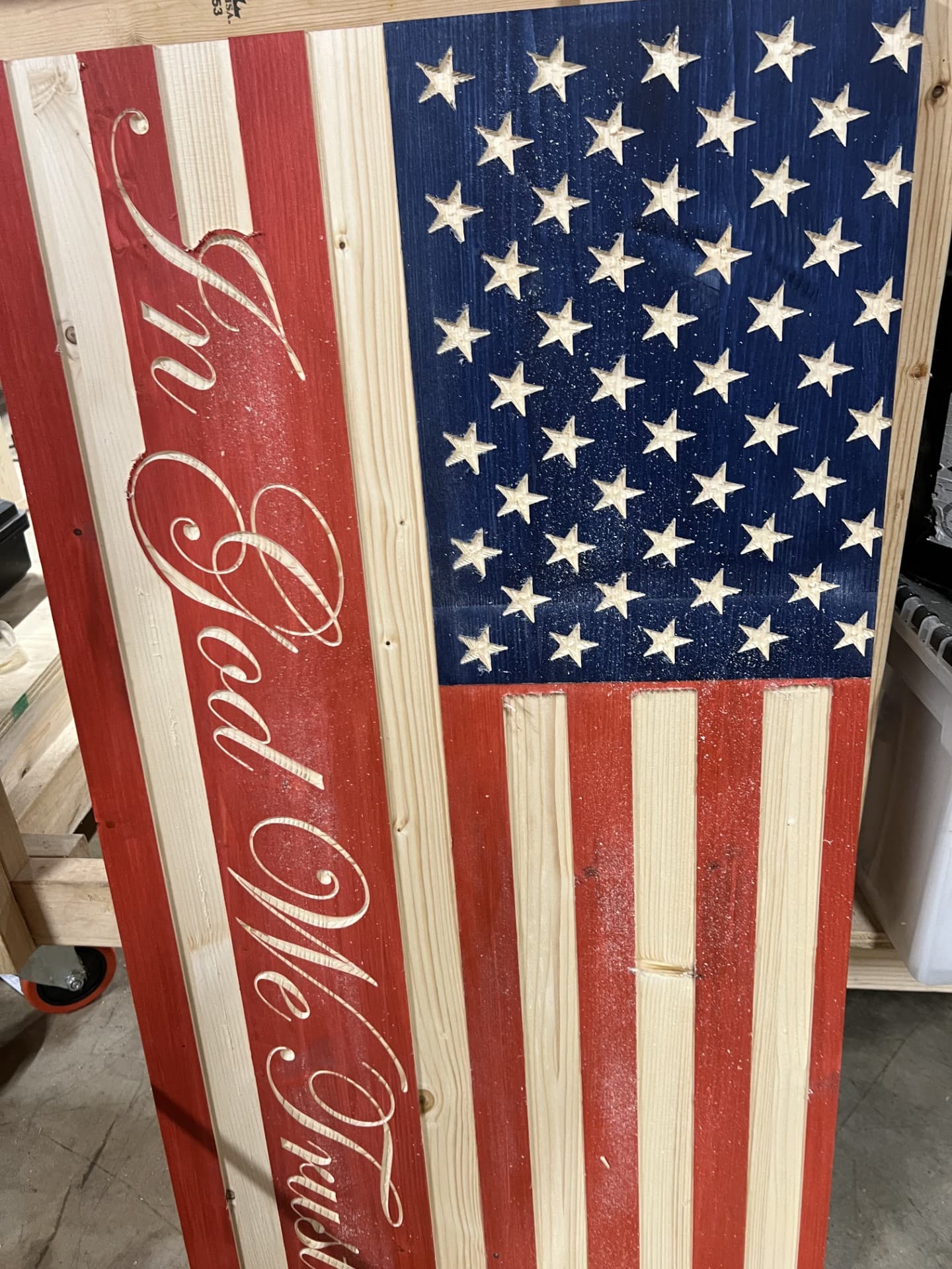

I have made several flags and they have turned out nice. All of sudden the union is being cut to close to the edge of the stock. I have not really changed anything and getting good zero. The stars on the top of the union are cutting off the top of the stock. Not sure what is going on. When I look at a simulation of the project - everything looks great. Anyone with suggestions, I would be grateful.

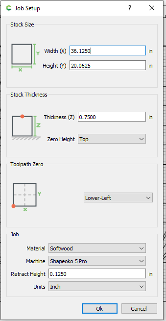

Double check the physical dimensions of the stock and the stock size in carbide create. What are you using for stock? Pictures?
Same stock each time.
Simulation
Dimensions look correct. Again this has been working and then all of a sudden it has changed for some reason. Probably something I have done but I can’t seem to figure it out.
Measurement on the stock are 36 1/8 X 20 1/16.
Set the stock in the same location each time and zero everything on each Flag.
Job Setup screen shot
¾ Pine for stock.

Got a pic of the result?
Does not make any sense to me. Running a new job now. Started with only the top most left star of the union so that I could stop it if it looked wrong. Damn thing seems to be running right now. We will see how this one turns out. $24 bucks a pop, lol. Have no idea what happened. We will see how this one turns out.
Really just looks like your stock is short. Can you measure again?
Brother, I promise I measured twice (5 times). It could have been, but to have two that messed up back to back was an oddity to me. Perhaps your right, I surely hope so. As I am cranking these things out and a screw up is $24 buck out of my pocket.
