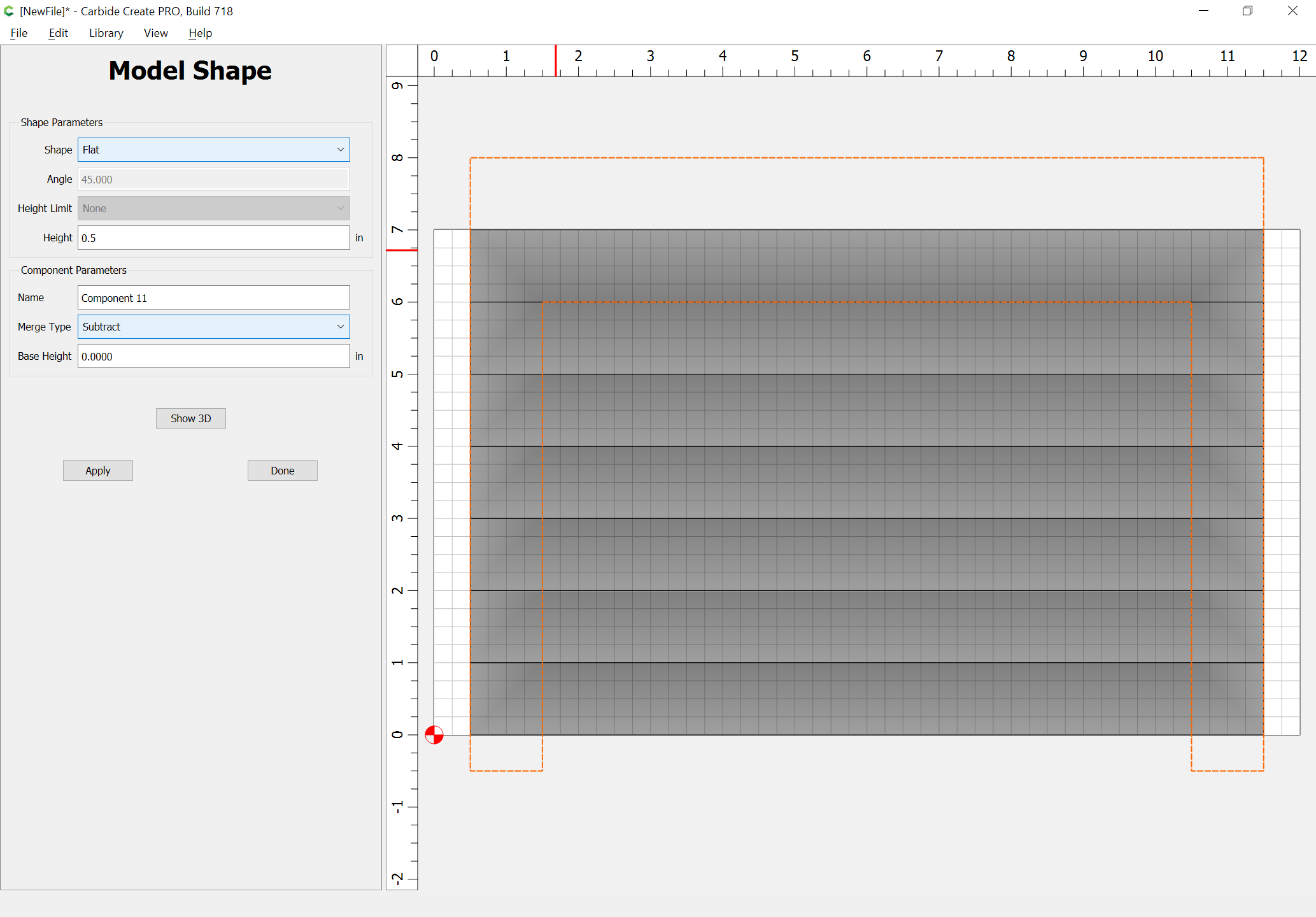

DOES ANYONE HAVE ANY EXPERIENCE SETTING UP FLUTING PATTERNS IN PRO? I AM MAKING SOME DOORS TO A CONSOLE AND WOULD LVOE TO EXPLORE SOME PATTERNS LIKE THESE… THANKS! I BELIEVE YOU CAN DO IT PRETTY EASILY IN VECTRIC.
Sure! It’s just a matter of drawing rectangles which are longer than the stock area and then either adding or subtracting them w/ suitable settings.
That said, most of your designs would be most efficiently cut w/ suitable tooling such as roundover endmills, or large ball-nose (bowl) endmills) see:
wha!!! did you figure it out?
Start w/ a rectangle twice as large in the Y-axis as you need:
Model it as an angle, scaling it to the height, and adding the base height:
This gets one slat:
Move, or select geometry one further up:
and repeat:
Repeat until one arrives at:
Then draw in geometry to remove what isn’t wanted:
and subtract to clean things up:

Hi Will, quick question, I should set up cuts with 3d rough and finishing passes right?
Correct, use 3D roughing to clear the bulk of the material — then the 3D finishing toolpath begins, assuming that most of the material has already been removed.
