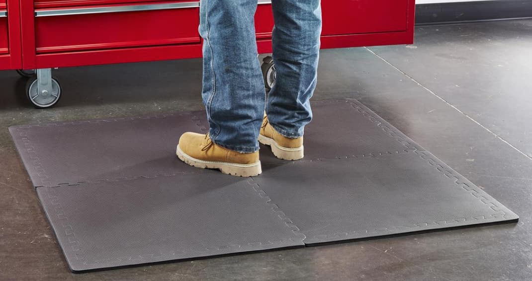

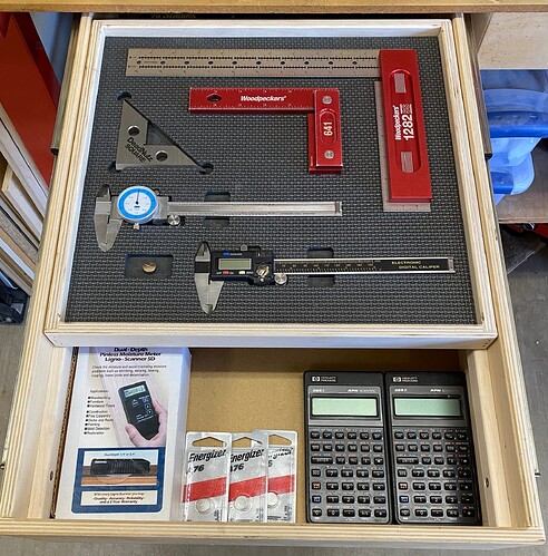

I needed a safe place for squares and calipers, so I built a sliding tray that fits inside an existing drawer. The foam insert was made from a section of Harbor Freight anti-fatigue mat. This stuff cuts really clean using a fast feed rate (150ipm). $9.99 for four 2-foot squares, 1/2" thick. A 2 flute, 1/4" downcut endmill created a cleaner top edge than a 3 flute, 1/4" upcut.

If its the same black foam that comes with accessories like Z-Plus and HDZ, then yes. It cuts good but as @WillAdams hinted, go FAST. I did 150 ipm and it worked good on the Harbor Freight foam, but in general you should probably go faster. I should’ve mentioned I was running at 24,000 RPM.

Nice! Looks like a great fit, Steve. I know there are several ways to go about it, but have you narrowed down a preferred method to model the projected area of each tool? Those seem common enough that the dimensions or even the CAD files are available online somewhere perhaps.
One straight-forward way is to lay things out on a scanner (w/ a protective transparent plastic sheet to protect the glass) and scan them.
Or, use a triangular block of wood w/ a divot and a pen insert (or a specialized long nect) to trace an outline.
Or, arrange on a gridded surface and photograph.
Mine too. Used ones currently fetch $100+ on auction sites. I bought two new ones in the 1990s and they are still going strong. I started with an HP 41C programmable, which was a godsend in engineering school in the early 1980s. Once you go RPN (Reverse Polish Notation), you never go back. My wife and kids never touched my calculators because they don’t have an “equals” (“=”) key. :rofl:
This was my first attempt at inserts. The squares were easy because the pockets were just rectangles and a triangle, which I measured and drew in CC. I tried photographing the calipers and tracing them in CC, but that didn’t work well. I ended up tracing the caliper on white paper with a mechanical pencil, scanning the drawing as a jpg, tracing it in CC, then cleaning up the lines with the editing tools. Then I did a test cut and tweaked the lines for a perfect fit. It’s a bit of work but the end result is worth it.

What did you use for work holding with that foam?
I used a few small pieces of double-sided carpet tape. I usually use blue painter’s tape and CA glue for projects, but painter’s tape doesn’t stick to this foam very well.
