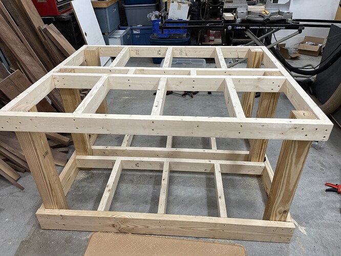

Thanks for the inspiration and size discussion. Here is what I did.
Looks pretty sturdy. You look ready to park an M1 Abrams Tank on top of it. I use pocket screws a lot. When I first started I would apply glue. Now I just use the pocket screws and no glue. I dont think glue adds anything and if necessary you can disassemble it if you need to make changes.
