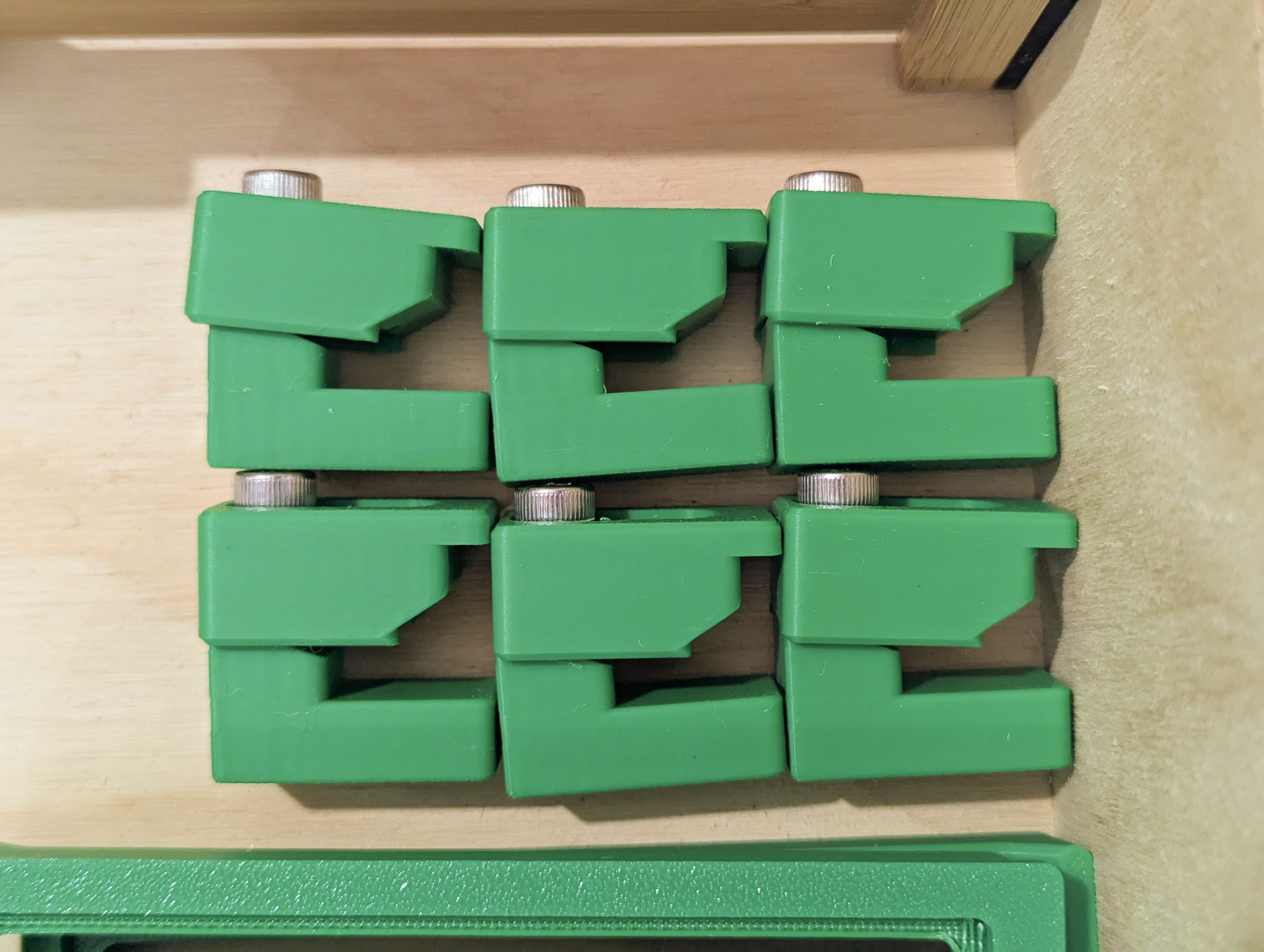

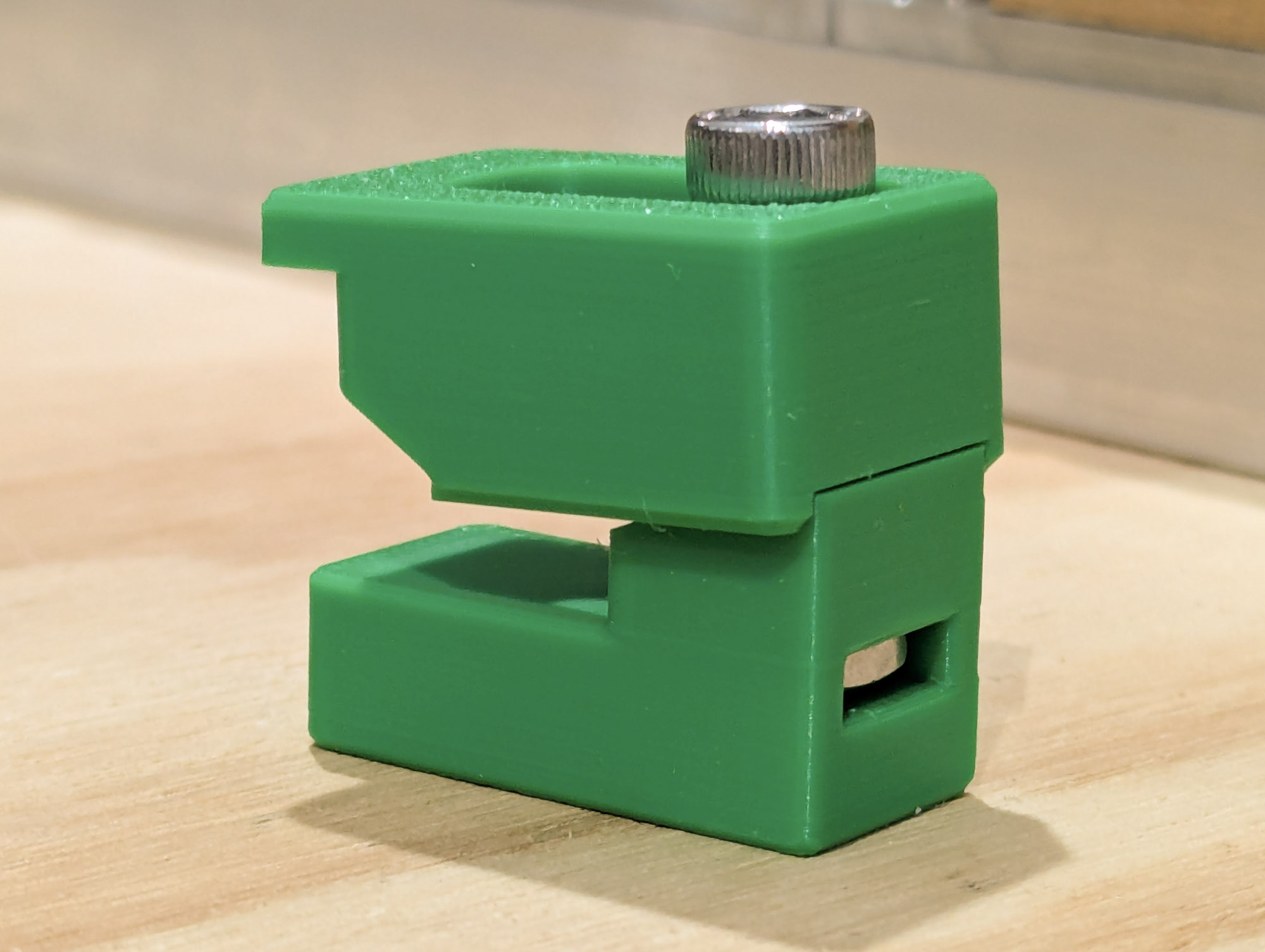

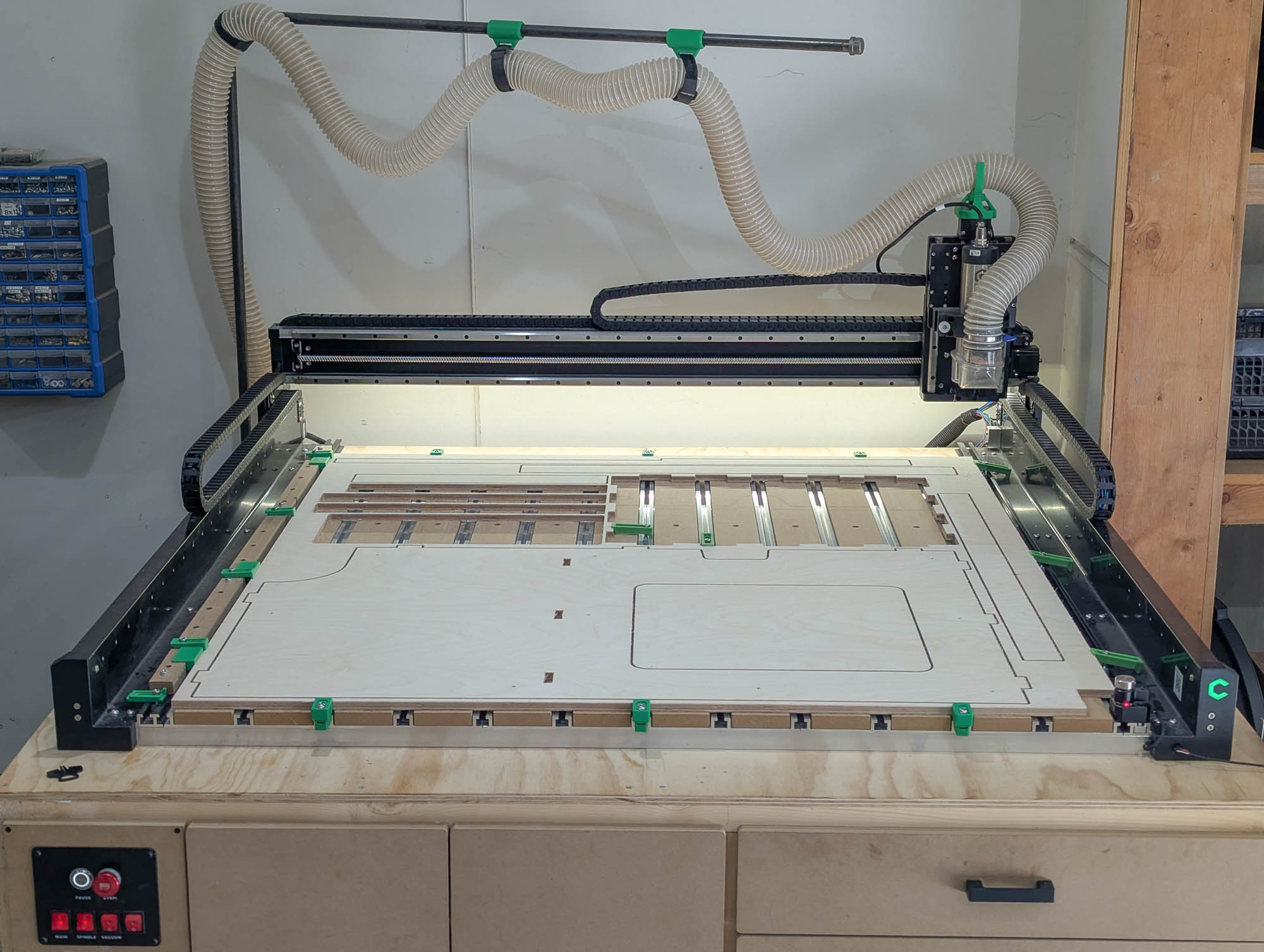

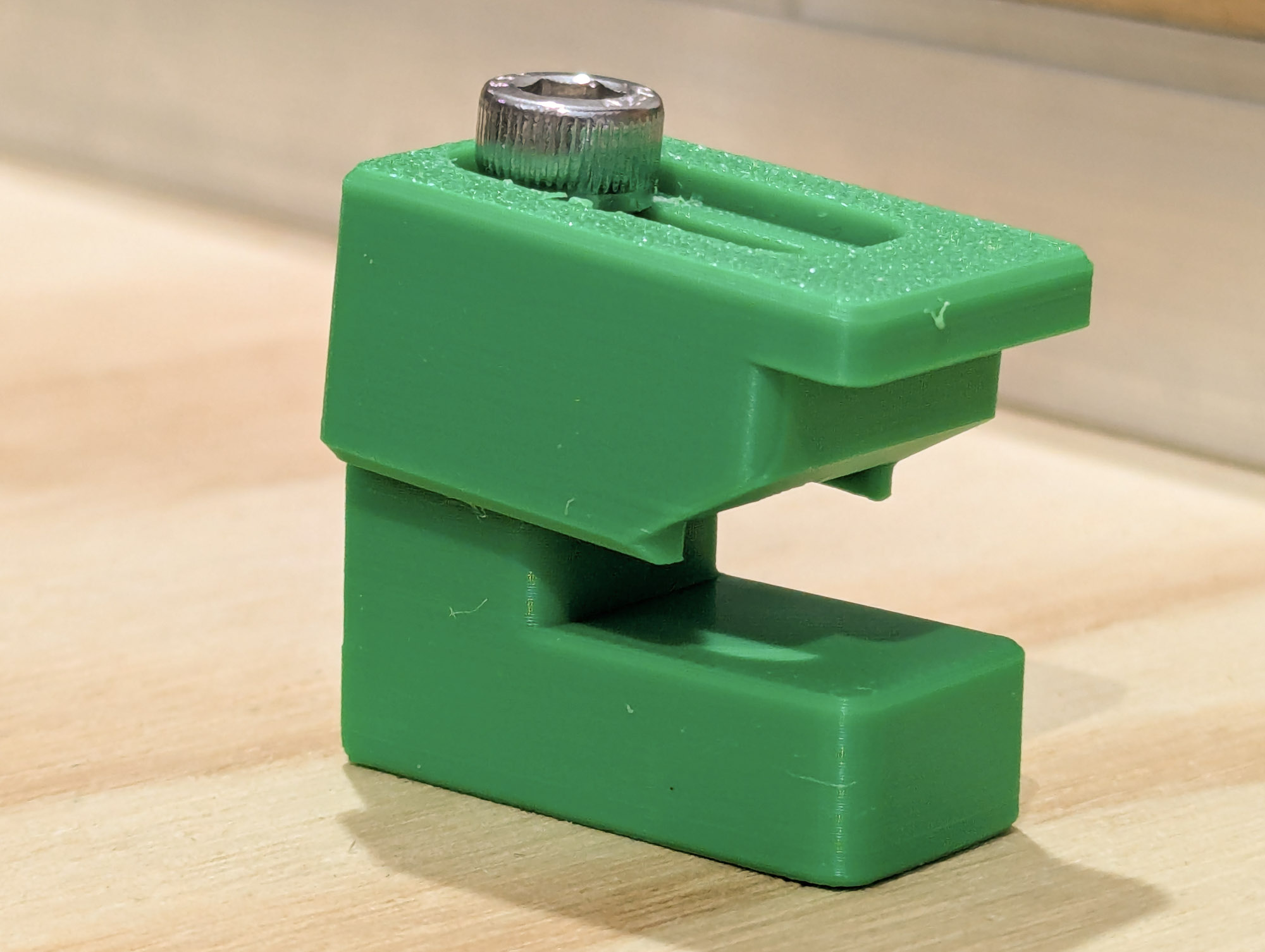

I have several upcoming projects that require 48.5" x 48.25" plywood sheets on my 4x4 Shapeoko 5 Pro CNC. I designed this clamp for situations where the stock covers the entire spoil board or is flush with the front or back edge:
The 3D Print File is available on Printables:
Specifications:

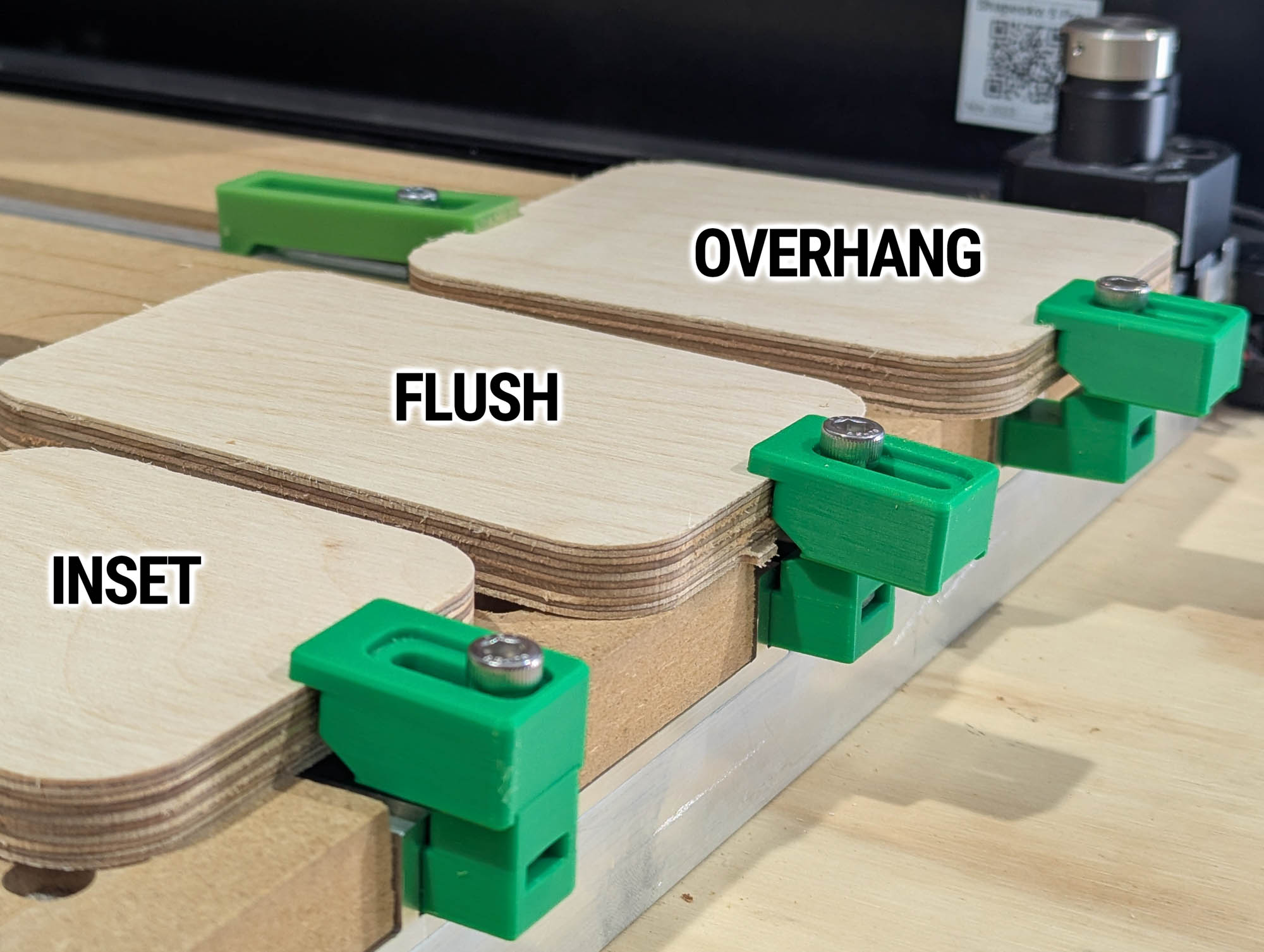

  • Stock thickness: 3-26mm (1/8" - 1") depending on spoil board thickness.
    • I created three different TOP parts to cover as wide a range as possible.
  • Stock position: 10mm overhang (outside the table) - 15mm inset (inside the table).
  • Hardware: M6 Square Nuts and M6 x 30mm Socket Head Screws.
  • Compatible with Carbide3D Hybrid Table (Shapeoko HDM, 4, 5, Pro).
3D Print Settings:
  • I used PLA with 100% infill for maximum rigidity/strength.
  • The bottom part does NOT require support. I added a sacrificial layer built into the model that can be removed after printing.
  • The top part requires support. For a clean and firm surface, I used PLA Support for the interface layer (PETG can work as support interface too). “Normal” supports are OK too!

Very nice! Thanks for sharing with the world as well :hugs:
For the top piece, if the bolt head isn’t inset could it be printed directly on the bed with no supports :thinking:
It could, yeah!
That would bring the bolt head a few mm higher, but it shouldn’t be an issue with clearance since it’s (in most case) outside the work surface.
Should I add a version without screw head pocket, as described?
Full disclosure, I won’t use it because I only have a nomad :melting_face:
I was just asking so I could verify my understanding and practice some 3d printing design theory :slightly_smiling_face:
Thanks for offering to put up an updated version though, that’s a kind thing to do for an internet stranger :beers:
Gotcha!
Supports are fairly common in the 3D printing world, and they work especially well with PLA :slight_smile:

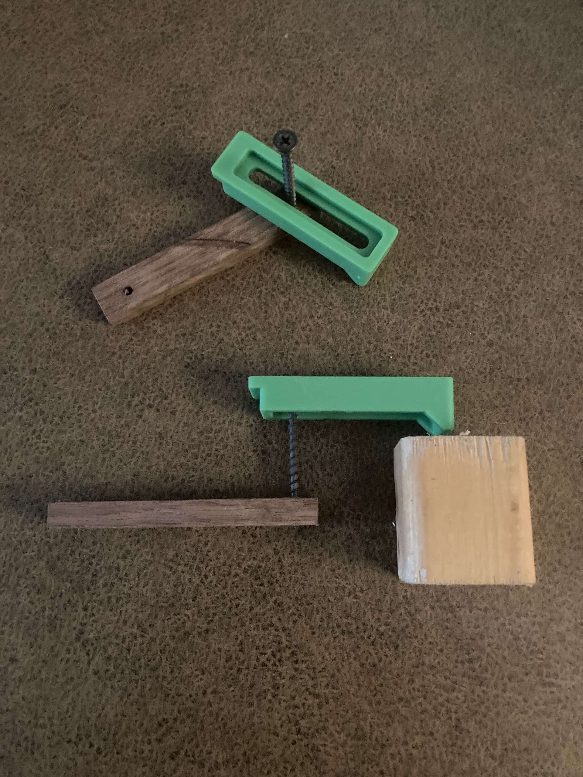

I recently had the same need to I rigged these up…
