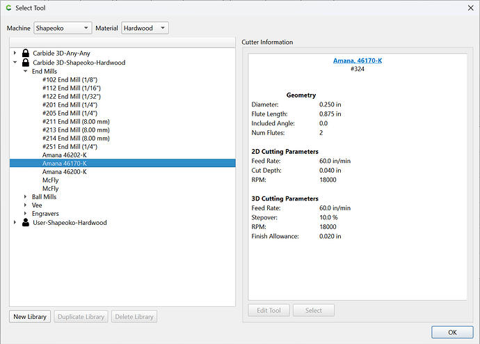

I have a Frost 1/4 compression bit SC250. I use it for my contour cuts when I’m cut through material. The site says it’s recommended speed for solid wood is 9100mm/min at a depth per pass of .455in or roughly 11.5mm. I run it at 2500mm/min with a depth per pass of 3mm. Question is can the 5.1 Pro with 65mm spindle handle that high speed or are those speeds and feeds for industrial machines. I’d love to speed up my cut times across the board. Also can the mashine also handle IDC’s “Beast” at those speeds?
Such feeds and speeds are for heavy/industrial machines.
We sell two compression tools:
The Amana #46170-K .25" 2 flute compression cutter (numbered as #324)
which in hardwood is set at:
and the #214:
which may serve as a (quite conservative) starting point.
We do have a video series on feeds and speeds:
and our own Julien wrote up:
which should inform testing and arriving at settings suitable to your machine and selected material.

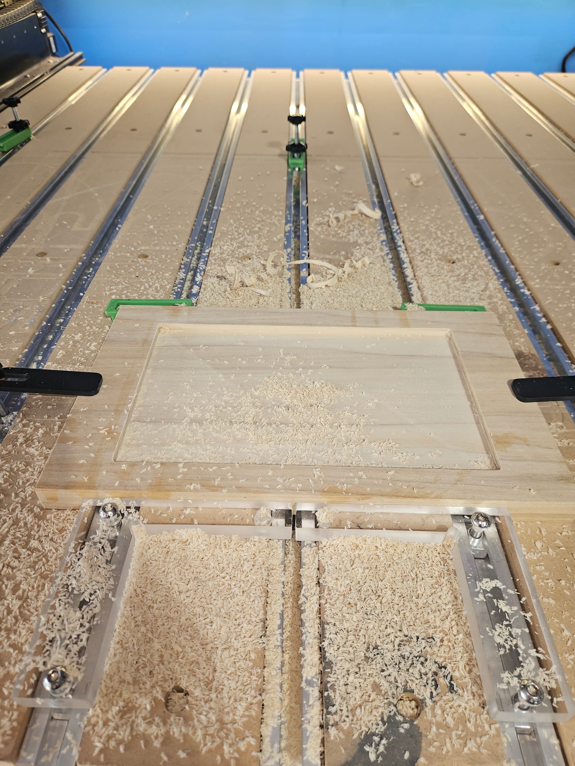

Using the above feeds and speeds article, I did my best at the formulas. Getting chipload, rpms, feedrate, DOC and WOC this i what I got.
And this is the result…
I think the test cut did well. The longer strips of wood…is that good, bad, or ugly? Any tweaks to my numbers above to improve?
Chips are better than dust
Looks good to me as a first test.
If stringing becomes a problem I usually either use a Facing or series of contour line toolpaths at 90 degrees to the wood grain for the roughing pass, then the finishing toolpath can be w/ the grain.
Long stringy wood cuttings can also be a result of the type of wood you are cutting. Pine and Oak can be stringy
