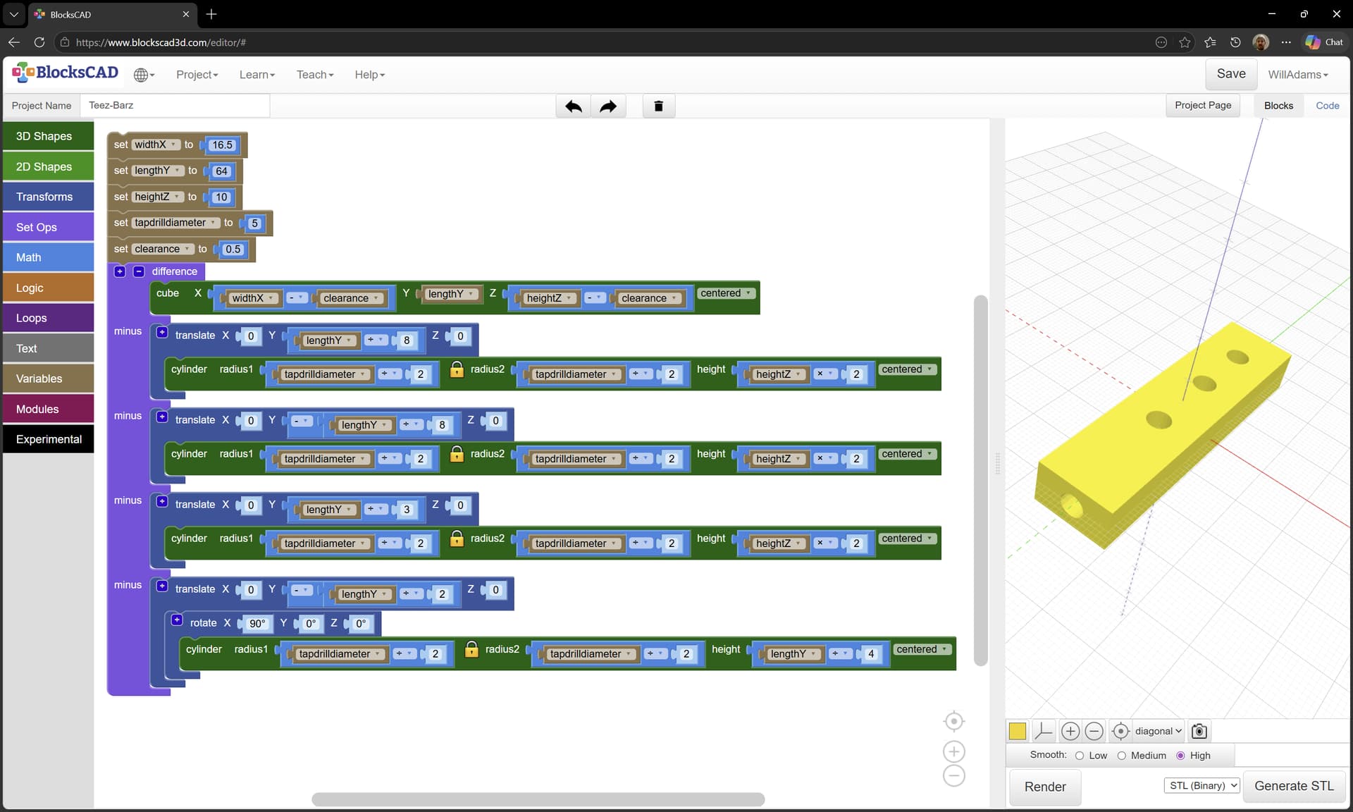

Ages ago, I bought some steel bar stock intending to make a Teez-Nutz alternative (Tee-bars?) which would afford two options:
  • threads at the end horizontally
  • threads at the end vertically
it’s a pretty obvious solution, something like:
https://www.blockscad3d.com/community/projects/2107574

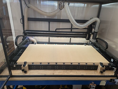

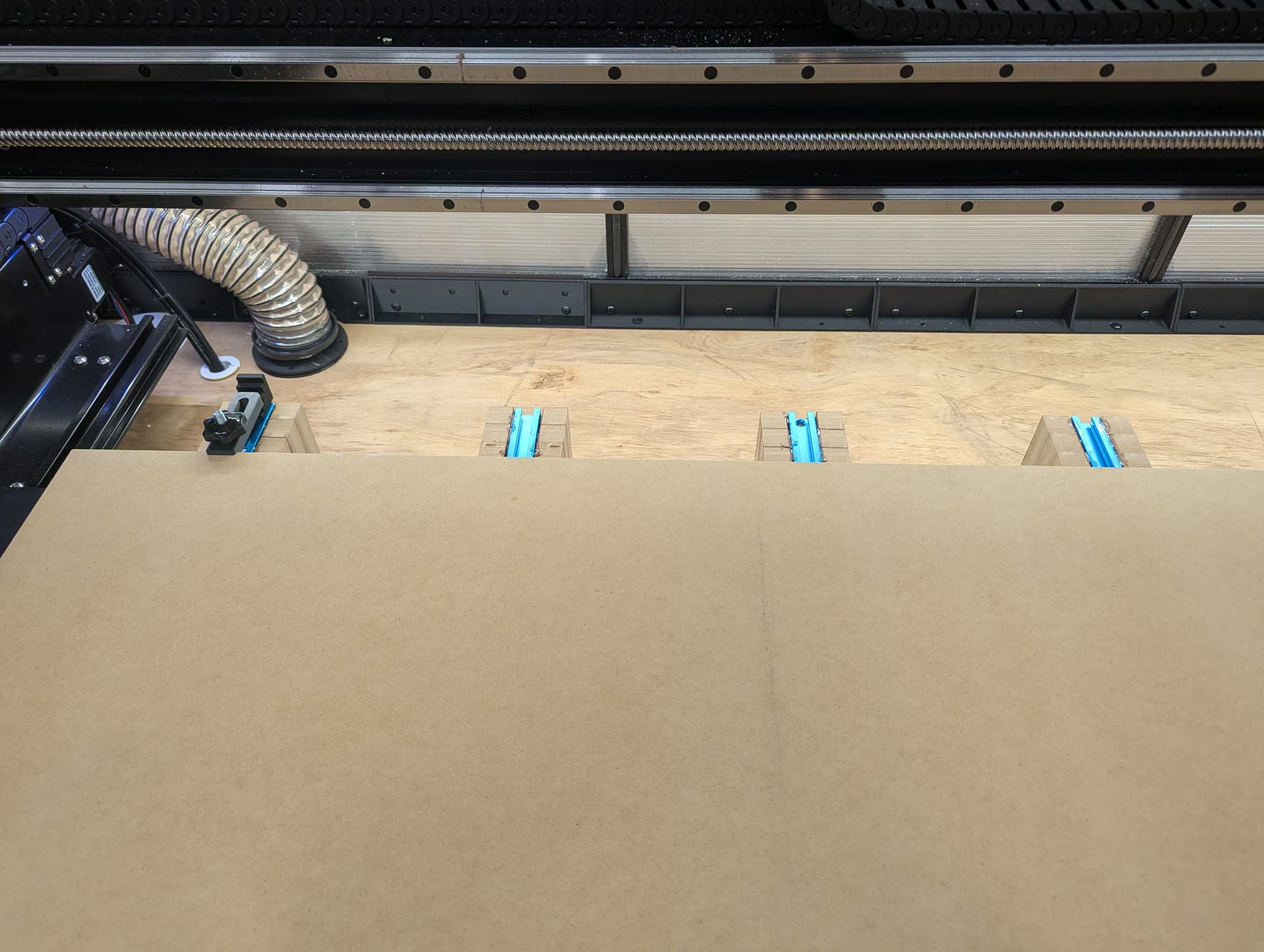

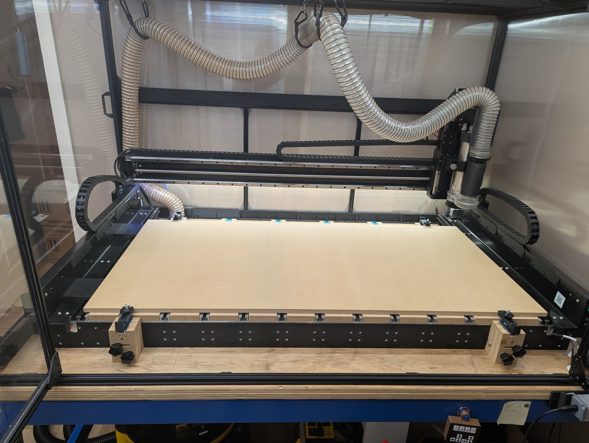

It took me a while to sort out how to hold 2’ x 4’ sheets of MDF or ply with my new 5.1 base, but I finally settled on something pretty simple:
I laminated 3 pieces of MDF together and slotted out room for a regular bit of T-track on top of each that I screwed and expoxied in. The three thickness of the MDF give the T-track enough length to let me clamp down the back and front edges of the stock. The only T-track bolts I could find were 1/4-20 so I had to print the clamps with a wider slot in them, but that wasn’t a big deal. I made enough extensions to place them every other set of mounting holes in the back because I can’t easily get to the back of the machine without rolling it away from the wall. They’re completely out of the way so it’s fine to just leave them there. I only screw in the front extensions when I need them for a sheet.
-M.
Looks very useful. Great idea.
