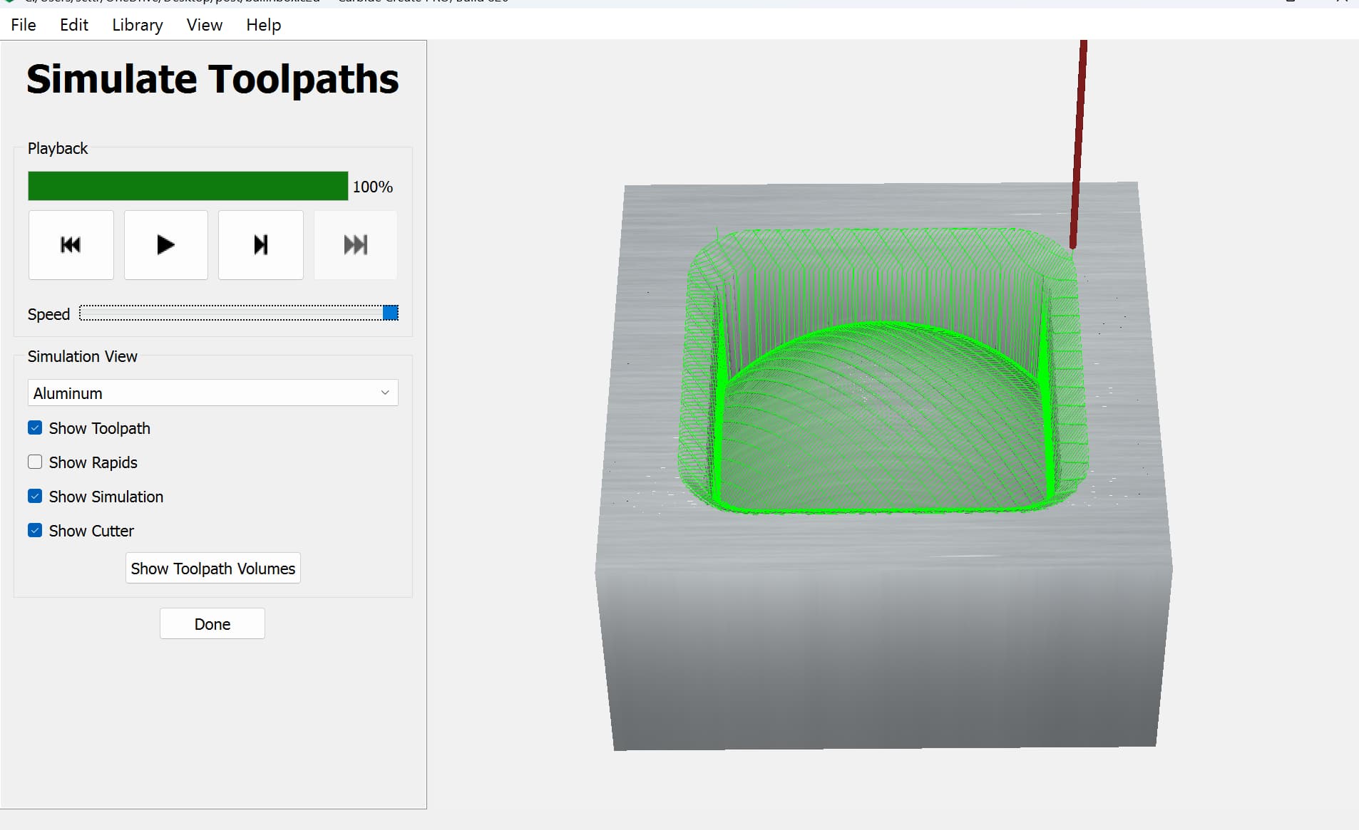

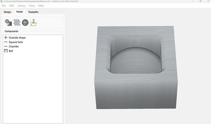

Here is a great little project that gives some insight to thinking in 3 dimensions, modelling only 2 geometries, and ends with a toy that people are compelled to pick up and study.
ballinbox.c2d (1.8 MB)

The key to this is work holding. You machine 6 sides and need a good zero. I included the file, but doing your own modelling is great practice.
Very cool. May have to give that a whirl.

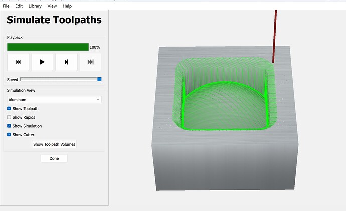

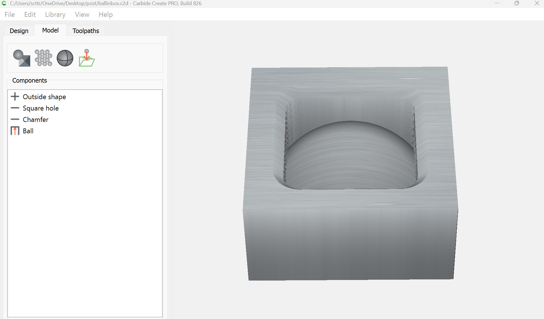

I noticed your stock size is 1.5" in X and Y but the Z height is .750". Shouldn’t the stock be perfectly square? What am I missing?
You are correct, however you are machining all sides and the software doesn’t know that. That’s why I mentioned “thinking in 3D.”
One only cuts half-way through with each operation — the bottom half will be cut in successive operations.
So the stock is actually 1.5" square, correct?
Yes sir. It only cuts half of the geometry on each operation.

The step over on the third tool path with the .25 mm TBN didn’t seem right. The file had .050", I changed it to .005".

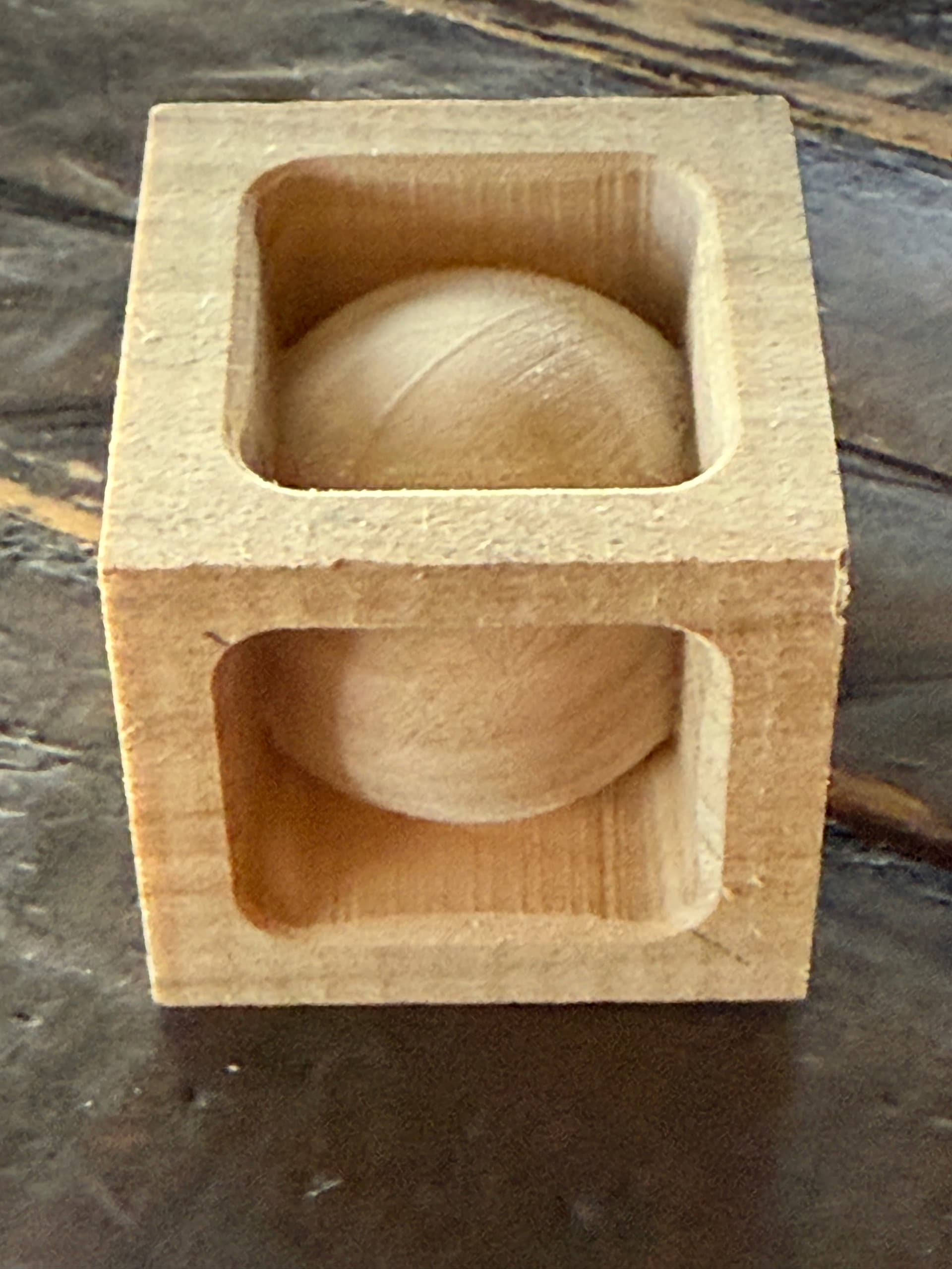

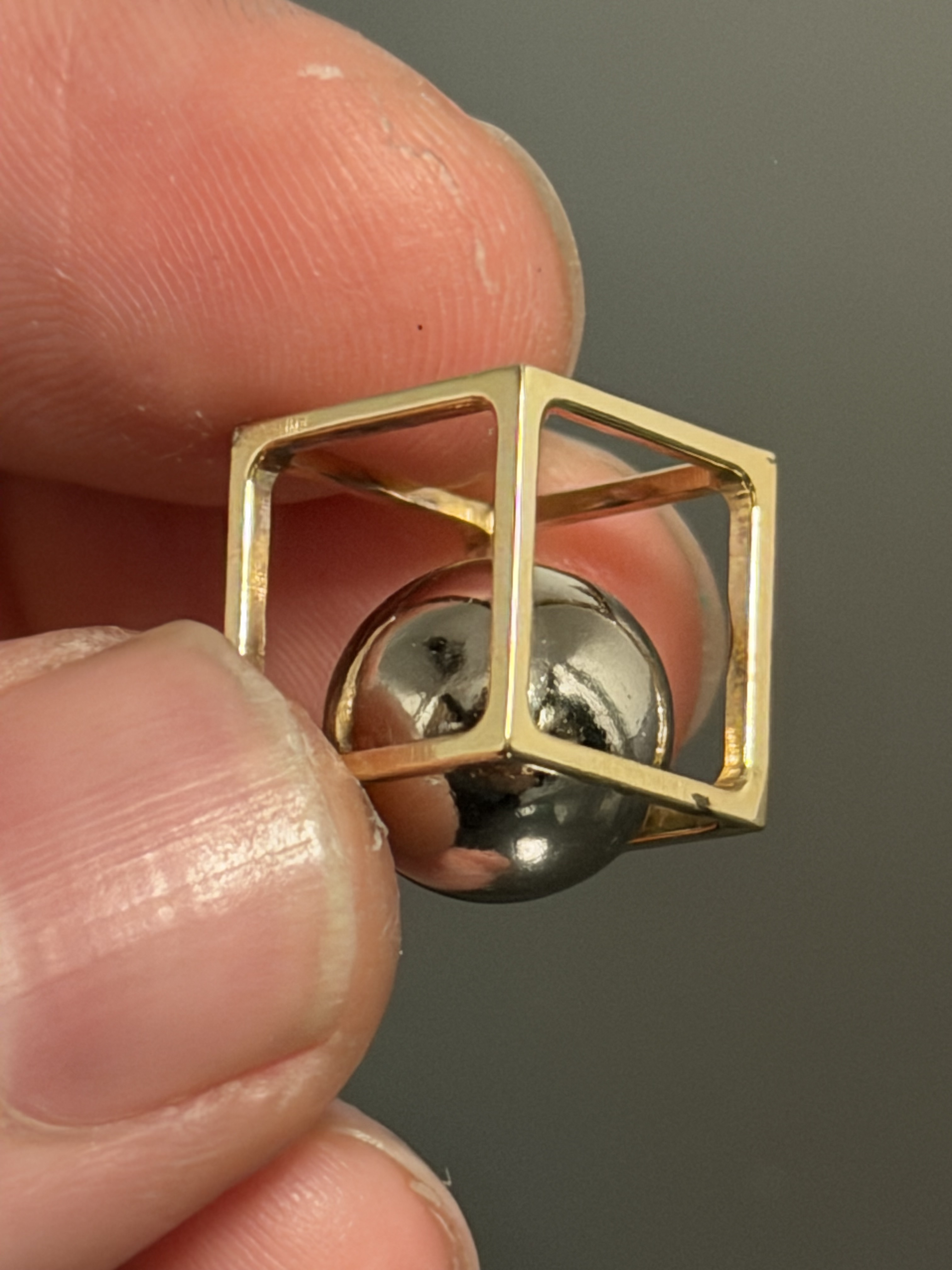

I must have done something wrong, mine doesn’t look anything like yours :face_with_spiral_eyes:
@HeuristicBishop
Yep, you used the metal polish instead of the Danish oil……. You can tell by the mirror finish!!
@Ed.E

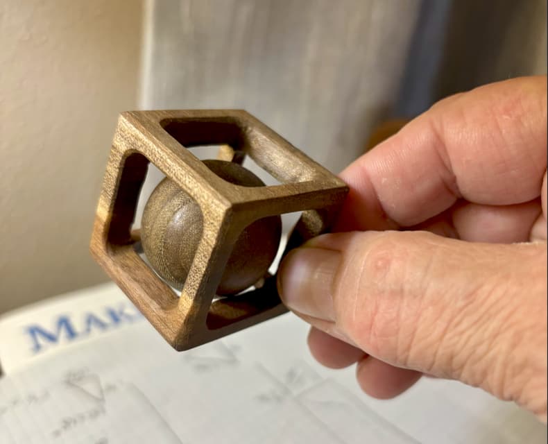

That looks great! I.m gonna have to try this now!
I guess you did not RTFM . What a surprise.
Beautiful work

I think I have a holding fixture figured out to hold the ball and cage for the last side where the ball is cut loose. I’ll have to test cut it, probably 3 times. :roll_eyes:
