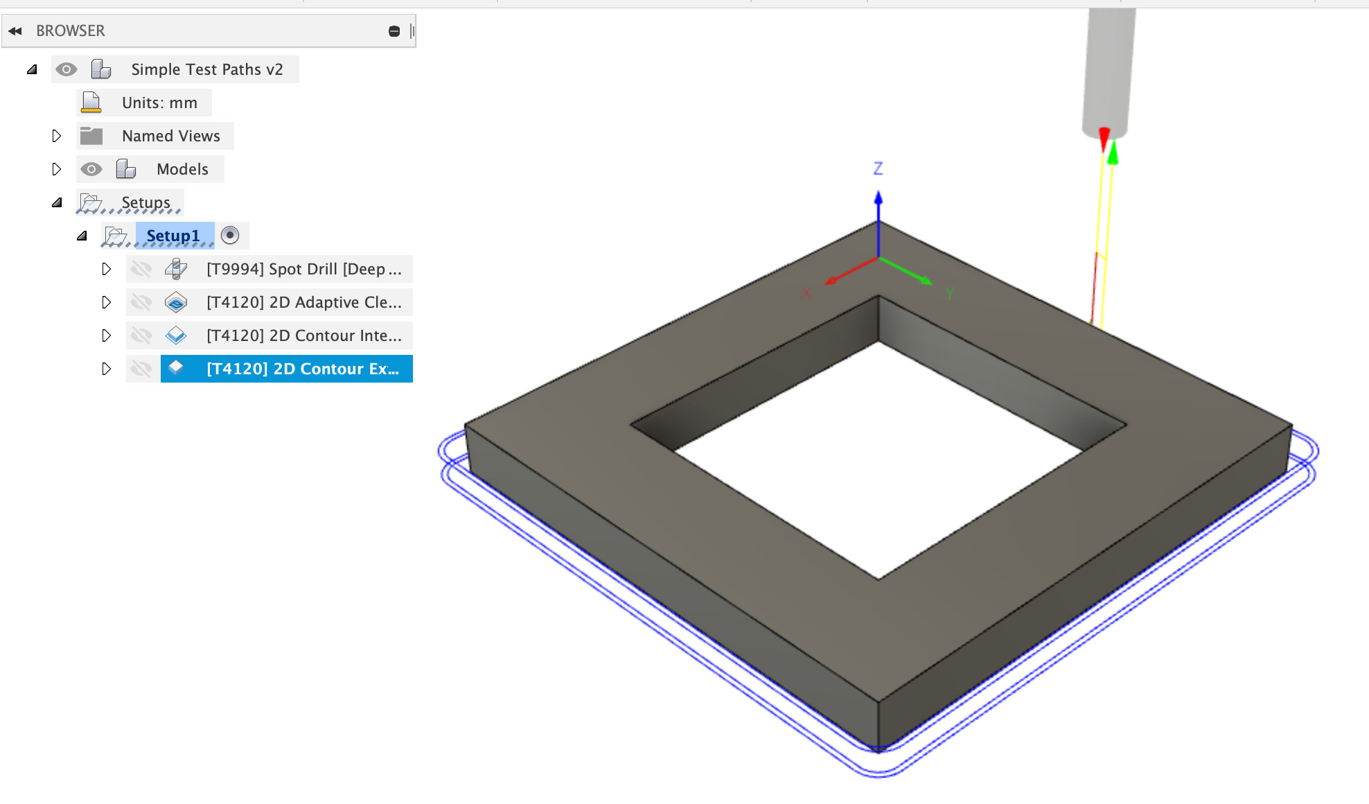

It seems that the Autodesk plan to make Fusion unusable without a license is going splendidly well, at least for me. Can anyone spot something I’m doing wrong here?
Since the “update” I now get this when I try to start a job in Carbide Motion generated in Fusion 360 using a drilling toolpath;
Here’s the intro to the GCode, with the helpful “we broke it” note from the Fusion team;

Whereas a toolpath generated before the “upgrade” looks like this;

So, it seems that Autodesk has decided to sabotage users by setting the feedrate to Zero to ensure that the job takes infinite time.
Editing the bold lines to remove the F0 removes the Autodesk F-You and the job seems to run.
Thoughts from folks who know more about GCode?
