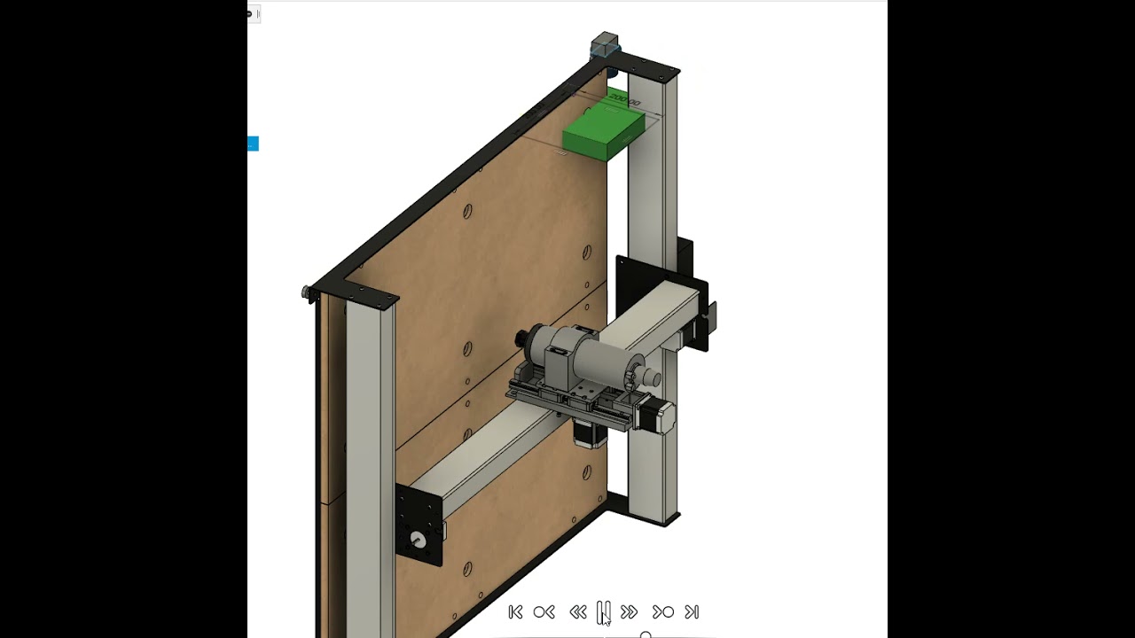

But I’m not doing it right (yet), and the simulation is an epic fail so far:
First off, the machine is oriented correctly when in machine builder (as illustrated in my previous video), with the X/Y/Z axes as one would expect. But still, when I select the machine for the simulation, it shows up oriented like this (which is how it WAS oriented in the original model, but then I rotated it in machine builder). That’s mystery #1.
Mystery #2 is why the simulation does not move anything on the machine model, and rather moves the stock. I’m sure it’s something I did, and I’ll probably post on the Autodesk forum, just not tonight.

@Julien The key for me was realizing that I had to drag axes to the spindle on the machine definitions. Least intuitive thing I’ve ever done.
If it’s this, then yes
Ha. Would never have figured that out. Let’s see if the Autodesk support guy spots it immediately too.
When your own support team can’t figure out how to use your new feature you know you’ve got a UX problem …
Nope…
Here’s the weird, non-intuitive part that needed to be changed. Who knew you could drag and drop the axes? They all need to be moved to “Spindle” which makes sense (once you get past the UI) as we don’t use a moving table on our gantry style machines.

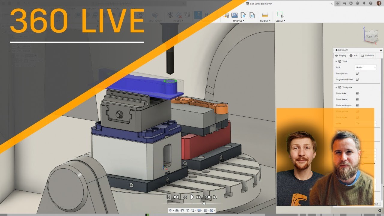

There’s an interesting live stream recording discussing the machine simulation too
Promisingly they state several times that they //intend// to keep machine simulation in the basic, available to all users, part of Fusion. Depressingly they also make it clear that such decisions are above their pay grade.
