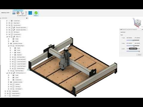

For the machine builder: Fusion 360 Machine Simulation - Machine Builder - YouTube

Well I have now had time to watch that video, and I must say this is tempting, quite a leap from the previous machine configuration feature which was pretty much useless.
The coolness factor alone of previewing the execution of a job and see the virtual Shapeoko move while it cuts makes it worth trying

So, that’s where I am
  • imported Liam’s Shapeoko XXL model
  • activated the Machine Builder features (in the Preferences / Preview features)
  • created a custom machine in Machine Builder: it’s still a little buggy, and I could not for the life of me figure out how to use the “offset” fields, but at this point the machine seems to move as expected
  • so I proceeded to try it and…got an error machine that the post processor must have MACHINE_SIMULATION_CAPABILITY added to it. Which led me to that page on how to do it, but it’s getting late and that will be for another day (and will most probably involve calling @neilferreri for help)
I’ll try to see this through, because this new feature AND the ability to model fixtures (think clamps) and preview a full job showing the machine moving around and cutting, and automatically detecting collisions, that would (will) be way cool

Turns out it was a known bug (this is a preview after all) and the unmodified machine definition was cached/not refreshed hence the error. So I have a modified post that’'s compatible, but now the simulation has the machine in the wrong orientation and it’s moving the whole machine around the piece. My test file is so messy right now that I won’t share it just yet, I need to restart from a clean state and will share then
Moving parts selection is also kinda buggy, I had to add the (~60) individual parts one by one down to the last screw
I realized the same. I couldn’t get the XZ assembly to move with the Y.
