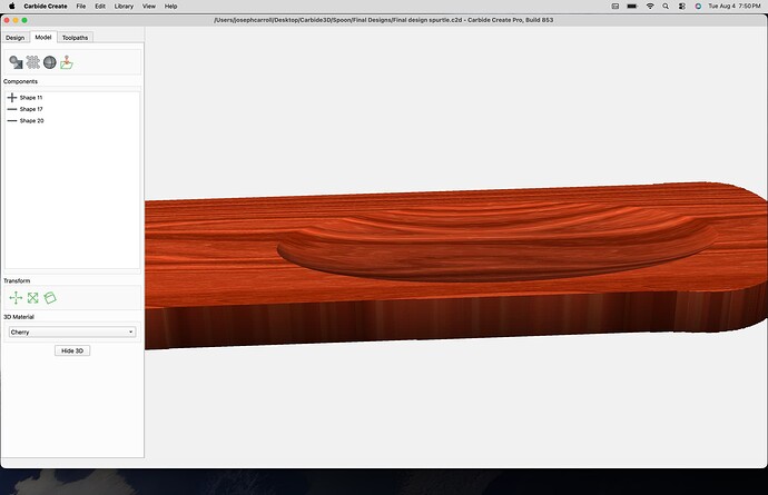

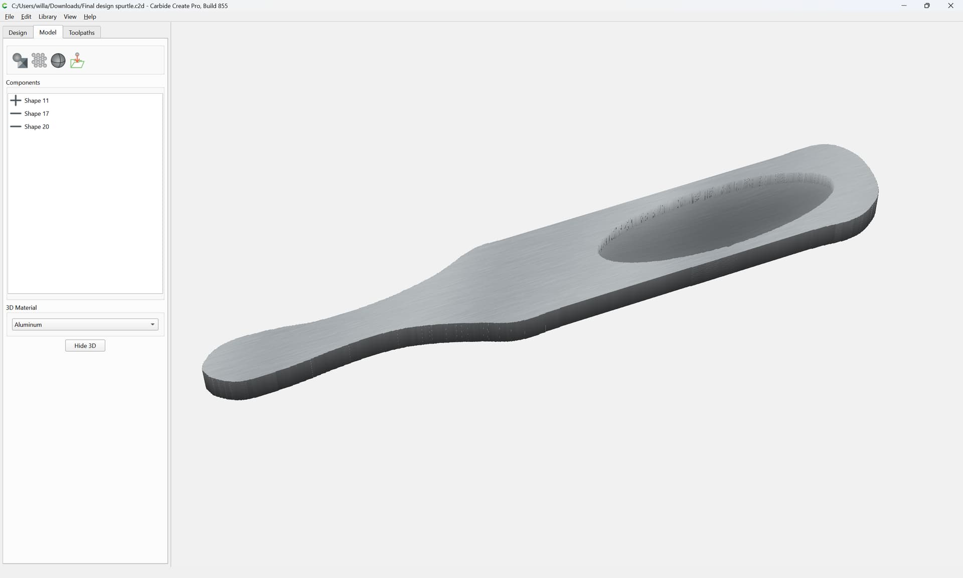

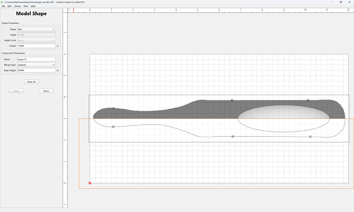

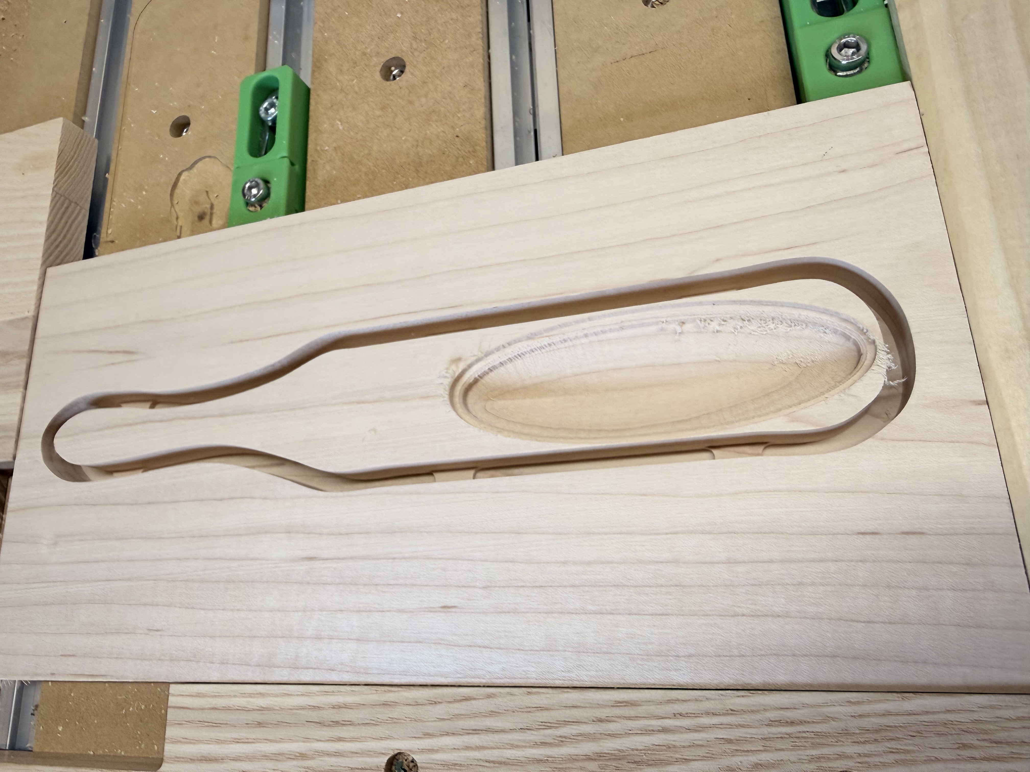

I’m trying to get a truly round bottom on this carve. What I wind up with is two sides meeting down the bottom with a defining line in the middle of the scoop. More like a V shape. Does this have anything to do with the angle in toolpath setting? Is that due to the elongated shape? Any help appreciated.

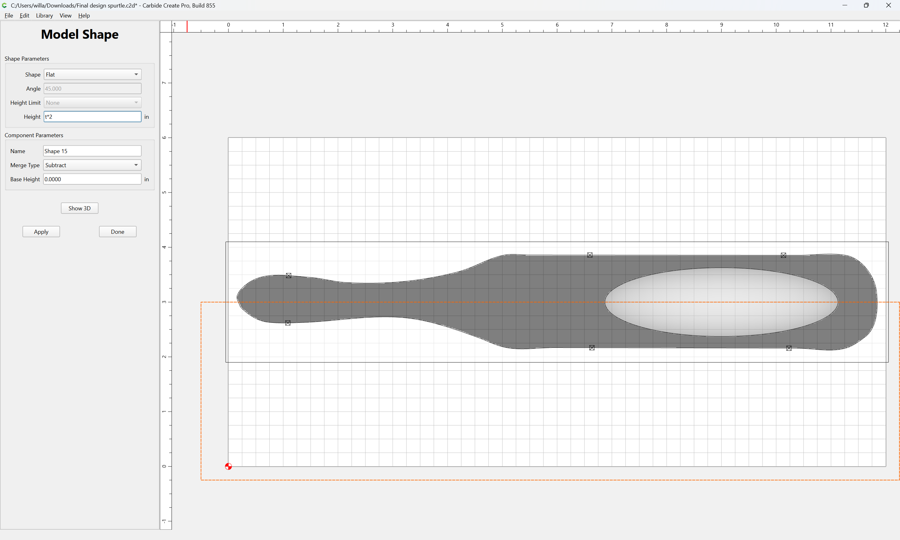

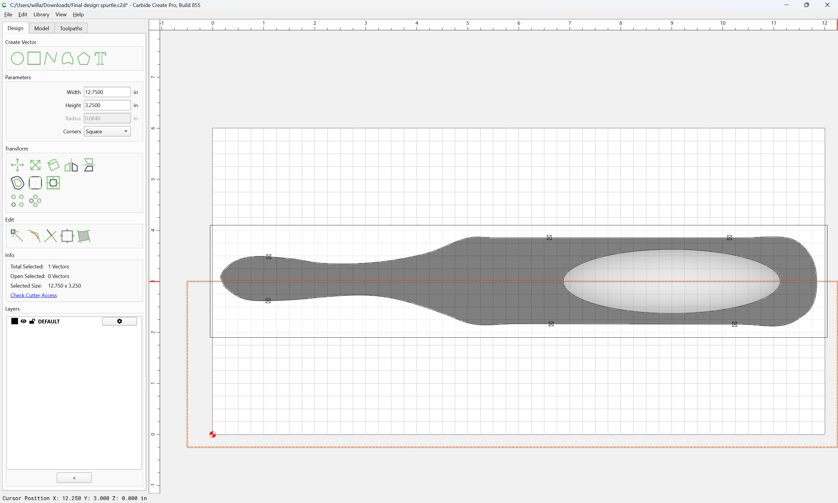

Here is the file in question:

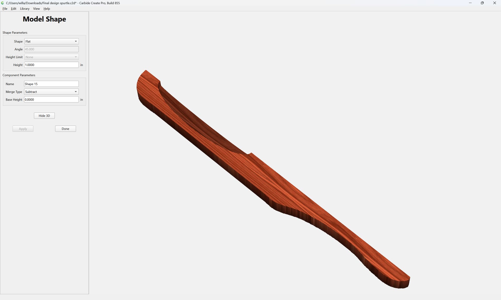

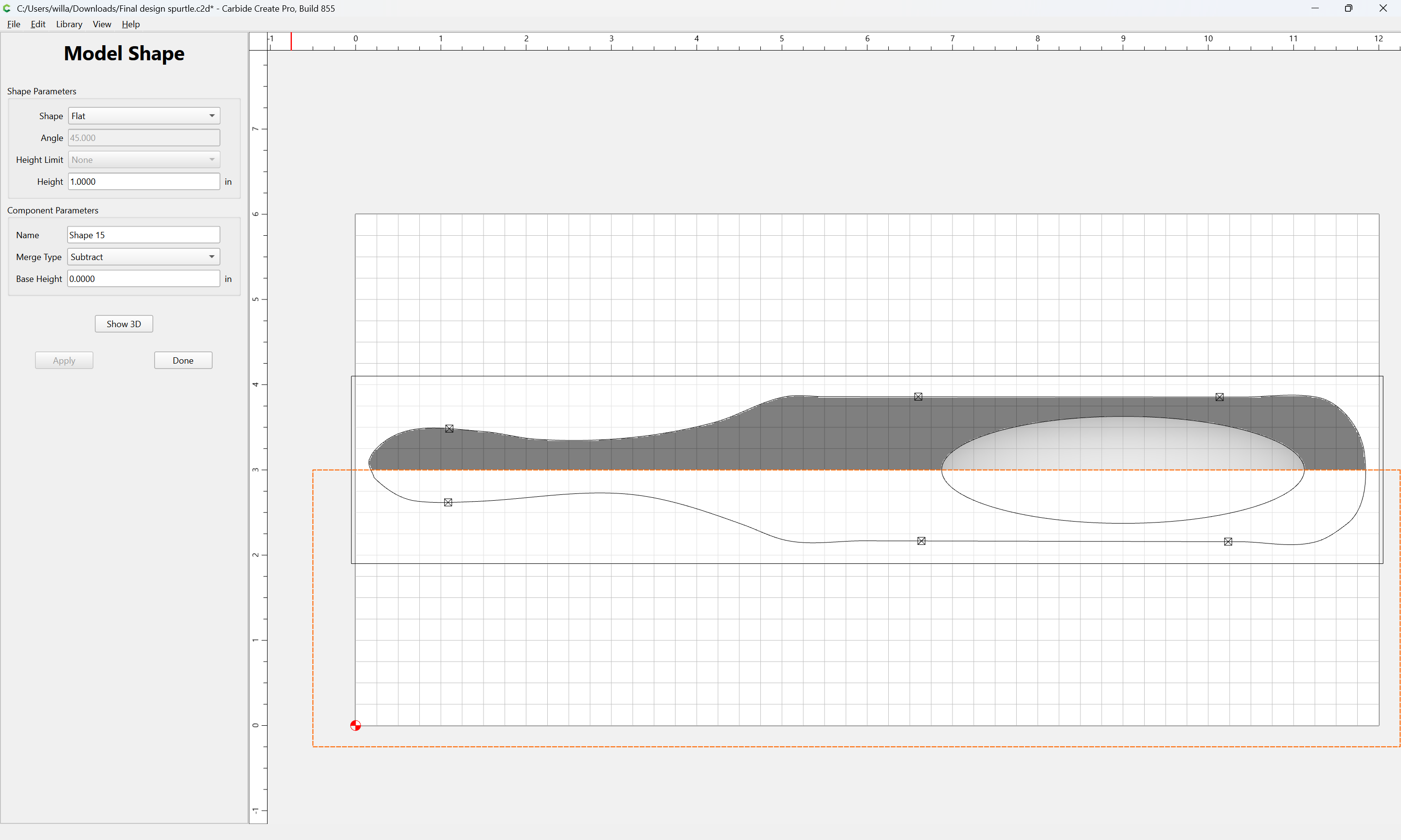

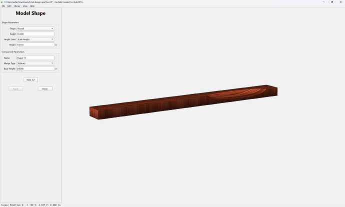

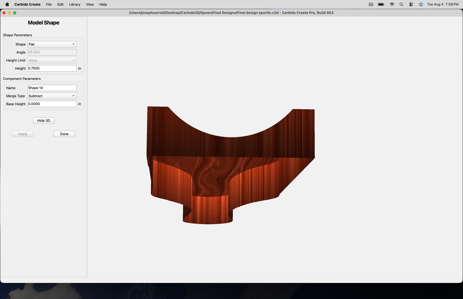

and if one slices it in half:
One can see that it has straight sides and is only rounded along the bottom. IME, such tools have a shallow/gently rounded form, so if we disable the subtractions:

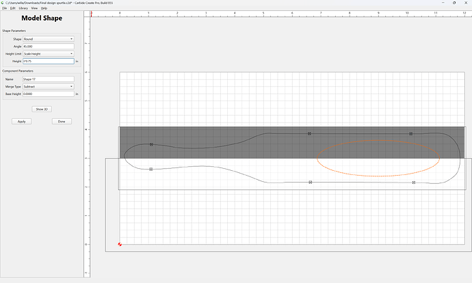

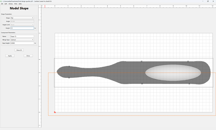

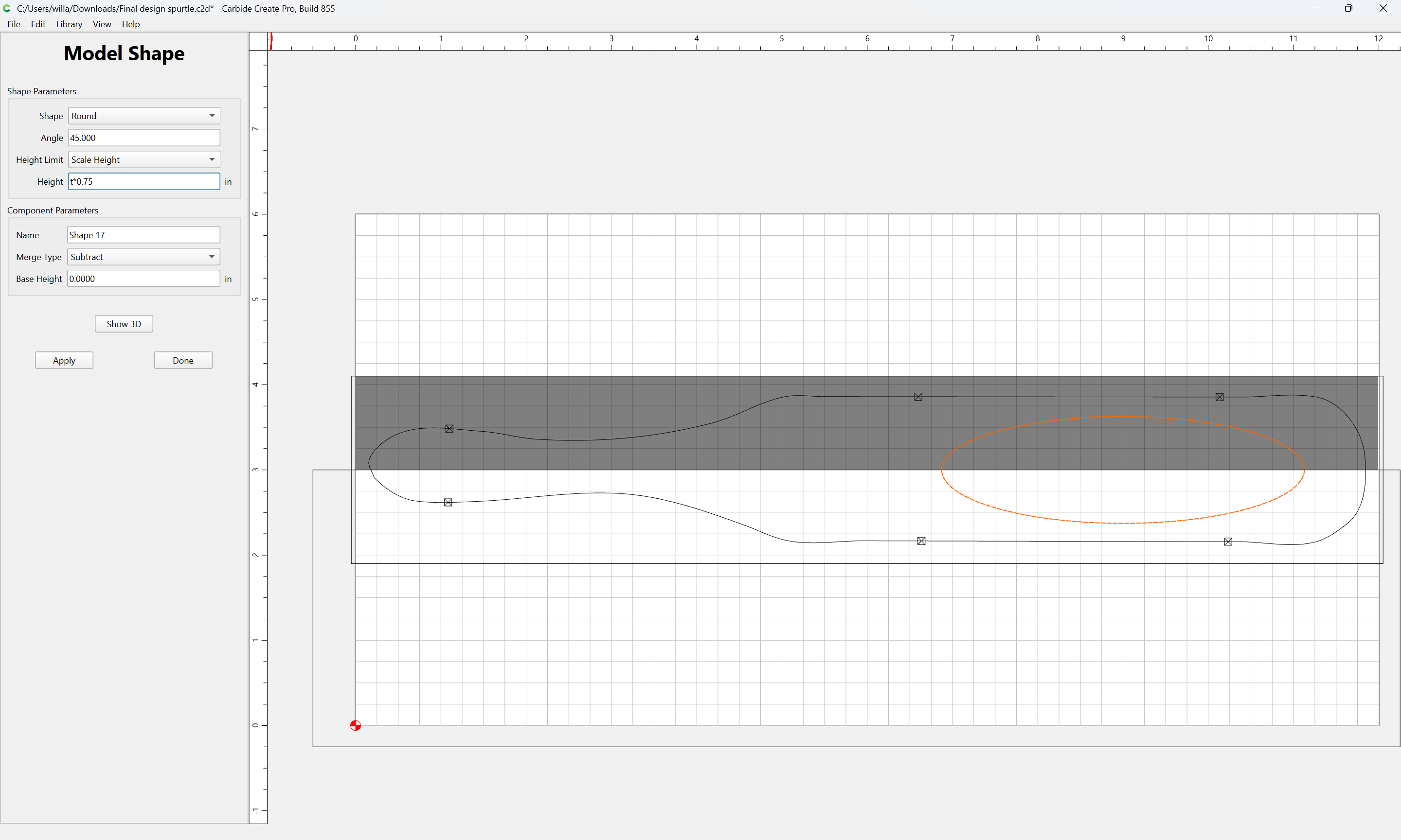

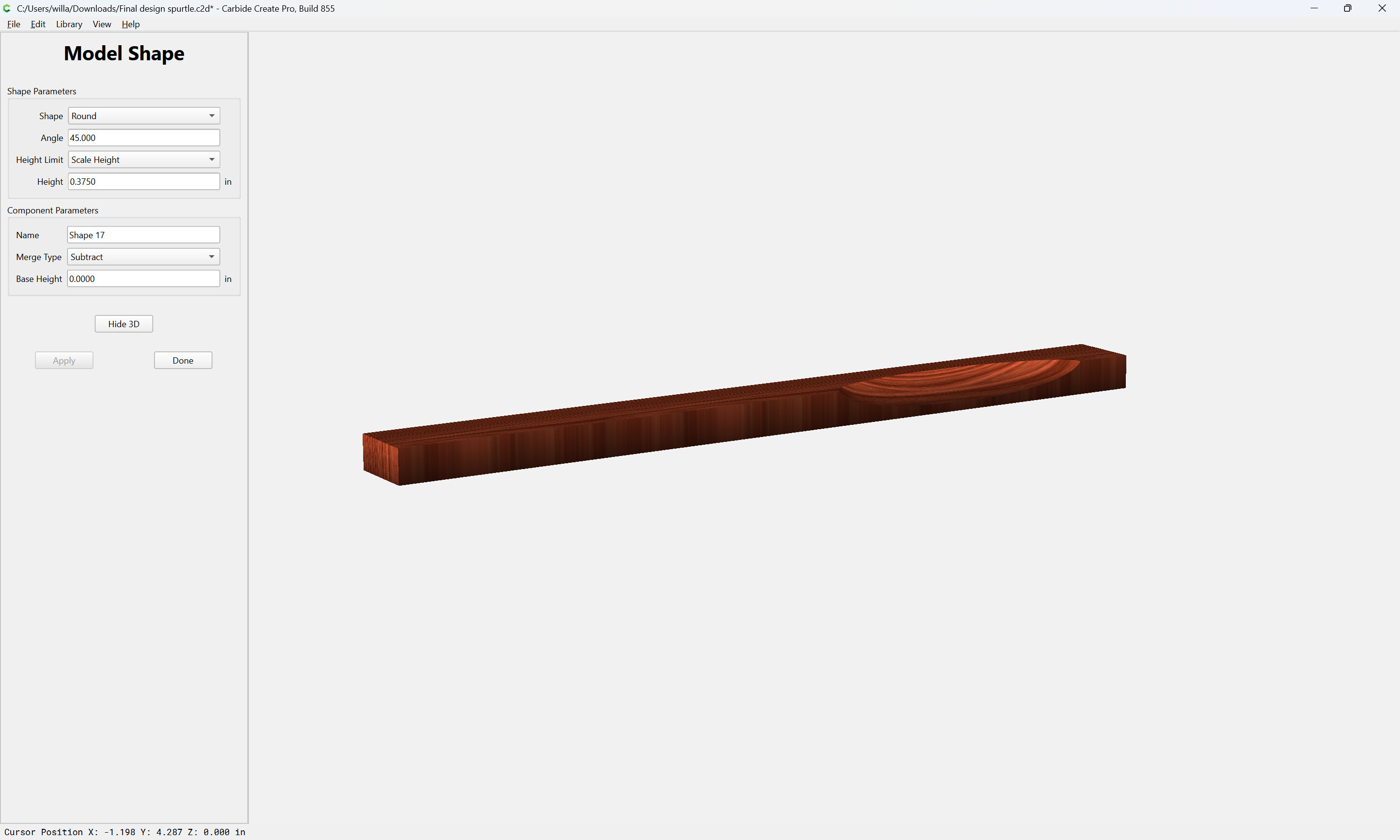

Then add in a subtraction which is rounded:

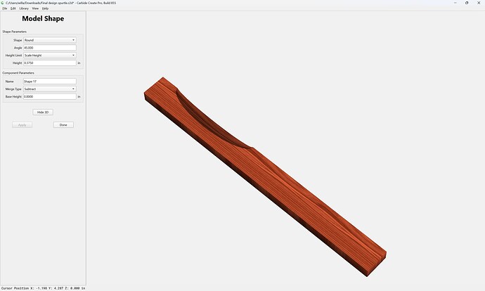

then the form can be made more rounded/shallow:
Altering the angle and depth and the setting for Height Limit should afford control over the shape of the rounding. Once one is satisfied, disable the half subtraction element.

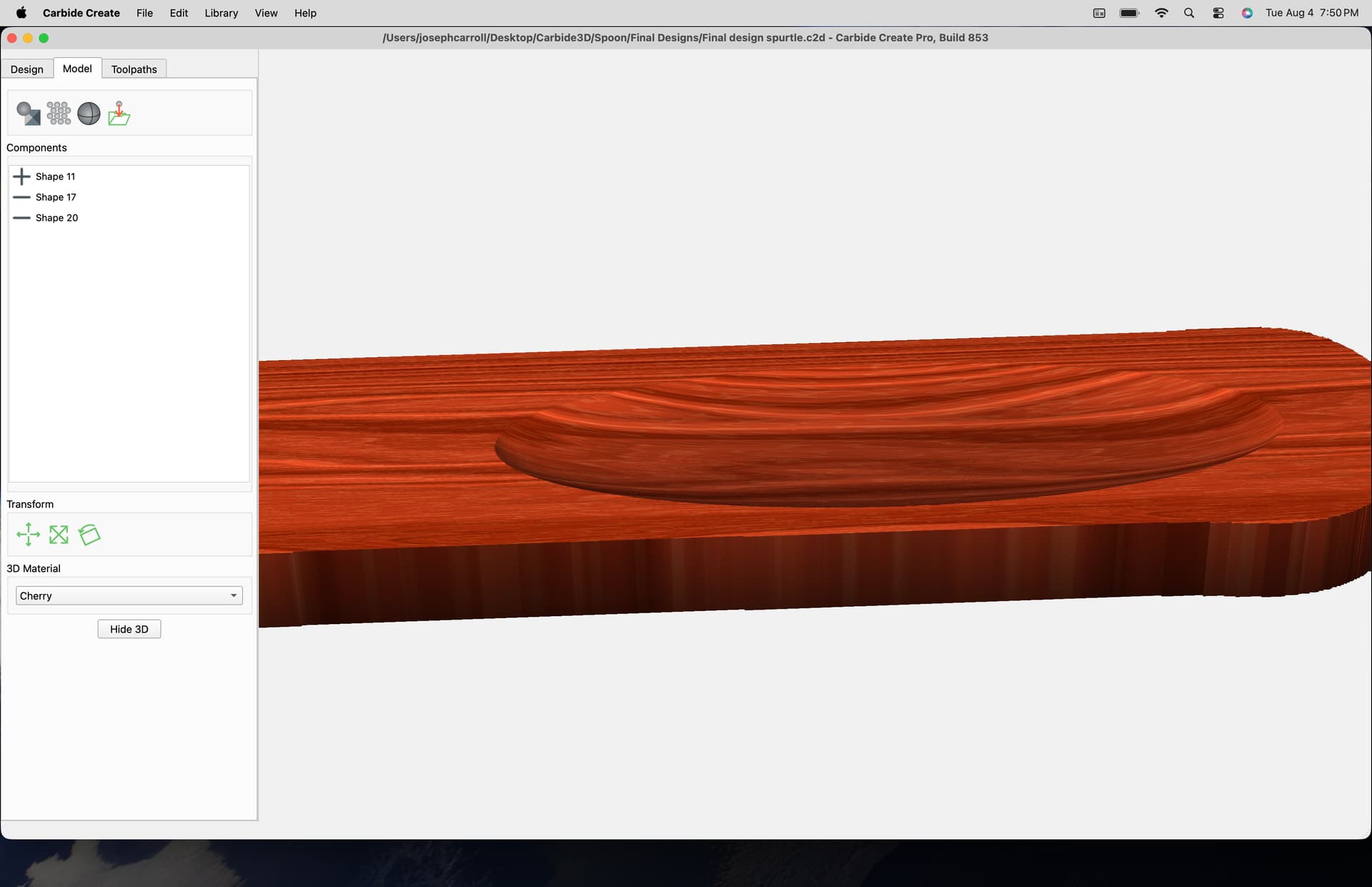

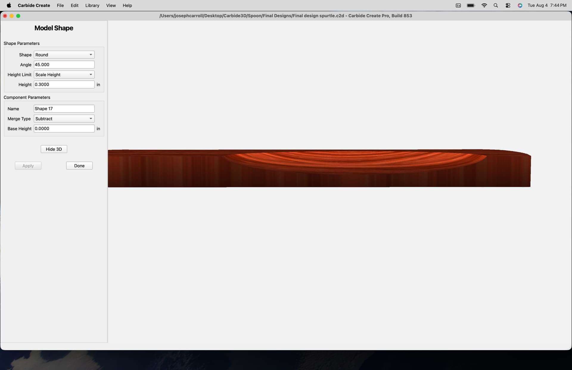

Well Will, you’ve done it again. Thank you. I followed your advice and the spoon now looks like I would like in the model. I took a cross section both ways just to be sure.
