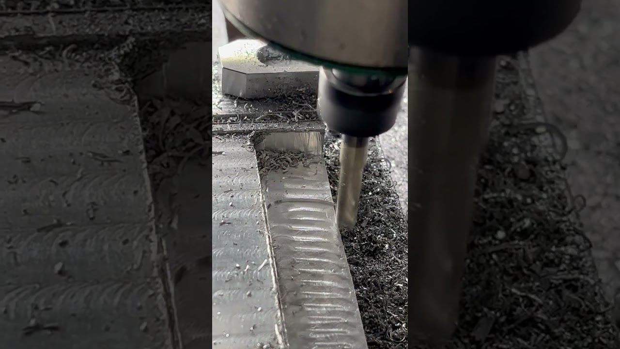

Started with a pretty conservative cut since I didn’t know how it would perform at all going the correct direction :joy: This is 60% WOC, 0.6mm DOC, 8.4k RPM and 0.003" chip load.
It cuts, isn’t vibrating my entire apartment, and actually isn’t that loud! There’s chatter, but waaaaaay less. Used 150% feed override after this and its still cutting fine.
Thank you! That video was super helpful! Millyzer looks super useful def going to buy that. I think just a bit of tweaking to minimize the chatter is all it really needs, then im guessing it’ll be pretty fine with most cuts.
