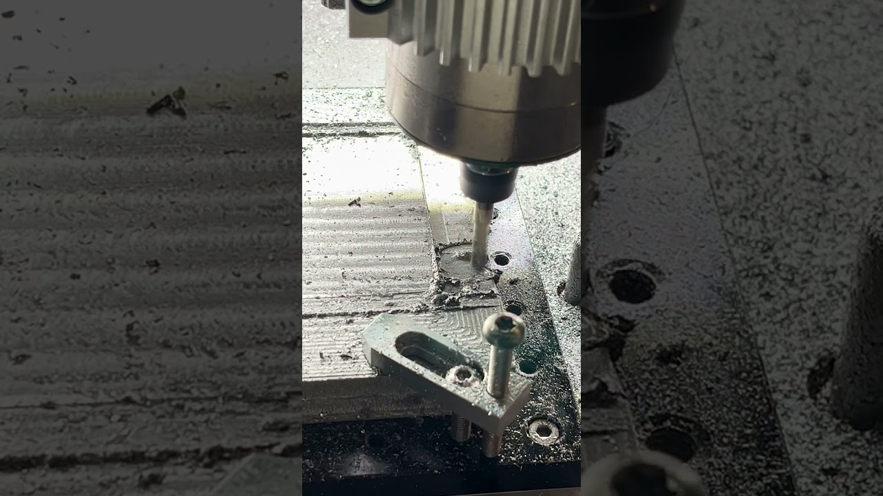

Tried out a slotting toolpath using these settings based off the video and HSAdvisor:
Screenshot 2023-09-20 104905
Thought it was going well until I realized I was missing a huge amount of steps on the Z axis. When I stopped it the machine was reporting it was at Z -10.92mm, measured it at actually -1.5mm
Have you got the collet tight enough? It could be the cutter rising up. [edit] actually your plunge feed rate looks quite high and it might be going down quicker than it can remove material.
It’s as tight as I can make it :sweat_smile:
Is there a general guideline for plunge rate? I was using whatever HSMAdvisor split out for it.
I think it actually is doing that. I might have been imagining it but I ran a simple toolpath with 0.4mm DOC and I think I could see the spindle+cutter pop up slightly when the cut started. It definitely did not take off 0.4mm either.
Use something to measure between the cutter tip and the collet nut before and after a test cut. Or put a witness mark on the shank of the cutter where it meets the collet.
Is it the right collet? i.e. a 3mm cutter in an 1/8th inch collet could slip even if it seems tight.
With a good fitting collet there should be no play in the fitting even before you tighten it.
Also check for debris in the collet which could stop it from snugging up.
Maybe also put a witness mark on the spindle next to the clamp to make sure that isn’t slipping either.
Ill try that! Its a 1/8 cutter and 1/8 collet, havent had this problem before. Maybe it is the clamp not tight enough :thinking:

Still seems to struggle hard with plunging/ramps though

Your stepover looks very small. The way the material is curling up at the cutting face suggests it is rubbing and pushing it out of the way rather than cutting a chip off; what does come off looks dust like. Even with the stock spindle I get nice curly chips albeit very tiny ones :slight_smile:
I would increase stepover (called optimal load in an adaptive path) to around 40% of the cutter diameter.
I would also take a very close look at your cutter and check it hasn’t been chiped/blunted and doesn’t have any material welded to it (if it has you may be able to clean it in lye).
The way those chips are curling and cutting makes me thing the endmill is dull or a downcut endmill made for wood.
:anguished: That’s a brand new 51377-Z Spiral ‘O’ Flute, Aluminum Cutting 1/4 Dia Up-Cut with ZrN Coating. I opened it like 5 minutes before the video :frowning_face: It’s not running right now, it still looks like new.
I’ve been using tap magic and it seems to turn the chips into a kinda gooey aluminum paint mess
This bracket is what I took off the top panel. Without it the sides and back were incredibly floppy
OK, that’s good news. Probably just lack of stepover which is causing dust-like chips.

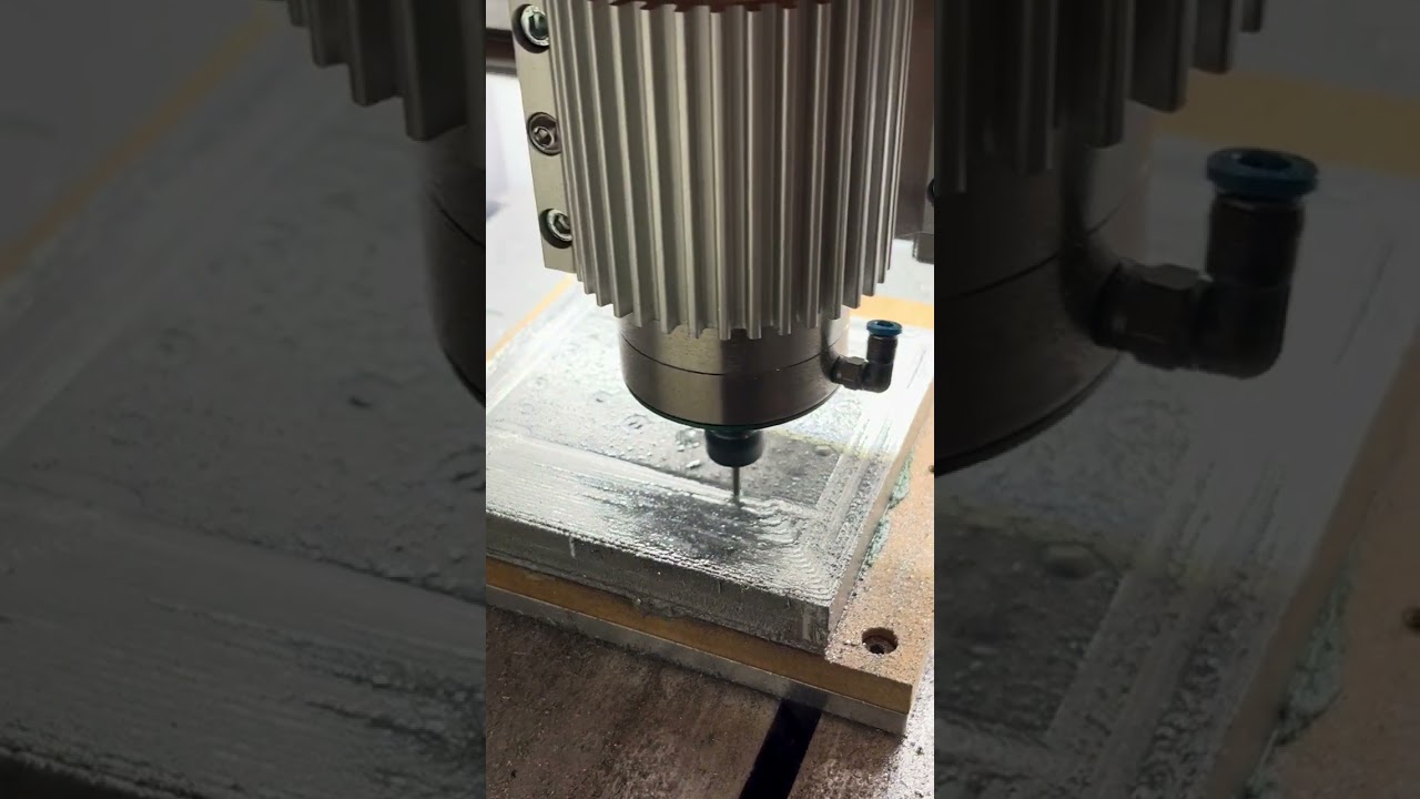

Tried out your suggestion of upping the stepover to 40%, seems to be going better so far. Its not a full step down since it picked up in the middle of the previous run.
Better, except the ramp right before the video vibrated my nomad so hard it actually moved the machine a couple inches forward.
These are settings:
Bit scared to have it do the full stepdown.
6061-T6511, this right here:
This spindle is creating a lot more vibrations in the machine than the stock one. I noticed the walls were floppy because I took the foam I put on the top off while it was running and the wall was vibing out
Edit: yea let it try the next stepdown and it shook the nomad about 3-4 inches forward, fairly sure it missed a lot of Z steps as well.
