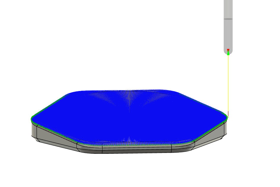

Oh man, a 0.170mm stepdown with a 0.2mm WOC and a really low feedrate? I mean, that’ll do it, but my laptop is currently having the time of its life calculating the 3D adaptive with those settings… For context, this is what I’m milling…

but if you want some photo & fusion evidence as to how well they work, here’s my f & s for a 1/8" 2 flute tool facing op. (i guess technically a 1/4" shank 1/8" 2 flute facing, now that im looking at the picture of my Nomad in action)
this maker coin/worry stone is approx 2" in diameter, and 1/2" thick, and was machined from a hexagonal piece of 6061 stock of that same diameter but just under 5/8" thick (hopefully that gives you an idea of the material that was removed.)
