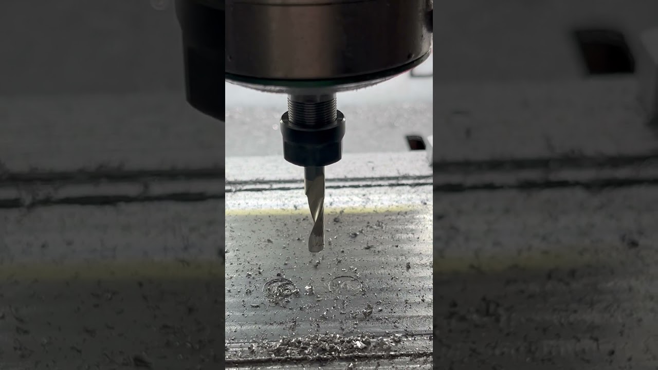

I guess the unsupported walls could resonate, very wise to put a stop to that.
Video looking like much a better cut, chipload calcs look more healthy too.
What is the actualy DOC in the video, clearly not 0.125" as shown in the calcs… :slight_smile:
The tap magic is causing the chips not to fly away and is probably causing some amount of re-cutting.
Do you have anything less viscous?
I always cut 6000 series dry or, if I’m going for a final facing pass then, a hint of alcohol mist.
I forgot to measure it :slightly_frowning_face: Up close it looked like maybe ~1-1.5mm.
I have some of this Ultra Lube aerosol, also have isopropyl and acetone laying around.
Would not use acetone … Everything nearby will melt, lol.
IPA is what I use.
I notice you reduced rpm and feed rate. Whilst this has maintained a correct chip load your surface speed is now quite low for a carbide tool on aluminum.
I think you are very close to a clean cut. I think with a tweak on lube and surface speed it will be great.
HSMAdvisor was giving me the very low rpm, decided to give it a try since this Spindle is rated to give 100% torque down to ~7k rpm I think it was.
Bumped it up based off this video. I know thats for the Shapeoko, but it seemed pretty conservative.
HSMAdvisor thinks this RPM is ridiculous lol. (I also upped the stepover a smidgen)
Going to get a short clip of this when I start it.

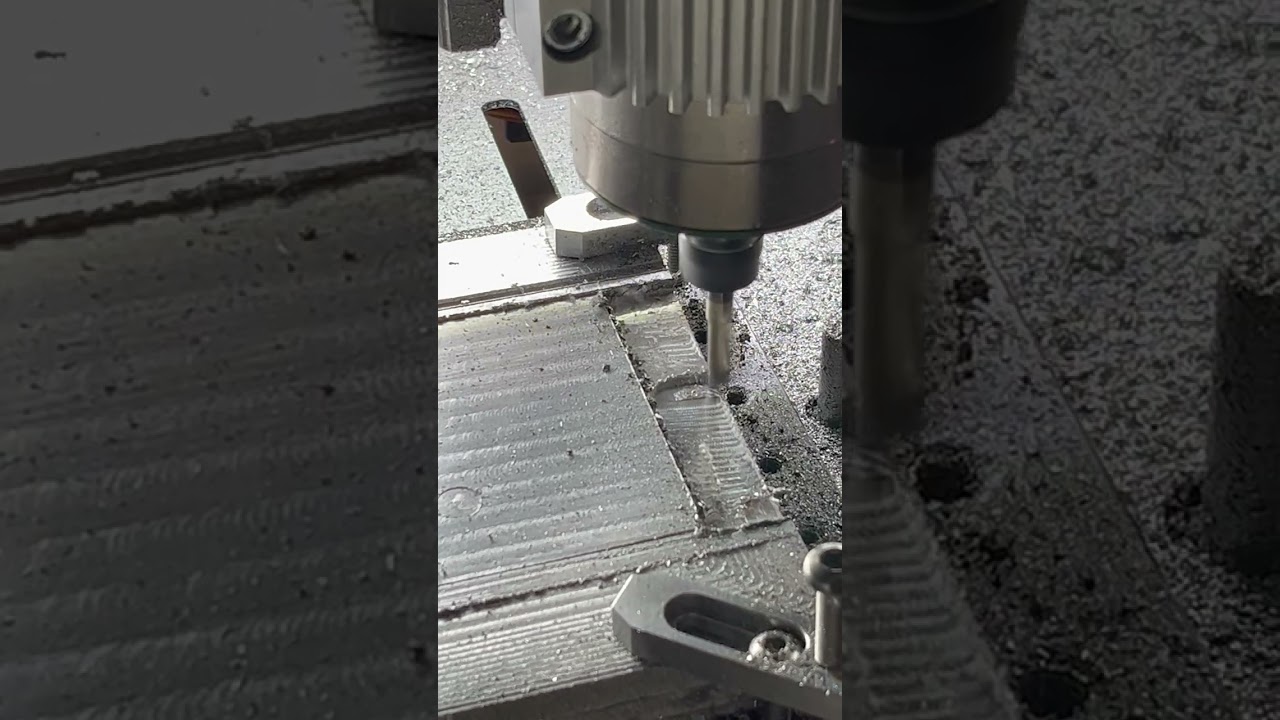

It’s certainly doing a lot better with iso and the new params. There’s still quite a massive amount of resonance that is probably making my neighbors hate me, but it doesn’t seem to be making the cut significantly worse. I’m probably going to need to reinforce this thing a lot to be able to handle the spindle.
Have you tried running a different endmill at all? If you have an 1/8th inch 2 flute I can give you feeds and speeds to try out that are proven to put almost a mirror down. That way we can rule out of its machine or endmill/feed speed based. Something is going on here because you should not be getting galling like that on a brand new endmill.
That does seem a lot better. I notice the resonance is slightly there when it is repositioning and the tool isn’t cutting on load so it could be something isn’t tight on the machine. I would definitely give Rob’s 2 flute params a go.
Looks like you have quite a DOC now, you could reduce that slightly.
Is the galling on the left of the cut from this cut or a previous attempt? The floor finish looks pretty smooth (please confirm)
In general I think you’re deflecting. You’ve basically removed the previous limit of spindle power and are now running up against the machine strength limit (and motion limits where you’re losing steps). Those numbers from HSM don’t make sense to me for the forces. If I can, I’ll check some other sources when I’m back at work tomorrow.
If you want to test it, I ran through a simple deflection test here:
A few more things.
Although adaptive toolpaths can make use of it, be careful with WOC/stepovers of less than half the bit diameter. It will cause chip thinning where you are cutting less than you calculated chipload. As an example your last listed HSM screen is 18KRPM at 36IPM with a 33.3% WOC/stepover. It’s calculating that as a 0.002" chipload. That is correct without chip thinning (36/18000/1 - IPM/RPM/Flutes). However, with chip thinning at a 33% stepover you are actually only cutting 0.00188" chipload. That’s not too far off. Let’s say though that we are using the 6% from your first HSM screen. Then your actual chip is only 0.00095", less than half.
That can greatly confuse matters if you are trying to come up with limits based on chipload. It may also explain some of the issues you are having as the smaller the chipload the hotter your cut will get. You could also be rubbing/grinding instead of cutting if you are not hitting the minimum for the material/tool. That will both increase the heat and the cutting forces.
Be careful with this. The max torque for an ER11 collet is 18 ft-lb (24Nm) for a standard nut and 12 ft-lb (16Nm) for a mini. If you go over this not only are you potentially causing damage but you may be inducing runout which will make matters worse.
Also since I’ve run into it a few time here recently… Are you snapping your collet into the nut before using it?
In general I’ve never seen a cutter that can’t do at least 600 SFM in 6061. That works out to ~18K for the 1/8" and 9K for the 1/4". Most decent cutters can do at least 1000 SFM which is ~30K for the 1/8" and 15K for the 1/4". Specialty cutters can go much higher than that depending on what they are shooting for.
Hope that helps. Let us know how it goes.
I do! I have a few of Amana’s 51830 55º Helix End Mill 1/8" that I can use.
That is from a previous attempt. I’ll lower the DOC a bit.
I love your pcb bits :heart: Ron spent a few hours with me a while ago helping me design a jig for double-sided pcbs.
That makes sense, going to try out this here:
I have separate nuts for all my collets so they are already snapped in, I make sure they are still snapped in though before I screw it on
Edit: That was prob one of the worst attempts, missed some Z steps and missed some X steps, which I didnt noticed until it plowed into the top of the model. Tweaked and tried again, still missing large amounts of X steps now. I think the 50% WOC brought that on
Seems like its going backwards after upping the WOC. This was with 40% stepover and .04" stepdown. Could watch it skip X axis steps as it went.
The plunge that happened after I didn’t notice the missed steps is on the bottom there, that was with 50% stepover and same stepdown.
That is what, 1mm DOC. Maybe back that off to see what happens.
Just looking back, your posting of fusion settings (adaptive 7) stepdown was in mm but HSMA calcs in inches.
I don’t see how 1mm could cut worse than 1.25mm in adaptive 7. There must be another issue. Or units finger trouble :wink:
Yeah, 1mm. I used both inches and mm :confounded: . Everyone typically talks about chip loads and feeds in inches so I’ve gotten used to those but I like to use mm for dimensions. I make sure I paste the right one into fusion. How much lower step down do you recommend? .6mm?
This is with 0.6mm DOC and 50% WOC, could watch the cutter bounce back every time it went it for a cut
