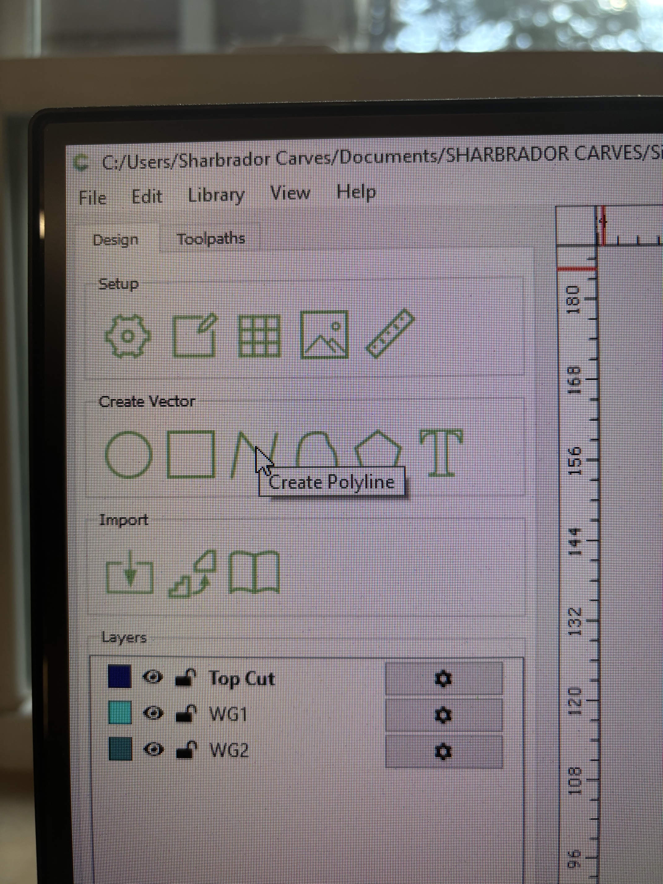

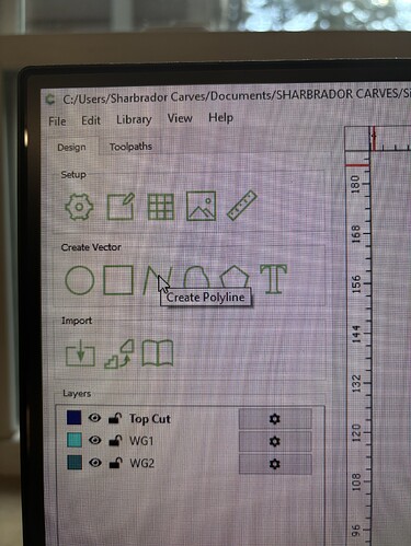

Hands down my number one request would be keyboard shortcuts for “Create Vector” options at a minimum and throughout the rest of CC if possible.
For example, instead of having to click on the “Create Polyline” there would be some kind of keyboard shortcut. When I have to create multiple vectors one right after the other using the same tool, it would save quite a bit of time to just have that shortcut in place.
I’m just used to them and use them constantly when working in other programs like Sketchup and Photoshop.
EDIT: Added in 818
