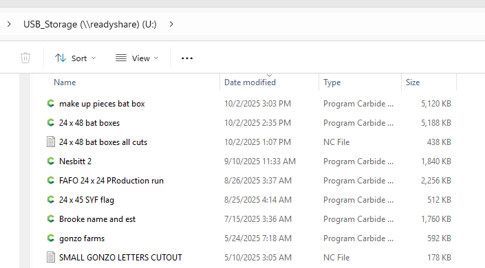

My Router has a USB port. I plugged in a thumb drive, noted the address, and I can access the file from any device connected to my wifi.
I set up a samba share on the PI that my windows design box can see. I simply save my files to that folder from the design box.

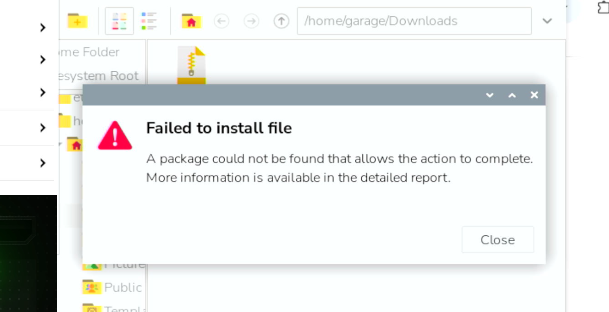

NEW ISSUE, cannot figure out how to get this to install on the pi, any input or something i missed?
Bring up the detailed report?
Perhaps the Pi OS needs to be updated?
Or maybe it’s a permissions issue… Linux is crazy frustrating at times with the way file permissions work & user access works. Did you input your user account password to give it privileges to install?
never asked for one. im installing everything on a pi 5 now with fresh 32bit
scratch that, i thought i bought a 5 and it was another 4, so im doing a fresh pi 4 with 32 bit os
best use command line window instead of GUI to install software. It looks like the software is still compressed. unzip it to the desired folder, cd there, and start install, always as su.

Did you fully update the rPi OS first?
I walked through setting mine up at:
yes, says its fully updated every time i check it.
the more i dig into this, the more i feel like its not compatiable with the newest versions of pi os.
@Bee Did a recent install:
noting the use of:
Bookworm 32 bit
that is what im currently trying to do is get bookworm 32 but im struggling to get this on my pi.
from what i have noticed, the libqt5widgets5 is no longer a suported file and has been deemed obsolite and has been replaced which is why it wont load on the newer os’s
