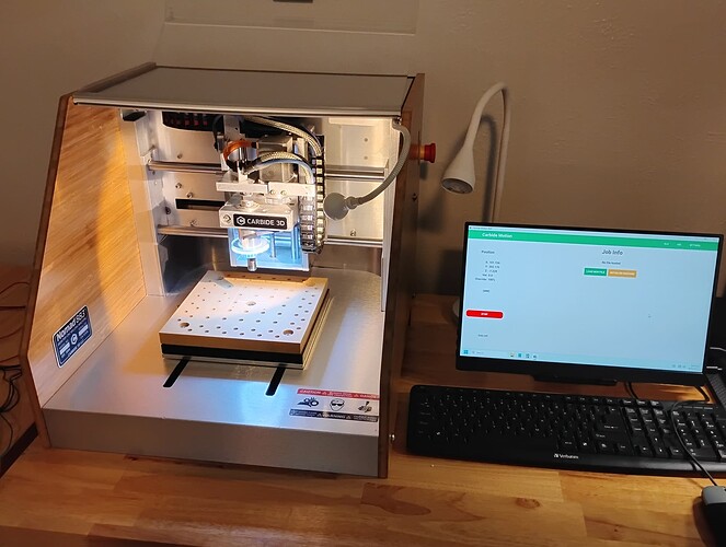

And here is the Classic+. I forgot until I unpacked the machine, that I had made a “hybrid table” of sorts by putting clearance holes in an MDF wasteboard to allow access to the threaded table’s holes underneath.
