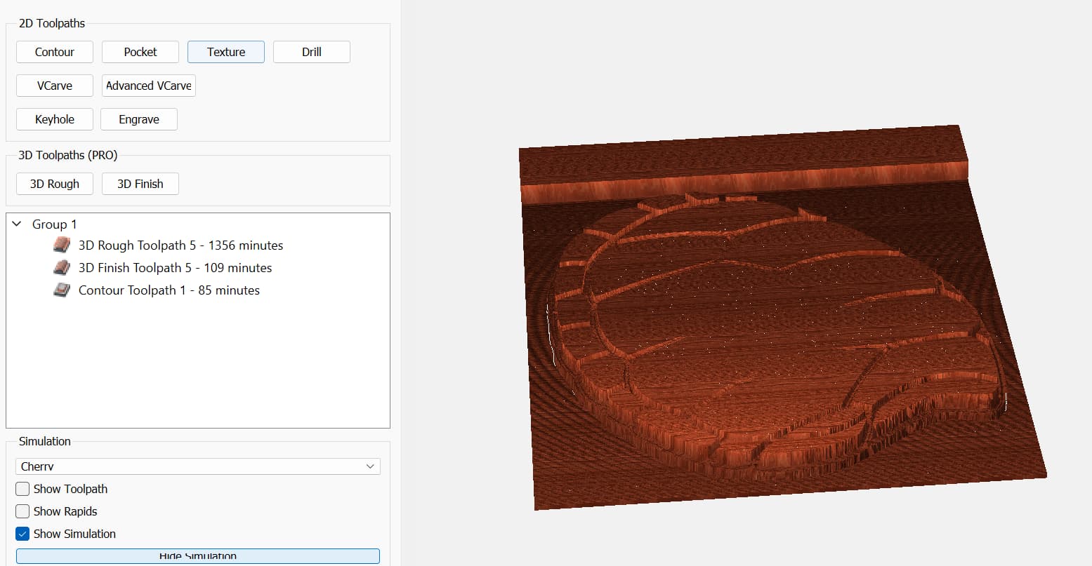

I have tried everything I can to get a simple 3D model for a turtle shell and I get nothing. I have CCPro, and have listened to the “tutorial” on youtube by Chris Powell to the extent that I think I can say the whole tutorial by heart!
Somehow, no matter how many times I follow what I think he is saying, I still get either a flat turtle, or a complete cutout of all the parts, which is no good either.
I must just be the dumbest follower of these “tutorials” in the world. Just so frustrating.

I have followed the info you laid out, three times now and I get the following. The “turtle back” should be as high as the thickness of the material (ie. 1.0- 0.25), but does not show up that way in the simulation. Instead it shows up almost flat, but does leave some kind of “sticks” standing up at various locations around the turtle back???
Obviously I’m still doing something wrong, but can’t seem to find out what.

One problem is that you have modeled things so that the height of the stock is exceeded (that’s what the red in the 3D model view indicates):
If you increase the stock thickness so that that doesn’t happen:
the Toolpaths will then be able to make something which looks like the design which you are making — if you select a region which allows the cutting to be done as it ought.
All geometry, except for the offset geometry which should be used for the 3D toolpath is selected:
If you actually want to cut out the turtle shell alone, you will need to select the perimeter of that and use it for the 3D toolpaths:
which should cut as expected:
Thanks for looking at it. Not sure why/how it got to deep/thick as I set the thickness in the setting, but will try again and see if I can use what you have suggested.

I believe you either entered the wrong height to extrude to, or missed choosing “Scale Height”.
Tried again with no luck.
Here is the pic of the screen from the Model stage.
Then this is what I get with the rough and finish toolpaths
Don’t know why?
