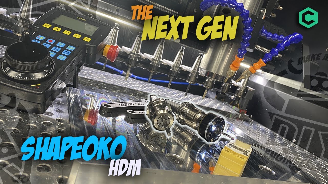

HDM + 12 tool rack ATC
Been rethinking my HDM, replaced the controller, raised the voltage to 48v, added an ATC, designed a 12 tool retracting rack and a bunch of other things…
enjoy:

For anyone looking to do something similar - step 1 is make sure you have en enclosure - I’ve seen the 40,000rpm version of this spindle fly out first hand.
I can appreciate the work that @davidgjohnson put into this, but I can’t help to think this is the wrong platform for such radical changes. The HDM is structurally a beast, I just feel like the use of GRBL is holding it back. I would absolutely love, love, love to be able to purchase a bare bones HDM with no electronics at all. Just utilizing the motion components and add on something like a MASSO with Clearpath Servos. I truly miss the ability to do 3D probing, and gcode rotation, and gantry squaring, and auto leveling, and… and…
I’ve also had a tool holder pull out once, it is a scary moment and the inertia even a small ISO20 holder has is crazy, and it wasn’t at full 30K RPMs.
I also would suggest closed steppers/servos when it comes to ATC, being able to trust that the machine knows where it is and in relation to the tool rack during a tool change is very important and can lend to more trusted “unattended”* operations. I have been saved a few times from the machine inflecting self-damage because of this as well.
*I still wouldn’t suggest leaving a CNC machine out of hearing/sight that doesn’t have all the industry safety compliance and features that a typical consumer grade/DIY CNC would lack.
Nice build @davidgjohnson, much more elegance and thought than I, when I went ATC :laughing:
sorry, a bit confused…
what platform are you referring to? HDM, UCCNC, ??
Sounds like you didnt watch the vid, (I replaced everything on the HDM in the process)

It was first days of the spindle being operational, no tool automation at this point just manual quick tool changes. It was more human error than anything, a miscalculation of cut depth and feed rate. Cutting forces and probably mostly the leverage causing it to pull out.
3/8" single flute suffered broken/chipped tip and tool holder has imperfections on taper and pull stud is “rounded”
Clamp pressure only retracts the piston, the drawbar has spring washers to retain clamping force. You can actually relieve air pressure afterwards if you really wanted. Here are some glory shoots of the spindle top and piston when I was inspecting everything.

the pull stud cap on the left looks to have a thinner cap.
while the clamp assembly is spring loaded, my spindle has a clamp input which is used during tool change (5seconds) to fully seat the tool clamp.

I think thats just because the tool holders aren’t at the same angle/plane in the photo. While it was damaged at the point, I checked the pull studs and tapers on all my holders to make sure they matched. At least with my limited amateur “metrology capabilities”.

I watched. I just wish we could get the HDM as a bare bones machine and BYO electronics. This platform with better electronics would b ideal.
