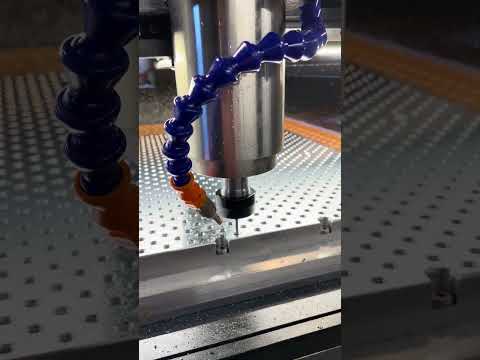

It’s threading time, finally!
8k, 1000mm/min, 1mm thread pitch, 1.24 pitch diameter offset, multiple passes, 2, 0.15mm stepover, spring pass.
And…ta-da, it’s finished! I am really happy with this, Works perfectly with the Saunders mod vises. It’s soooo shiny too!!

Could you link the drill you used?
I ran some tests boring with a long 3/16 endmill and it’s got a bit of chatter.
https://www.carbidedepot.com/Drilling-Carbide/3-FLUTE-5XD-150-DEG-SELF-CENTERING-POINT/METRIC-UNCOATED/050MM-DIA-SER-103M-DRILL-50MM
Per @SLCJedi , whose opinion I greatly respect, a 2 flute from Harvey tools would be better - faster and better chip evacuation then the 3 flute in the above link.
I had already made the investment in 2 of the three flutes so I stuck with them.

I did some more testing today boring and threadmilling and I think I’m getting close to what I’m going to run for the final operation, with one problem.
The 3/16 1inch reach endmill starts with making some pretty nice chips but then starts to make fine dust as it gets deeper. I assume this is because of it rubbing against the stock. It also leaves a paper thin layer at the end because I’m using 1 inch stock. I could try increasing the cutting depth by a thousandths or so but then it would hit the shank. Should I consider switching to drilling?
Up until this plate I’d only used boring toolpaths for holes. I used a 1/8” diamond coated single flute to cut 5mm holes in 1/2” plate.
I tried using 4mm single flutes to bore 5mm holes in 7/8” plate without much luck. My take was there simply wasn’t, even using a single flute, enough room in the bore for adequate chip clearance.
So, I learned to drill. I think you might as well.
Good luck!
How wide is the cutting edge on your single flute cutter? 1/2 the hole dia plus the cutting edge width is the largest tool you should use when hole-milling / boring.
With a 5mm hole & 4mm cutter, the center of the hole might be getting cut with the center relieved part of the tool.
