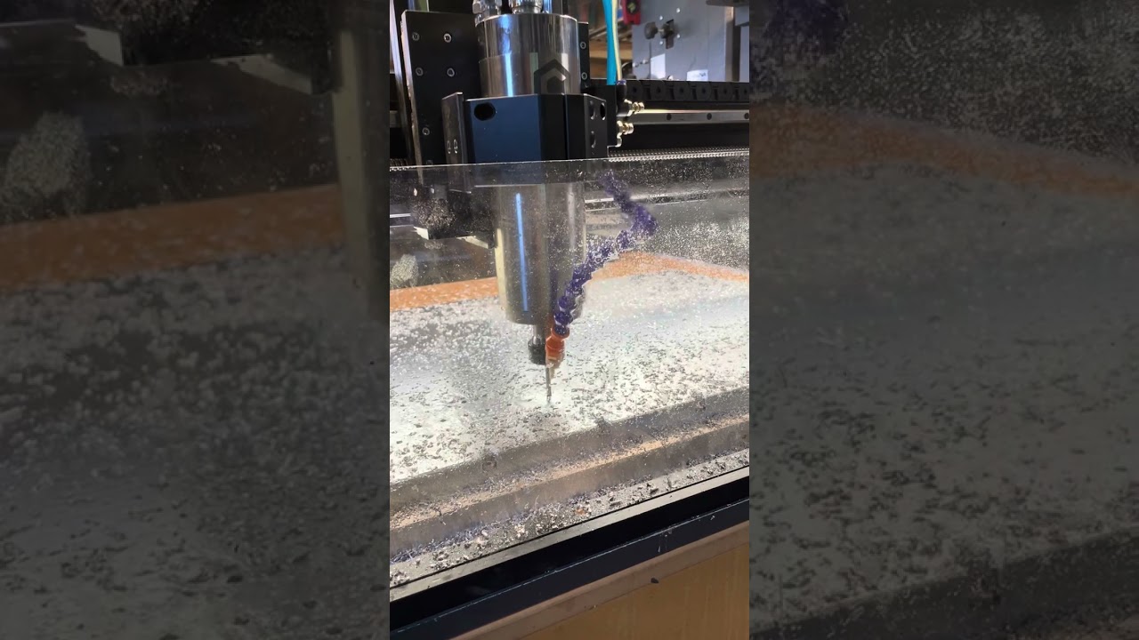

Started pecking some 5mm holes today, finally. 3 flute stub drill from Kyocera.
Struggling a bit losing steps occasionally, forcing a stop and re-zero. Guessing it’s my kludge mist system flow variations. I can hear the drill bind a bit occasionally, usually in the first 3-5mm. Seems odd given the giant steppers on this thing. Verified the coupler is tight. 500mm/min, 1.2mm peck depth, full retract.
In any event, it’s working, albeit slowly.
I was having issues with drilling too. I had a conversation with Vince and it turned out I was not plunging fast enough, getting build-up, then stalling the spindle. I was also using Harvey Tools carbide drills and they are 2 flute with more room for chip evacuation.
Good to know.
Started my drilling learning curve at 1000mm/min with immediate lose of steps. Ended up at 1/2 that with acceptable results but not good enough.
My California Tools air compressor crapped out yesterday so my pecking has petered out ‘til I fix the compressor. Hopefully the 2 flute drills will arrive by the time I fix the compressor.

I run 80 IPM retract with 30ipm plunge at 10k .040" pecks and lubricant is a must otherwise the chips stick in the flutes.
Buy some tap magic cutting fluid and add a few drops at the hole locations if needed. Thats what I started with years ago before the mist system.
Started testing at 8k, 10k seems to work better. 1.5kW spindle.

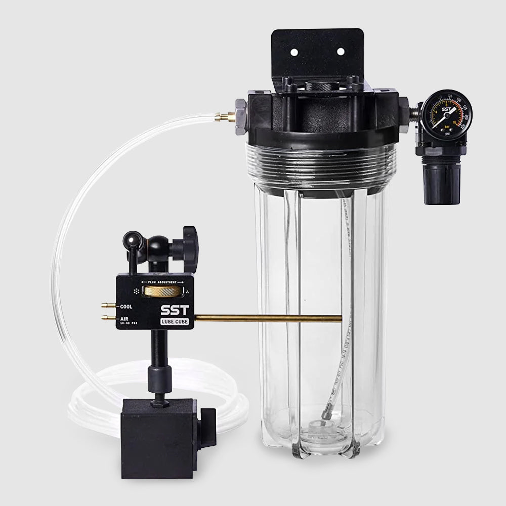

I’ll probably bite the bullet and splurge on a Fogbuster. After I look around a bit to see if I can build my own. The machined block doesn’t look that hard to duplicate, just need to find the pressure capable reservoir.
Is the better bargain over fog buster if you want to DYI buy a 10 in water filter housing they are rated to over 40 PSI and is all these companies are using.
You beat me to it…I was just about to link the SST version. :smiley:
Thanks, I thought I’d seen an alternative somewhere around.
Fixed the compressor, back to pecking. Trying a alcohol/wd40 mix this time. 40 holes and no missed steps so far.
I got the SST lube-cube and love it. However, the stock reservoir is not good for alcohol based coolants. I had to swap mine out with a polypropylene based res. Polycarbonate gets really brittle from contact with alcohol.
I do love this forum. Another “good to know”.
Care to provide a link to the reservoir referenced?
This is what I got. I just took all the hardware off of the original res and put it on this.
You want the version without the pressure relief button.
Got 1/2 the holes done yippee!
Stayed with the three flute 5mm stub drill, learned a bit.

I used a small water filter housing and NTP to 5/16 quick connect pneumatic tubing hooked up to a compressor. Outlet is a 1/8 tube pushed in to the 5/16 that acts as a straw inside the housing. I built a weird janky system where the air for both the mister and air last comes from the same tube with a y splitter but from testing with a generic Amazon mister it works pretty well.
Ok, so the container is pressurized, that should make the flow much more consistent.
