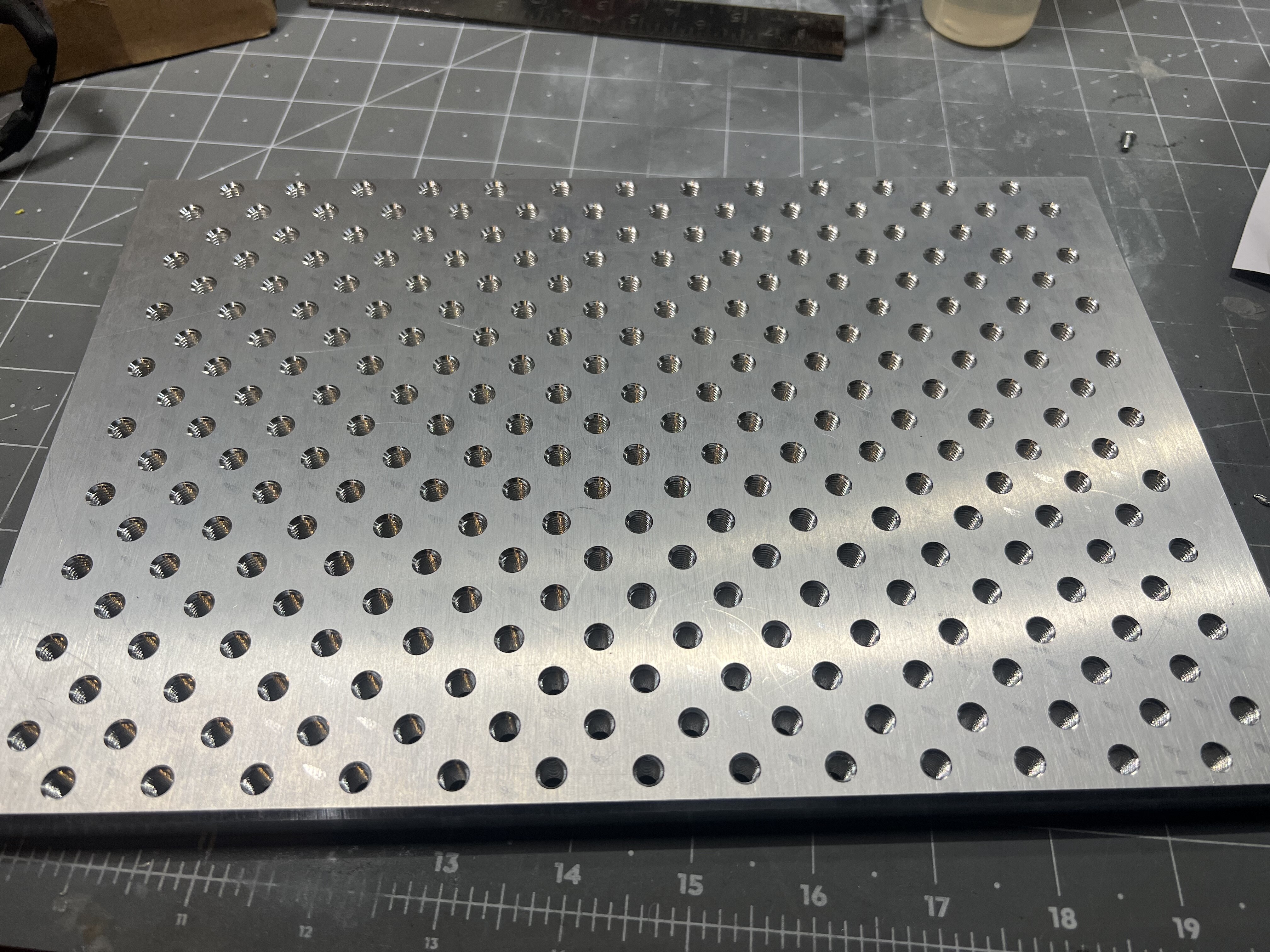

Finished a smaller fixture plate as a test run, came out pretty nice but the threads are a tiny bit rough but very useable.
M6 might be a little small for a full plate though, maybe I’ll throw in some 1/2 threads but I’m not sure
I had to manually debur every hole with a chamfer bit from the bottom though. It didn’t take too long but I don’t really want to do that for a full coverage plate. Is there any way to prevent burrs other than flipping and surfacing/ chamfering?

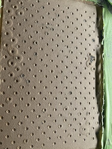

I also found that mdf isn’t great as a spoilboard material with ipa mist, lots of swelling and it almost came loose. I didn’t want to buy a slab of HDPE but it looks like I might have to
