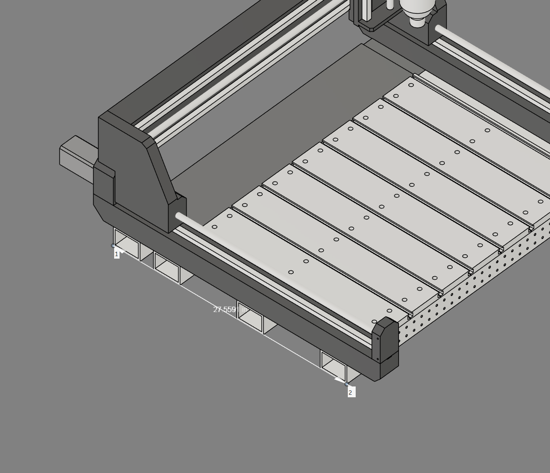

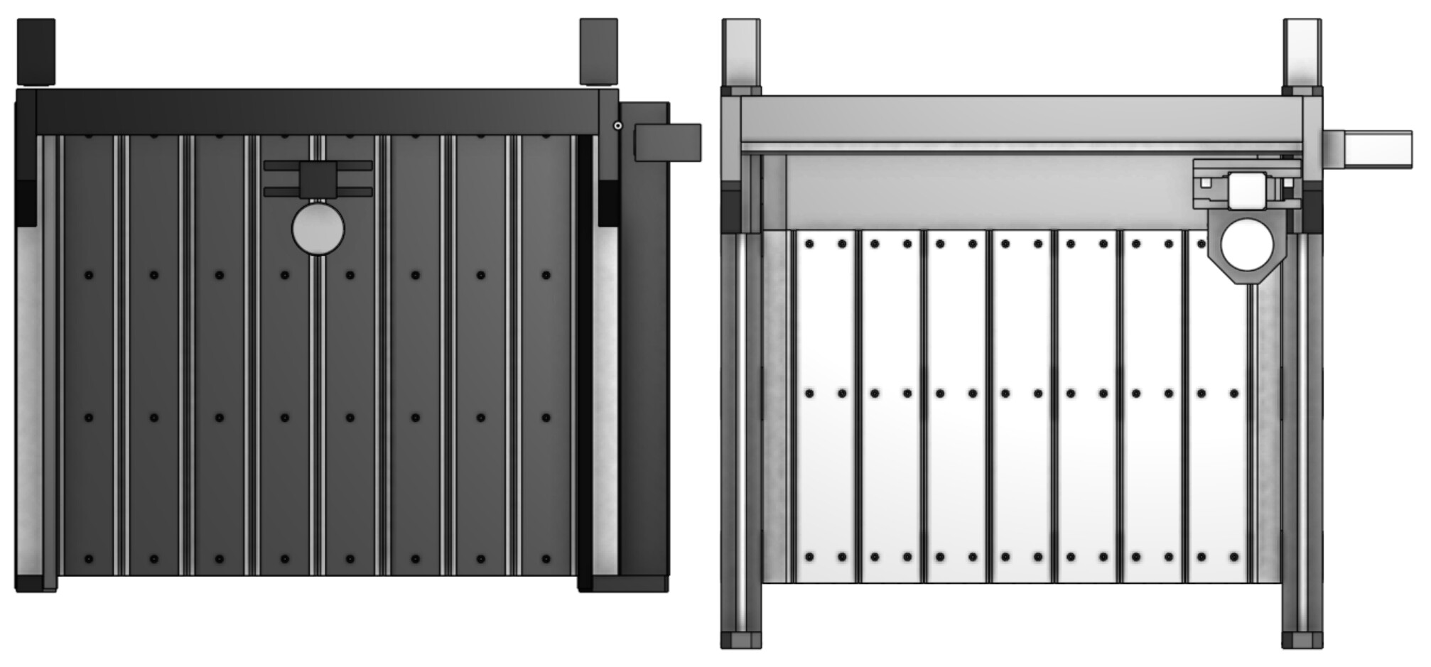

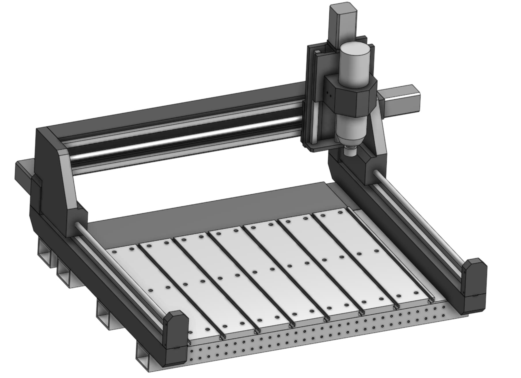

I noticed there were some significant differences between the HDM V3 and the CAD models for older versions of the HDM here, so I made a model for the V3. It’s not fully detailed, but the important dimensions should be reasonably accurate. Hopefully someone out there finds this useful for designing tables, enclosures, or other accessories for it.
Link to CAD in Onshape:
And here’s a link to a step export:

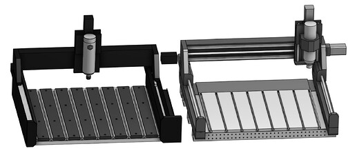

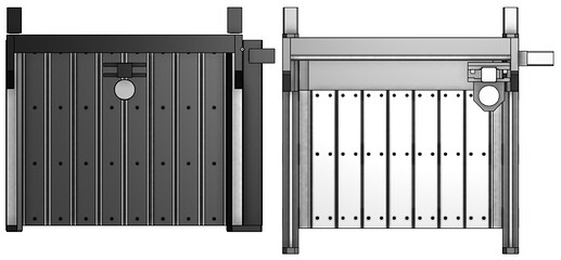

The V3 is ~86mm deeper overall than the older version. Wish I’d realized that before buying a 36" deep table to set it on…
Enjoy!

It sits on a 36" deep table just fine, it’s just a bit awkward to build an enclosure around it on a 36" table since it hangs off. The front of the spindle mount also projects ~45mm in front of the base when the Y axis is moved all the way forward, so the enclosure has to clear that.
