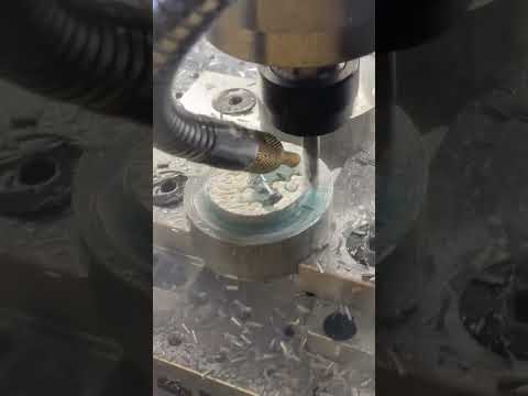

Here are some videos of more aggressive cuts I am starting to get comfortable with on the HDM, it is pretty insane how rigid this machine is and how much I realized I was able to push my PRO, but was always chasing my tail for good surface finish (rigidity is the key there)… Enjoy
Here is a sample of a single flute at 120ipm and .3 doc with .04 step over
This is +40%
How do you manage all that liquid?
I cut mostly with air only, sometimes with IPA mist on my HDM at similar speeds/feeds.
It’s 70 alcohol and water with some lubricant, it evaporates pretty quick after a day of cutting, I’m also running a metal frame and chute to a collection bin for all the chips, so under the machine is open to that
Just air blast makes my tools wear too quick in my experience on the pro
Still figuring out all the nuisances of the HDM and where I can push more, but overall I can’t even compare to the Pro for aluminum, these are finish passes similar in step over and tool paths as on the pro only 3X faster and the finish is almost polishable. I blast and powder coat most do this is perfect as is for final. In a month I’m sure I’ll be polish ready on most parts, insane how well this machine works!

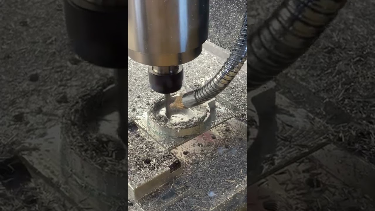

3/8” ball mill and more aggressive speeds and it’s starting to look great!

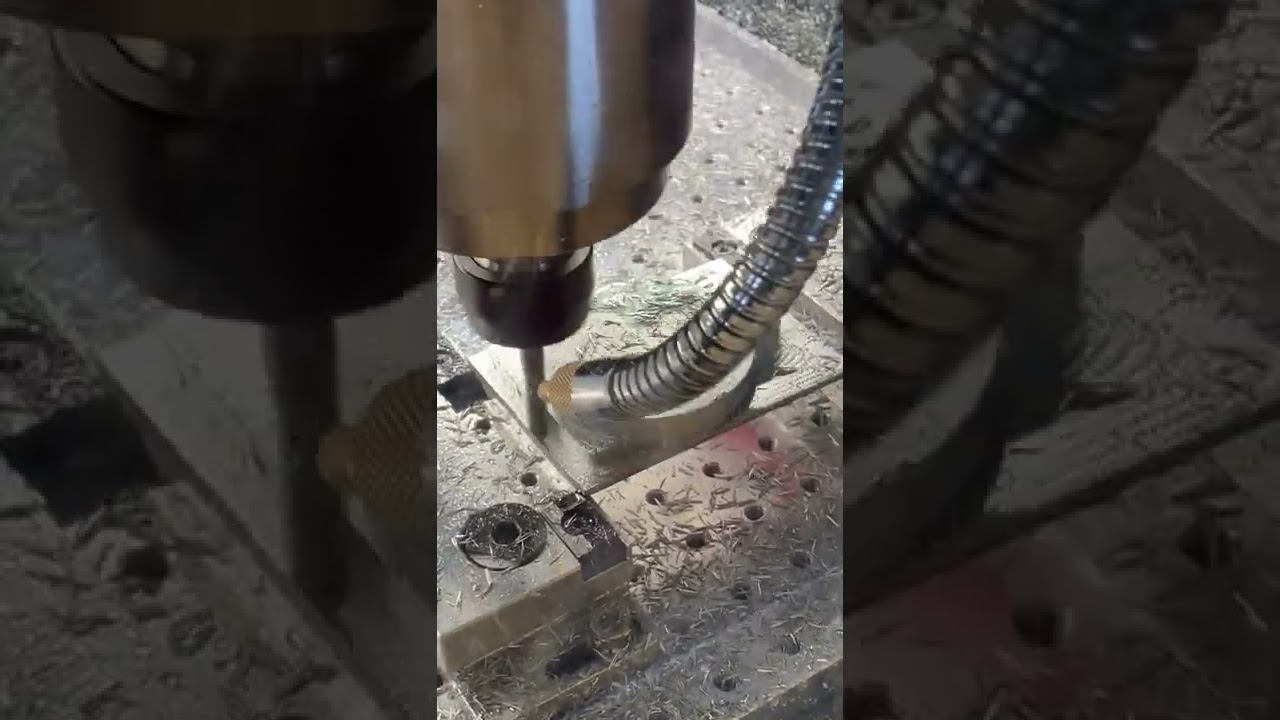

Here is a test on a part I’m pushing, single flute 0.35 DOC
