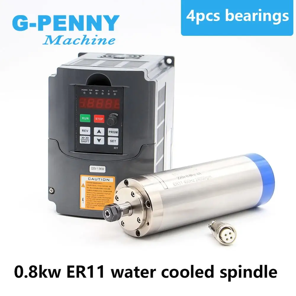

You 2.2Kw guys can keep them. All I need are 1/4" bits so I’m going with the 800W G-Penny spindle on Black Friday. Based on what I cut with the CNC it’s all I need now. The VFD that comes with it is 1.5Kw so I can upgrade later if the need arises.

This one that had just the spindle and the VFD. I’m going to add my own pump and cooling system. $175 for the spindle with VFD and $72 shipping. Total around $250.
I’m not a big proponent of big spindles, but has anyone looked at the spindle/vfd offerings from www.lightobject.com ? I’ve purchased several laser parts from them and the quality has been super excellent! I can’t vouch for their spindles since I don’t own one, but if the quality is anywhere near their laser offerings they should be pretty good. And they are in the US, so no slow boat from China.
Got it. That’s the same vendor I want to use. I think their overcharging for shipping since I ship packages to Shenzhen and Shanghai often for less than that. I just wanted to verify it wasn’t just me. Let us know when you get that one and what you think. They look like they’re a good product.
I didn’t end up getting shipping quoted because for a standard 2.2kW 24k RPM spindle, it was around $350, which is the amount I can get a whole kit for.
I’ll get a quote with shipping in a couple months when I have the money for a spindle.
