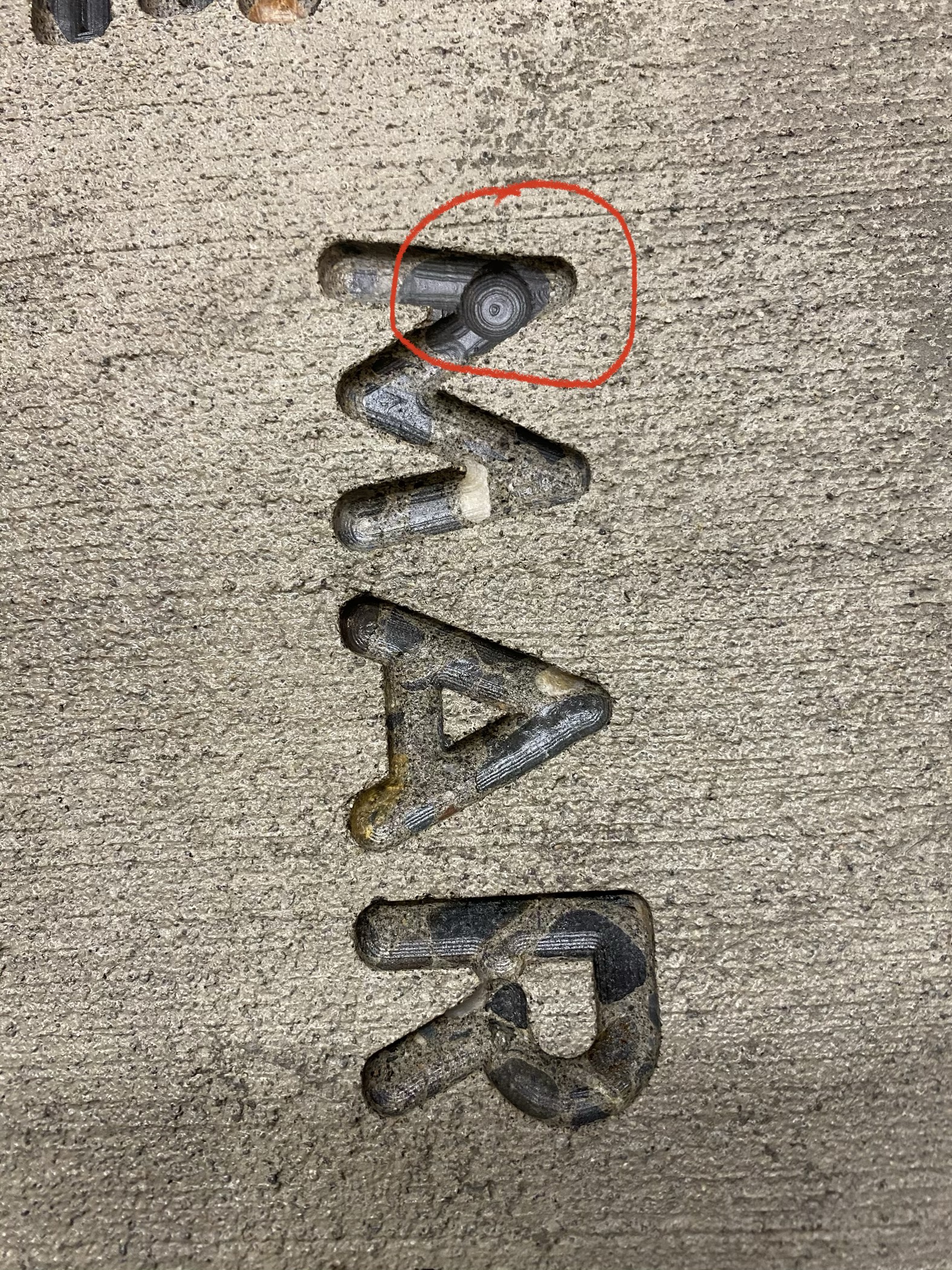

Julien - here is the update.
Concrete is such a difficult material to work with being non-homogenous.
Overall the the adaptive toolpaths are much faster. So we are absolutely on the right path. Here is a video of the 0.020" stepover. https://youtu.be/6DB4Zf2K1do
The downside is that the Z axis was skipping on all three of the trial runs Sunday. When the aggregate is hard, the forces are just too high for the stepper motor to hold. The worst attempt was made when the plunge hit a hard piece of aggregate on the plunge. Skipping like a kid with a jump rope. Obviously the depth control was, well, not in control. Need that HDZ upgrade!
The comment about the non-homogeneous material is related to the small inside of the A was knocked over during the milling process. However, this is not due to the toolpath or speed of travel this is due to the material that was supporting the small column. The top and bottom A are broken and the middle is still standing. The middle had a piece of aggregate that the center of the A was carved out of.
Here are some pictures.
Quite interesting. So 0.02" radial stepover it is, for now.
