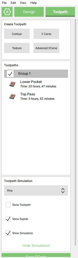

I’ve really got to figure out something here so I wanted to share my settings with you all, maybe someone can help me either 1: see what I’m doing wrong or 2: share some tips or suggestions to help me shorten this time down. Or heck, even 3: just let me know I’ve got it about as good as it can be and I’ve just got to deal with it…see my photos for settings and calculated hours!
Hours|152x500
Can you share the file at all?
Usually when folks use a tiny endmill and have issues with lengthy cut times it’s because they’re trying to preserve detail while clearing a large area.
A better approach is to instead use a V endmill and do a V carving — if you’d post the file we’ll gladly do our best to work through this with you. If it’s not something you can share publicly send it in to support@carbide3d.com

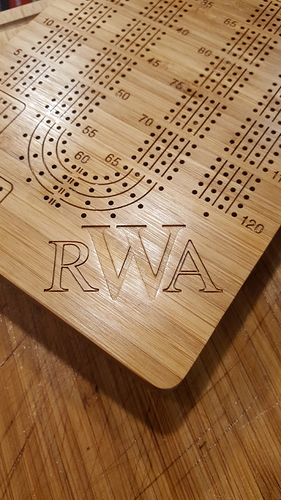

Teddy, I do a lot of small, shallow work. Here is a crib board I did with an 0.0315" bit to clear the middle letter, then used the 0.0150" bit to do the other letters and sharpen the corners of the middle letter. I think I used an 0.0235" bit for the numbers and lines between the holes. It was still wet because I coated it with mineral oil and hadn’t blown off the excess yet.

I recently upgraded CC to 4.74 from 4.64 and have not created anything in 4.74 yet. In 4.64 my estimates for tool paths were about double what CM would estimate. I suggest you load you gcode file into CM and see what it says. Additionally the estimate in CM is usually a little bit longer in actual time. An example would be that CM estimates 12 hours 47 minutes it would take me about 13 hours 30 minutes from hitting start to the router retracting and heading to the back.
Darn! Will try that out. I think I’ve kinda recognized that subliminally, but kinda brushed it off like, Naa, surely not or maybe its a glitch. Thanks for letting me know I wasnt going crazy, caws it’s happening to others too.
