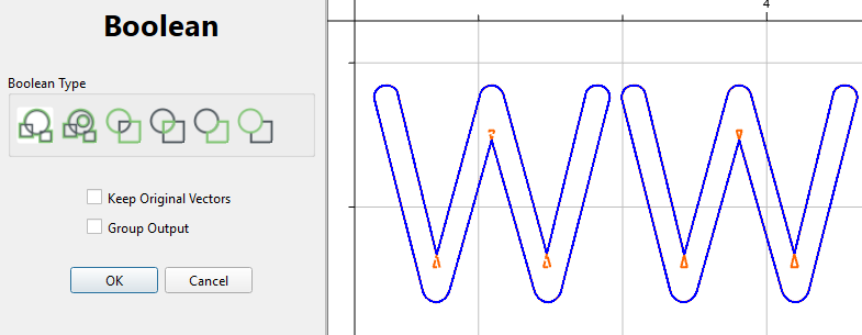

Quickest way is to boolean weld it. You have to pick at least 2 objects, it doesn’t matter what the other object is, as long is it doesn’t overlap your letter, or is contained completely inside it.
Thanks Will, I’ll do that.

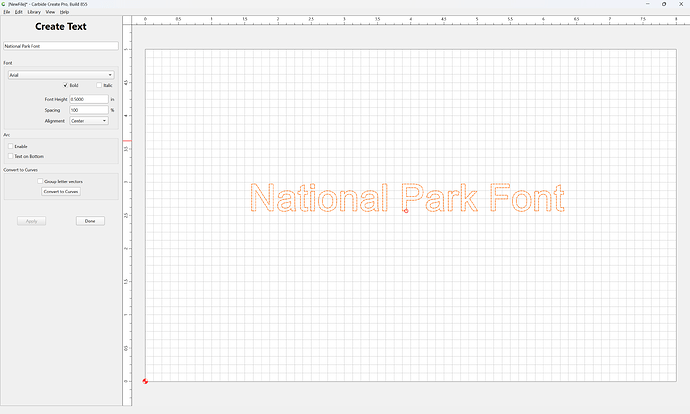

I have a question: I have been using this font for years…but it doesn’t look like what you are using. Is there some varient? And why do you have to trace it? It’s a font. Fonts live as vectors.
That looks like Arial:

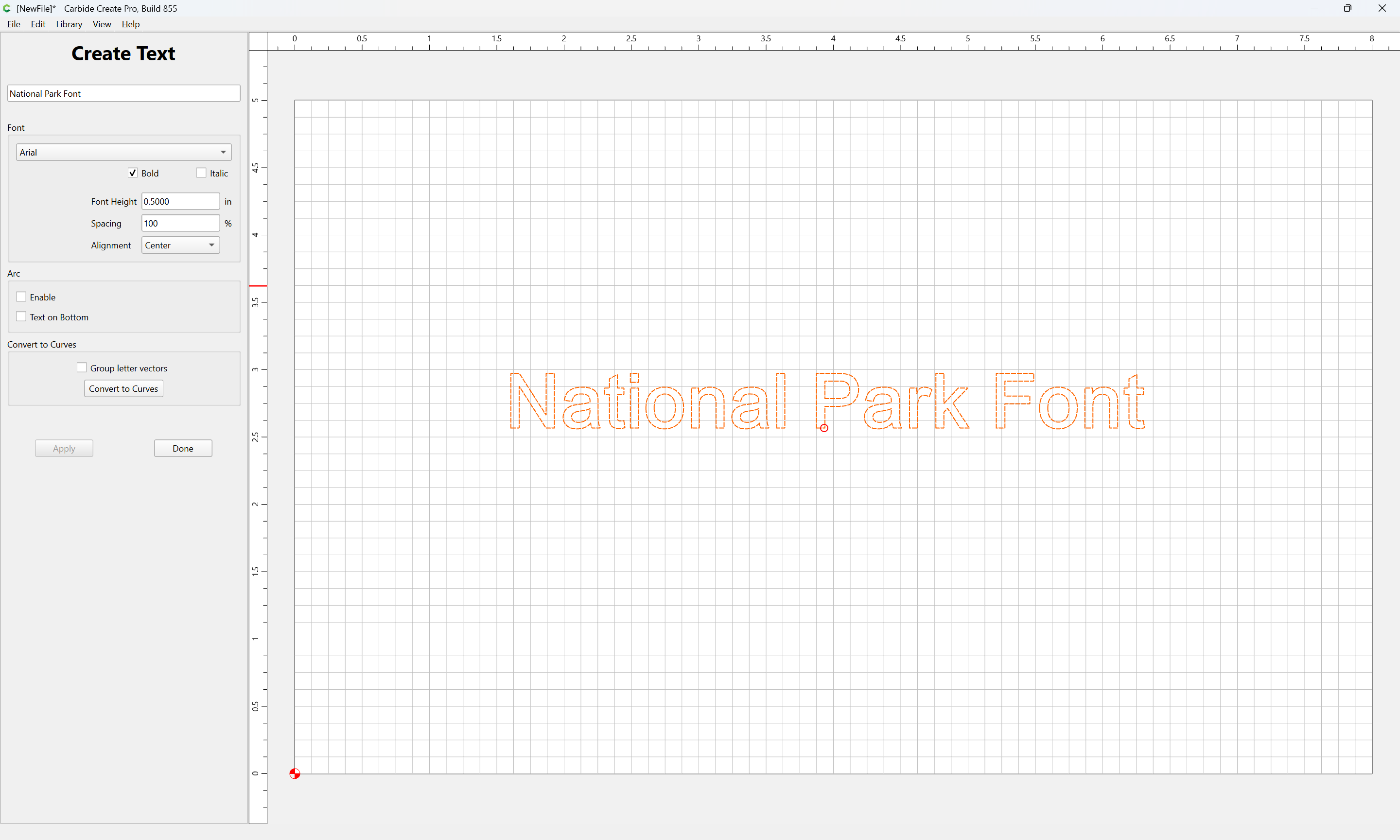

Probably they are vectors but when I create an svg in Adobe illustrator and try to use it without tracing, it doesn’t import the text. But when I trace it works. I usually function in the “how do I make this work” realm wherever that path leads.
From @WillAdams reply above. This is the font I’m using.

Ahhh…Love simple solutions like this. Worked perfectly!
