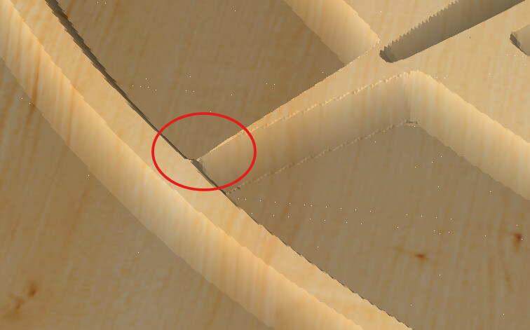

I would start the male side with Start depth of 0.050" and Max depth of 0.330". This allows you to fit the female part to the male part & measure the actual top gap, then adjust the male numbers to get the results you want. If there is any deflection, or the Vee bit doesn’t have a perfectly sharp point, or slight variations in the top surface, the parts will fit differently.
Another thing to note, anyplace the male side comes to a sharp point there will be 0.0" glue gap.
You may need to sand or shave the pointed top edge to get it to fit properly. In your case it looks like only these areas…
