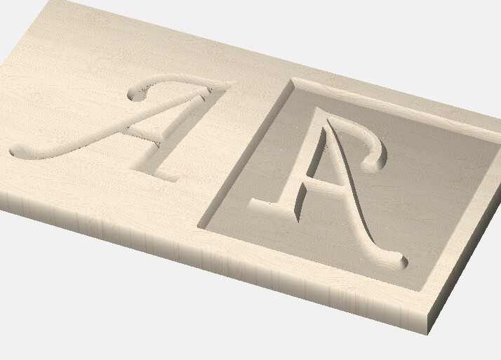

Iampretty new to using inlays in CC. I was trying to cut a simple Letter A with inlay model. What I see in simulation does not seem right. Can you guys let me know what I am doing wrong? The file is attached.

Answer: everything.
There are two carved "A"s. The cursive item is not part of the project?
For exercise there should be something that is not symmetrical to understand why the mirroring os necessary.
If you cut out two cutouts then gluing these together results in a cave not in an inlay.
You will need one cutout and one inlay that can be glued into that cutout.
One trick might be to cut out the area between the structure itself and the square around it to establich a plug “island”.

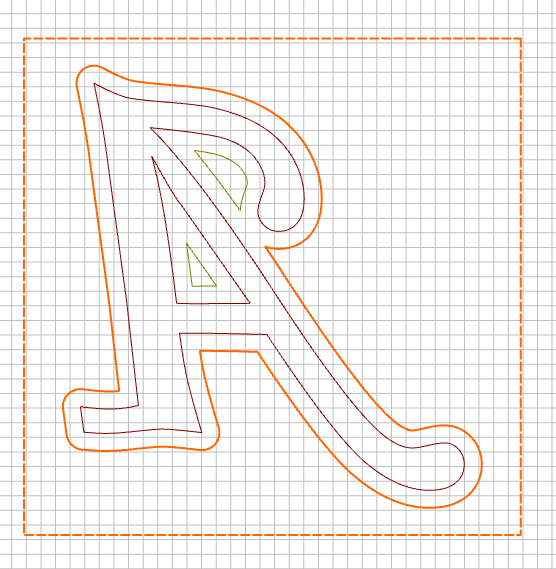

Suggestion:
Letter A inlay suggestion.c2d (192 KB)
What Matt said ^^^ :smiley:
Move either the offset or the outside boundary (Not both) to the Letter A Plug layer. :wink:

Here ya go. All I did was move the offset to the “Letter A Plug” layer so it was included in the path.
Letter A Plug layer
Letter A inlay TB.c2d (180 KB)

Pocket & V-carve look at the outermost boundary & machine within it. If there is another boundary inside that one, it stops machining that area. If there is a 3rd boundary inside the 2nd, it machines within that one, etc…
To cut the inverse, just deselect the outside boundary.
