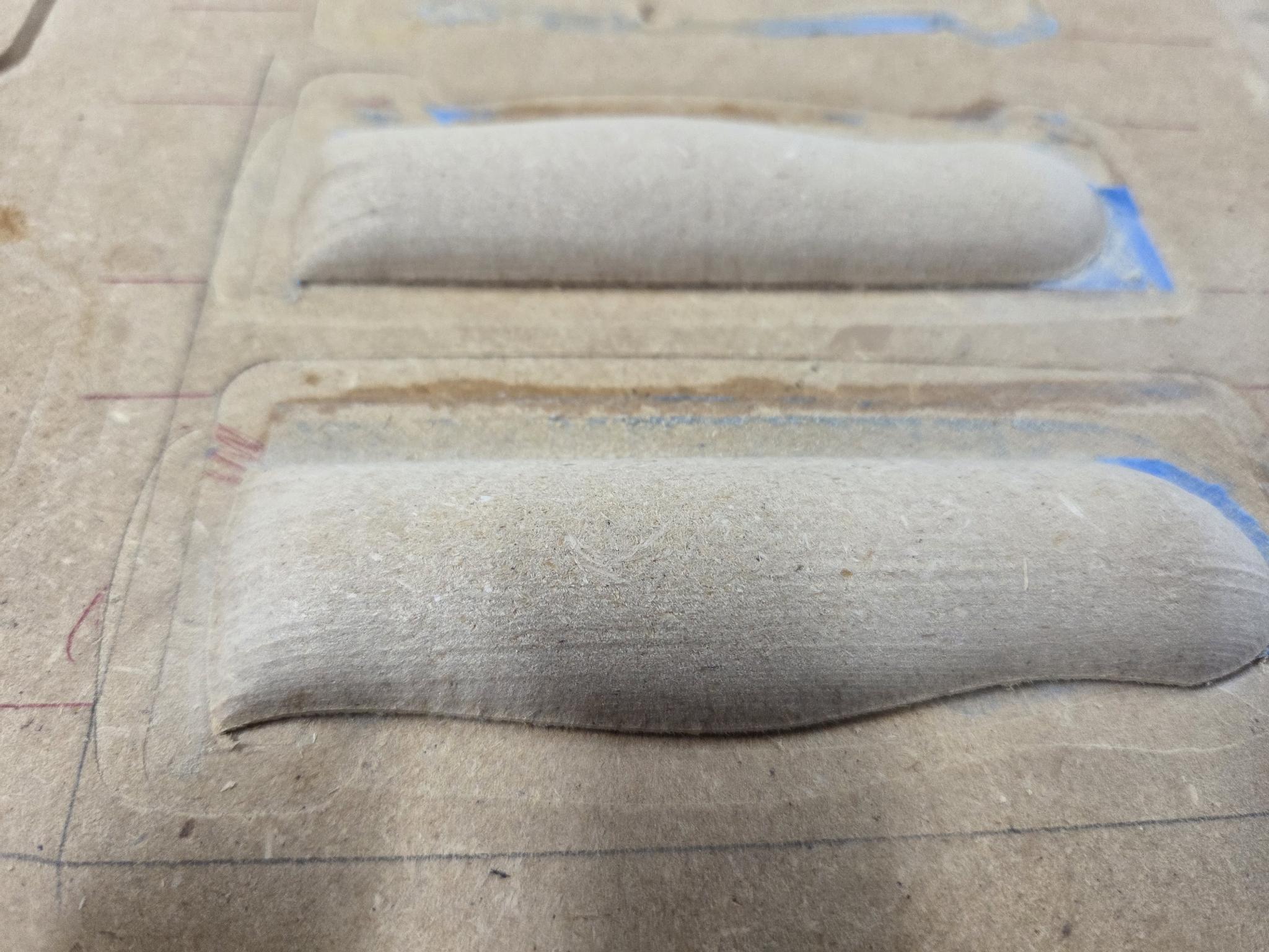

Yes, thank you all, its starting to come together in my head now. Will make changes and test this afternoon.

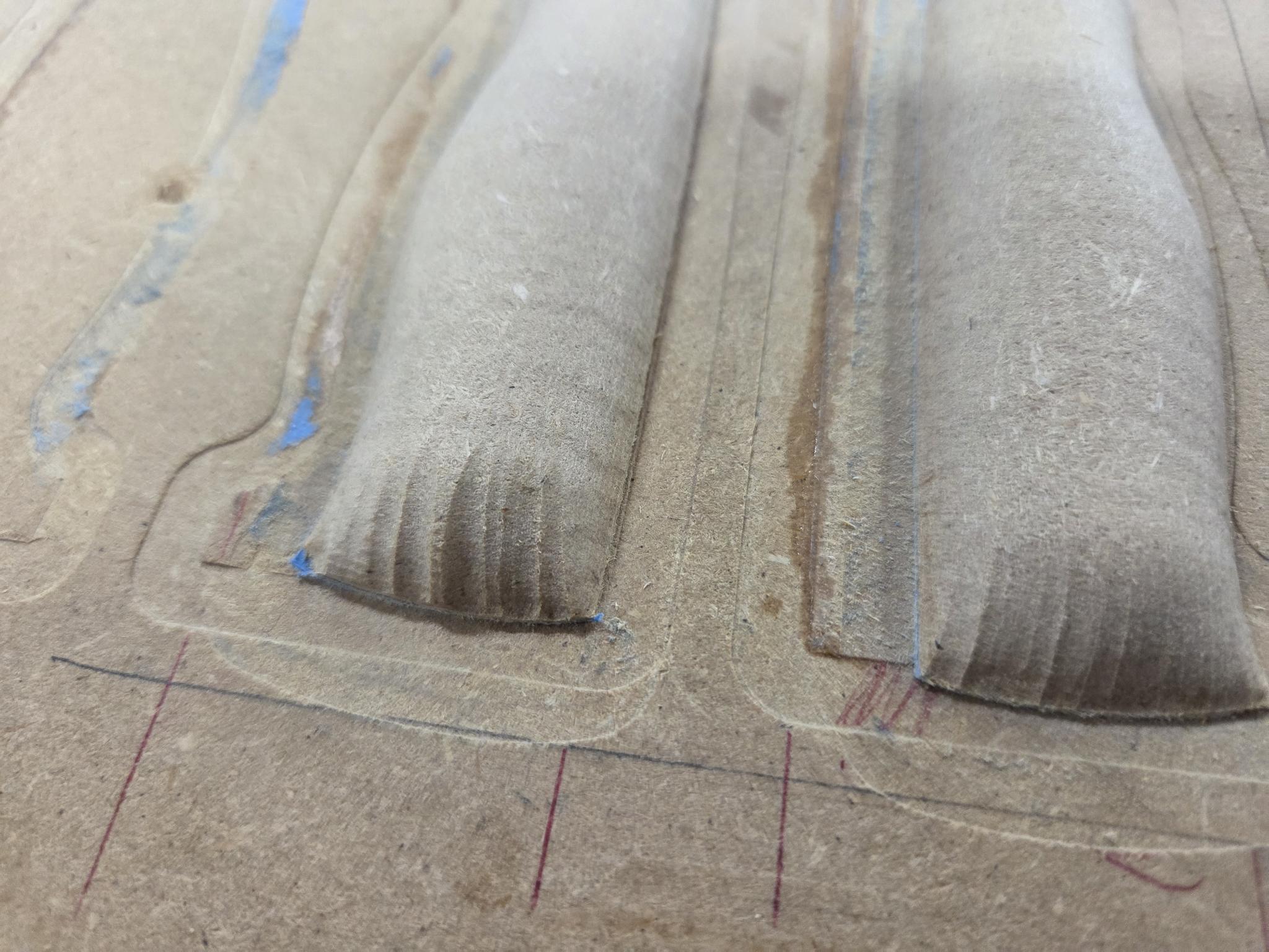

Much improved, but the ends are still a little rough and thats from the finishing pass.

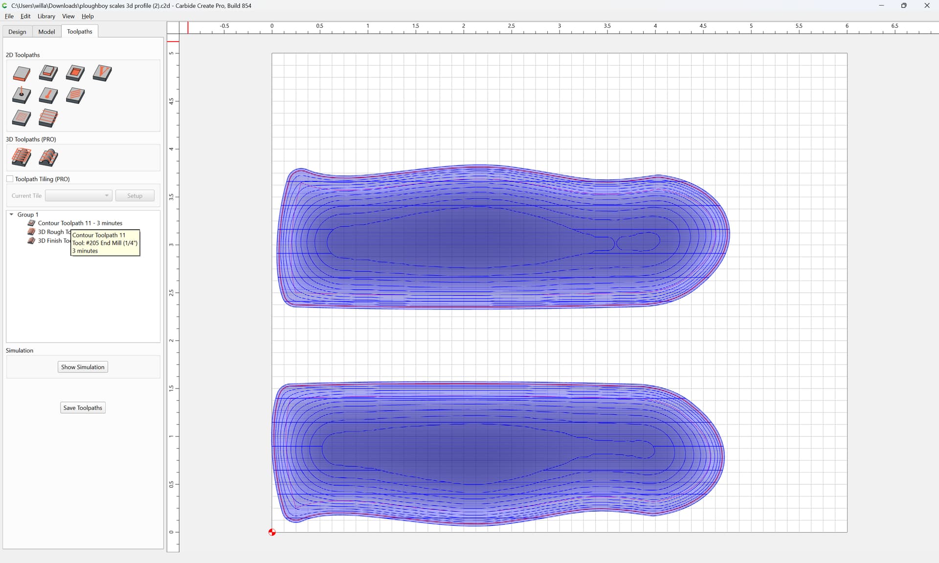

That does not match the 3D preview of the toolpaths:
If nothing shifted mechanically, perhaps add additional 3D finishing toolpath(s) at various angles?
If that won’t work, perhaps try a 3D CAM tool with more control over toolpaths such as MeshCAM?
It’s odd that the piece on the left is so much different on the end as the piece on the right when both pieces share the same tool path. Is you machine mechanically sound? Could your work holding have slipped a bit? Also, consider running your finishing tool path at 90Âș if your roughing pass is at 0Âș.
That the parts shifted position seems likely given that the Contour toolpath:
precedes the 3D Roughing and Finishing toolpaths — it should be last.
Im using blue tape with CA glue for work holding. There is zero indication of movement.
