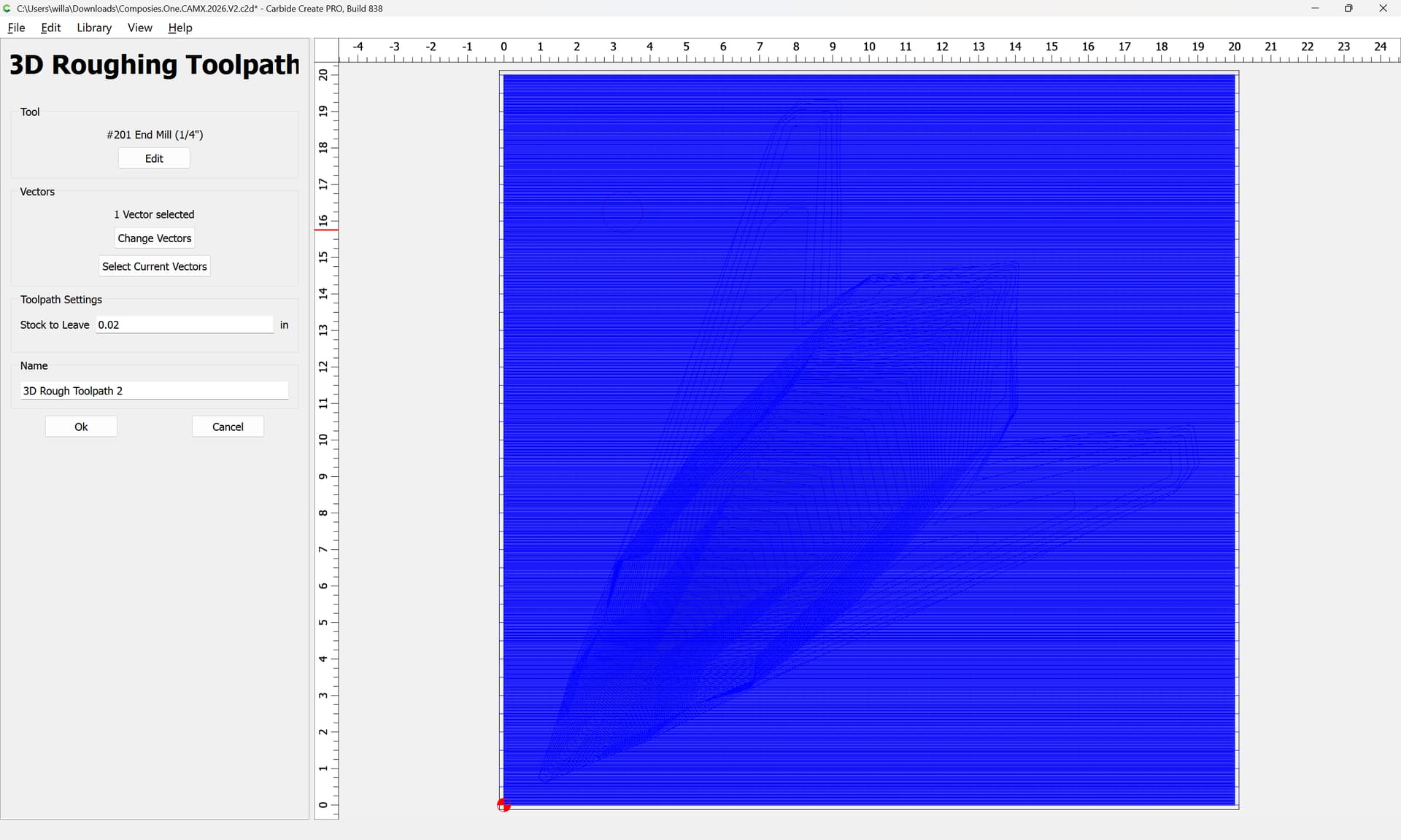

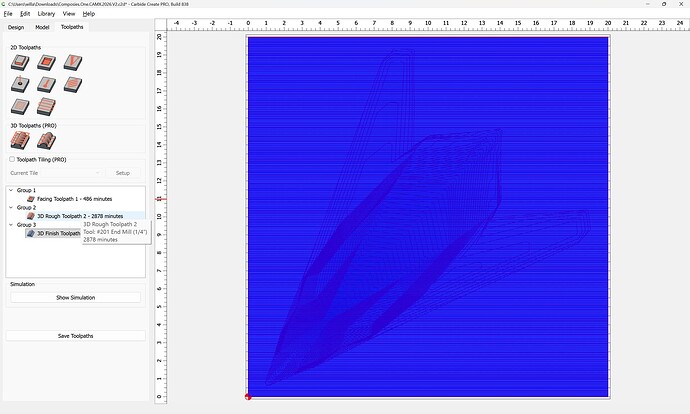

Given a file where a 1/4" tool is used for 3D Roughing:

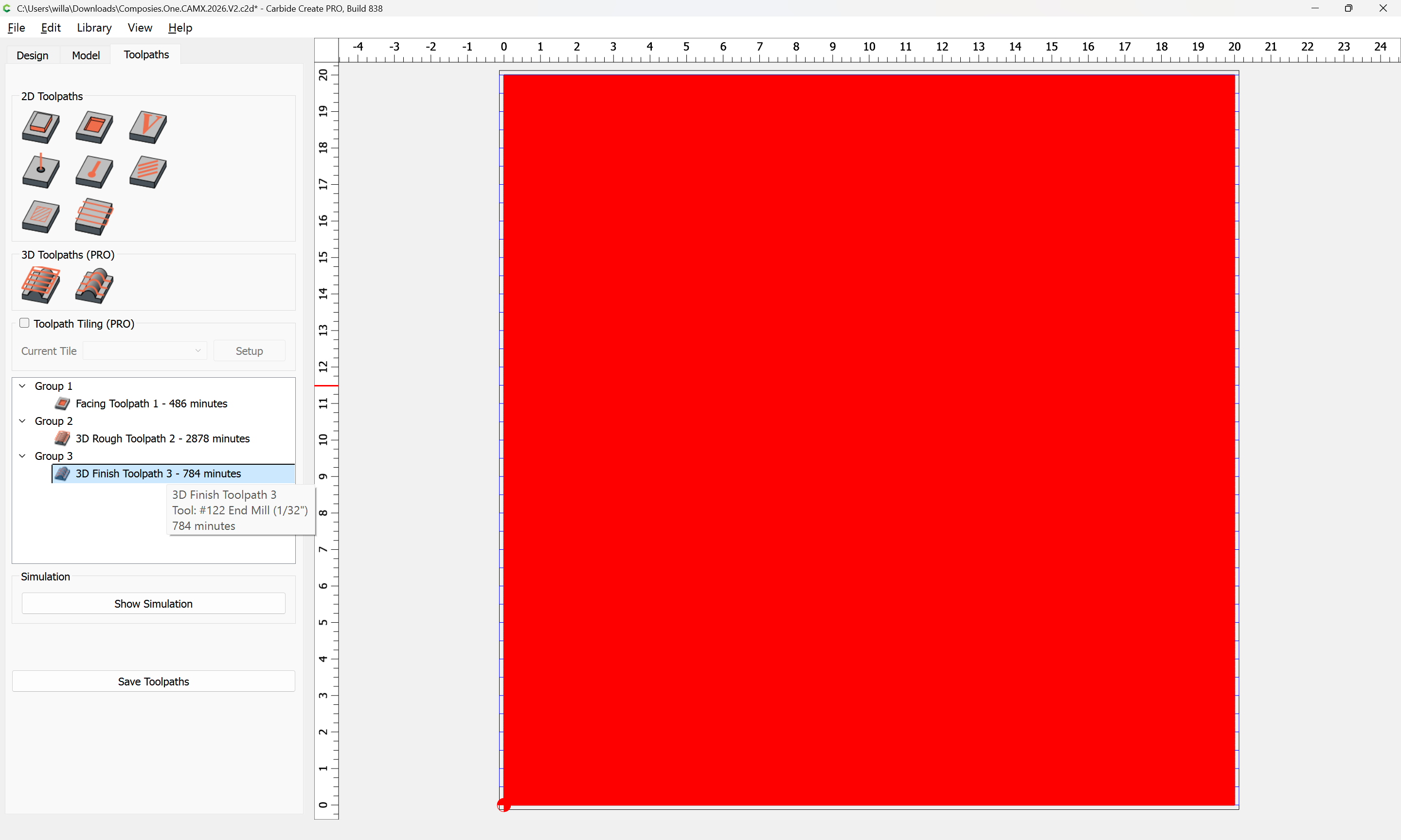

and one wishes to use a 1/32" tool for the ultimate 3D Finishing pass:

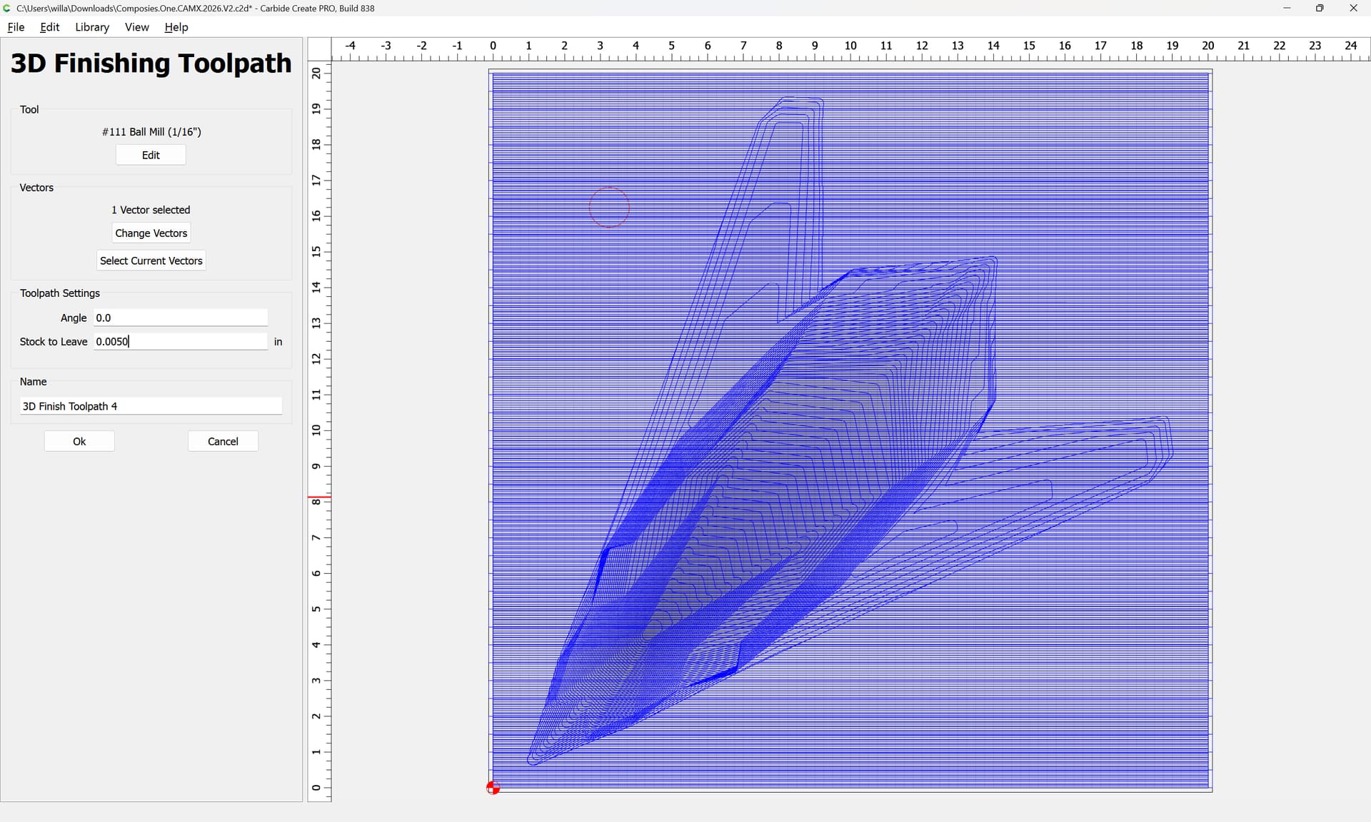

one possibly valid approach would be to insert 3D Finishing toolpaths for 1/8" and 1/16" tools…
The first thing which must be done is to consider that leaving just chipload thickness for each size tool will probably result in rubbing (and that at the stock feeds and speeds in Carbide Create, both the 1/32" and 1/16" tools have the same chipload, ~0.001") — so the actual consideration here is what thickness of material should be left uncut for by tool — Carbide Create of course provides a default value for this in its 3D Roughing toolpath, which presumably is workable for a 1/4" tool (presumably that would be the default):
this gives us 0.0197", which is sufficiently close to 0.02", and since we are halving the tool size at each gradation, a first approximation for testing might be something like to:
  • 1/4" — 0.02"
  • 1/8" — 0.010" – 0.005"
  • 1/16" — 0.005" – 0.0025"
so we would have 4 toolpaths (1/4", then 1/8", then 1/16", then 1/32") with only the last having a “Stock to Leave” of zero.

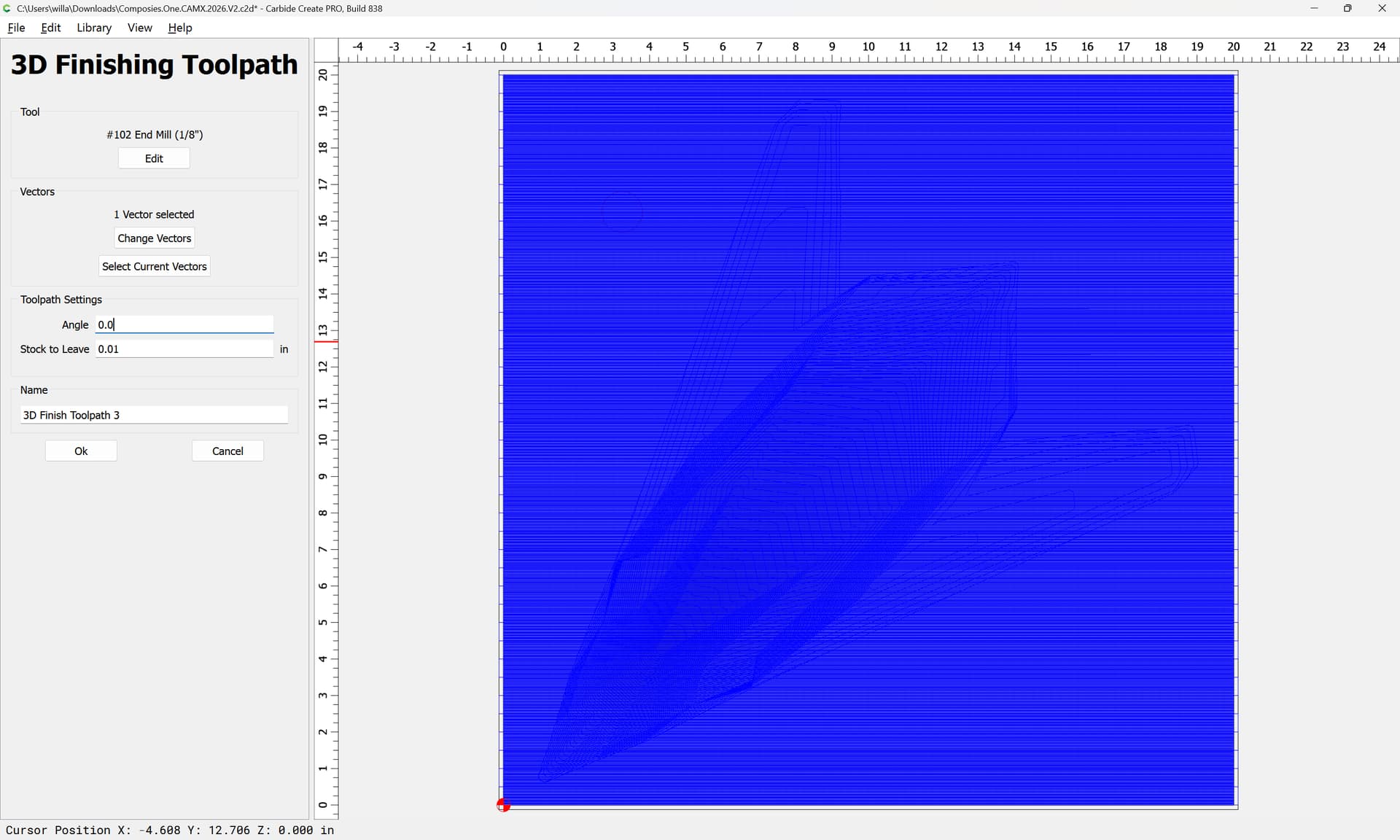

  • 3D Roughing w/ 1/4" tool:

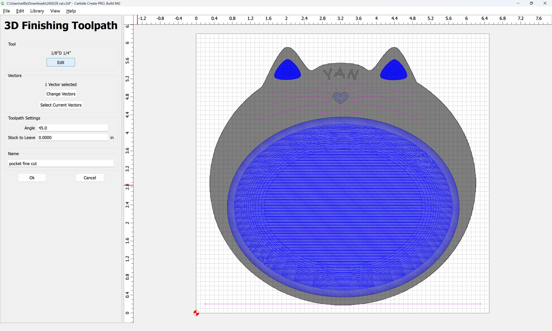

  • first 3D Finishing toolpath w/ 1/8" tool:
  • penultimate 3D Finishing toolpath w/ 1/16" tool:
  • ultimate 3D Finishing toolpath w/ 1/32" tool:

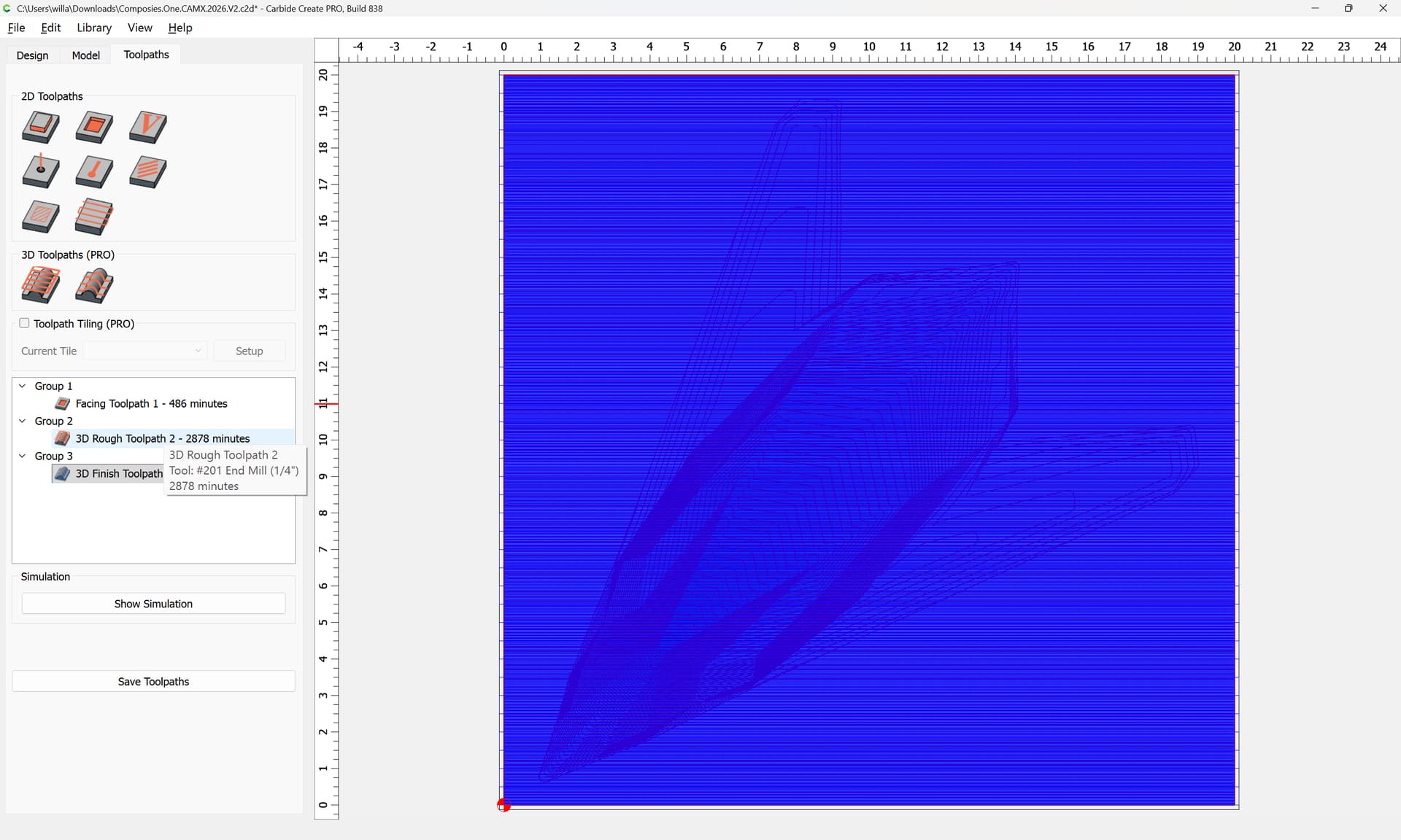

One potential concern is that there may be surfaces sufficiently vertical that the shank on the tool will collide with them — measuring and calculating these is left as an exercise for the reader.
A further improvement would be to alter the angle of the cuts, ensuring that the final pass is along the grain of the wood.

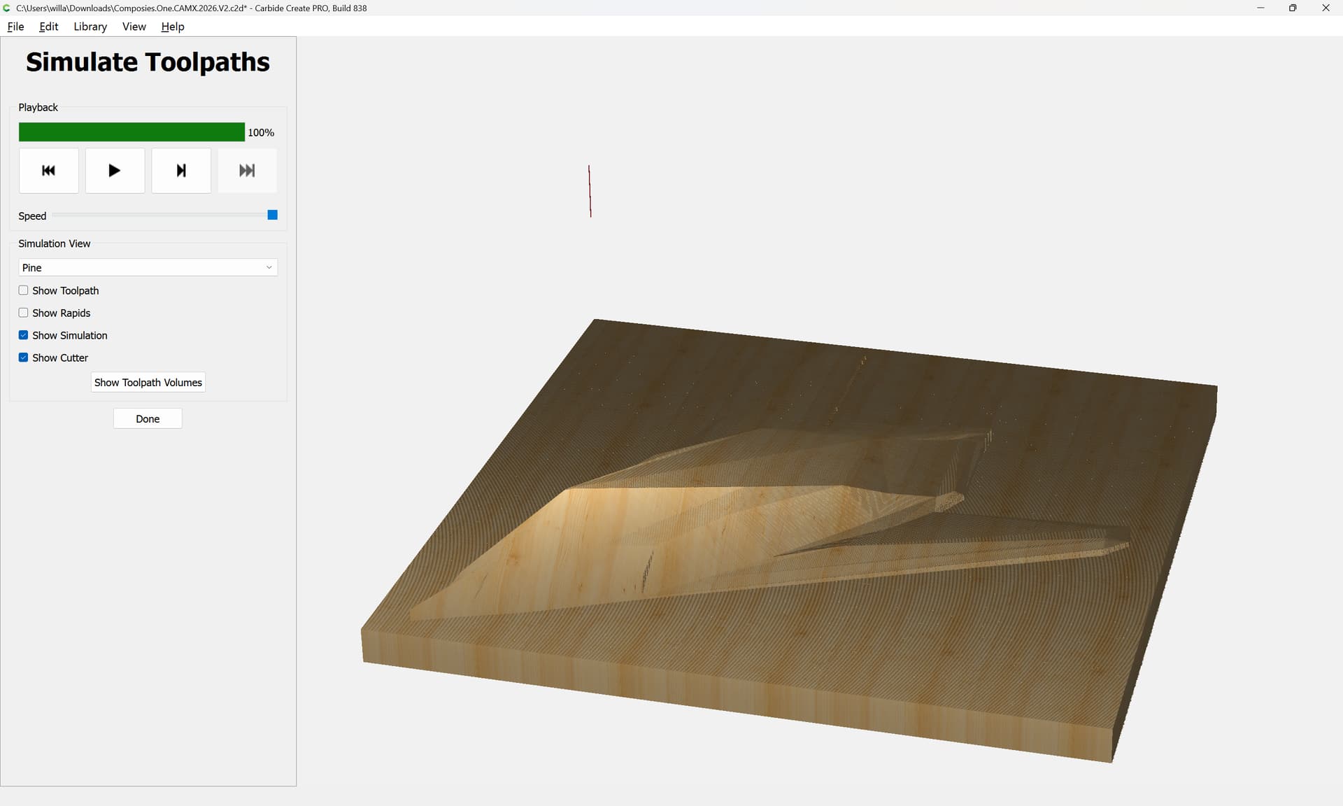

With all that, the preview is:

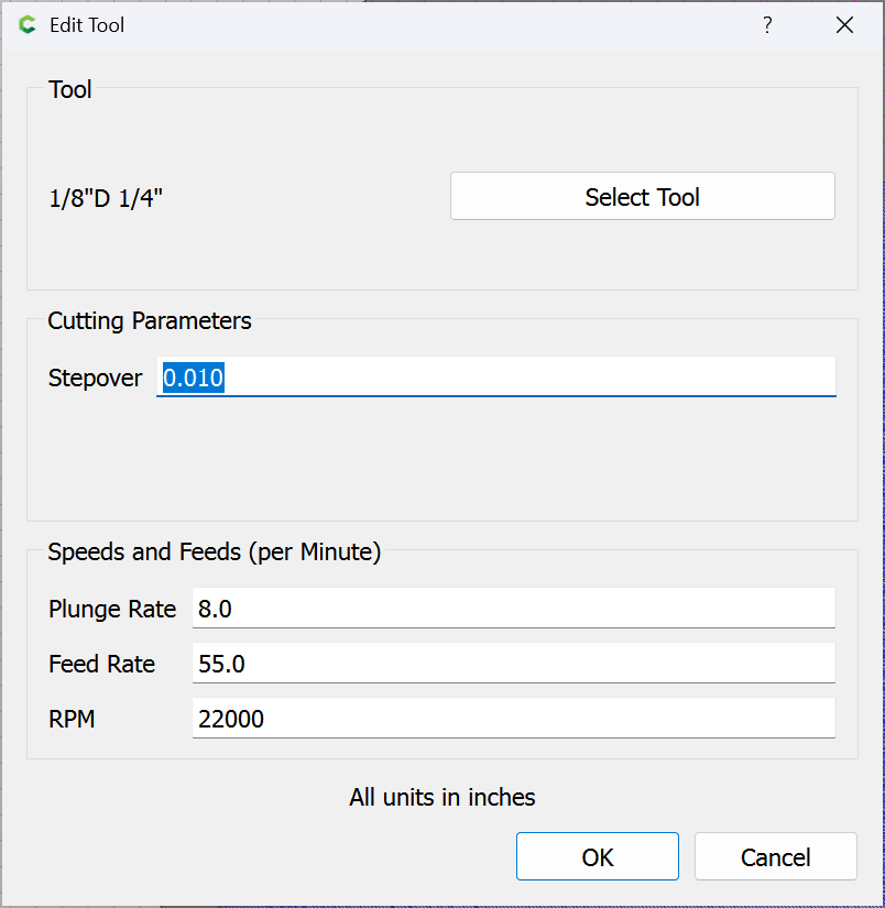

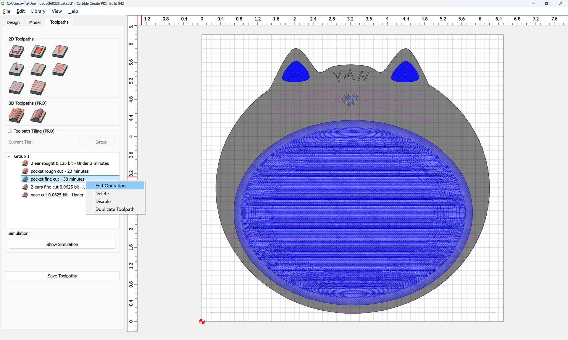

Note that one may also want to adjust Stepover, so Edit a 3D toolpath:
Edit Operation

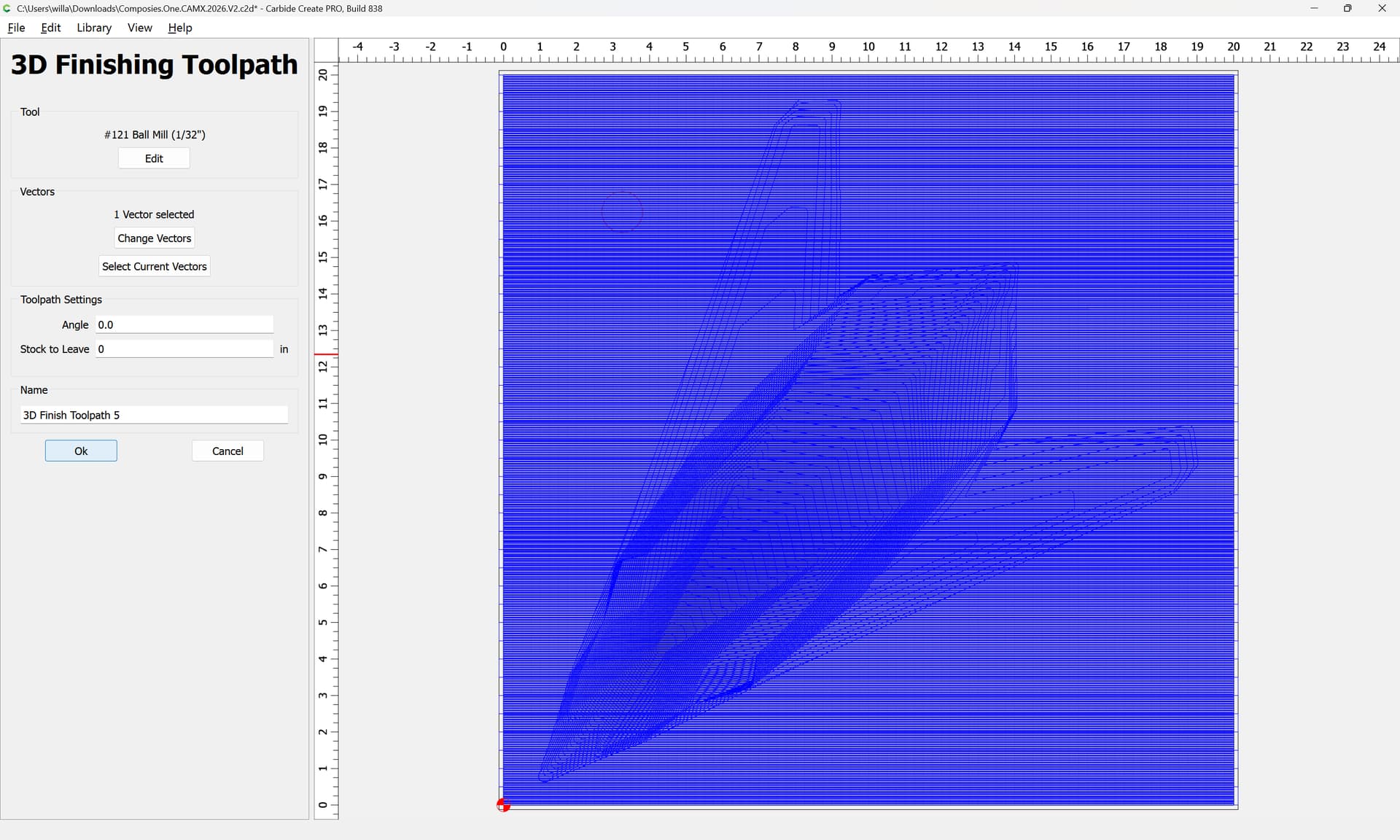

Edit Tool Settings:
and adjust the Stepover value as desired.
