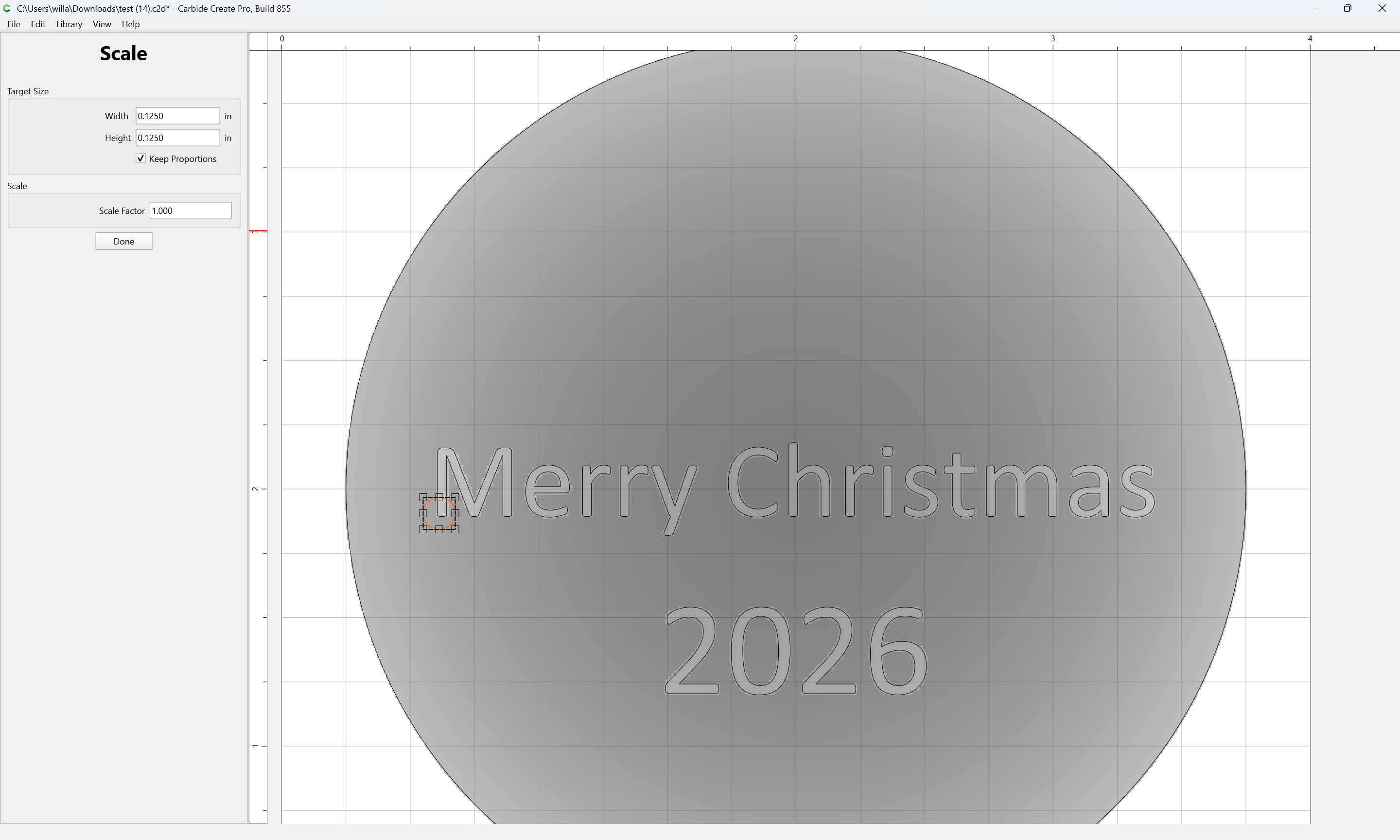

How to carve text on a curved surface
You will need to use a suitably small tool.
The 1/8" #102 you have selected is a far too large:
See:
Perhaps a #121?
