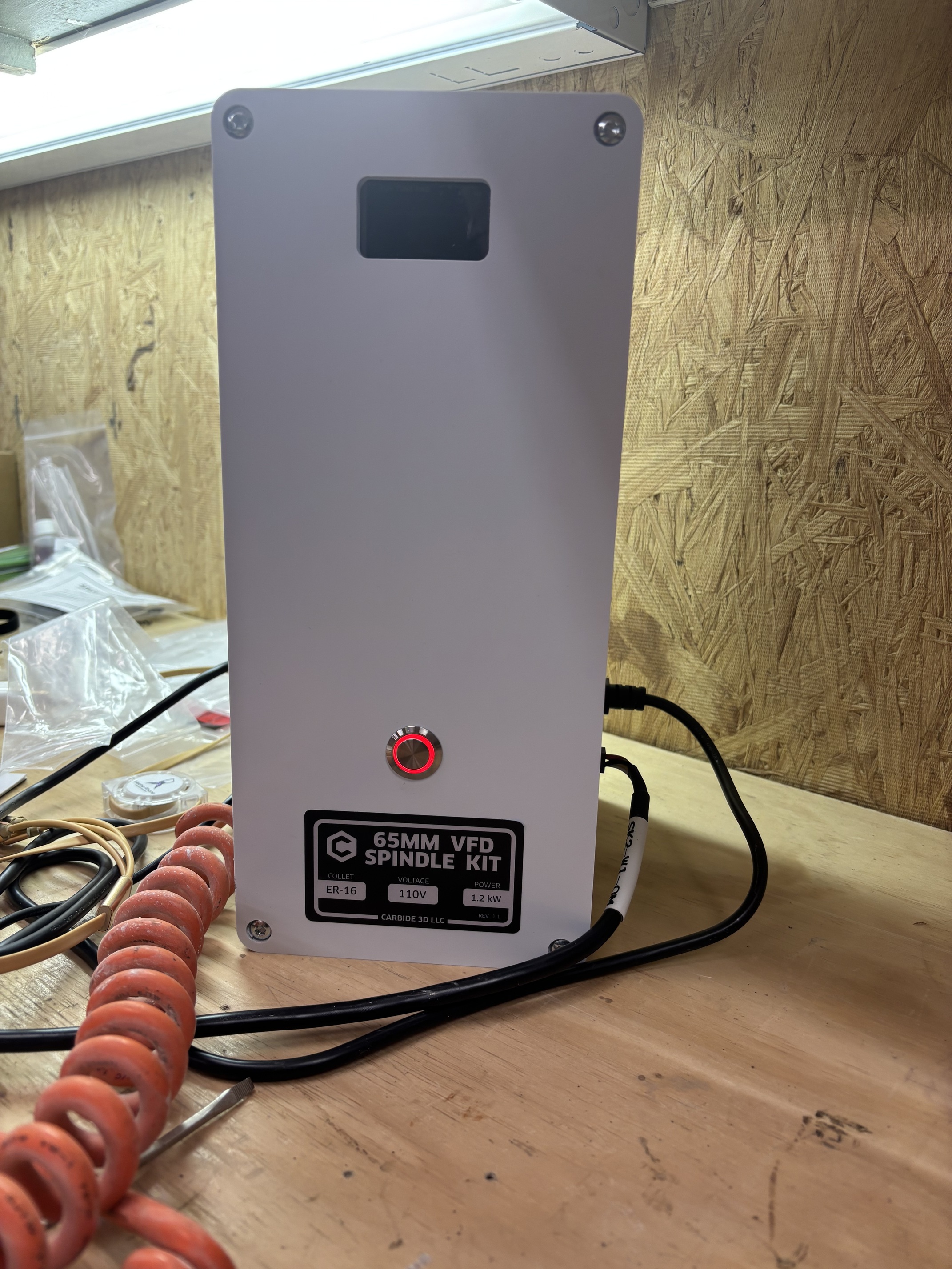

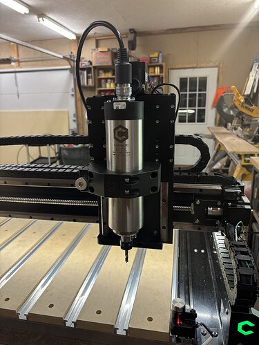

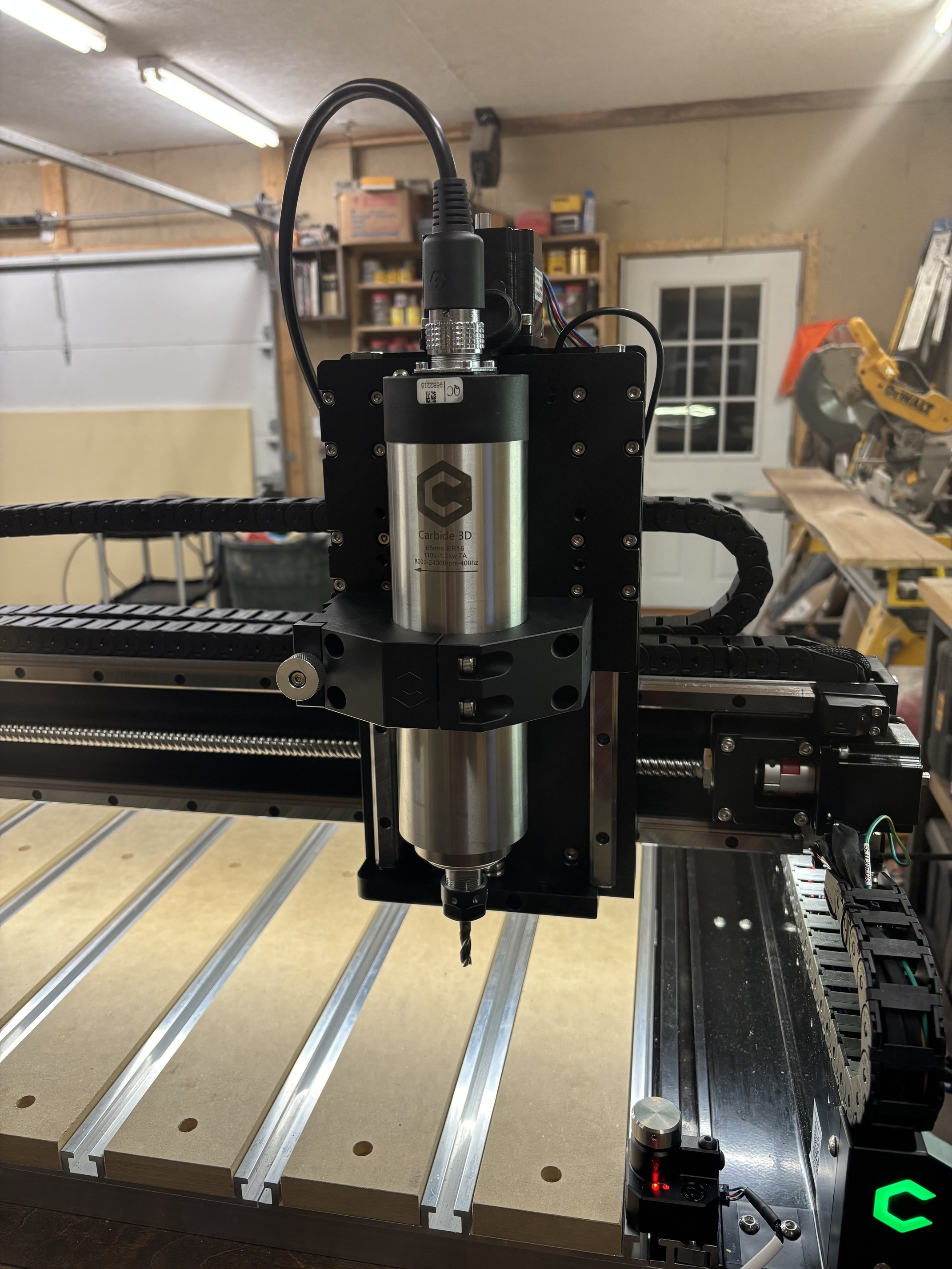

So! Got my Shapeoko 5 pro setup in place over the weekend. Yess!!! So very excited! Spindle arrives today (Monday) just in time! Yes yes!! Get it all installed and the machine ready to go, software installed. Start watching the training videos…the machine is on and moving around :partying_face::partying_face::partying_face:

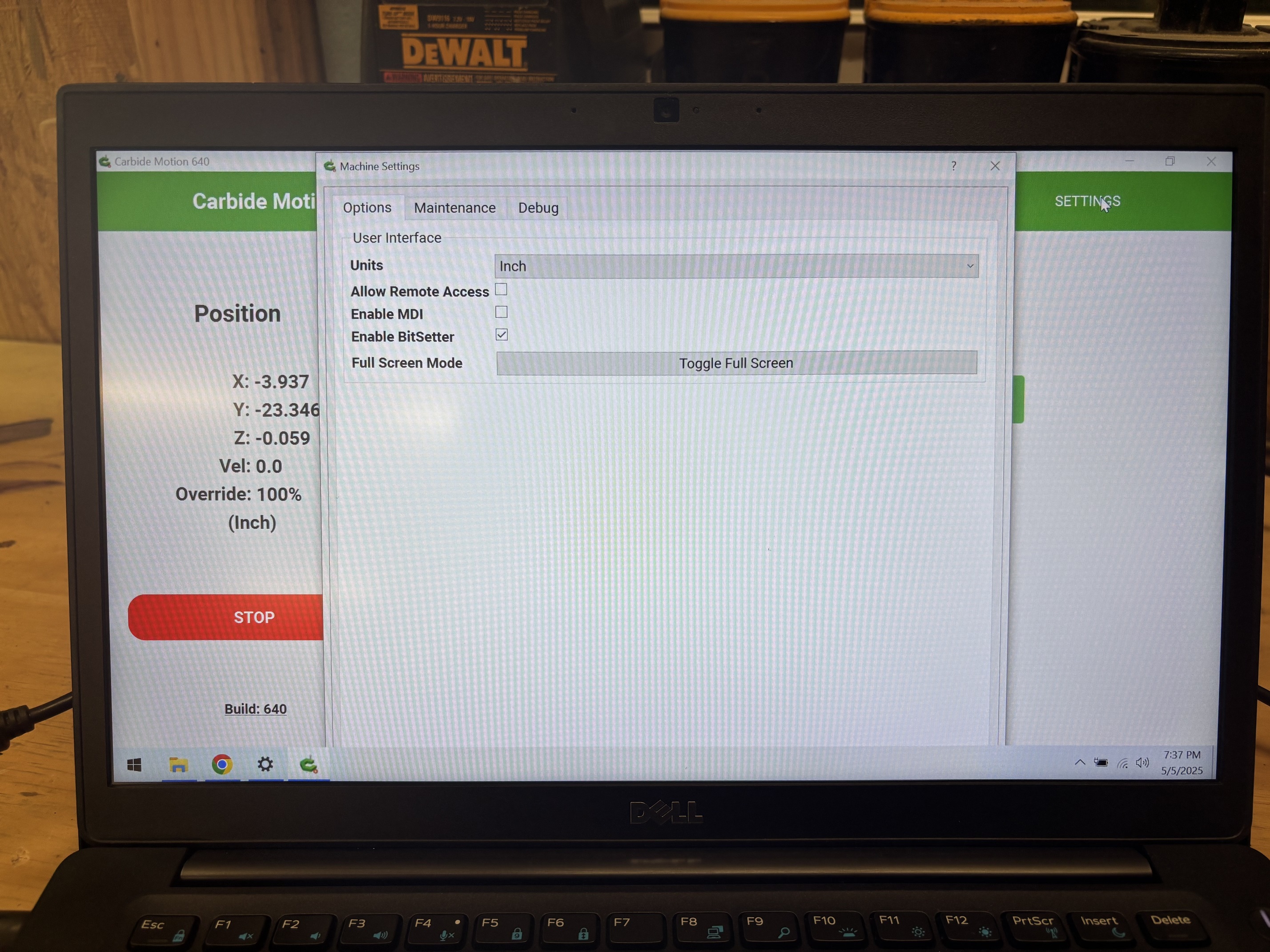

Then…stall. As I’m watching the video(s) my carbide motion doesn’t have the same options as what the videos are showing. I am able to fumble my way around the software and the machine. But finally, I’ve given up fearing that I will ram the new sharp bit into the metal frame (which I nicked once :flushed:).
Pics show the setup I have. Literally, all I want is someone to point me to an accurate tutorial that walks me step by step using the carbide 3d equipment that was sent to me.

C3D has a complete series of beginning videos, they were very helpful when I put my S5Pro together. Go to the ā€œjogā€ tab in CM and run the machine around on the jog screen. You can leave the bit out until you’re more comfortable moving the machine around. It just takes using the software to get used to it. The screen you show above is used very little in my case, I only use to disable the bitsetter for very specific operations. You normally will not use it, usually only Run and Jog (at least in my case).
