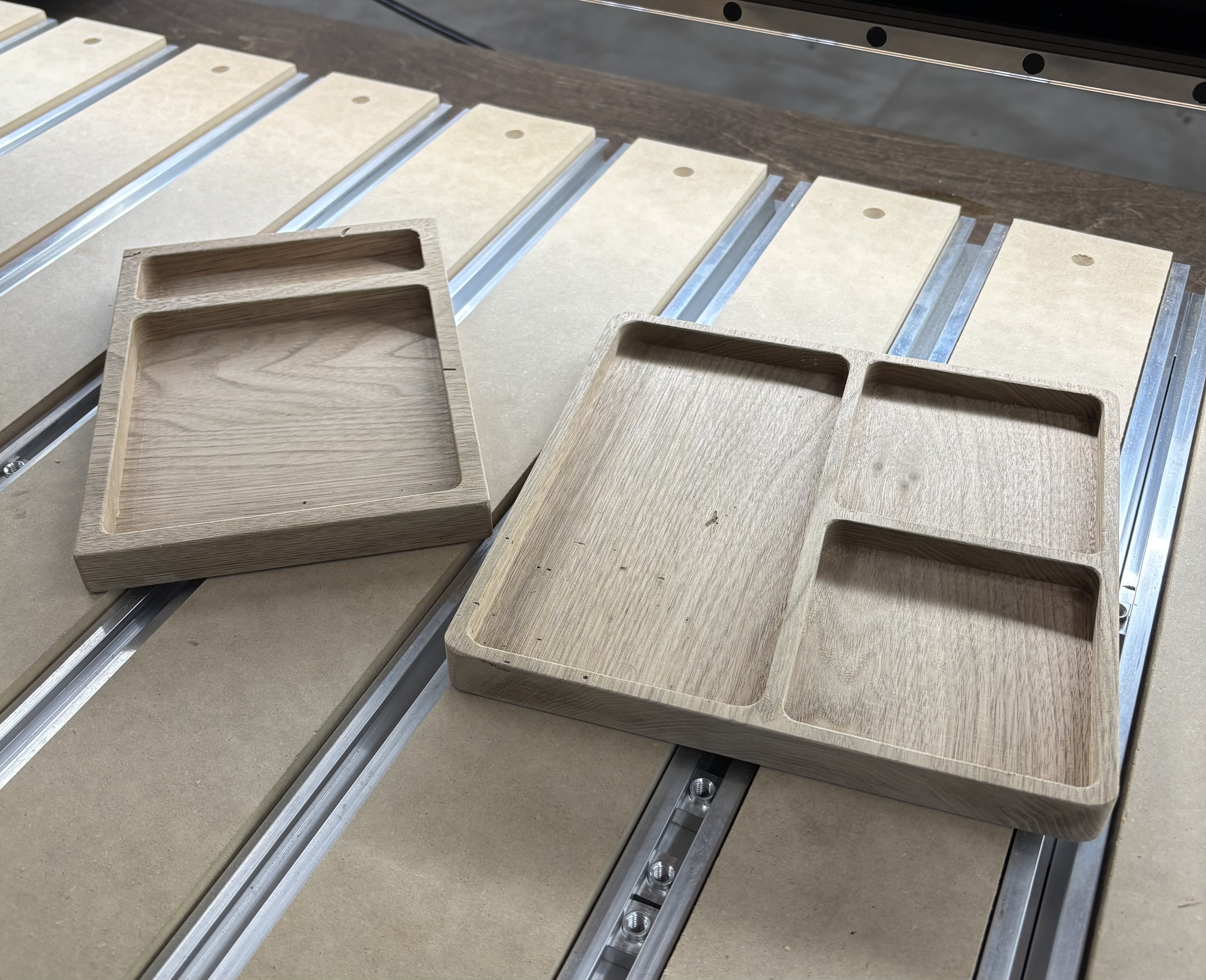

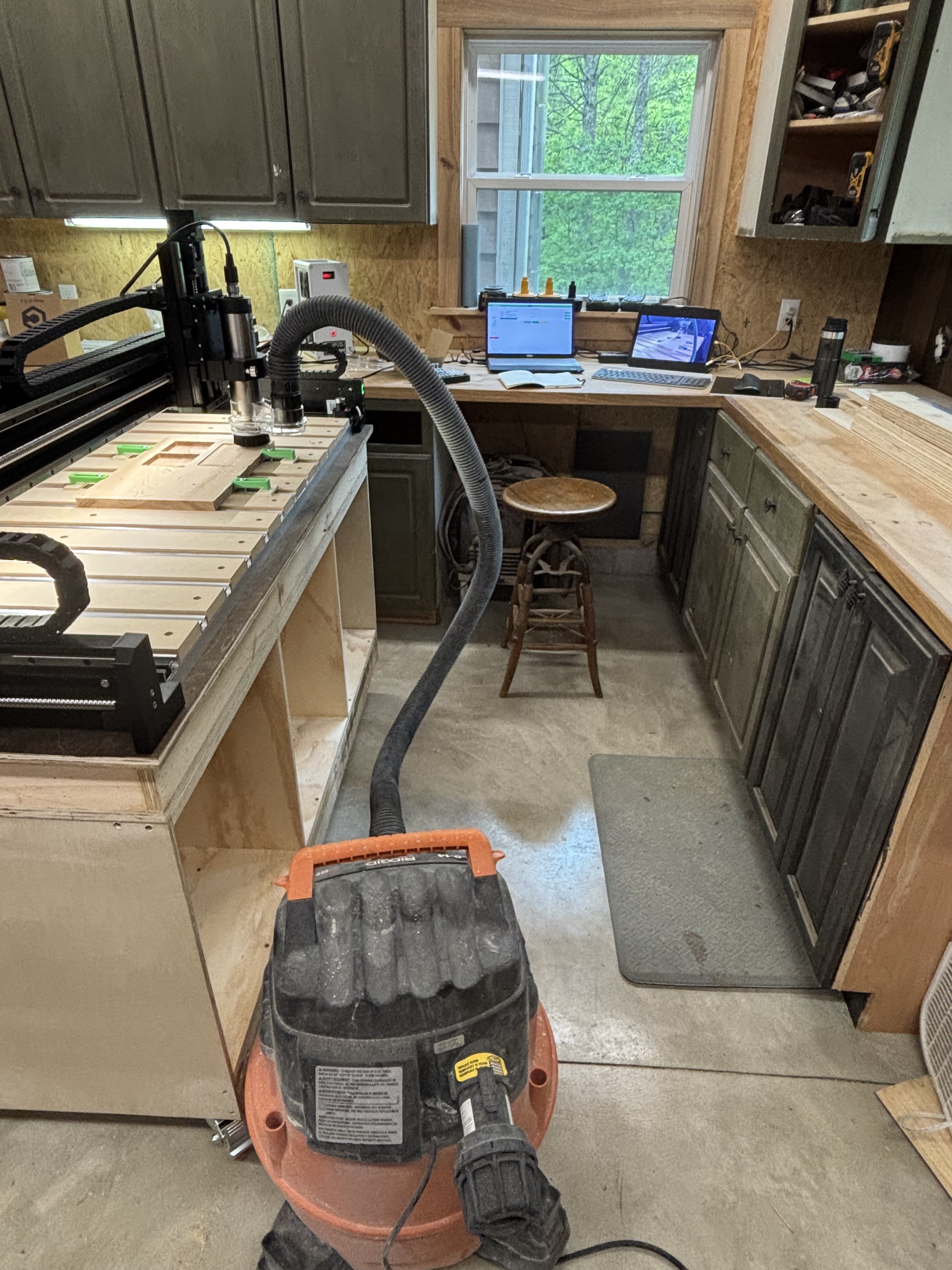

This is the kind of work space I want all the time. And my first project from the jumpstart tutorials with my and my wife’s spin in it. That is Butternut if you are at all wondering.
The first project from the Shapeoko Jumpstart Tutorial…with my wife’s and my spin on it. From Butternut

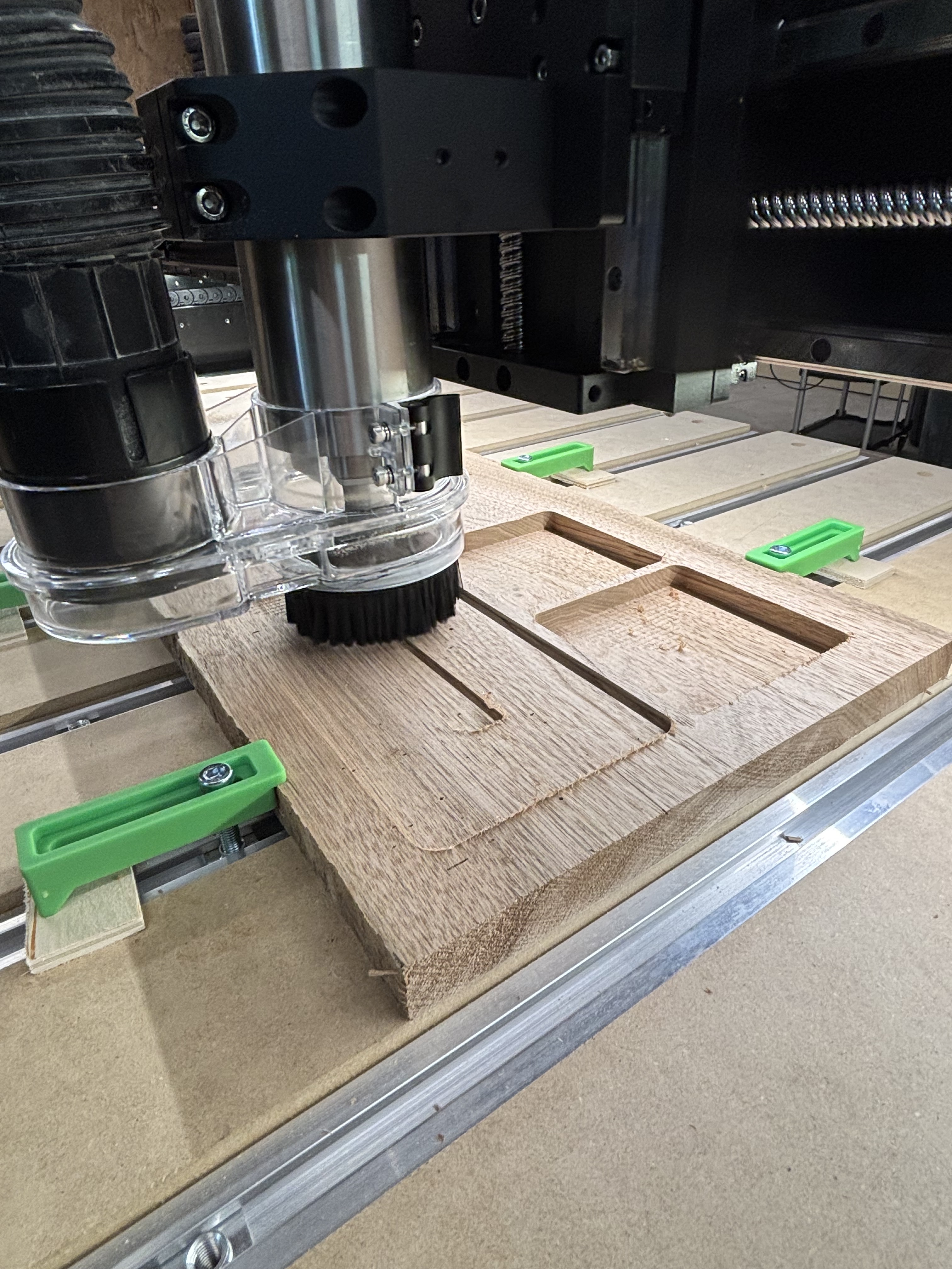

As I’ve continued to progress through my learning, I’m starting to realize the value of zeroing of the table. Which method do you prefer?
Have you flattened the table yet?
@Redlander it honestly didn’t cross my mind…needed?
I would if you want consistent surface to clamp to and zero off of, especially if you set your Z axis zero to the surface of the table. All types of wood and MDF can absorb moisture. I live in central Fl and humidity can be an issue. Another reason to flatten the table. It’s not hard and more importantly teaches you more about your machine. K Barnett has a file uploaded in C3D CutRocket and you can download for free. It’s specifically for your machine.
As of now I zero Z axis off the top of the stock 95% of the time.

I prefer to zero from the table and then putting in the exact thickness and let the machine do the rest of the work for the project to be planed down, and cut to the design I have. Now, I do still zero from the top as well when I have a design and only want the carving to go only so deep in the material. Doing the top zero helps with being able to have the thickness I like for backing material or to be able to come in and cut insert tabs so I can add a different species wood as the border. I can cut this design feature on my table saw.

One very important thing you need to check, if you haven’t already, is your machine squareness. The assembly of the machine does not automatically square up your machine and table. You need to do that at the beginning so your table is true square to your gantry and spindle.
It would also be wise to tram your spindle to make sure it is as close to perpendicular to your table as possible before surfacing your table. If your spindle isn’t perpendicular to your table, no matter what you do, there will be step lines in your passes. Some users have gotten lucky and when assembling their table, they got a really close tramming of their spindle without even realizing it. Other users might not even care or worry about tramming because they cut more openly with designs that will not even really notice these lines.
I haven’t leveled my table because I had to move my machine in my shop and my floor isn’t level. The person that finished the concrete in the shop did a terrible job and it is out of level anytime I move anything in the shop that requires a level floor. I was resetting up the layout of my shop and the area I had for my machine became the incoming area for my lumber material, and has been turned into my lumber storage at the moment. So, my machine is sitting on unlevel ground. I still don’t like where it is at and once I have the machine moved to the right area, I will have the table leveled completely again, and then resurface my table.
I was planning on remaking my table with drawers and areas for my electronics to be boxed in away from the open dust of the shop, but still have filters and fans in place moving air in and out of the electrical panel. I also will be buying the 80mm spindle in the very near future, so I have to build an area for the chiller to be stored and serviceable. Plus, I want to tie into my dust collector as well so I dont have a shop vac running all of the time on the job/designs.

Unlevel floors are HORRIBLE! The person who finished my shop floor did a terrible job, and unfortunately that person was me :cry:. I ended up getting it resurfaced by a professional and am SOOOO much happier!
As far as square, fortunately I watched the installation video and took to heart the need to square it. It was at least 1/4" out of square when I began the process. I spent quite a bit of time ensuring square to the 1/64" give or take a 1/128th of an inch…at least per my tape measure.
