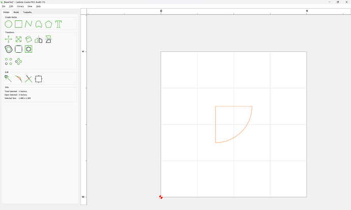

Help with rounding corners

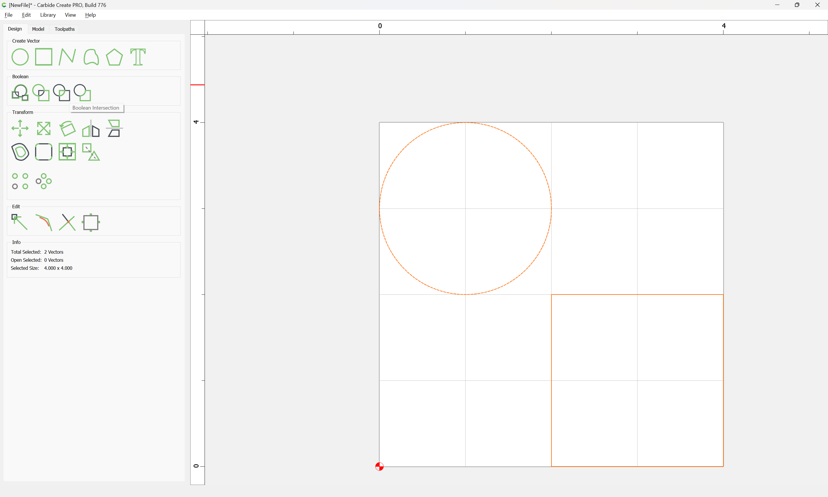

Can someone direct me in rounding these 3 corners?
TIA
See:
If that doesn’t help upload your .c2d file and we will walk through this with you.

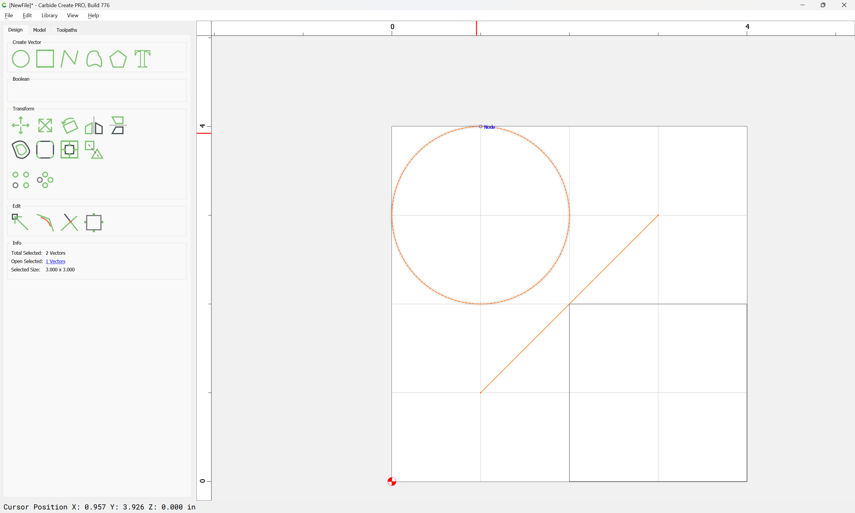

im having trouble i remembber seeing the boolean operations but they are no where to be found right now on screen

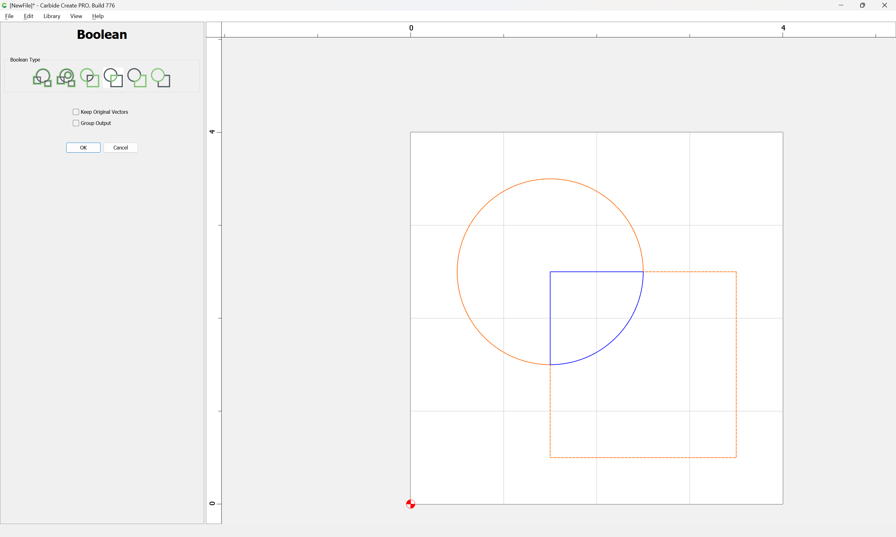

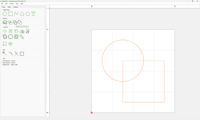

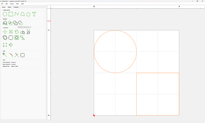

Boolean Operations will only show when two objects are selected:

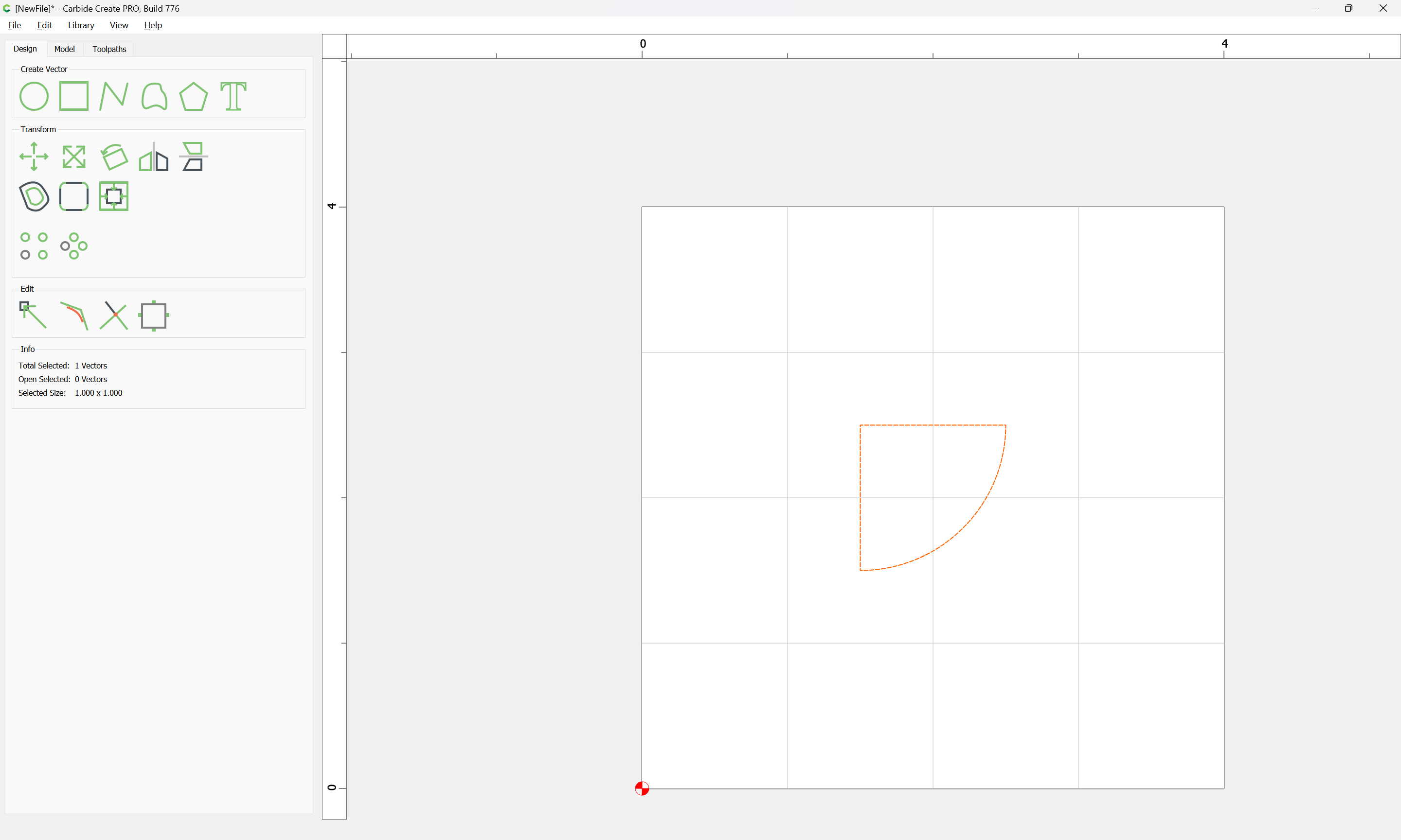

They will only be effectively employed when both objects are closed geometries which overlap:
