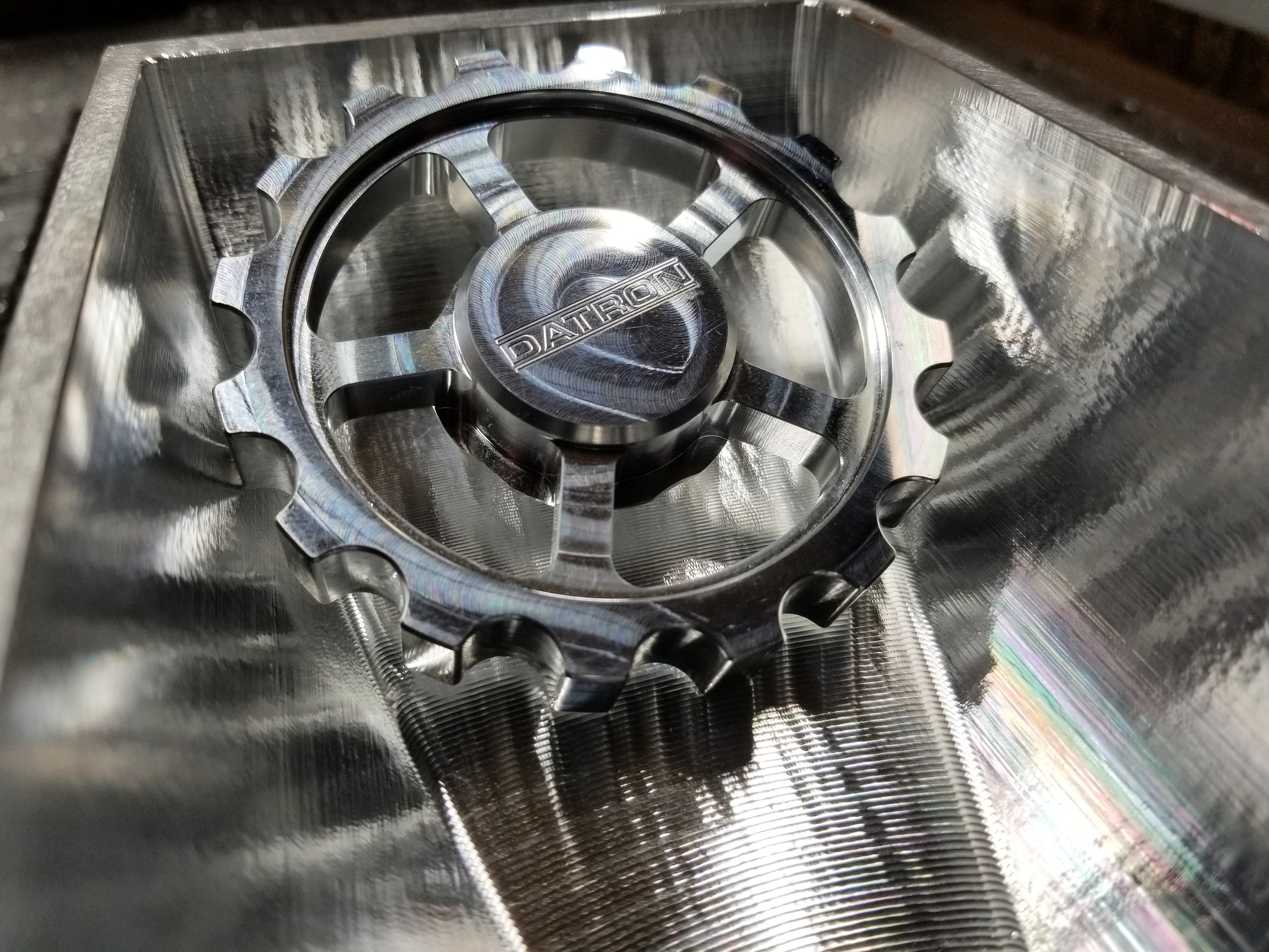

Well…just because…ha ha!
My only belt skip while cutting was in Z Solved that problem with Mr. Beavers HDZ design.
