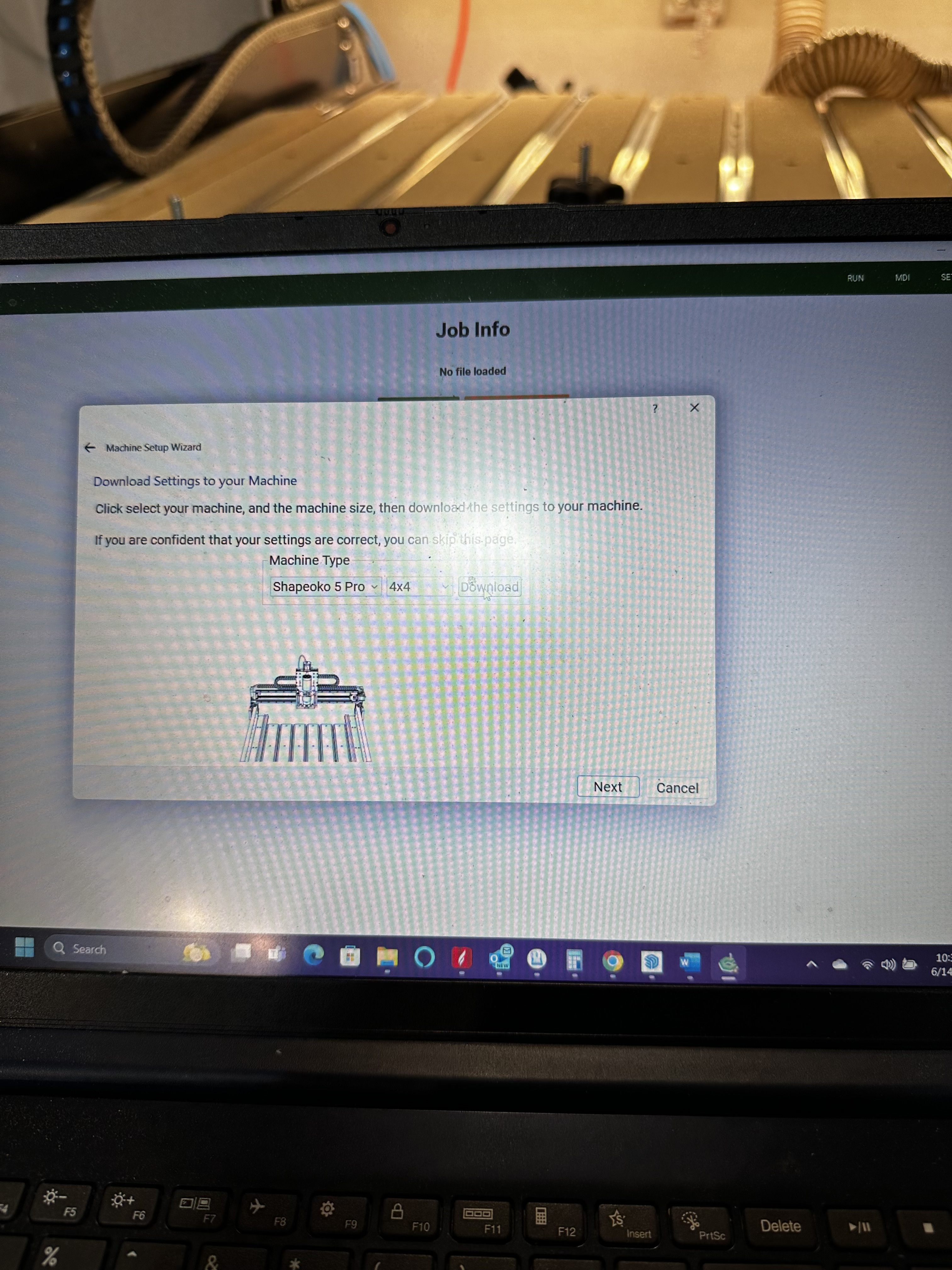

I’ve gone through setting up the new machine multiple times, I’ve checked the connections, but nothing seems to be working.

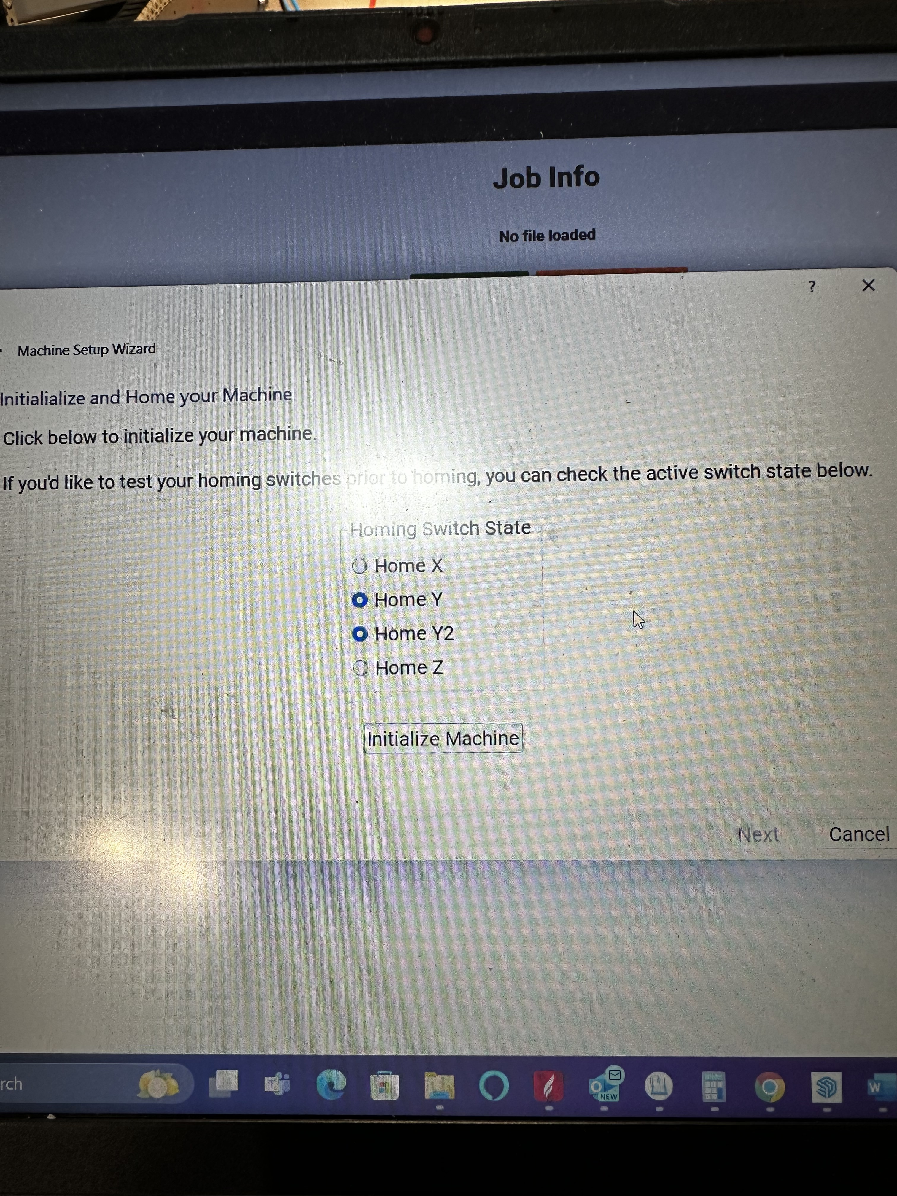

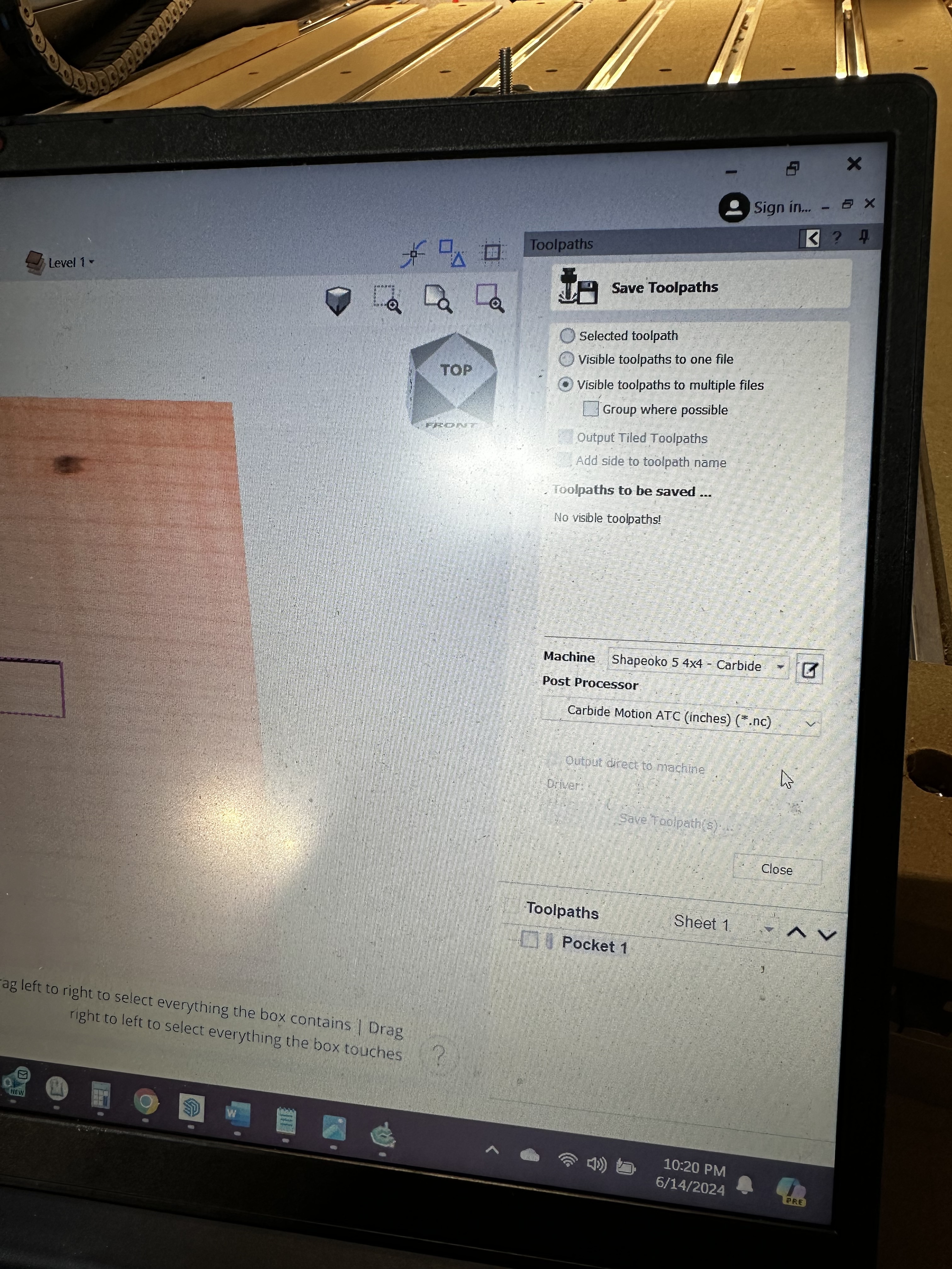

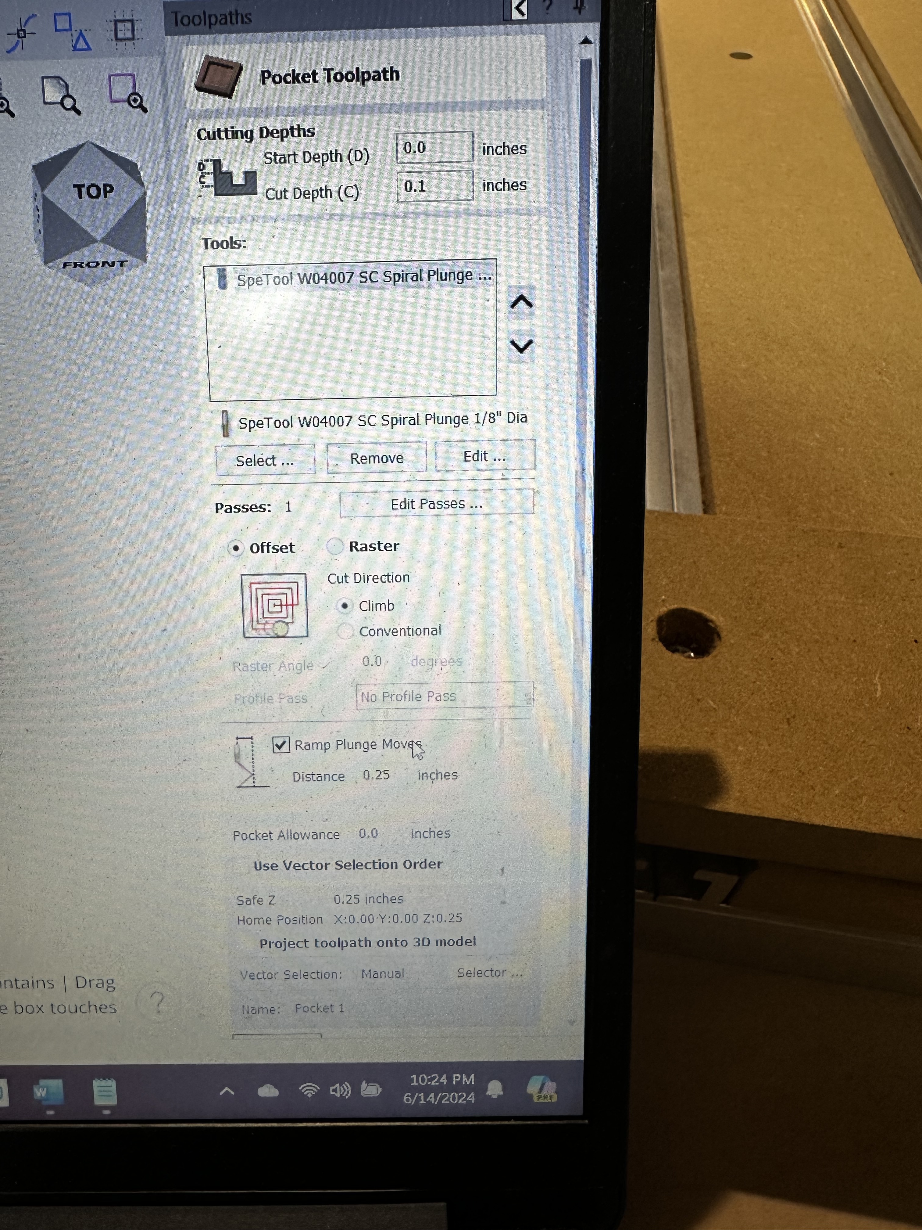

I attached to pictures of the settings(it won’t let me upload video, but I have that too.

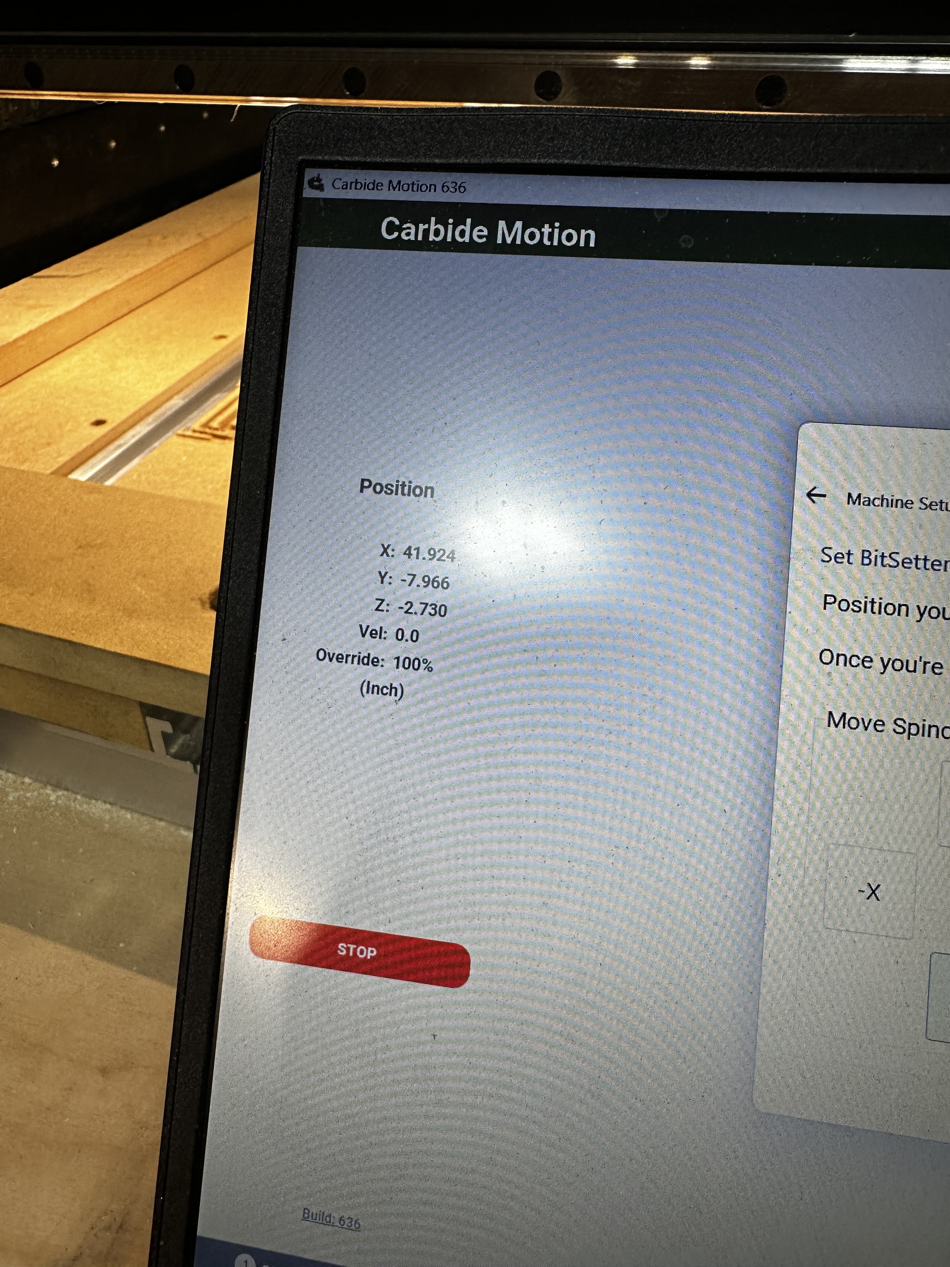

With the z all the way up it’s only showing a z height of a little over an inch.

I figured it must be an error on my part since I don’t use Carbide Create often and the file was from Cut Rocket.
Then my son asked me to cut out some lettering for him to make me a Father’s Day present. I drew it up in Aspire with a single profile tool path to cut out some letters and stars and the same thing happened.

I’m not sure what the XYZ is supposed to be after Initialization, but I’m pretty sure that the Z should read higher than 1.67" when retracted all the way in the positive direction.

@WillAdams - here’s a video of it running through the homing process and another of jogging during the “set up new machine” process. Everything looks like its functioning as it should, but the z height readout on the Z doesn’t seem right to me.

Then running some suggested tests, my Z-Axis homing switch stopped functioning.
Support had me switch the X-Axis switch with the Z and test to see if debug was recognizing the switch. It was. So it was determined that it was a bad Z switch and they mailed one out to me. Has not arrived yet.
I had a spare switch sent with the machine, but the wires came out of the pins of the switch that came on the machine, so I had to use the spare during setup. So I had a spare, but it needed two pins.
While I’m waiting for the new switch to be sent out. I bought the tools and pins and replaced the pins on the switch that had come with the machine.
I installed it on the X-Axis, since support had me swap the x and z out to test the switches previously.
I fired up CM, connected to the cutter, went to debug and tested all the switches and they all triggered. Iit up red at the switch and blue in debug.
Yay, happy again!! Went to initialize and the Z moves up and just grinds at the top then fires an error saying home error, which can’t be found. GRRR.
Mind you, the z switch is the old x switch, which I didn’t do anything but swap from one position to the other. The x switch is the one I re-pinned and it’s not the switch that is having a problem and CM debug is showing all switches functioning correctly.
I’m going to wait until the switch they sent out gets here and try again, but I have no faith that the real issue is in the switches.
