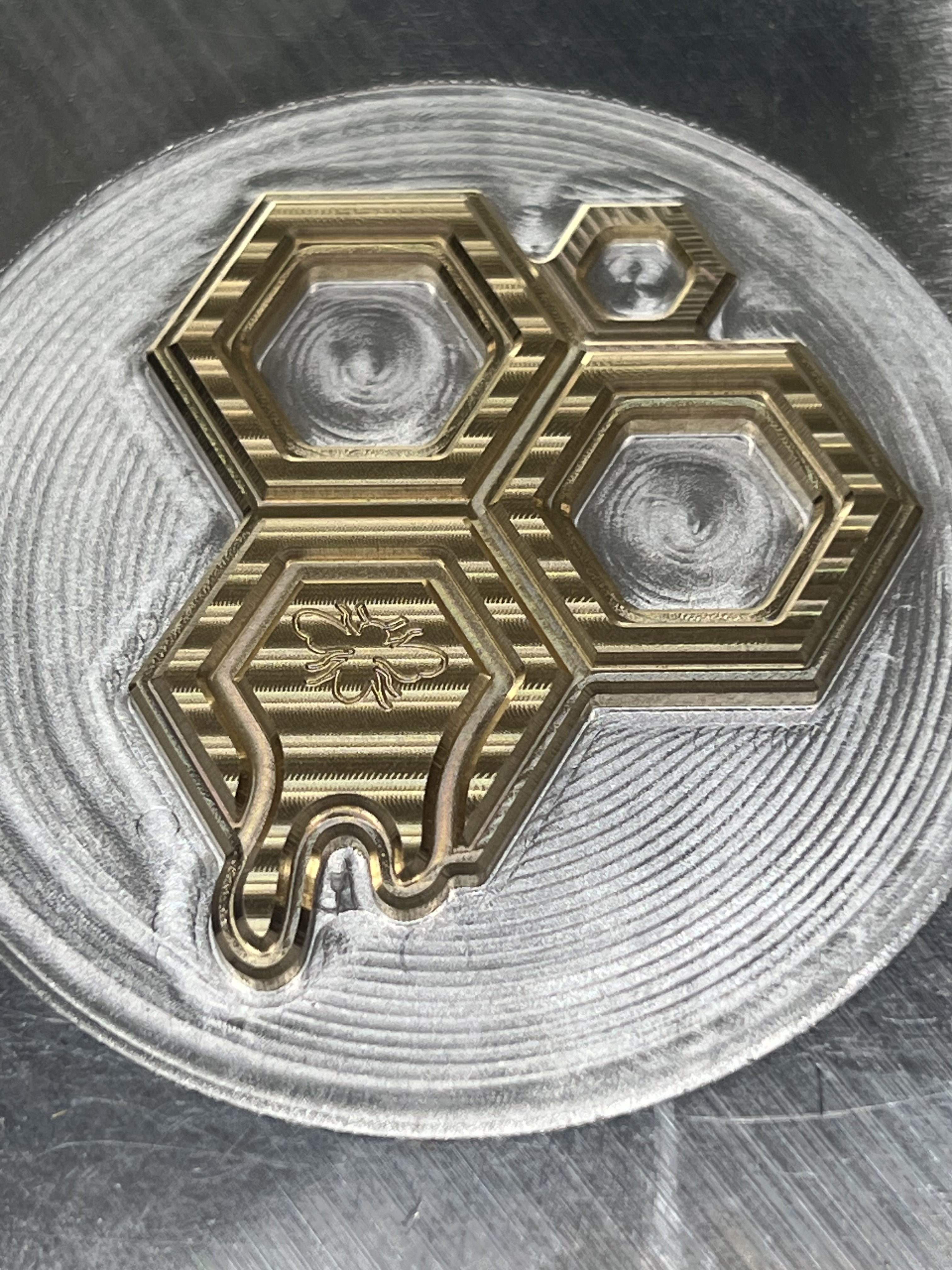

Workholding was thin super glue to a small piece of sacrificial mic6 aluminum. The sacrificial piece was then held securely in a vise.
I was a bit worried about the sudden full engagement once the floor was hit but it did not prove to be a problem.

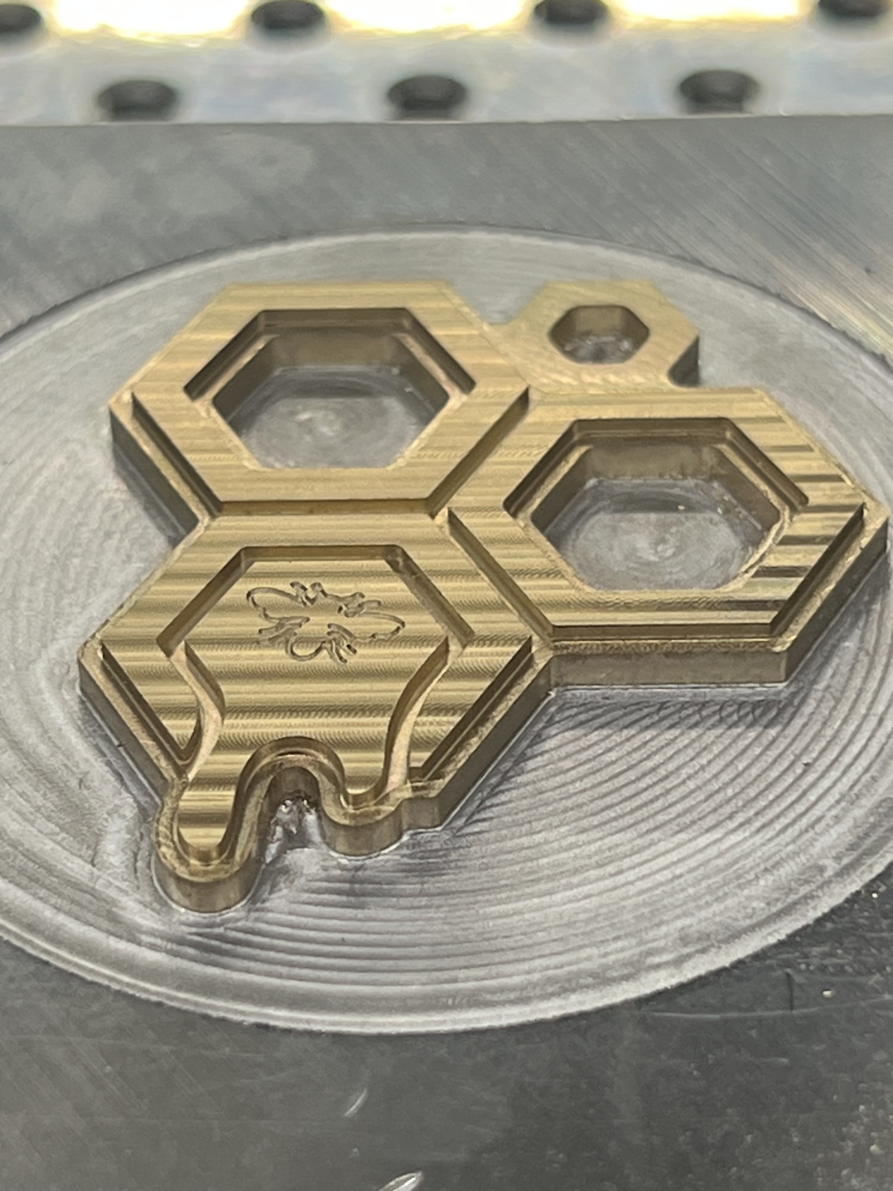

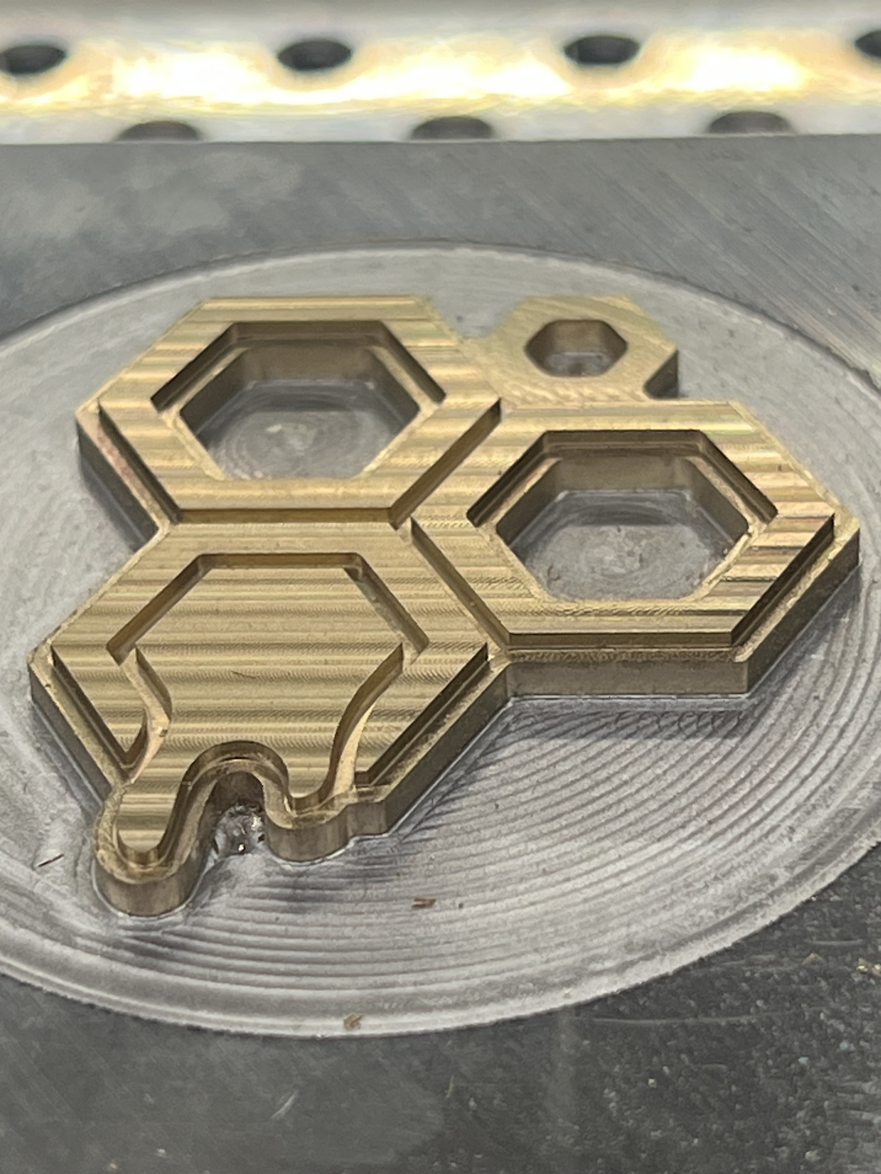

OP 1 was facing and an adaptive toolpath with a 1/8” two flute.
I also did a drilling operation on the keychain hole to clear the bulk of the material.
Basically just as much bulk material removal as I could with the (relatively) chunky tool

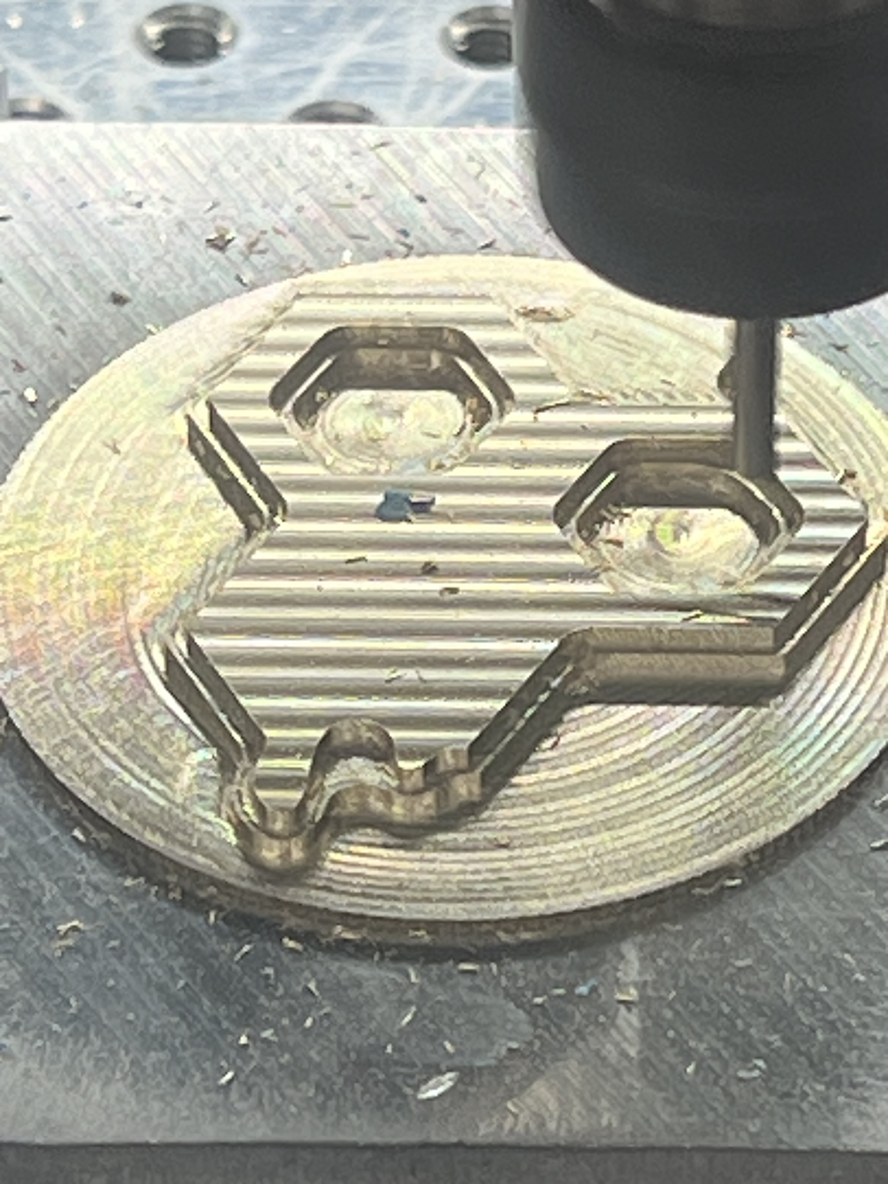

OP 2 was a tool change to a 1mm two flute. A ramping contour along all of the edges clean up the corners that the 1/8” couldn’t get. I wanted the features to look crisp.
This tool also defined the honey drop in the bottom comb which required a ~1.1mm slot.

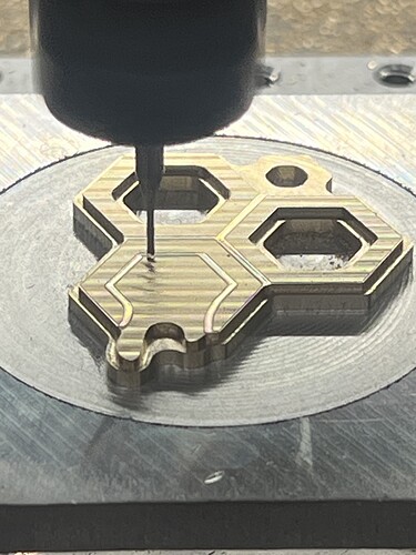

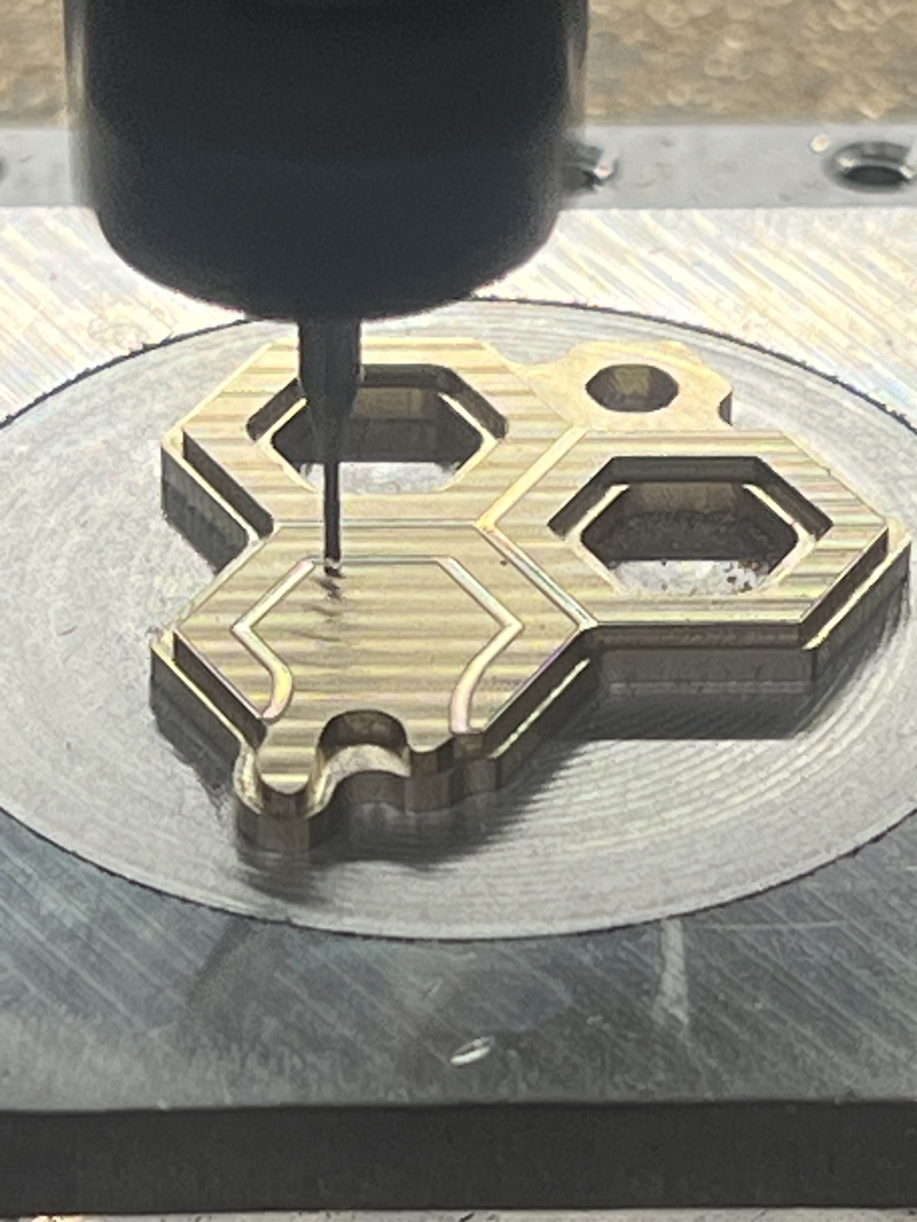

OP 3 was a tool change to a tiny engraving/chamfering bit from precise bits. It was used to chamfer all edges and to engrave the bee.
The chamfering just provides more visual interest, allowing a bit more play for the reflections of the polished end product.
The intention of the bee engraving was to go deep enough that the nickel plating would stick around when I lapped the top surface. A subtle highlight to the engraving surrounded by brass.

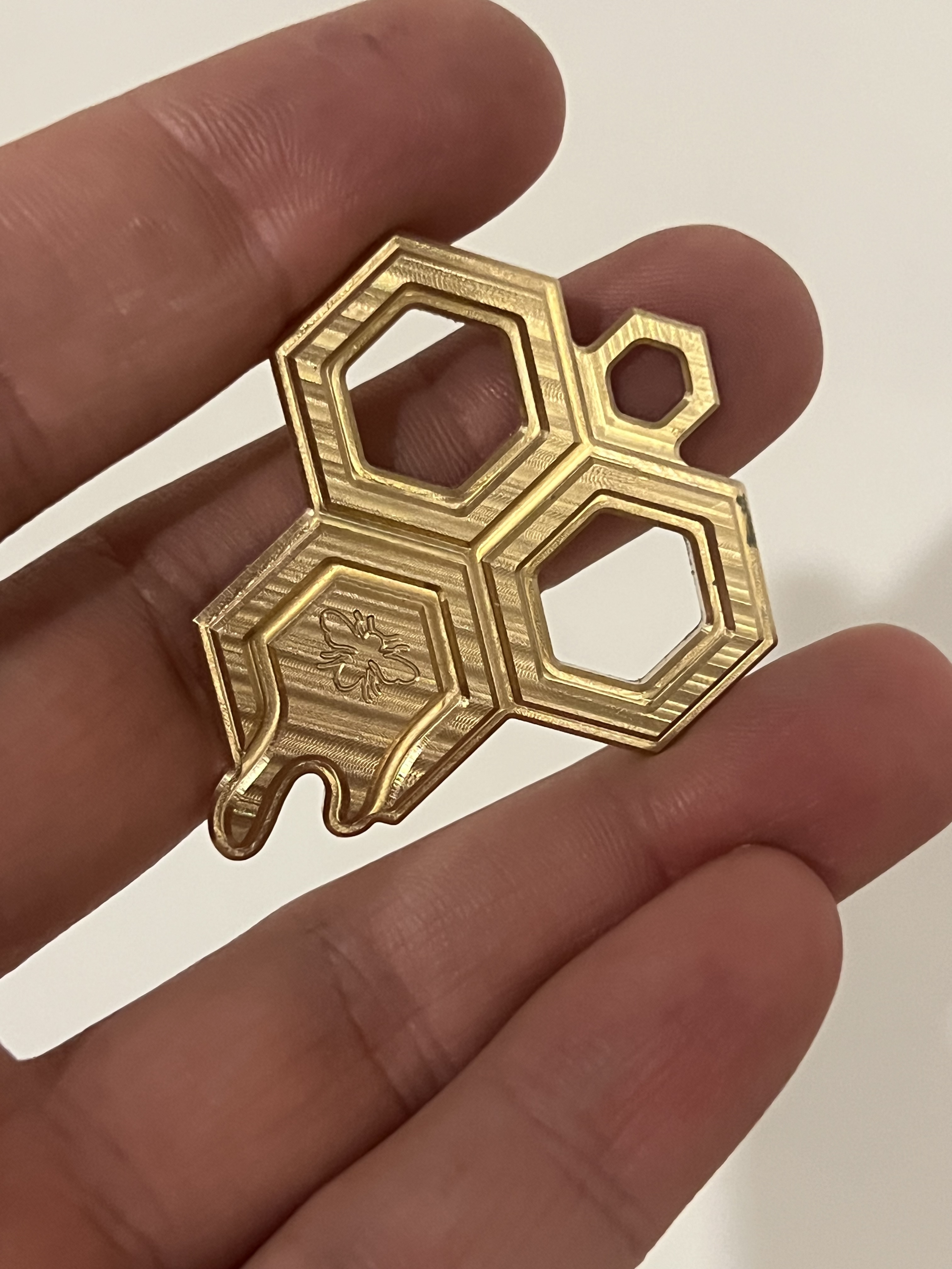

That’s it for the cutting, now on to the hand work.

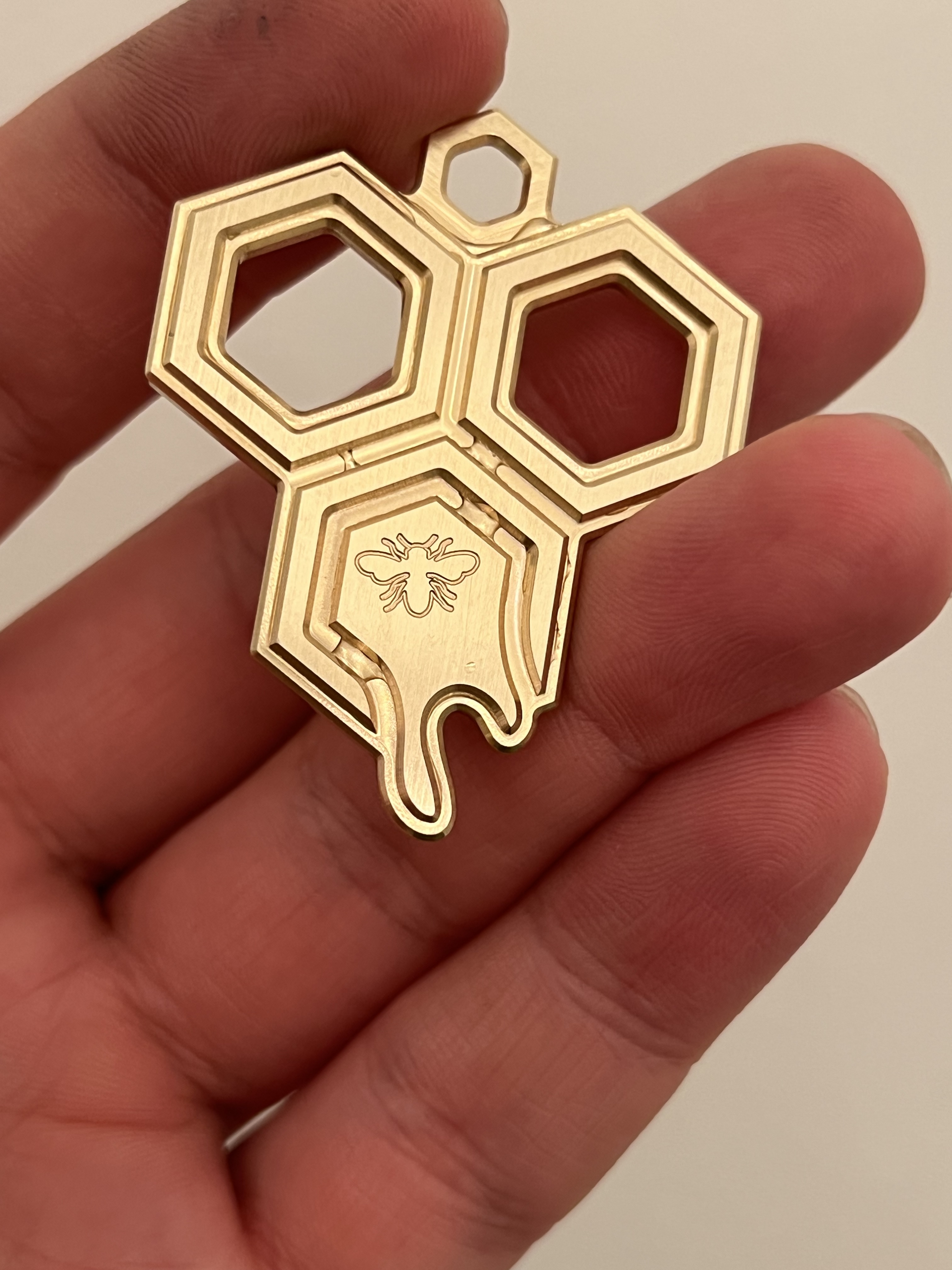

A fine grain radial flap disk broke all of the edges and gave just a touch of rounding to the crisp edges. The rounding isn’t strictly necessary but I figure reducing stress risers and areas where the nickel may start to flake would be a good idea.
Then came the lapping of both sides of the charm. I wanted to get a mirror polish on the backside and ensure the front face was as flat as possible with no tool marks.
Lapping was done with adhesive backed lapping film on float glass. Usually used for honing knives, it was nice to not deal with diamond paste. A more pleasant lapping experience.

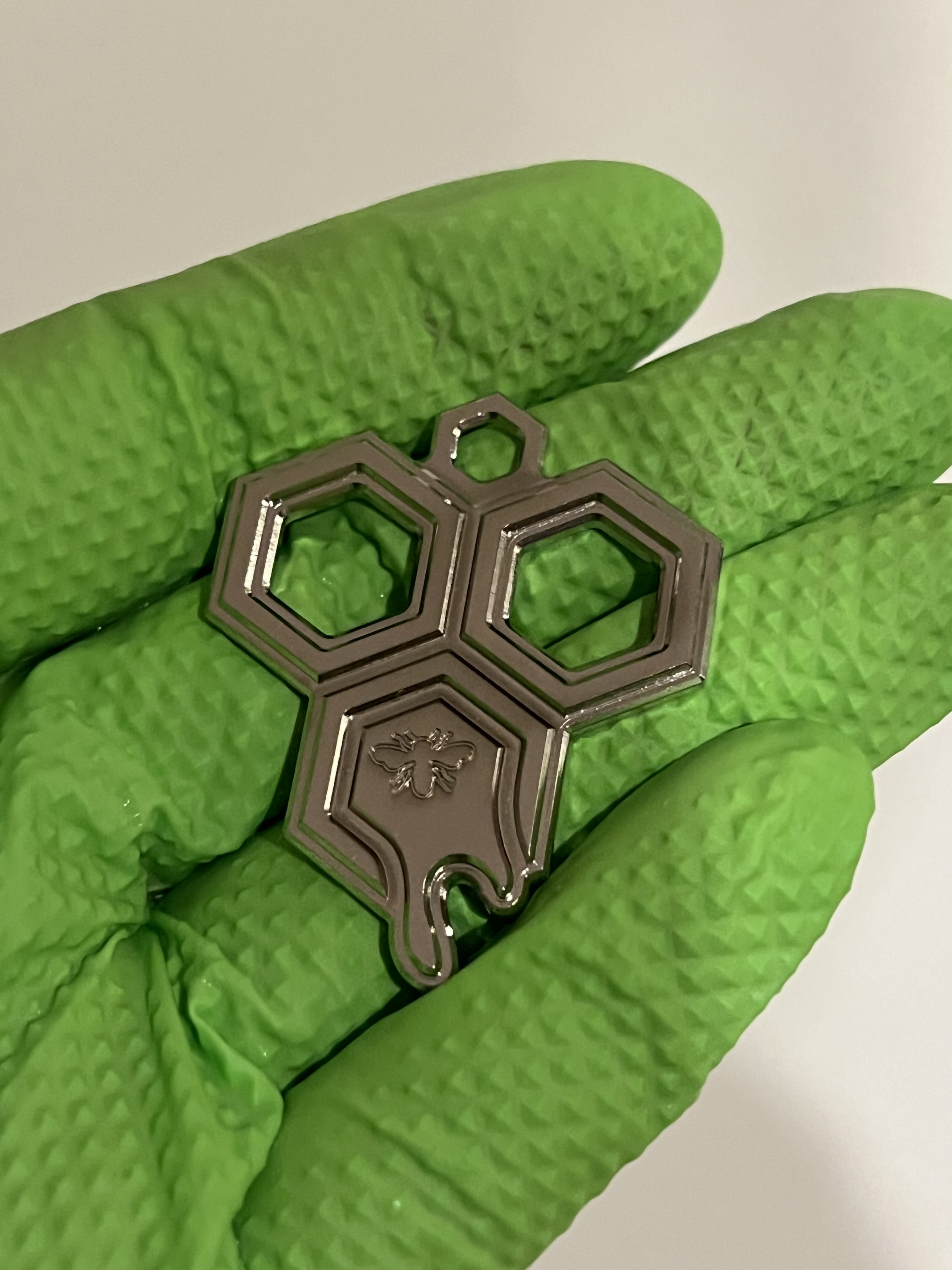

Now it’s on to cleaning and nickel plating.
A bath in acetone to get everything squeaky clean, drop in RO water, then a dip in the electroplating solution at 4v for a few minutes.

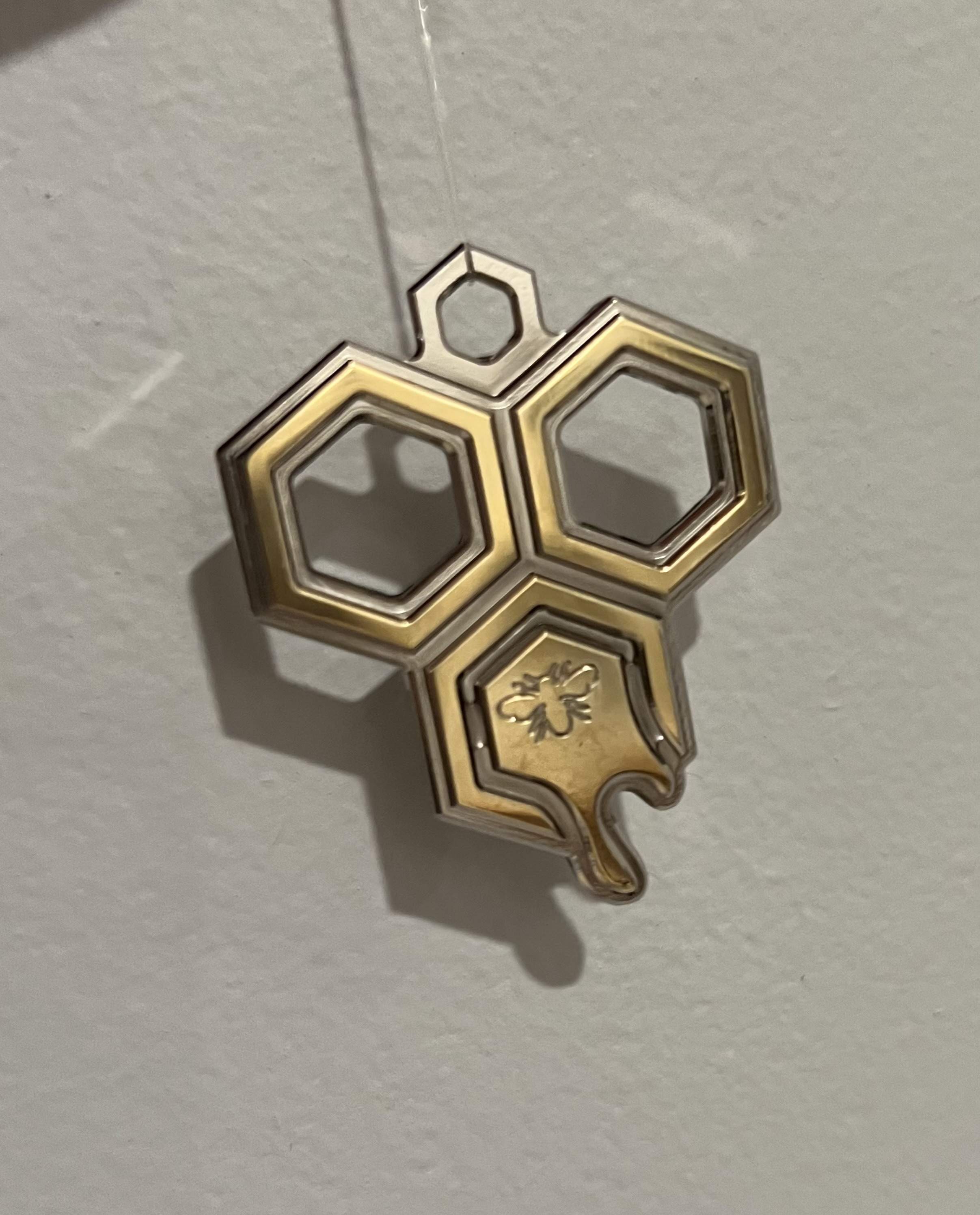

Now that looks pretty good already but that’s not what we’re doing here…we can do better…hopefully :slightly_smiling_face:

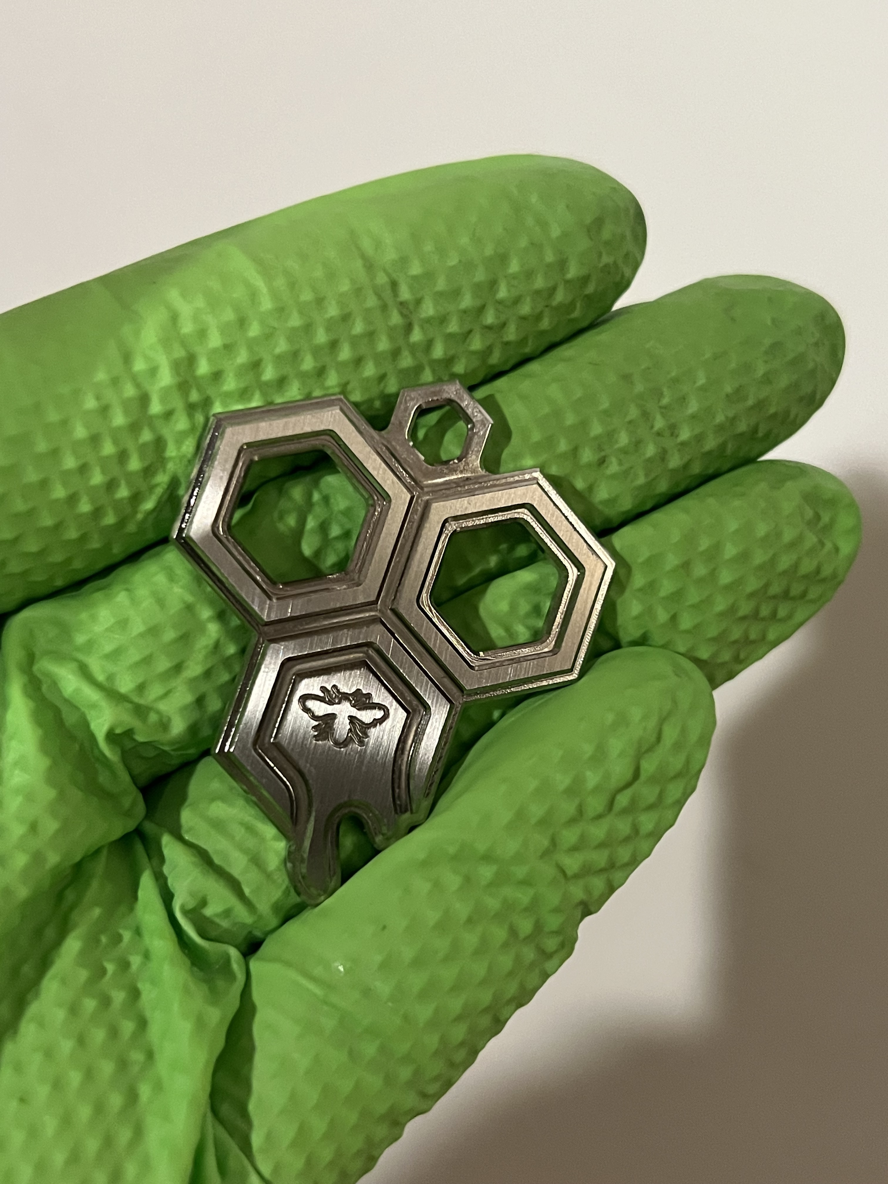

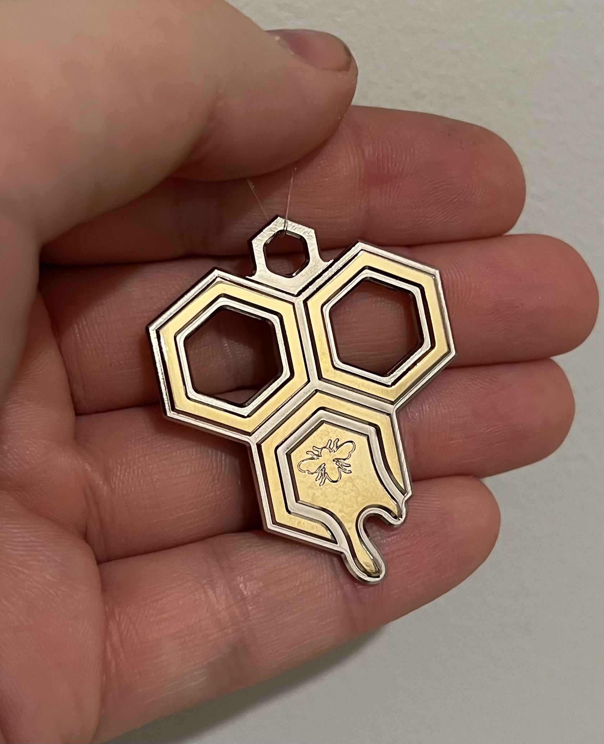

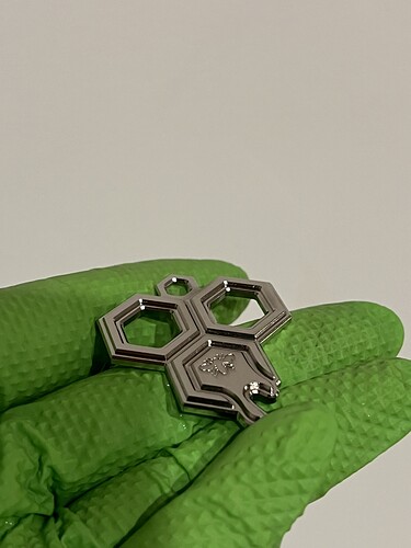

Last step, lapping the plating off of the top face.
This was a slow and steady process with frequent stops to check progress.
This photo is after a few swipes on the lapping film, it had more impact than I thought. I’ll be playing with this more for sure.
It worked exactly as I’d hoped and brought out some awesome contrast, especially so in full spectrum lighting.
Ok actual last step now was a final polish on a firm felt wheel. Just to make everything really pop. I also intentionally hit the honey drop to give it a more organic rounded surface. (Thanks to the wife for that suggestion)

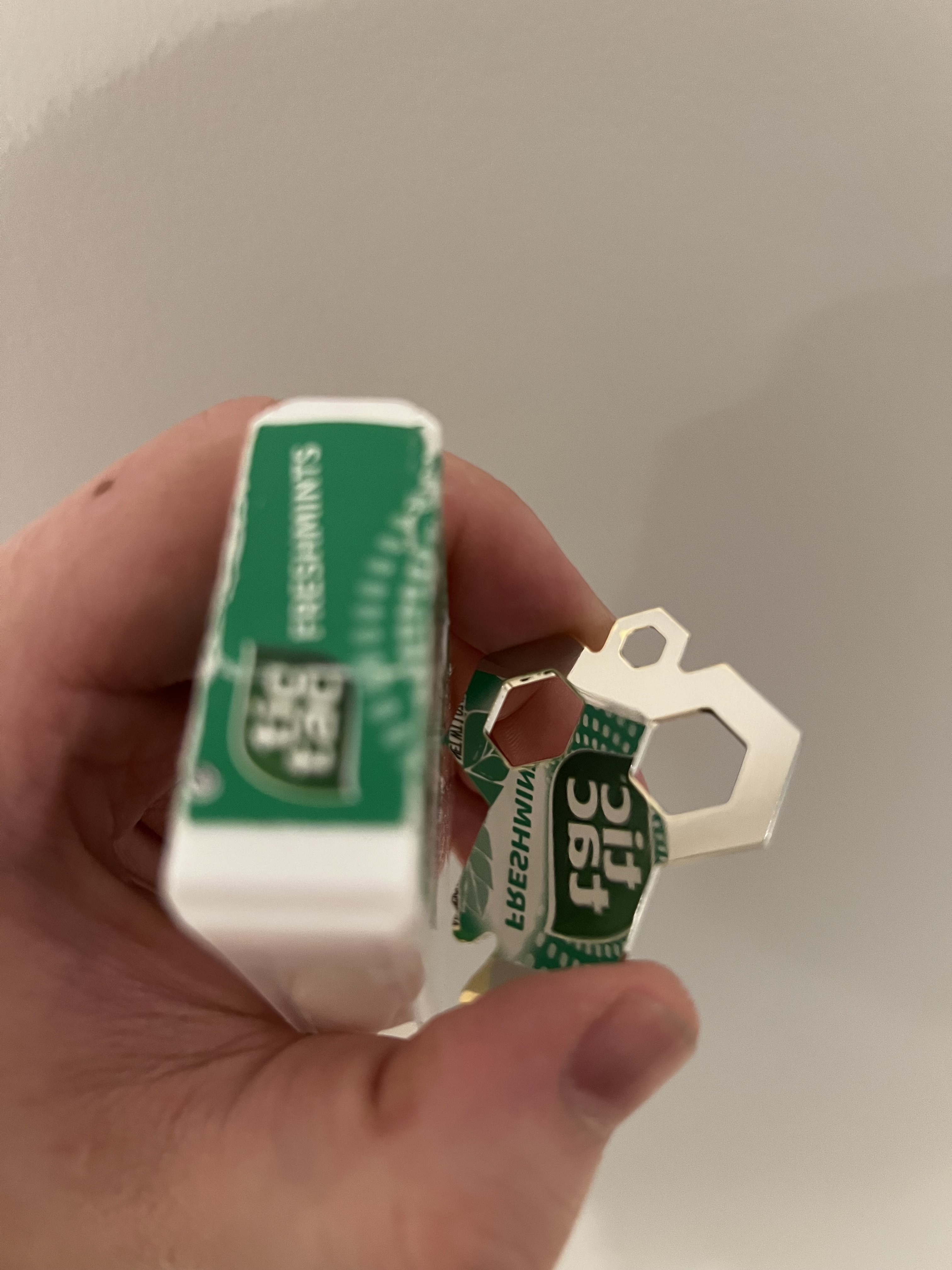

I’ve been practicing my polishing and I’m getting better. Here are some tic tacs for reference. I did go through the plating a bit in a few places but it’s not worth replating and starting the lapping over :sweat_smile:
I was going to do some laser engraving and drop a gem somewhere but that just felt busy. I’m pretty chuffed with how this turned out as is :yum:

Would you spec this? I’ve got some coin material that I need a plan for plating.
I’ve used diy nickel plating solution but it’s never come out quite as mirror like. Super cheap and easy to make though with plenty of online resources/YouTube videos for different recipes.
This piece was done with EarthCoat Nickel Mirror that I bought from Pepe tools: EarthCoat Cyanide Free Bath Plating Solutions 1 Quart Bottles – Pepetools
Caswell also produces a high quality product and might be easier to get (I’ve not used their nickel solution personally though)
The part has to be very clean, any oils or debris on the surface will show in your plating.
The plating solution is heated to 140f, set the power supply to 3.5-4v, anode is a piece of pure nickel, cathode is the work piece, let it sit for about a minute.
If you need to rinse it, use the purest water you can find (usually reverse osmosis from the local grocer is easiest to get)
I use a lab power supply and a heated stir plate to prevent bubbles catching on the surface of the piece but it doesn’t seem to be too finicky. You could probably just move the workpiece by hand since it’s such a short plating period. The heat also didn’t seem to matter too much. You could try with no heat first and see how it works before investing in any equipment. (That said, heated stir plates are dirt cheap)
