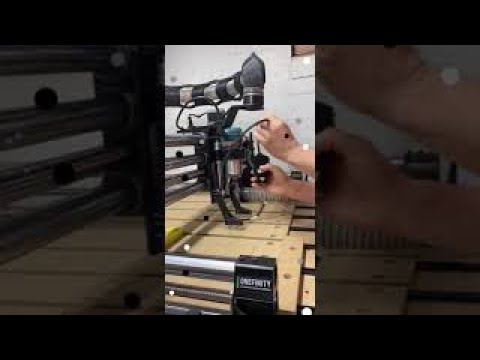

I’ve been considering doing a play on this following example for the articulating/jointed arm but rather than only be supported by one end (anchored to a wall) it is also supported at the spindle end (a part that has no Z travel).
Neat, I like that! I’ll have to think about implementing it.

After seeing that oneinfinity dust extraction arm, I am attempting my own. I am going to make a plate that mounts under my Z stepper and extends out to mount the expanding hose to the dust shoe. I ordered a swiveling 45 from the Rockler Dust Right Flex Port system. I have some aluminum bar that I have cut into sections and will make links to support the hose. The aluminum will be supported on both ends. Wish me luck LOL
