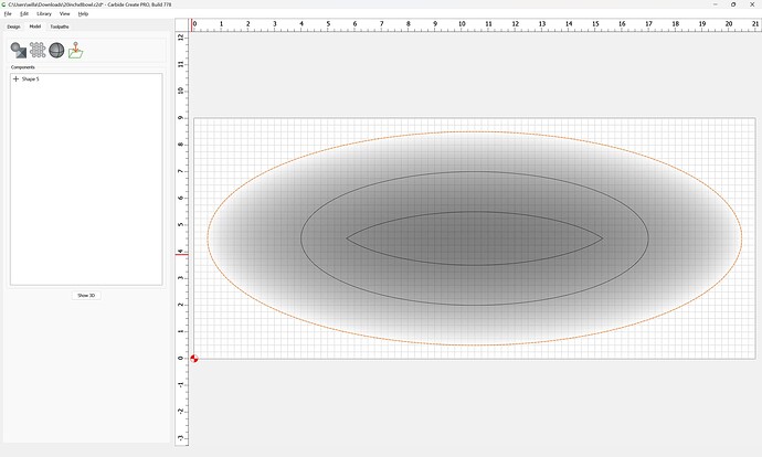

So I successfully managed to Model the top of an oval bowl. I figured out the Subtract command.
Having trouble modeling the bottom of the bowl, leaving a footing. I’ve tried all the commands I think possible Height Limit, Merge Type. Attached is a pic that’s as far as I can model.
The stock I’m working with is 2.75" high. The oval dimension is 20"x8", the footing is 13"x5" and I’d like it rounded from the footing down to within .25"(base height). Using a 3/8" ball nose.
Can anyone show me what I might be missing in the Shape menu’s? I’m thinking because the area of the contour is outside of the footing it’s not possible in Carbide Pro.

Upload your file and profile drawings of what you are trying to model?
20inchx8bowl.c2d (136 KB)
I’ll work out a profile drawing on Fusion 360 and upload shortly.
I screenshot my fusion screen. Best profile I could come up with. The radius is not set in stone.

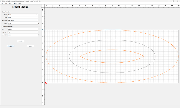

To model a similar shape in Carbide Motion you have to inset by twice that dimension, then model in the round.
so select the inner geometry and inset it again my that dimension:
Apply
Then select the original outer geometry and the offset inner geometry:
and model them as a rounded form:
Except that the inset is not even:
which the current version of Carbide Motion can’t work with — an alternate approach would be to just model the entire rounded form (after increasing the space around things)
adjusting settings until a reasonable form is arrived at:
Done
Note however that we want to be doing this in the new v8 beta:
because this then affords the option of right-clicking to “Create Outline Vectors”:
which outline we can use to flatten the bottom of the bowl:
Apply
