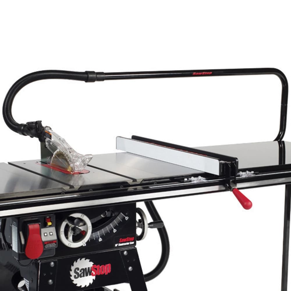

Do you have both the cabinet connected to the vacuum as well as the overarm collector? That overarm collector makes a huge difference for chips. Even with my industrial 3hp DC chips will leave the back of the blade and fly towards you…That’s where the overarm unit is effective

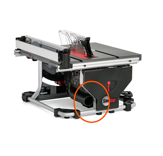

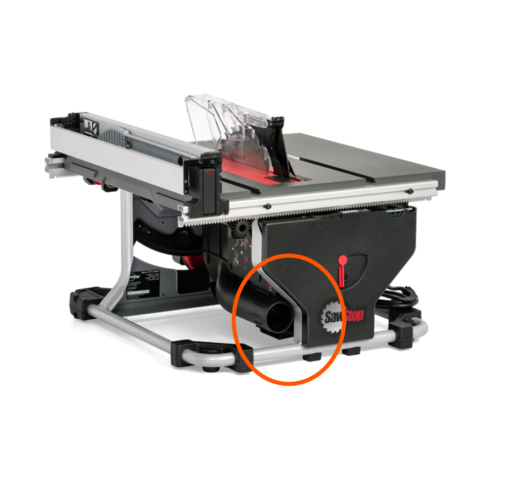

the vacuum is this here:
in my shop it works well, it has a “auto-switch” power supply, what I love. And if the bag is empty it sucks nicely. I think. Can’t compare.
The vacuum is connected to the back dust port of my small Compact type table saw, of course with a reduction piece.
I do not have a overarm collector vacuum hose.
I had a home depot table saw before, and this item did not throw the chips on the floor that much, the under the table connector kept it rather clean.
It is not so much of an issue as just an annoying inconvenience, I do not use the table saw that often, rather briefly, and always have to sweep afterwards. For a lazy guy like me that lets me ask.

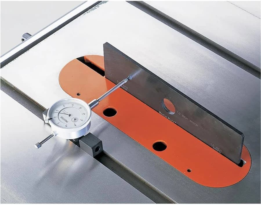

I use this system to line up my saw and others.
There is a very flat plate you put in place of your bade and a jig that holds an indicator to help align your blade to the miter slot. Then you just move your fence to the miter slot and adjust it to line up with the miter slot.

Above-Table Dust Collection (Overarm Guard)
  • Floating Overarm Guard (TSG-FDC): Requires a dedicated 4-inch extraction port adding a requirement of at least 400 CFM (or roughly 680 mÂł/h). [1, 2]
  • Combined Systems: If running both the lower cabinet port and an overarm dust collection accessory concurrently off a single main collector, SawStop recommends scaling up total capacity by at least an extra 100 CFM. [1, 2
