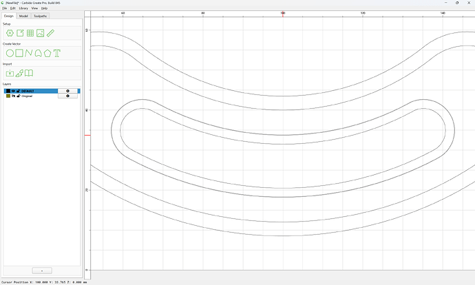

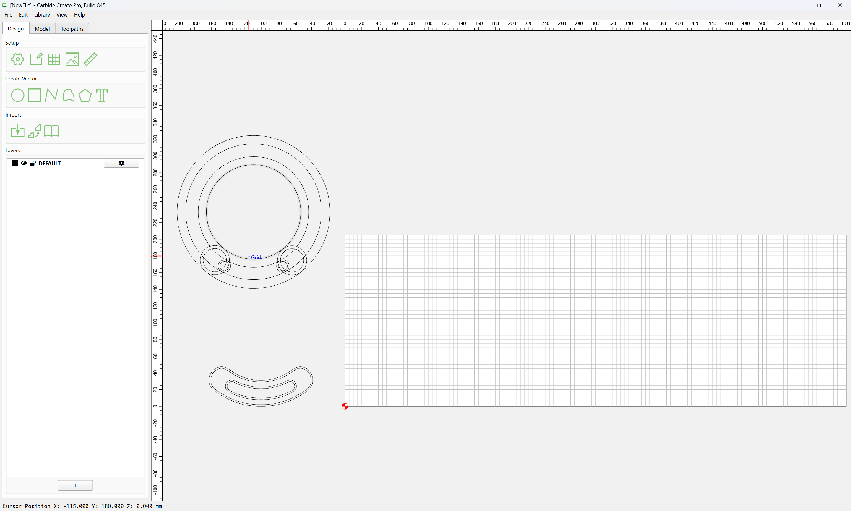

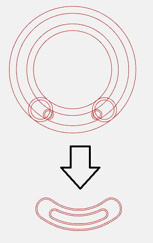

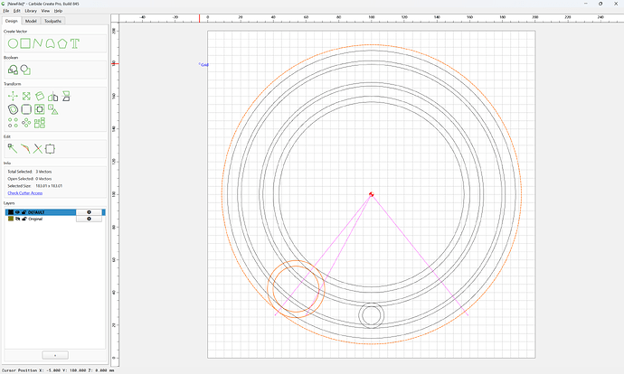

How to Carbide for this drawing

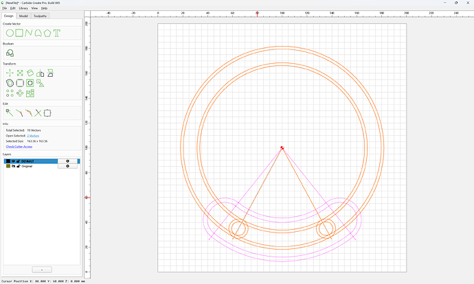

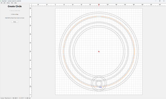

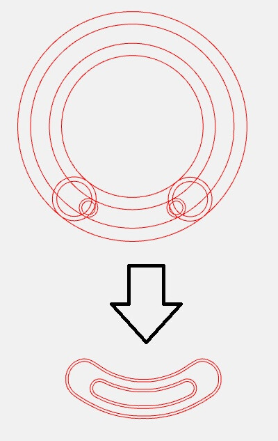

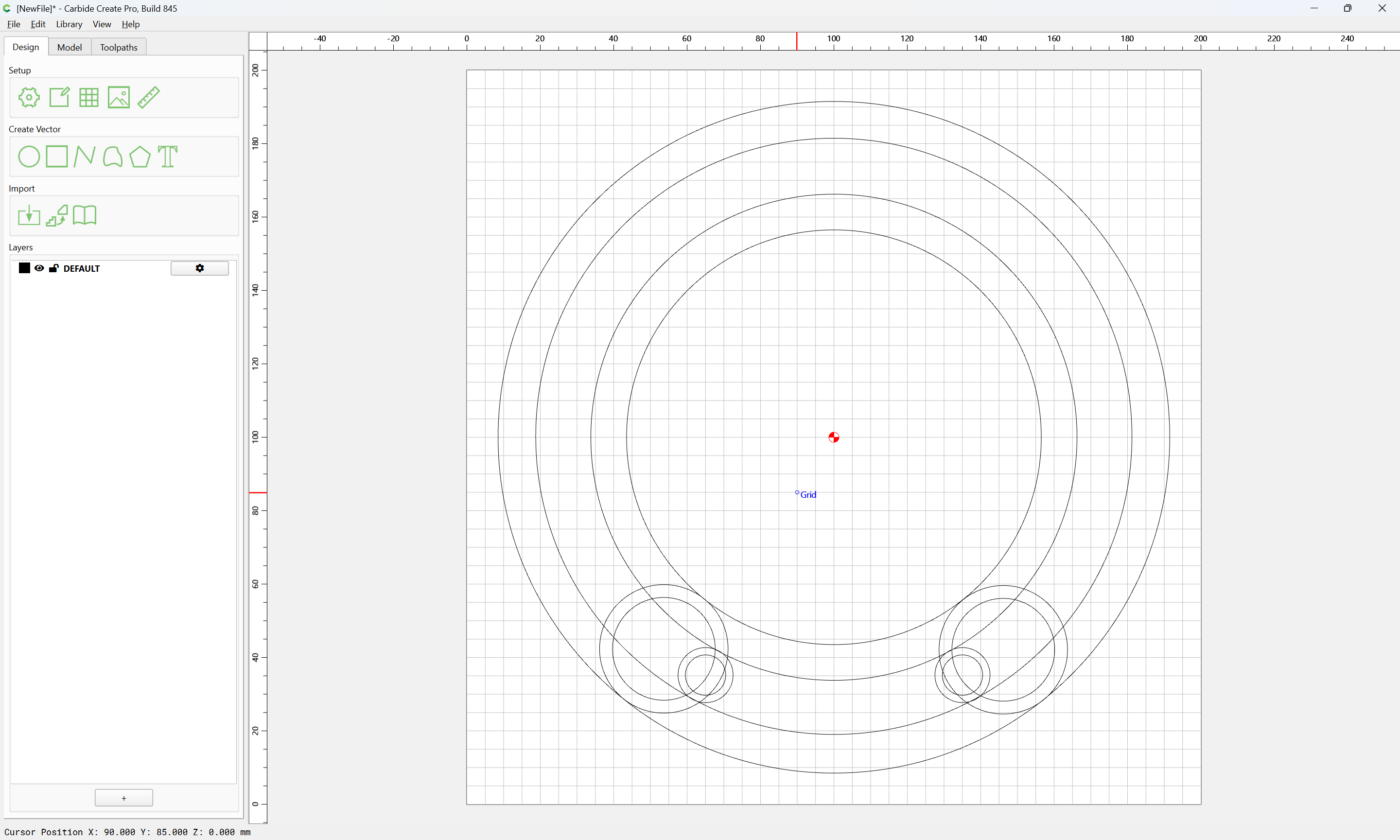

I am working on to design a hotdog shape using CC, after trying all different ways of Boolean and other options i couldn’t get the desired results. Can someone help, i have attached the source svg.
Carbide hotdog.zip (20.2 KB)
There are a couple of ways to do this:

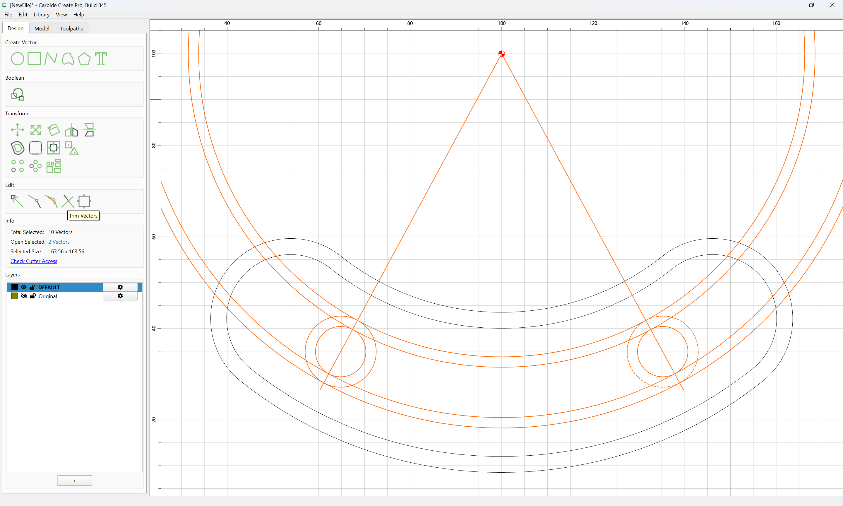

First, to make things a bit simpler, we delete what is not wanted and reduce the Stock are to what we wish to work with:

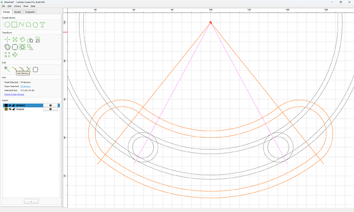

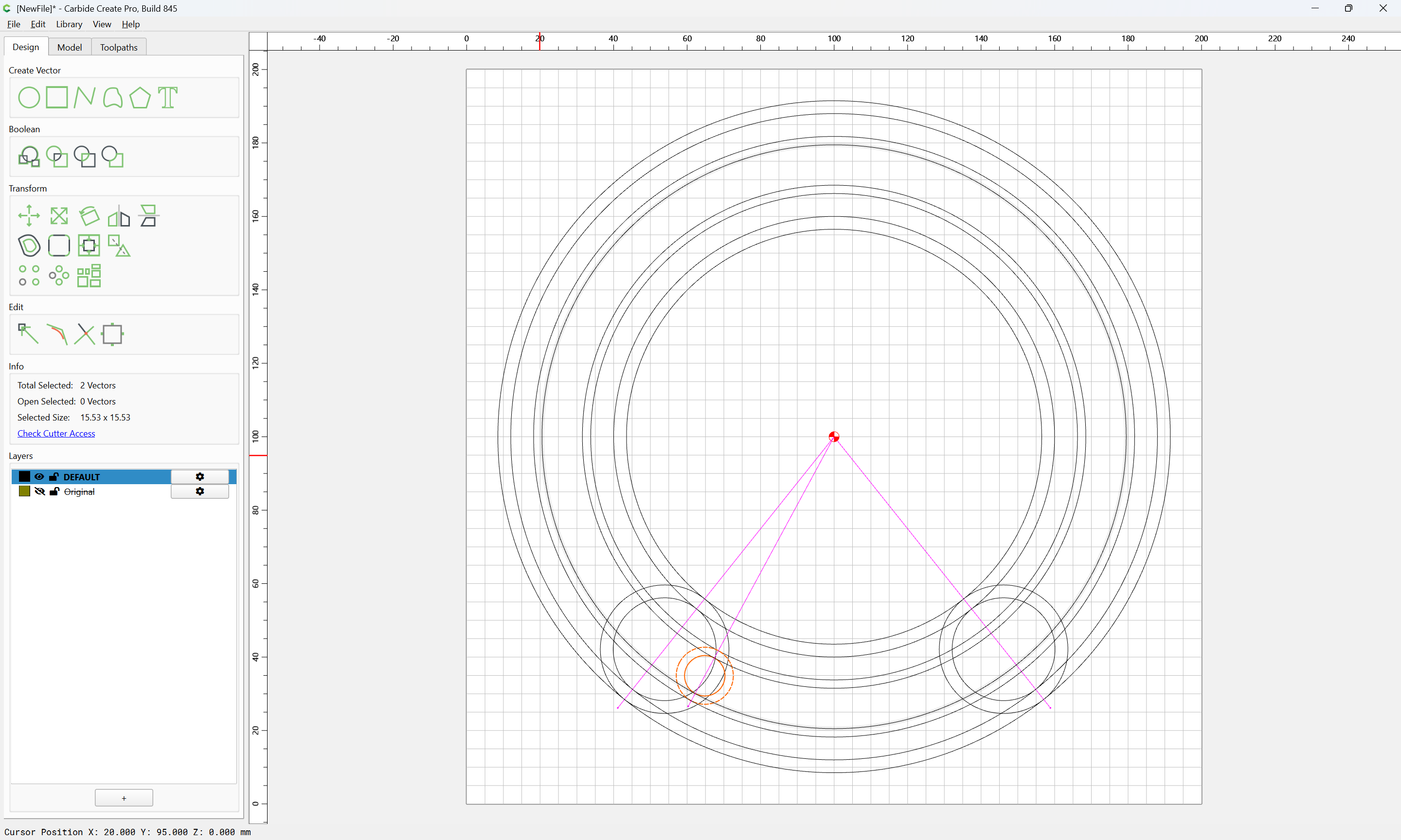

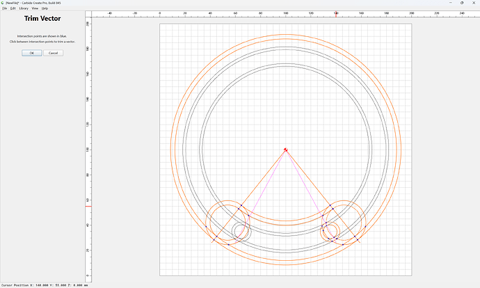

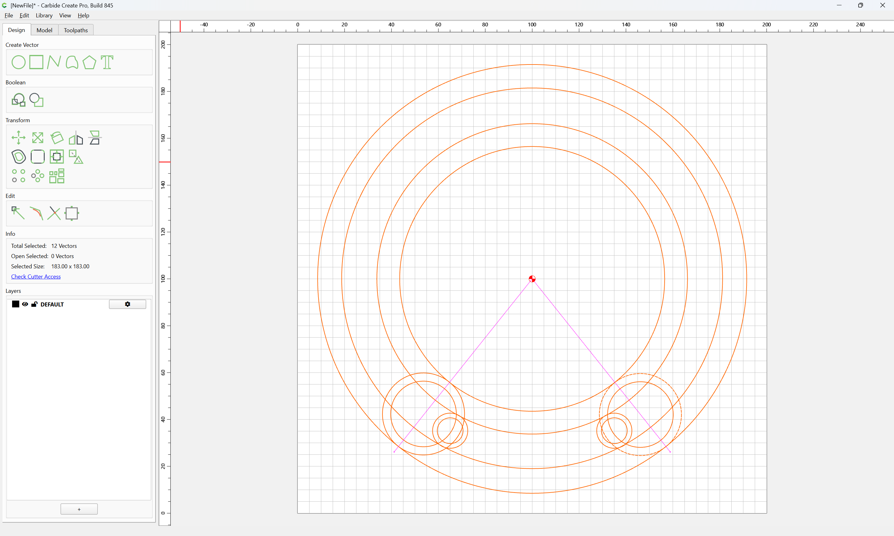

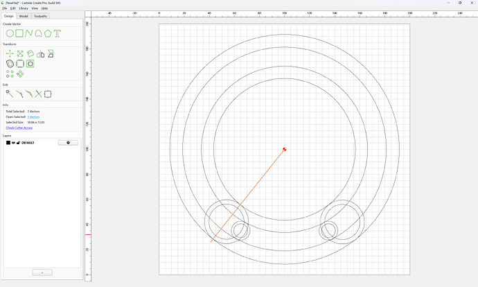

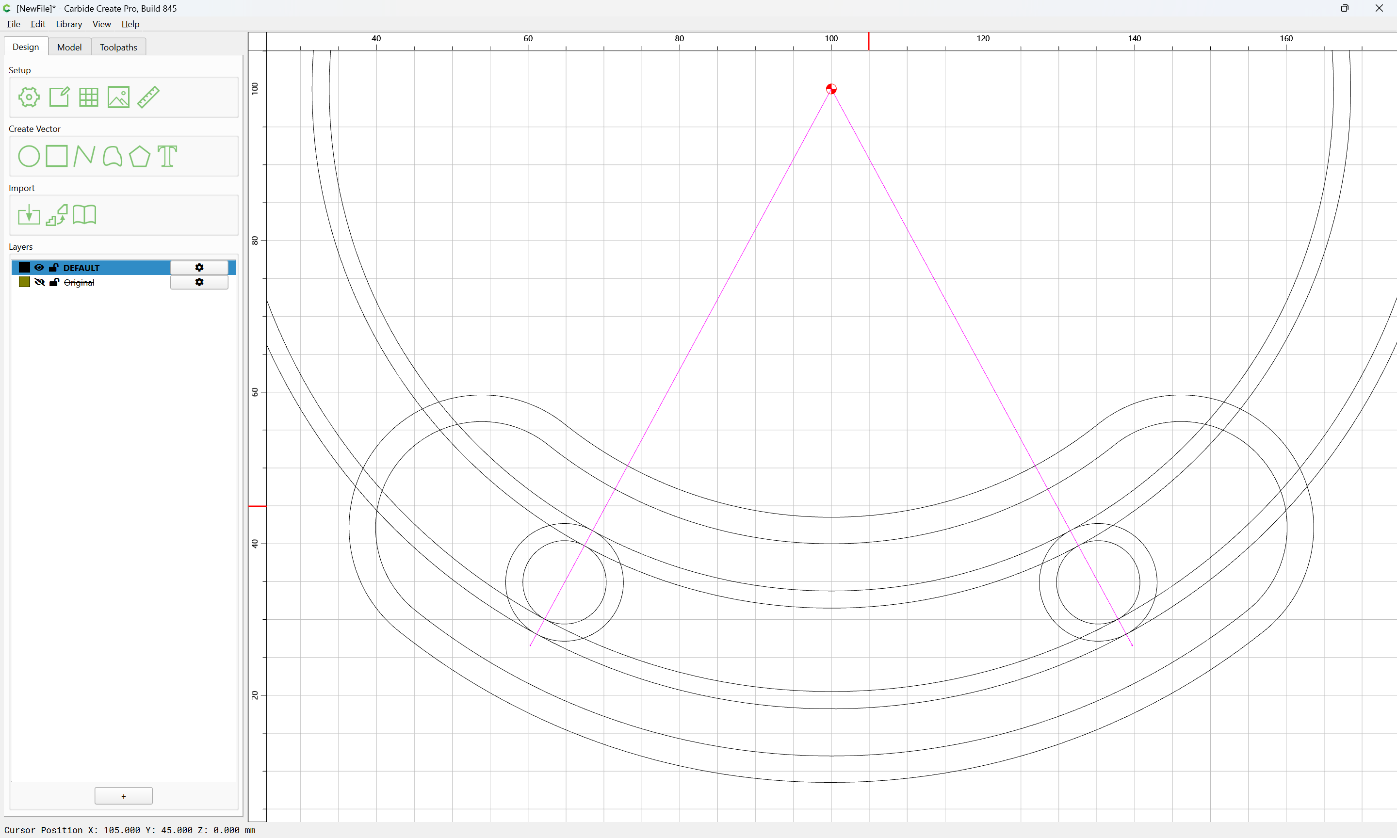

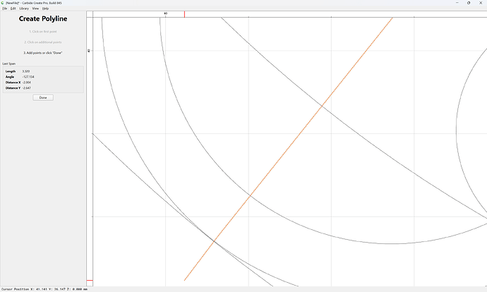

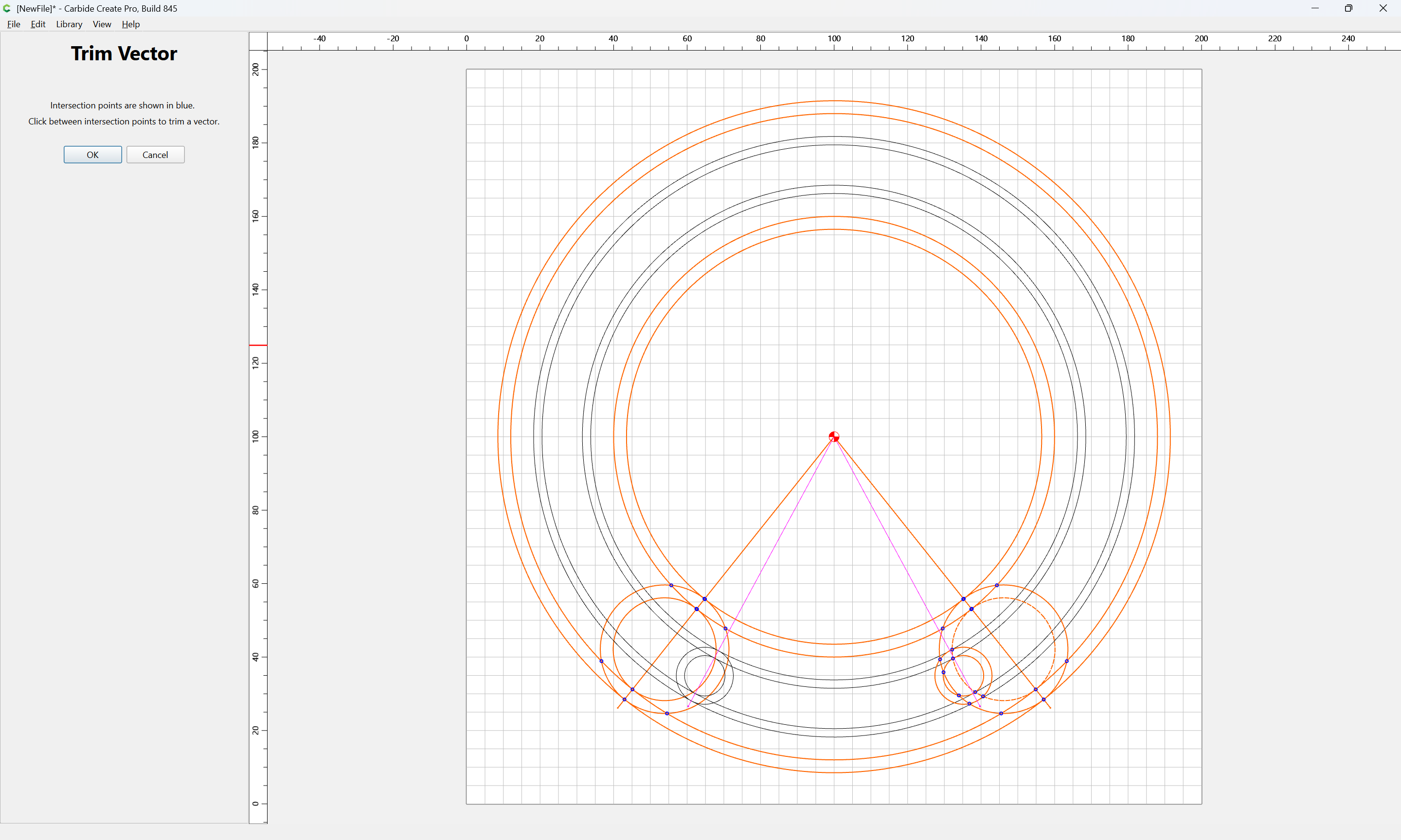

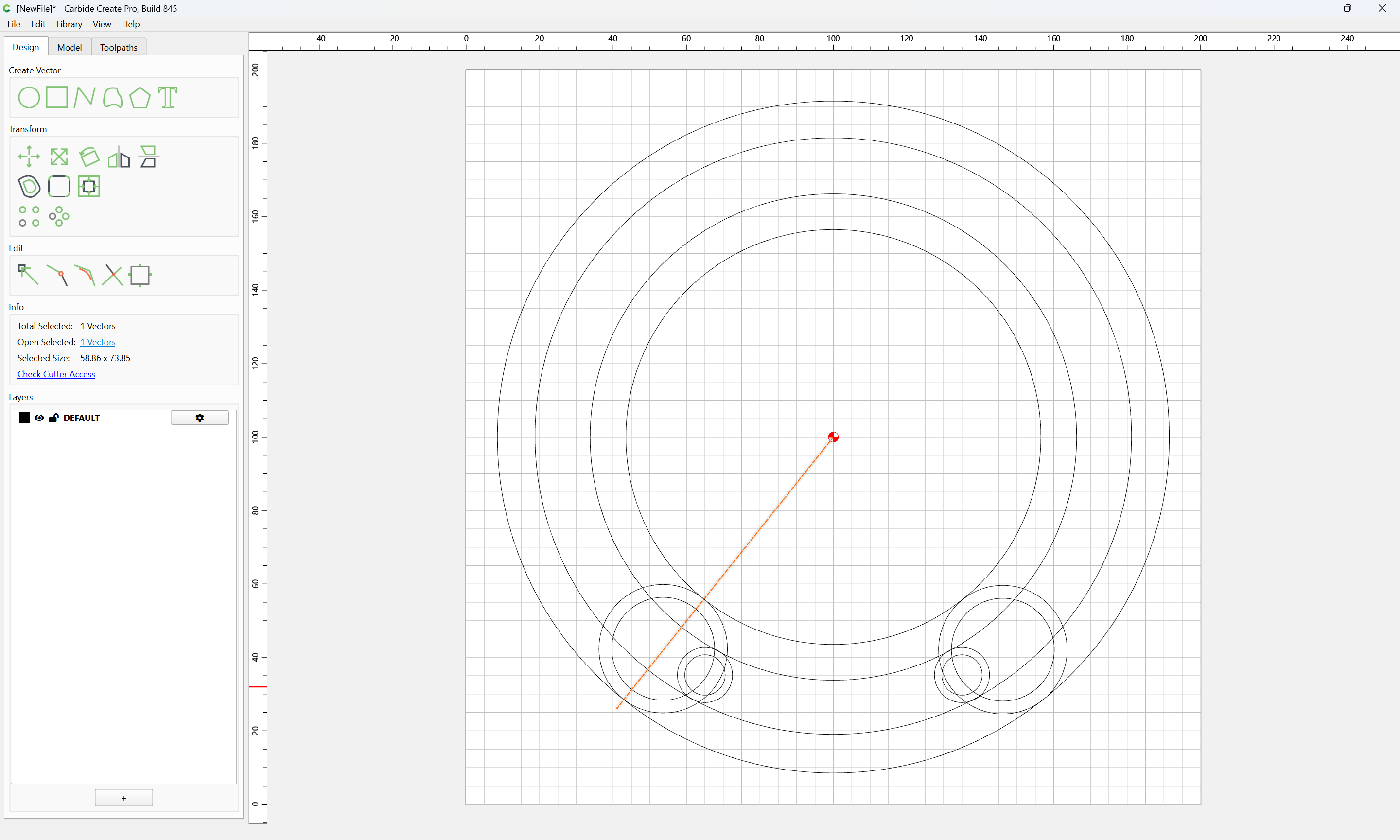

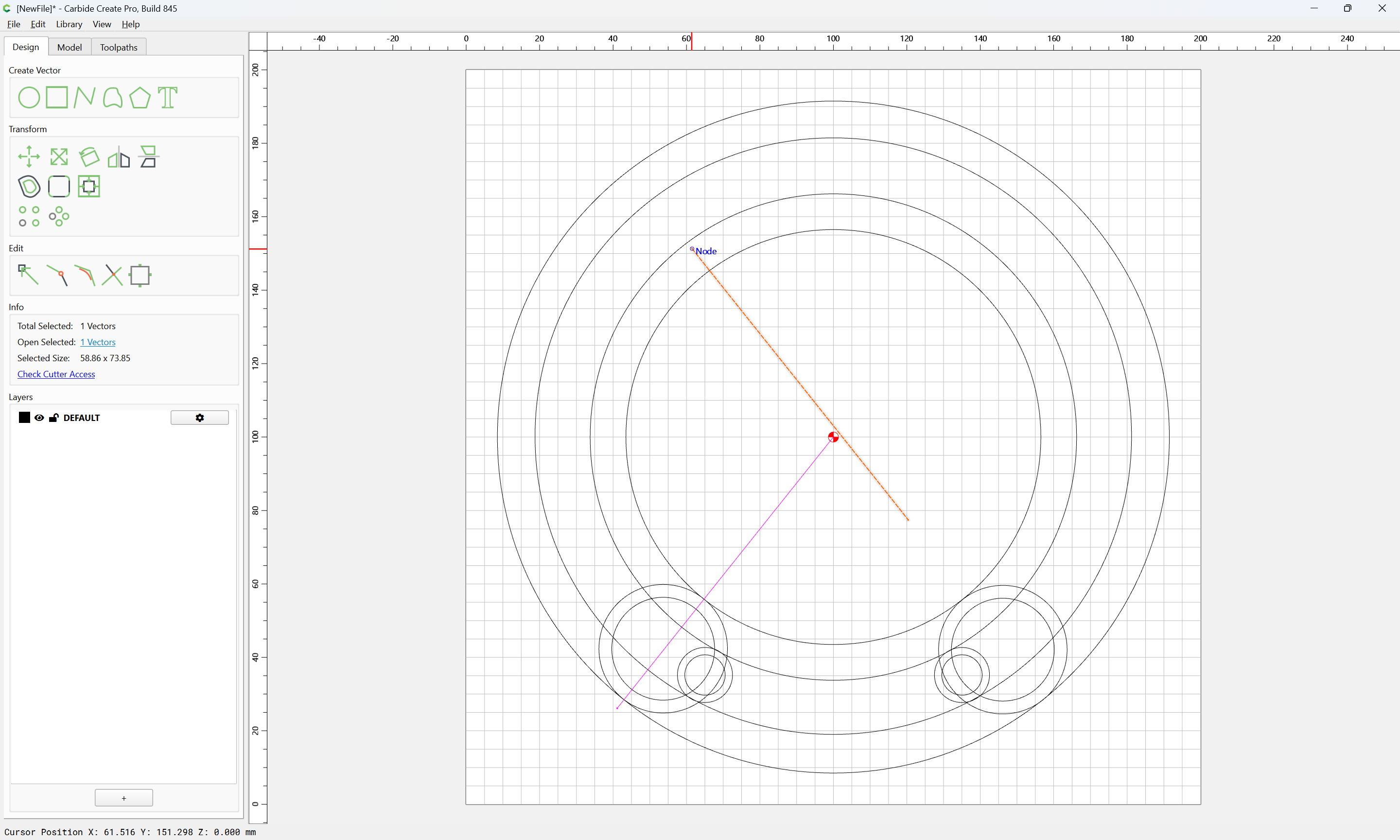

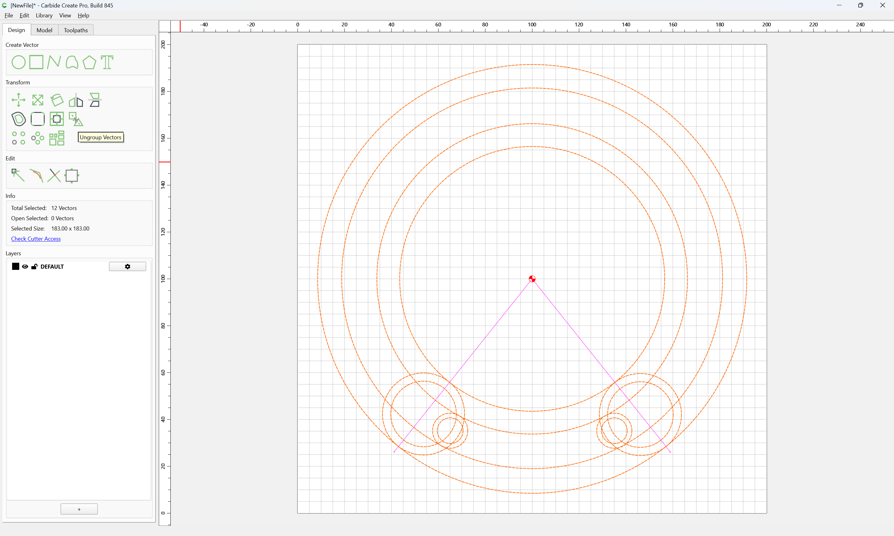

Then, for each set of circles, draw a line which intersects them at the correct angle from the center:
For actually getting the originals lined up c.f.,
Done

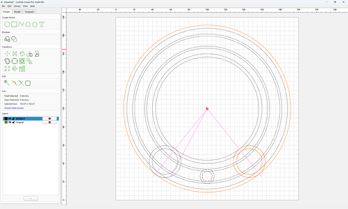

Select the geometry for the matching set of circles after creating the missing pair of circles and adjusting for the matter of things not perfectly matching up:
Probably best to just re-create everything…

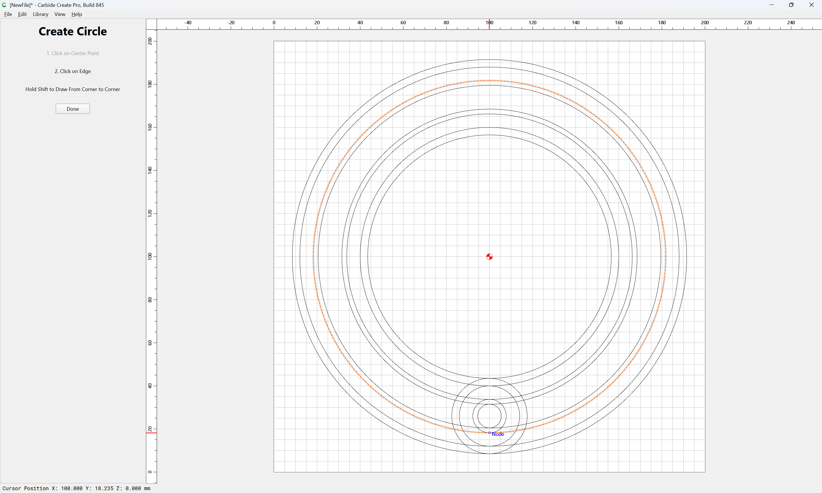

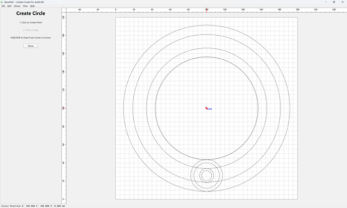

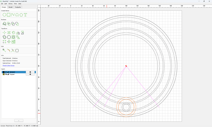

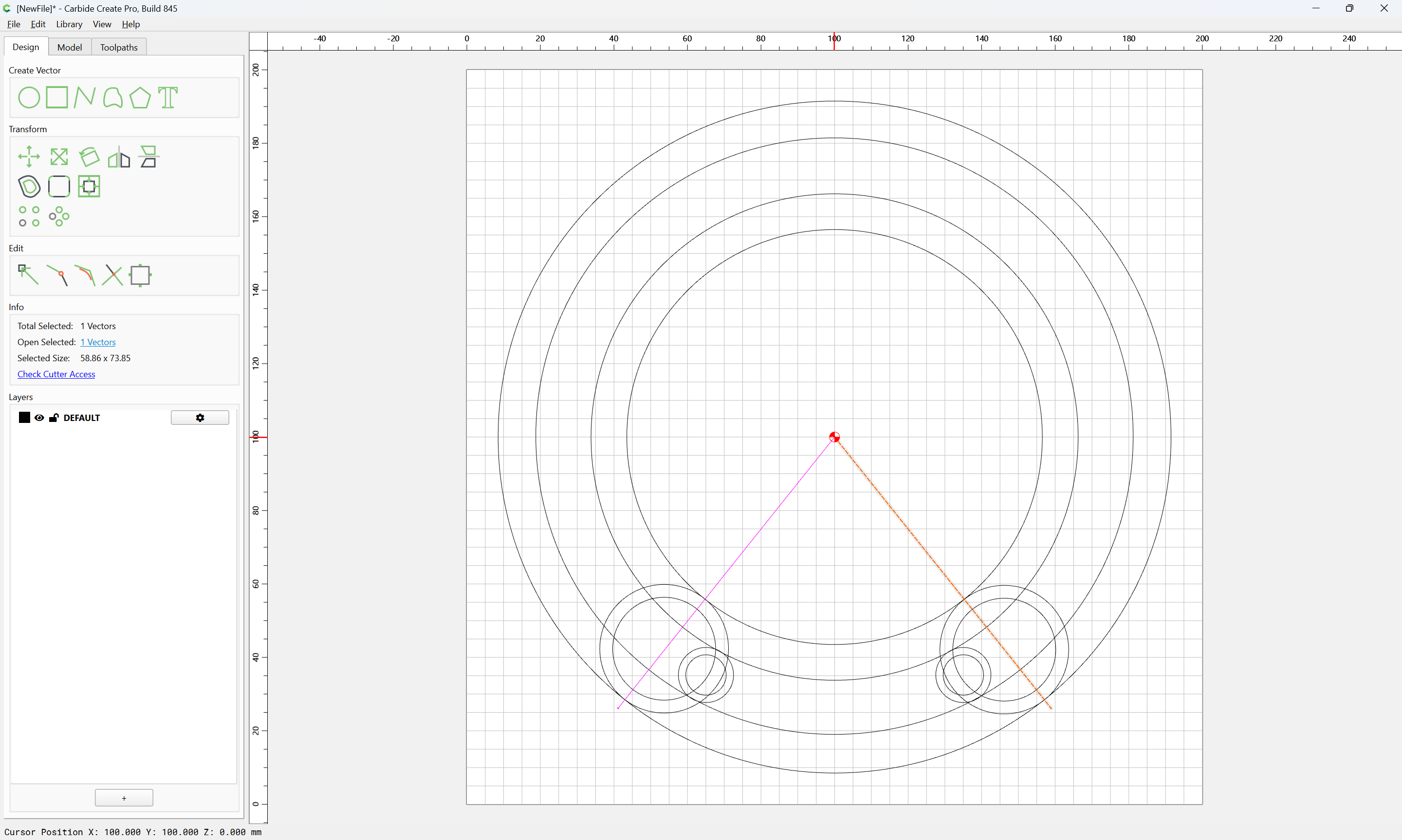

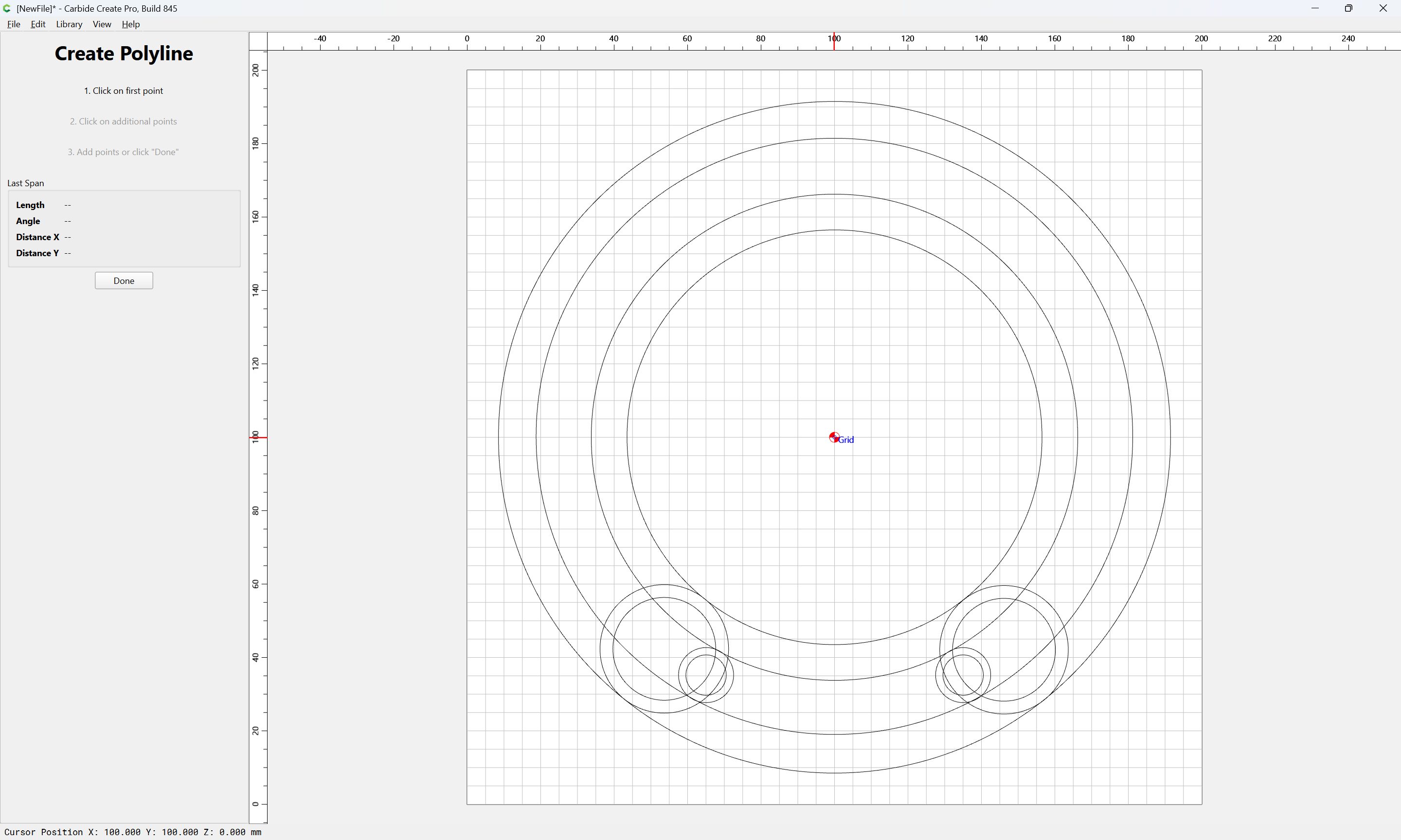

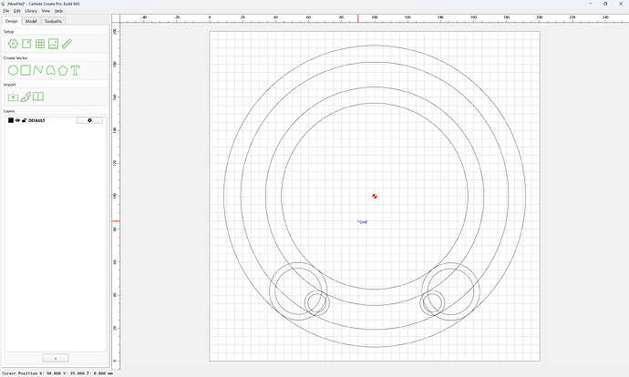

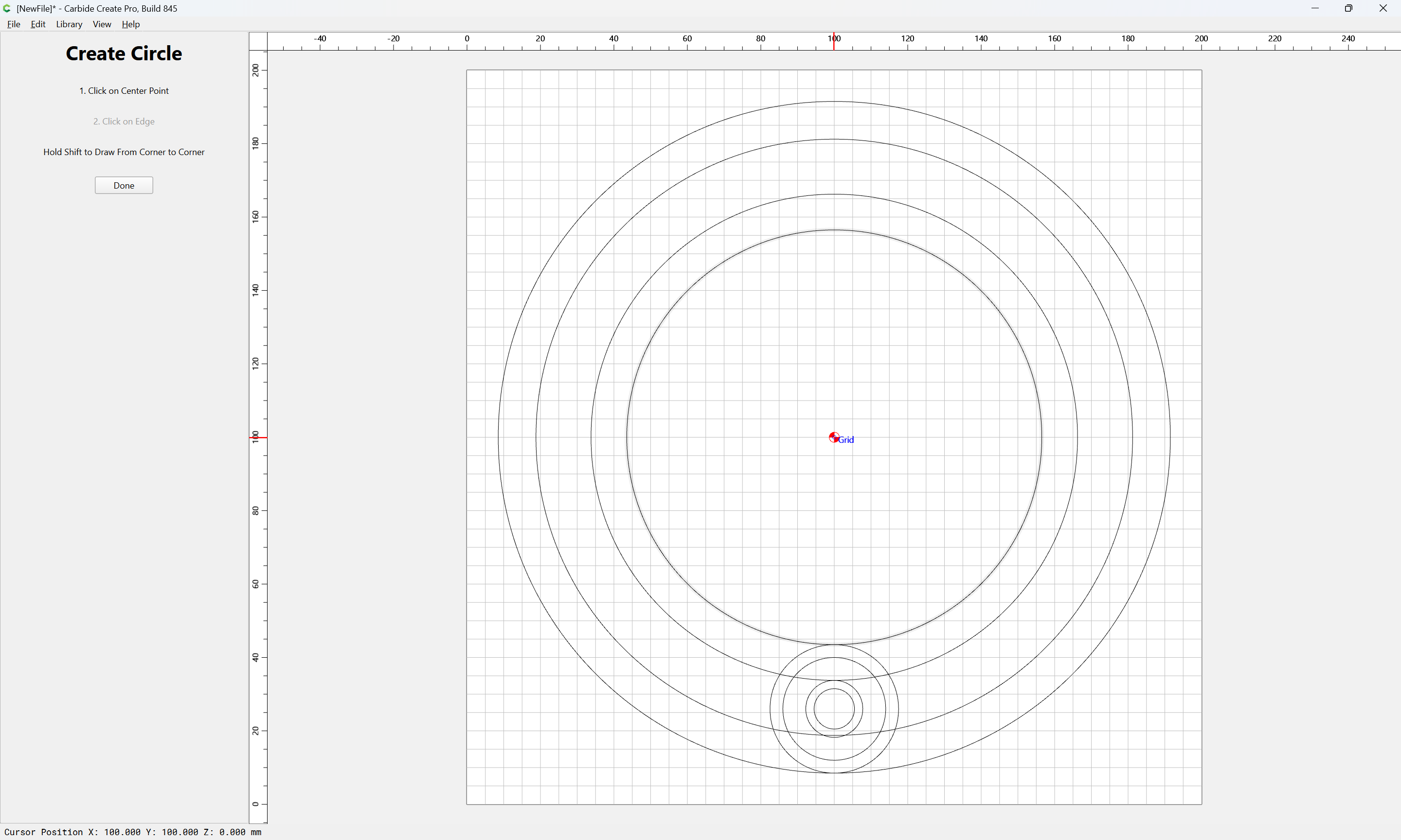

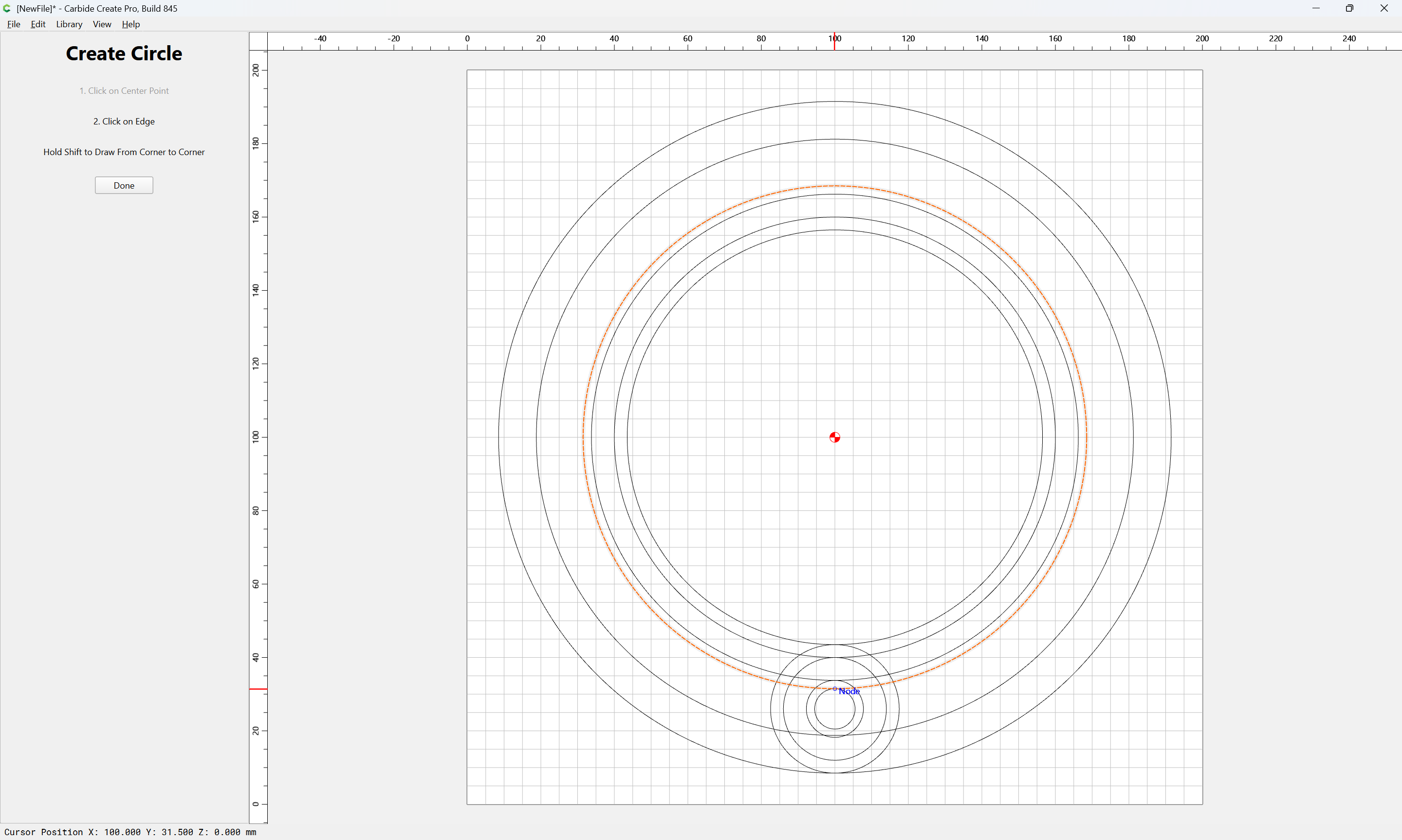

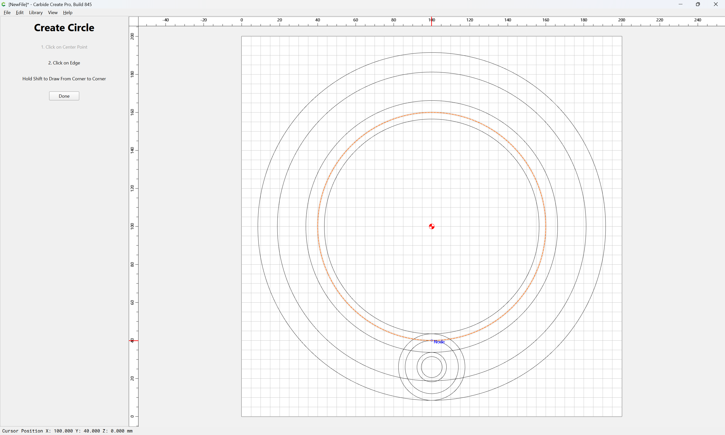

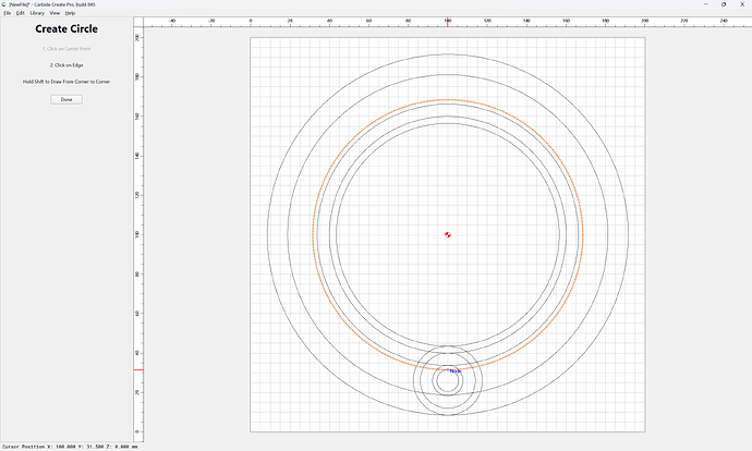

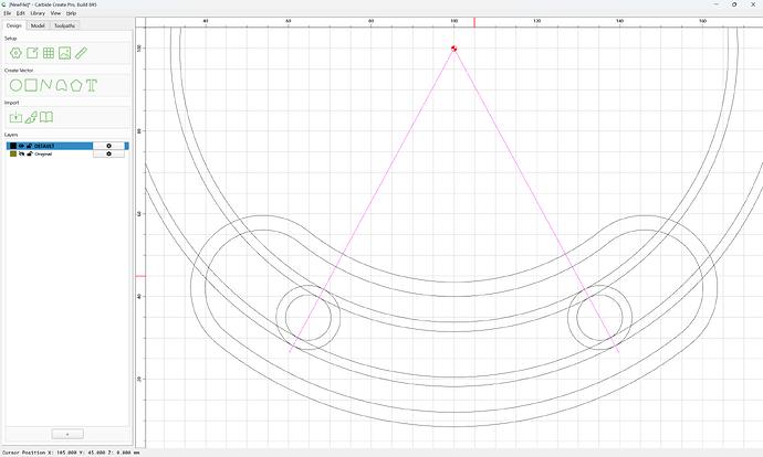

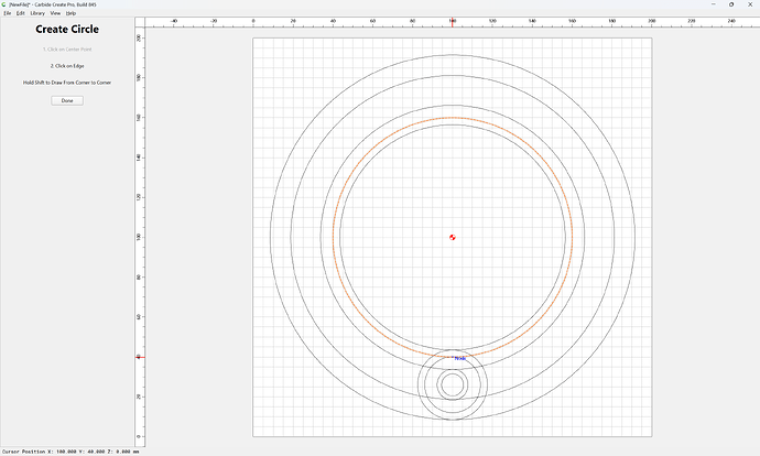

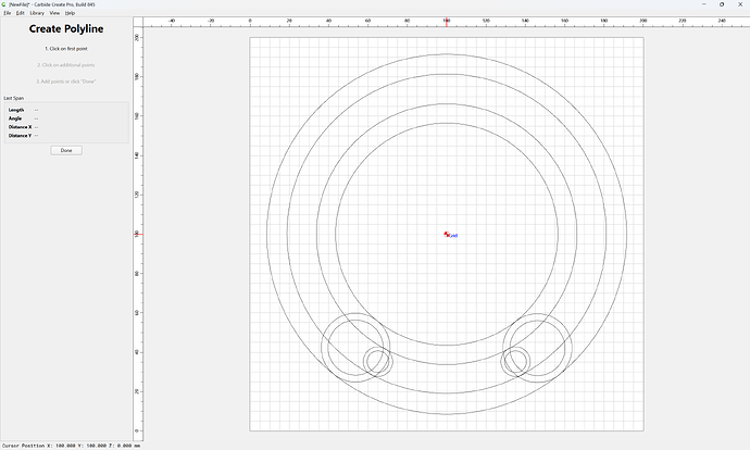

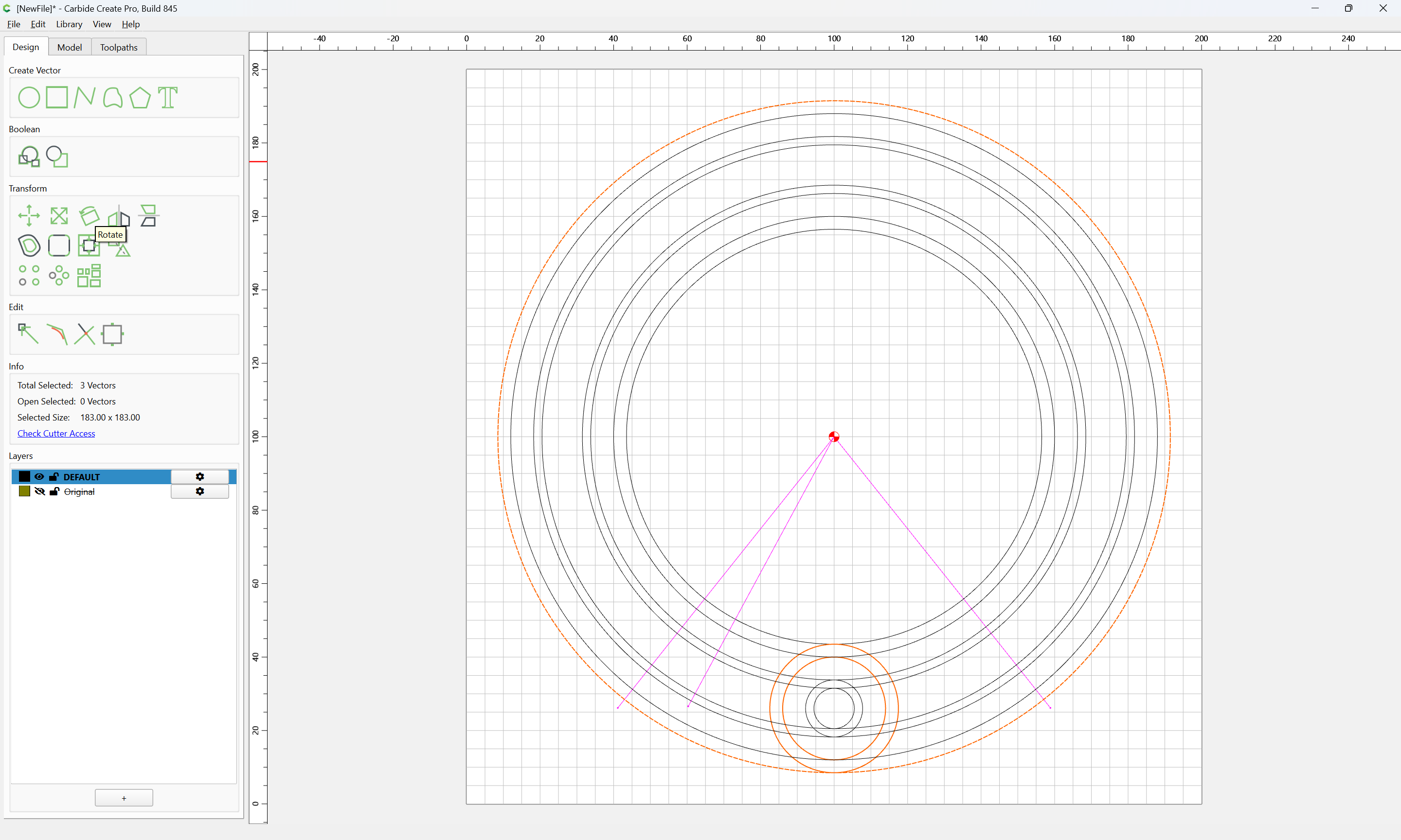

Re-draw one set of all the circles:
which makes the lacunae clear:

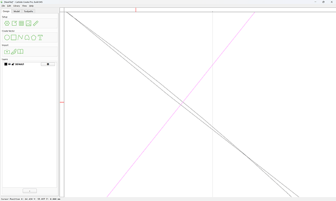

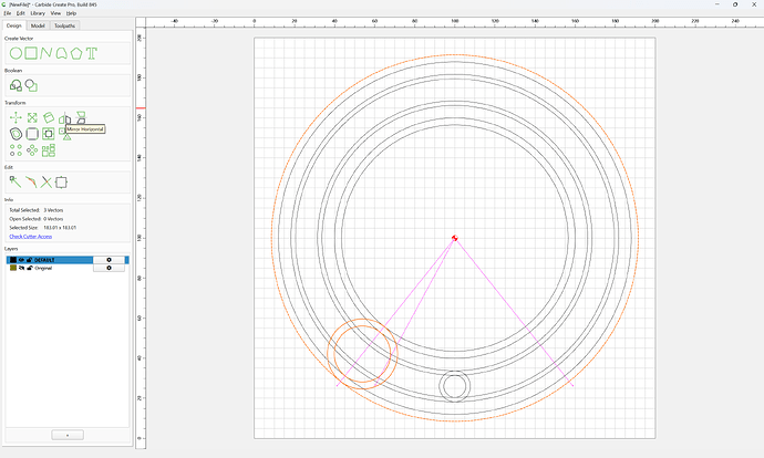

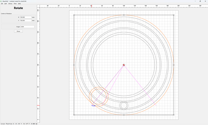

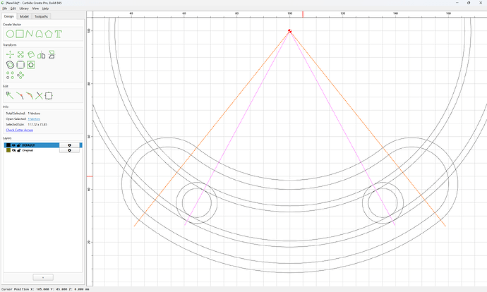

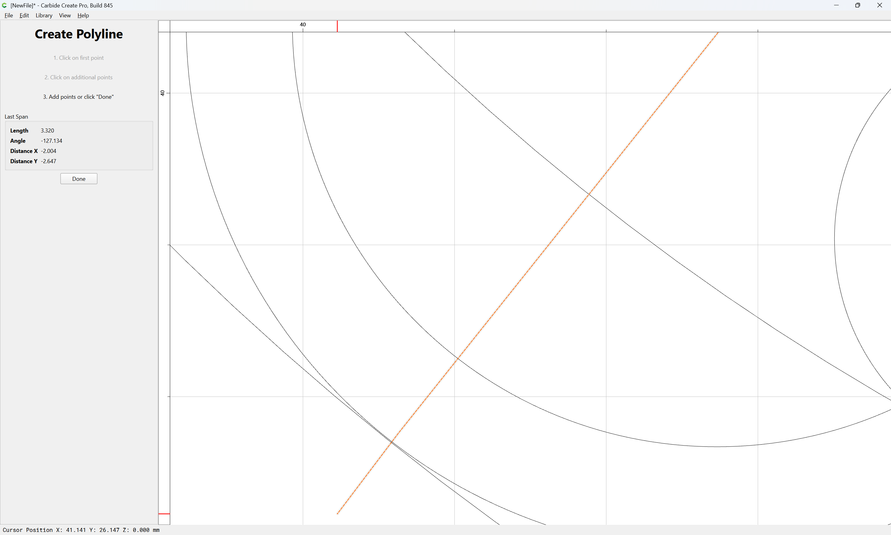

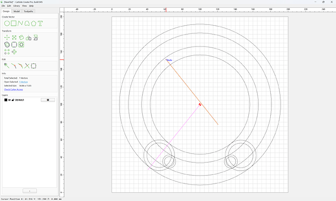

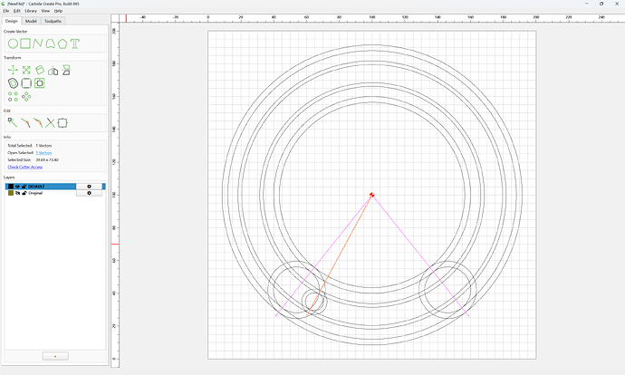

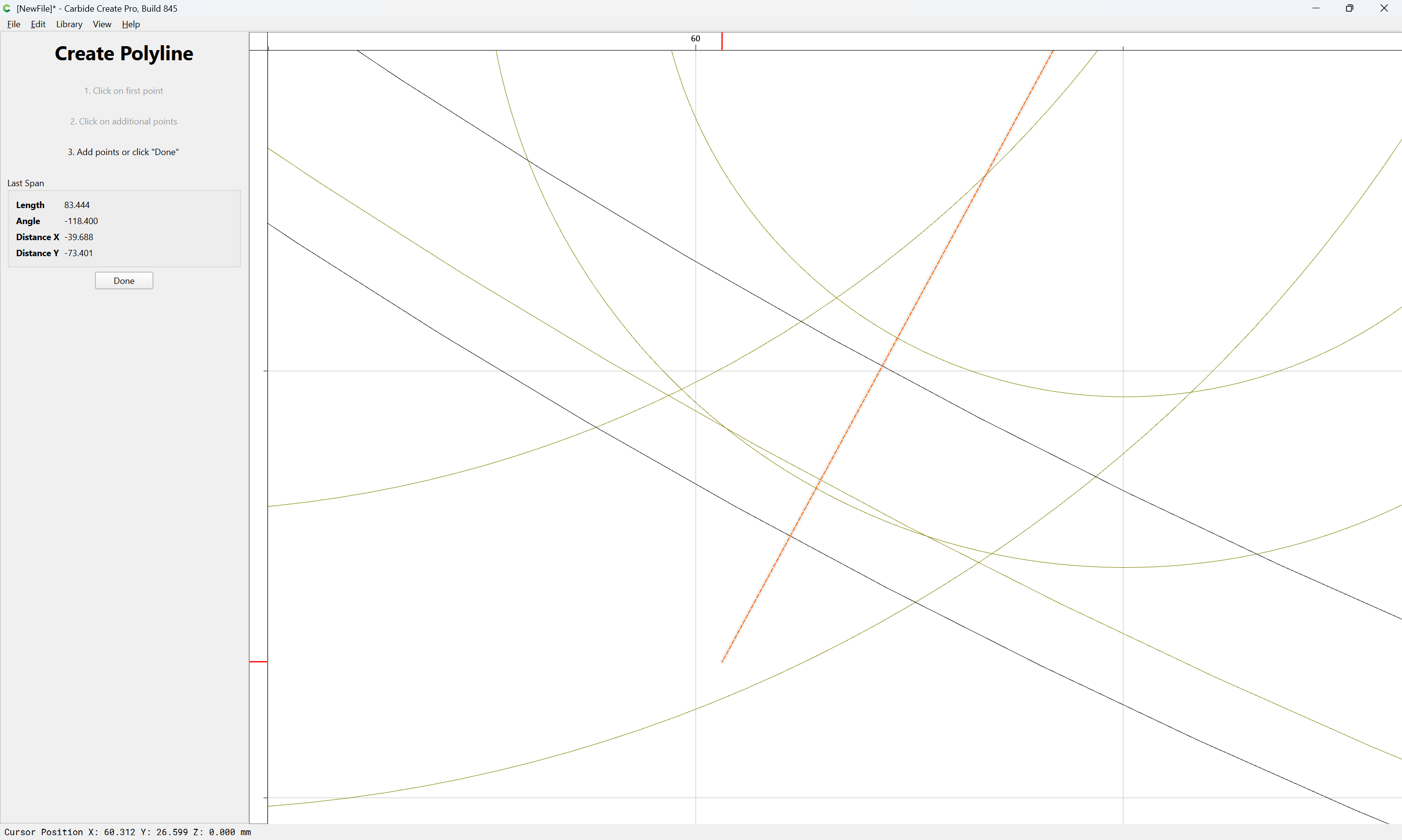

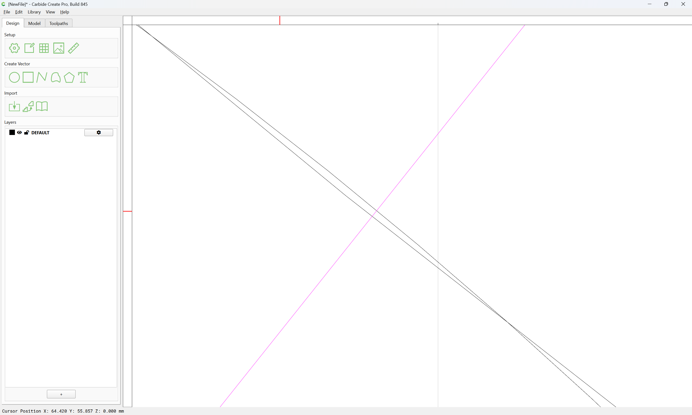

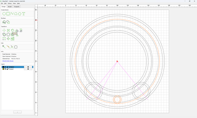

It will the be necessary to draw in the pair of lines to get the angles needed:

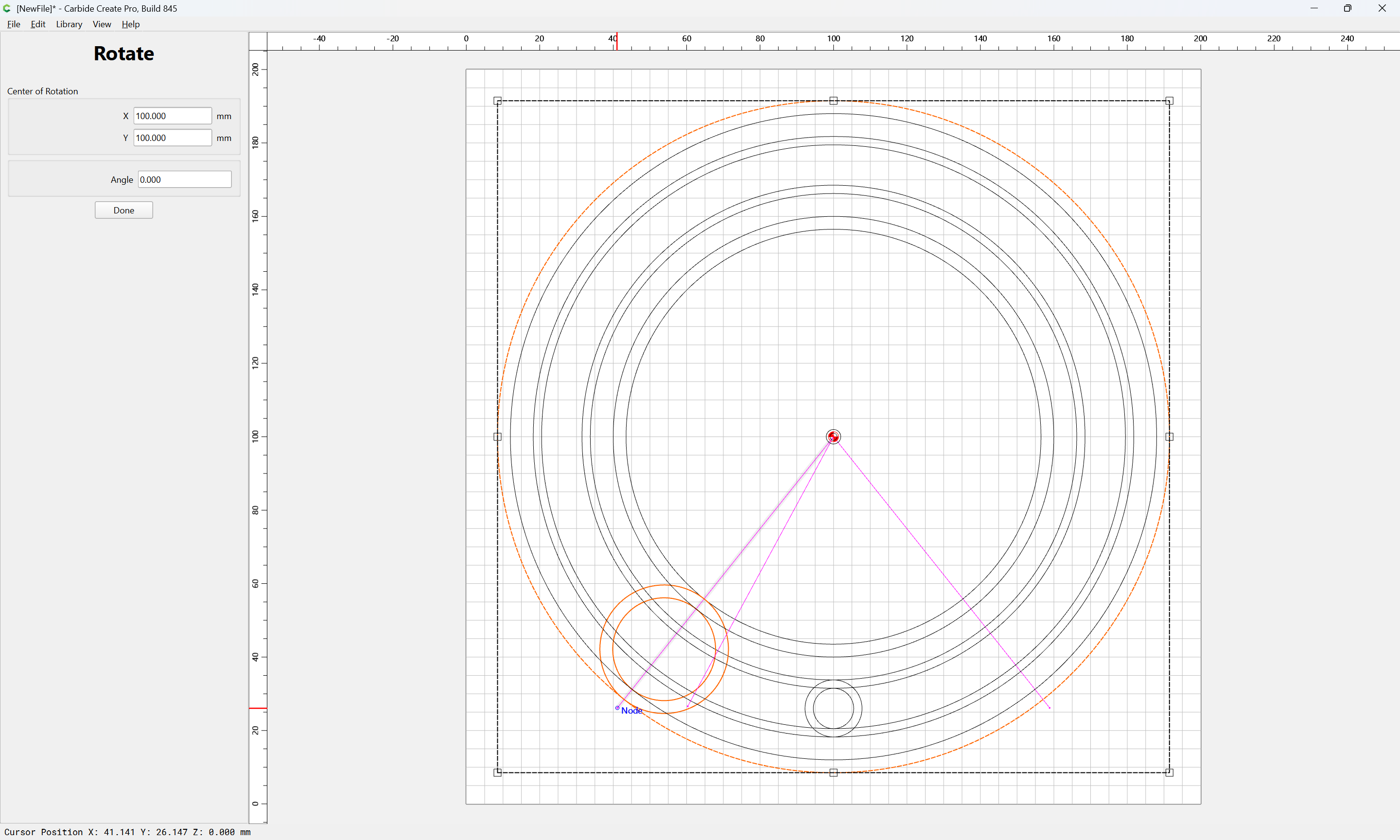

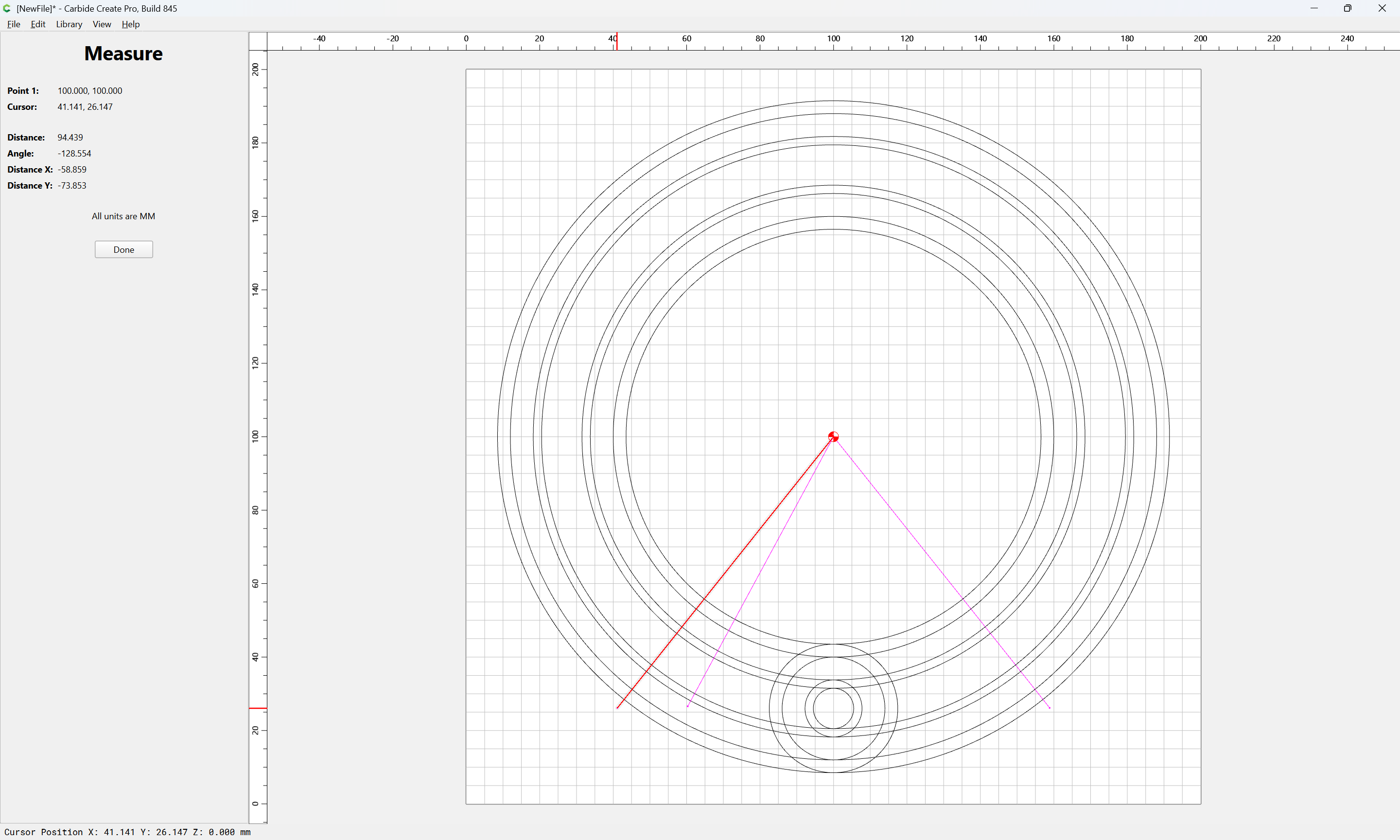

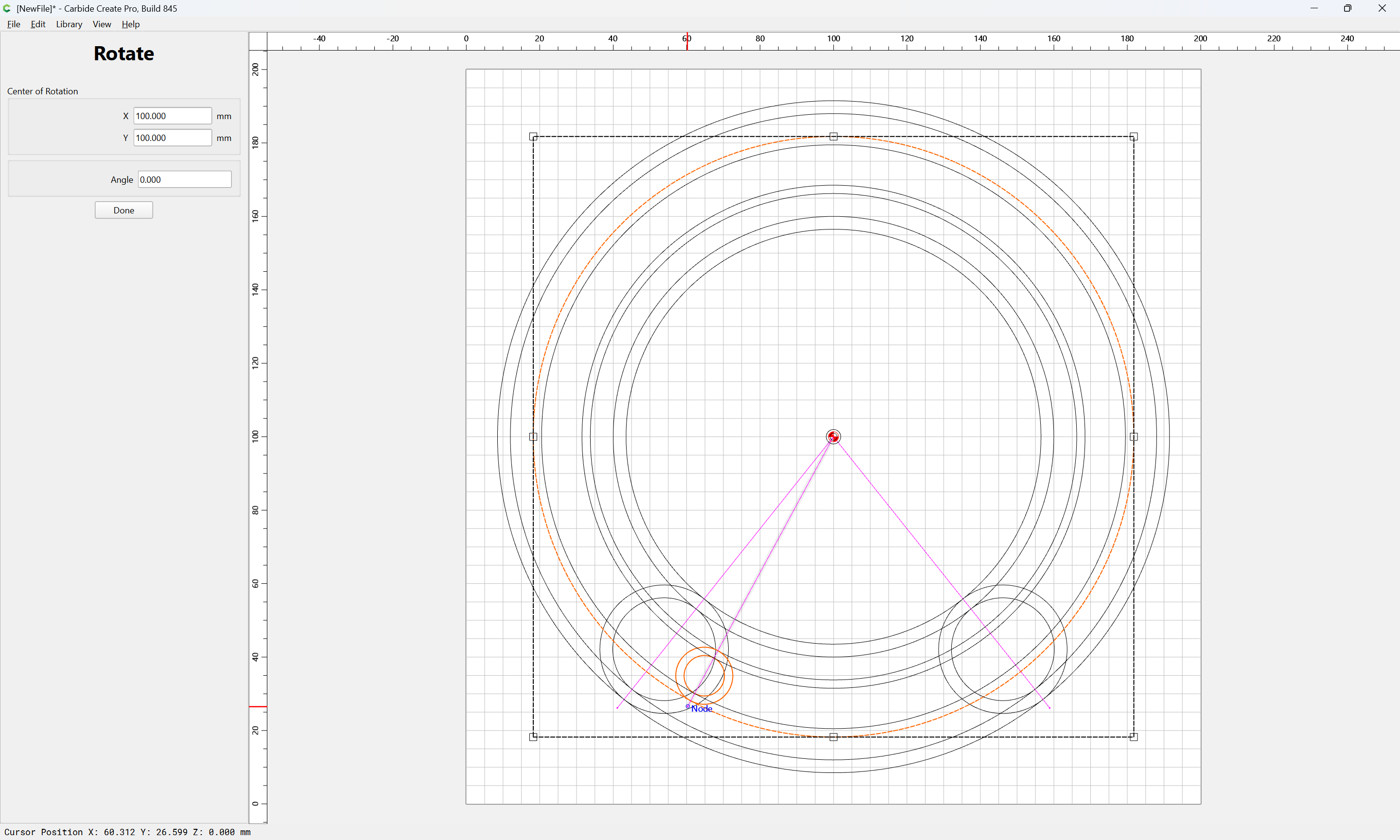

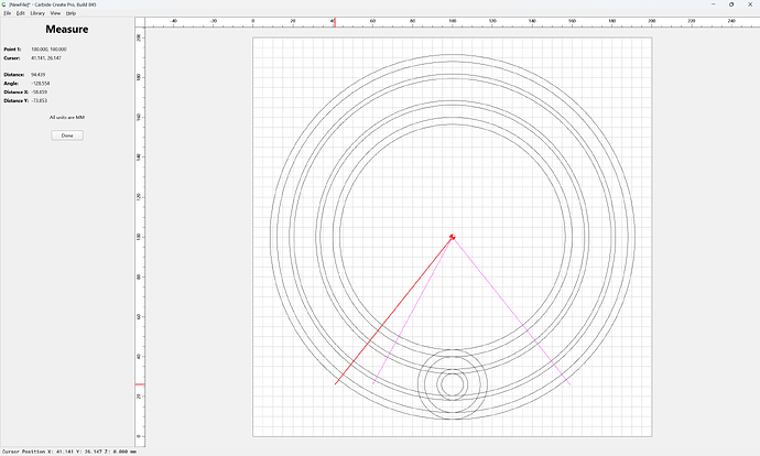

Then Measure the needed rotation:

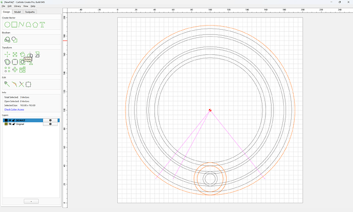

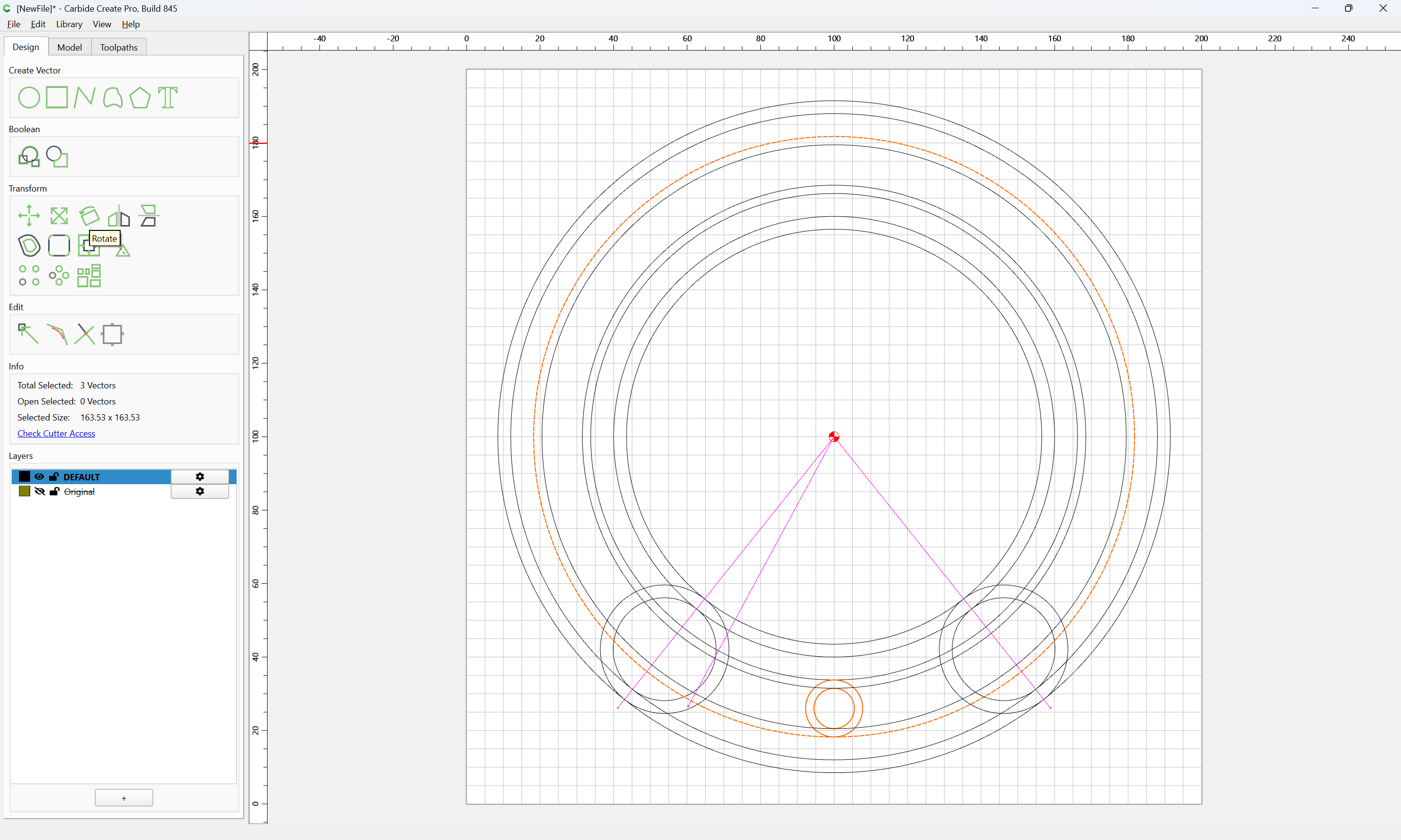

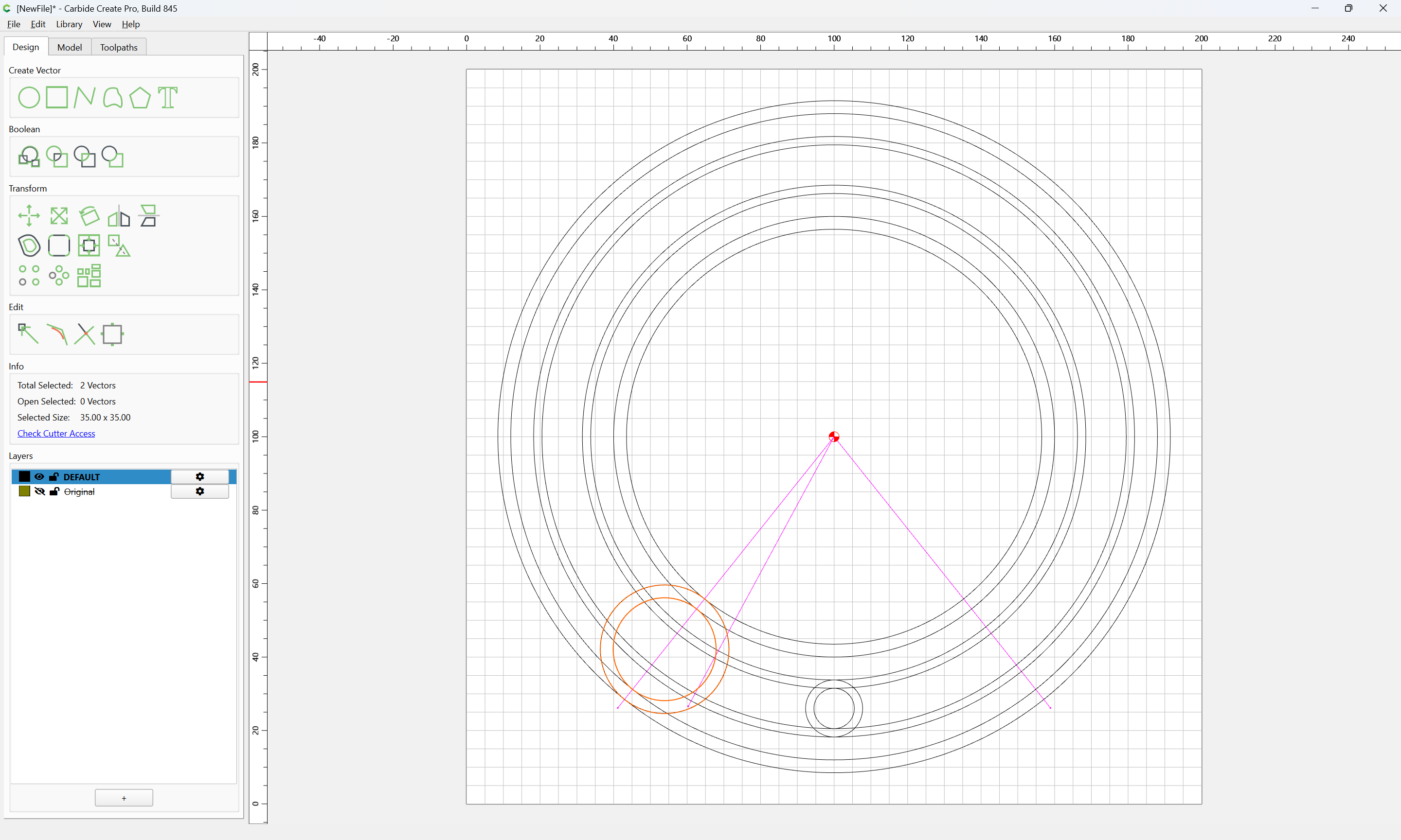

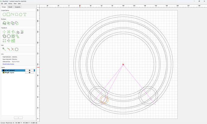

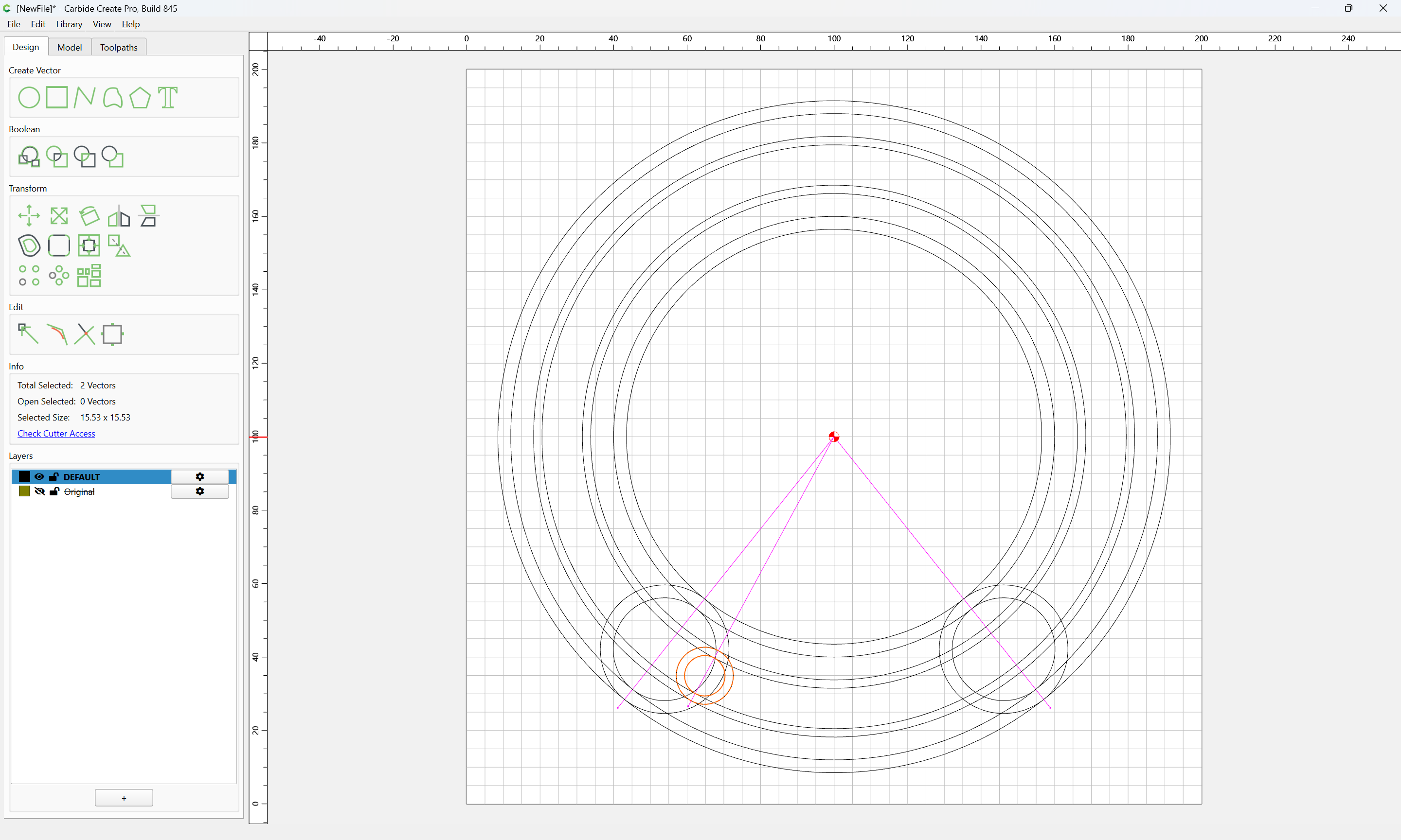

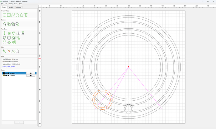

Select the pair of circles which match:

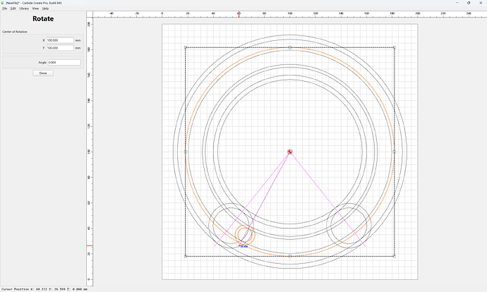

and a piece of geometry which is larger and centered on the desired point of rotation:
and rotate it into position — it should work to snap against the node of the line, rendering the measurement superfluous:

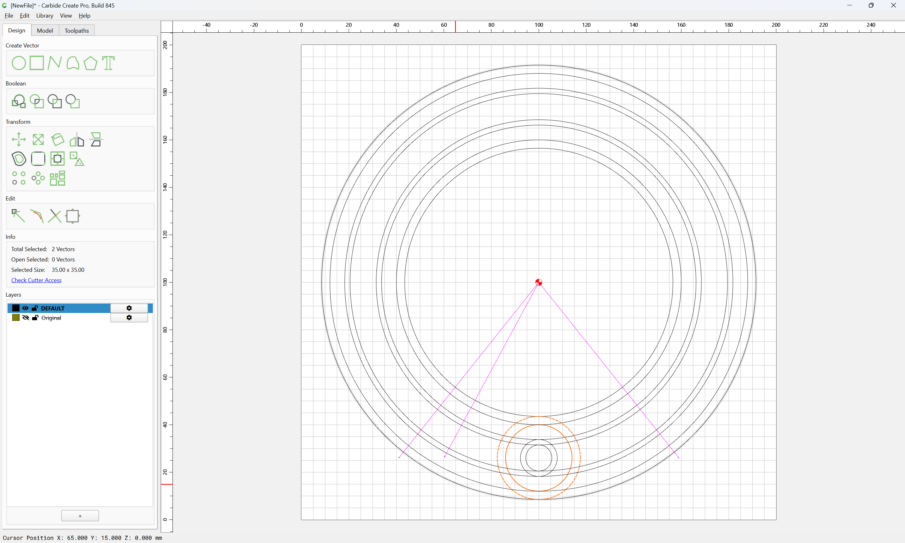

Done

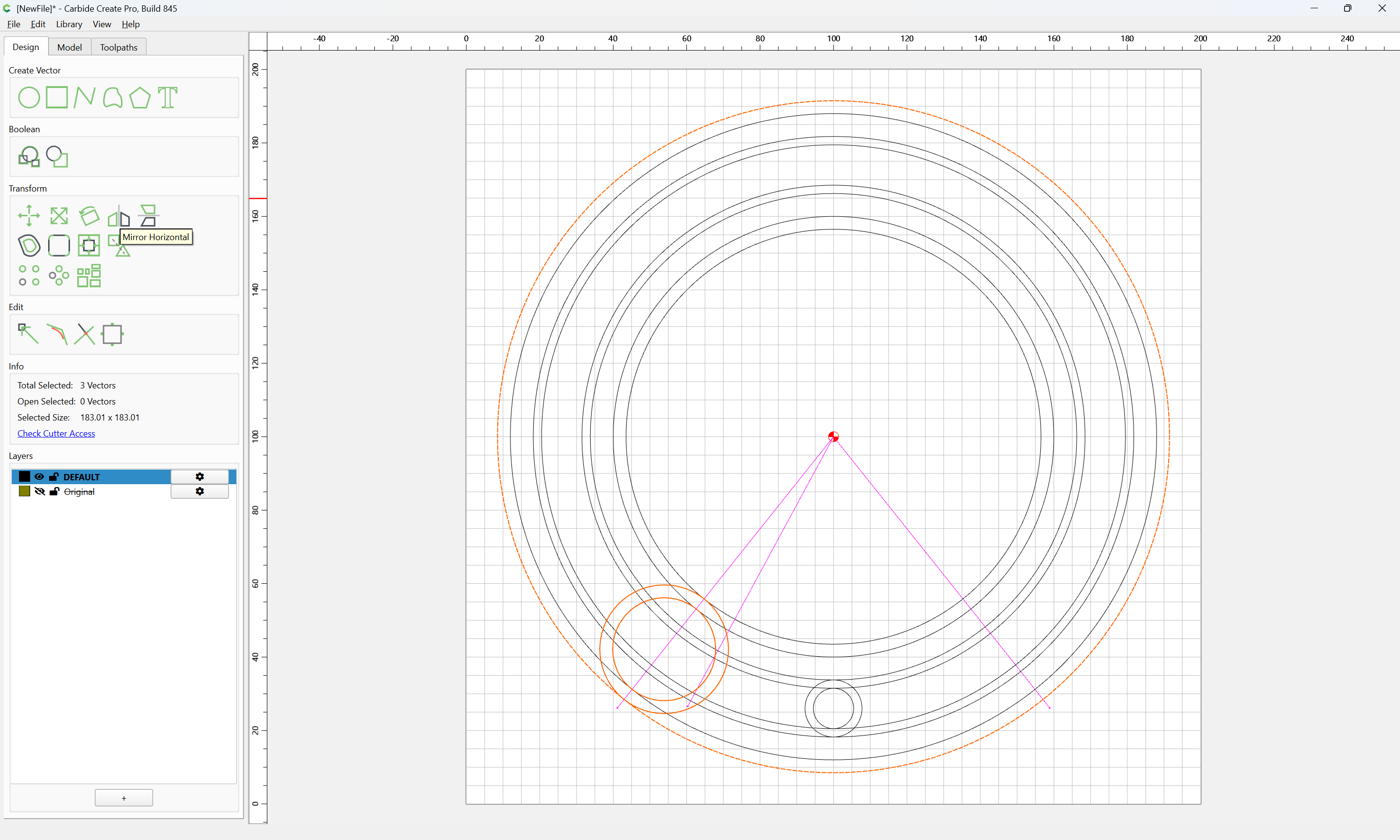

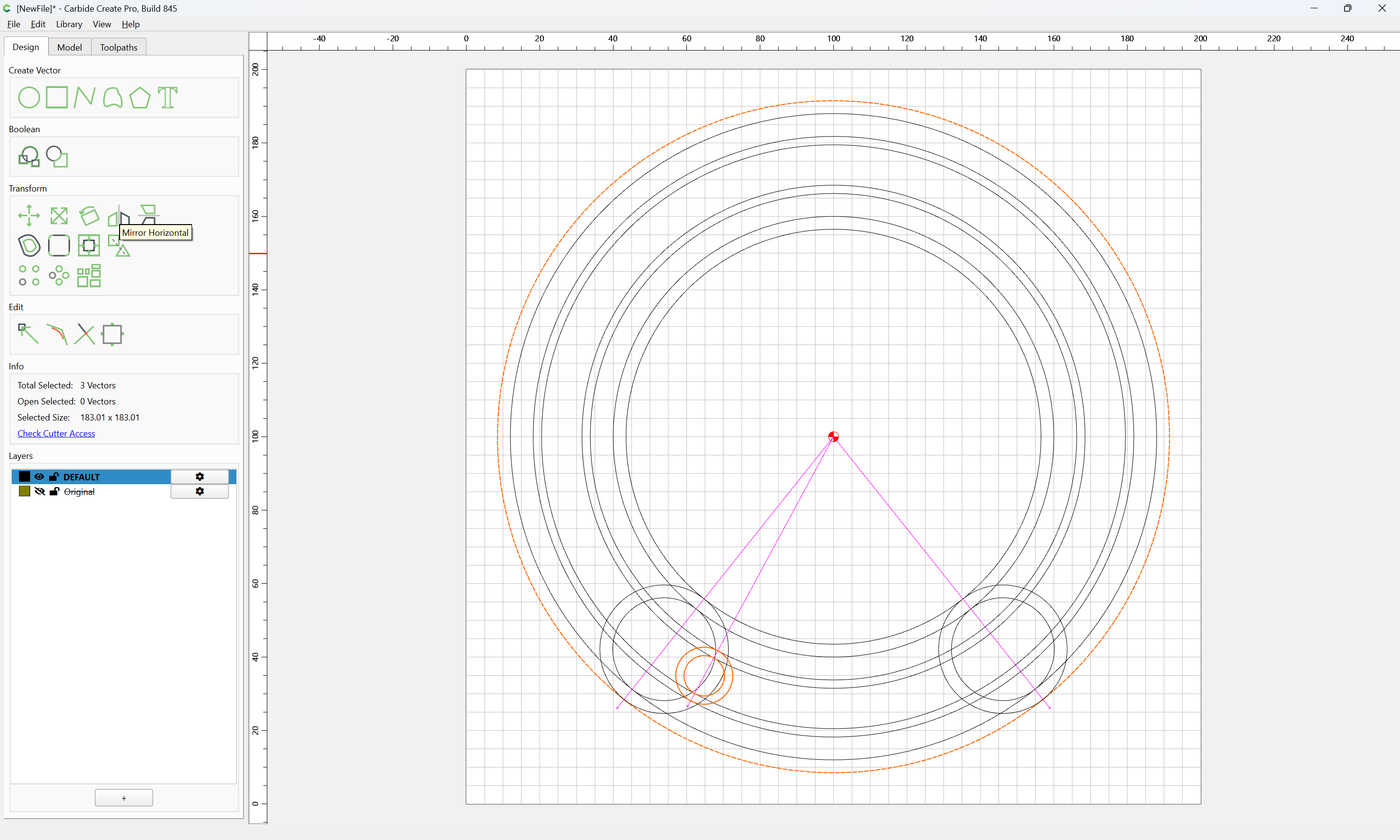

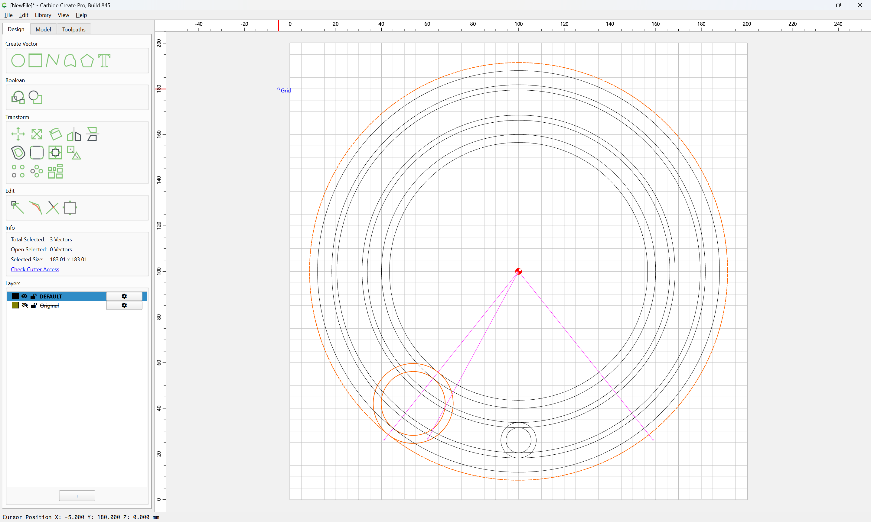

Duplicate the rotated circles:
shift-click on the surrounding circle to add it back to the selection:

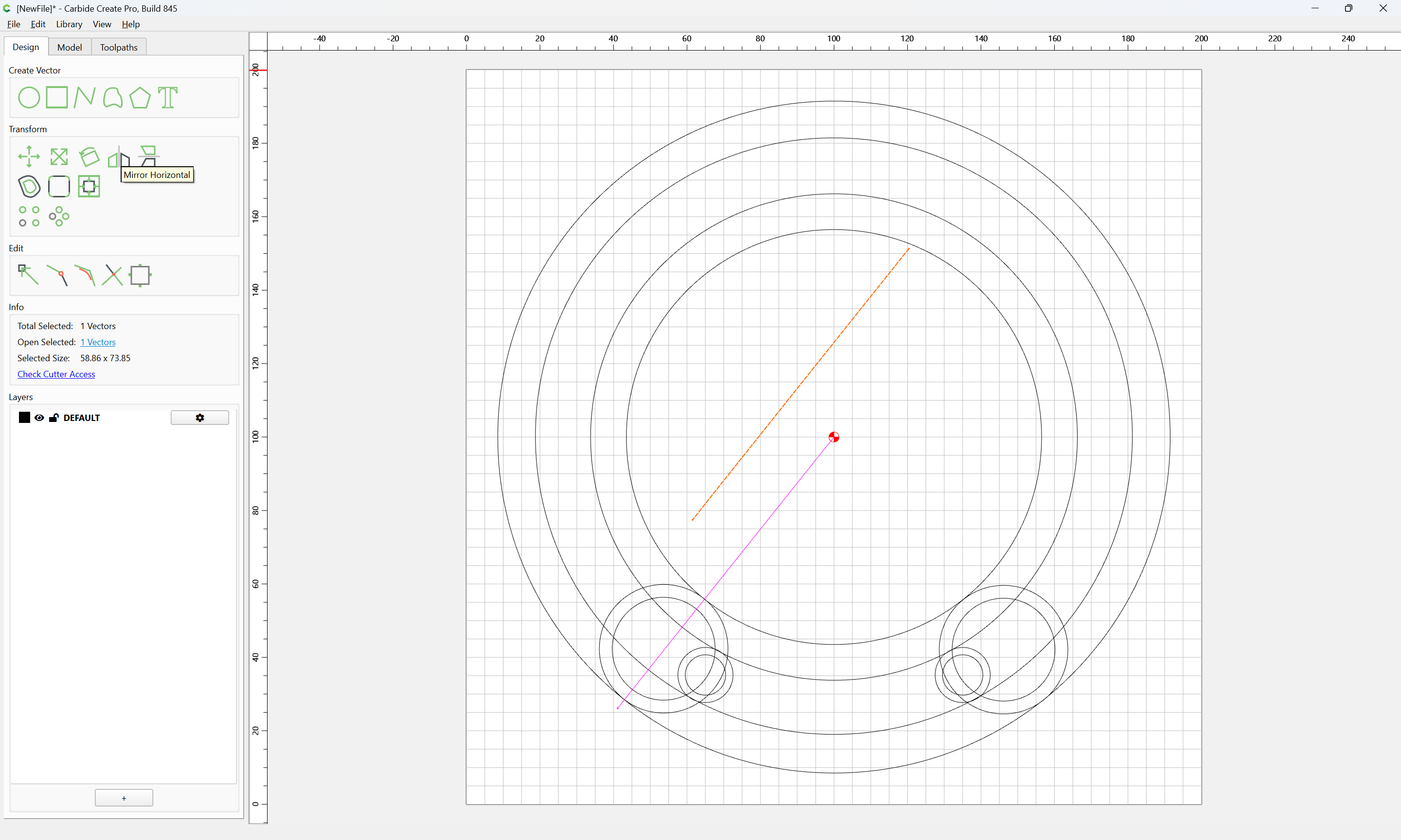

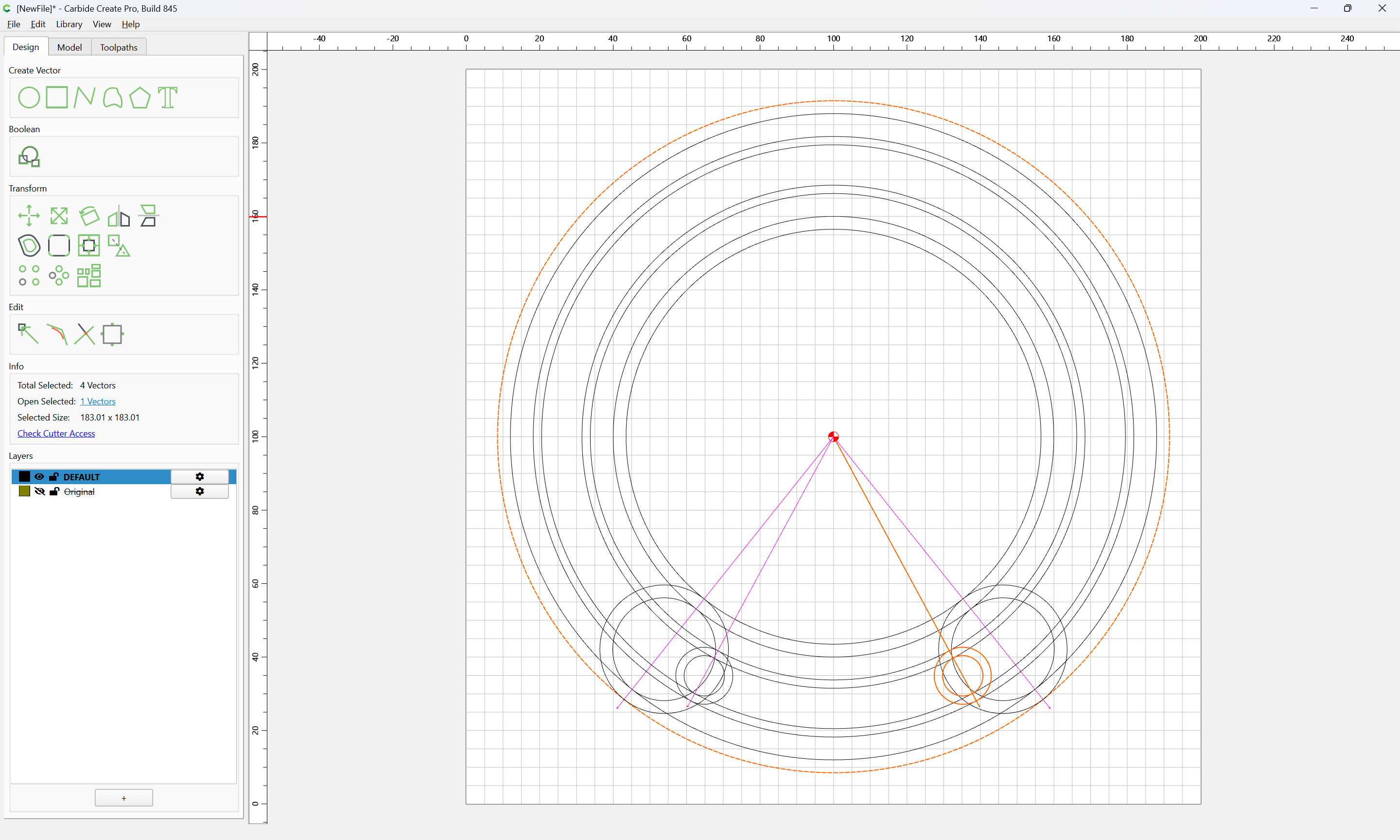

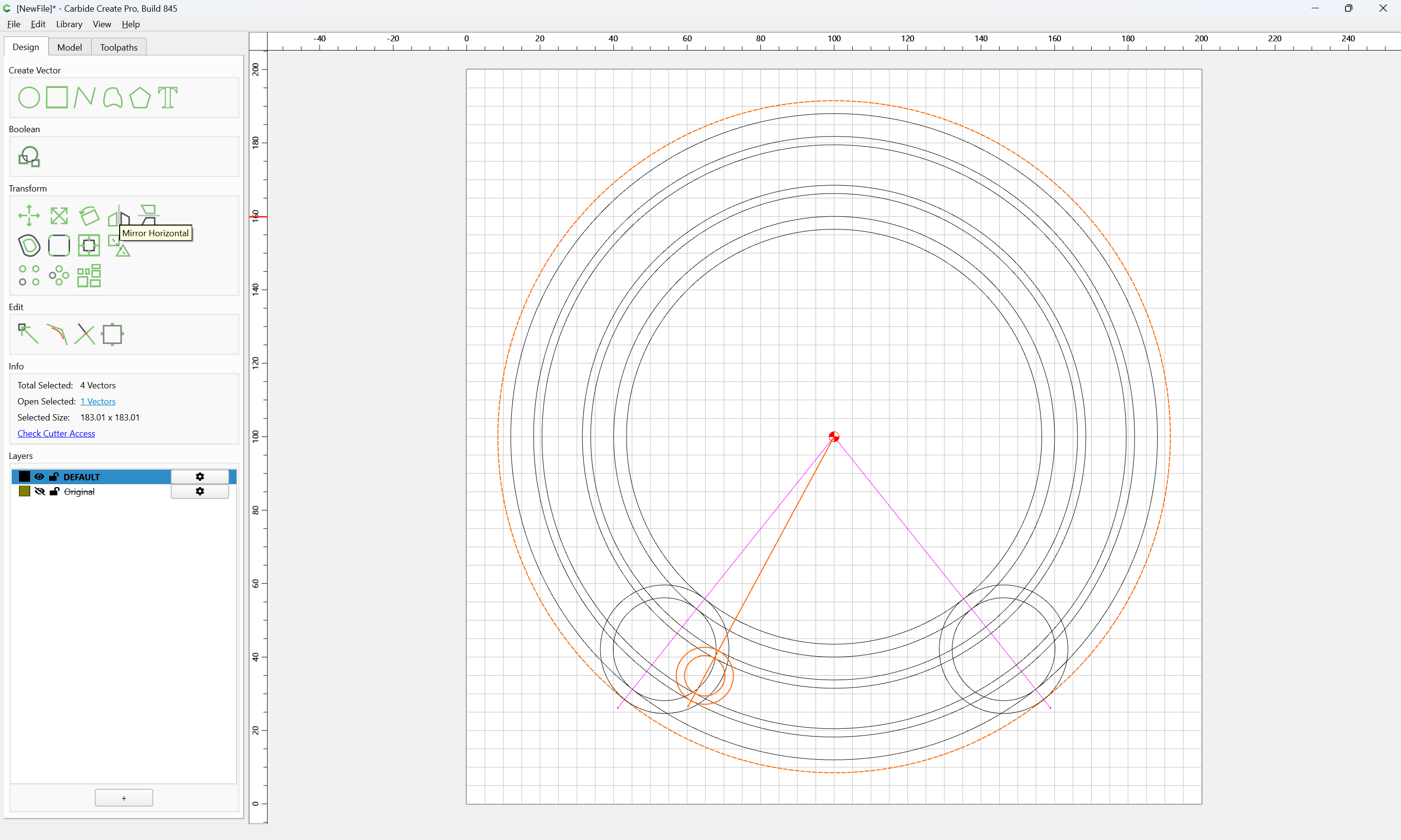

and Mirror Horizontal:

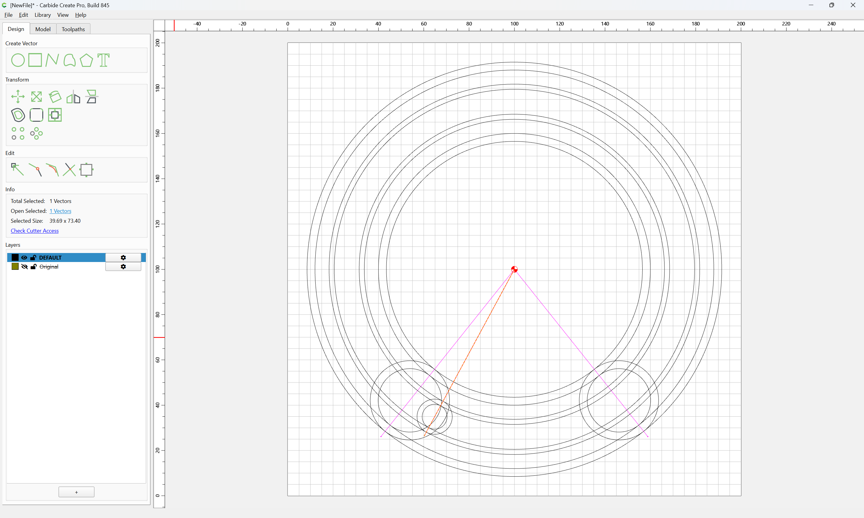

Repeat for the remaining circles:
Done

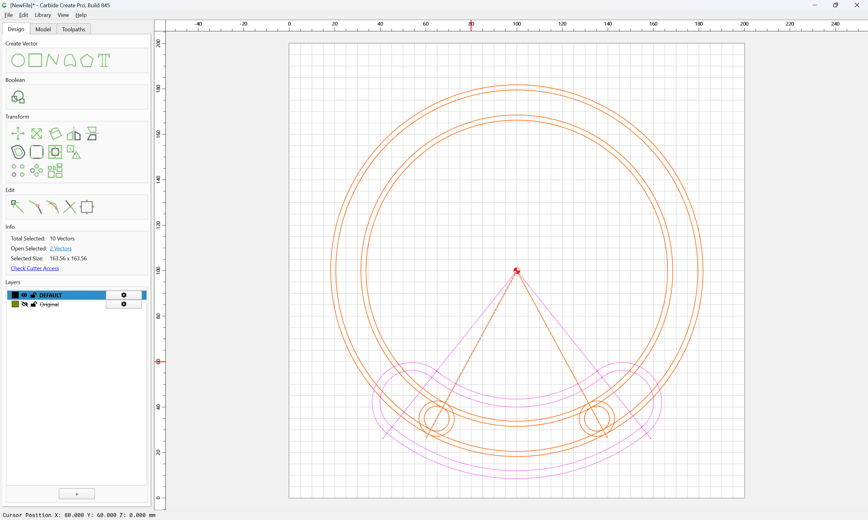

copy-plaste to clone in place:

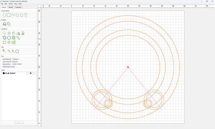

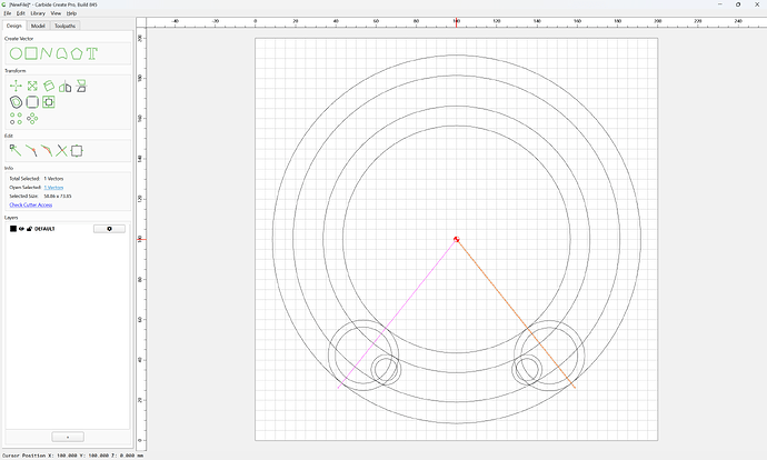

then shift-click on a surrounding centered piece of geometry:
and do the same to the other angled line:

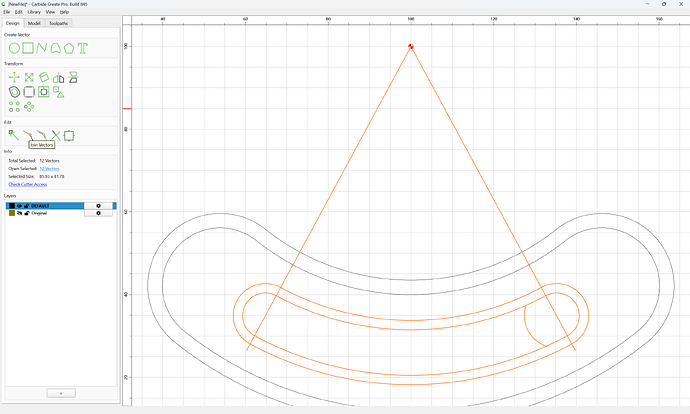

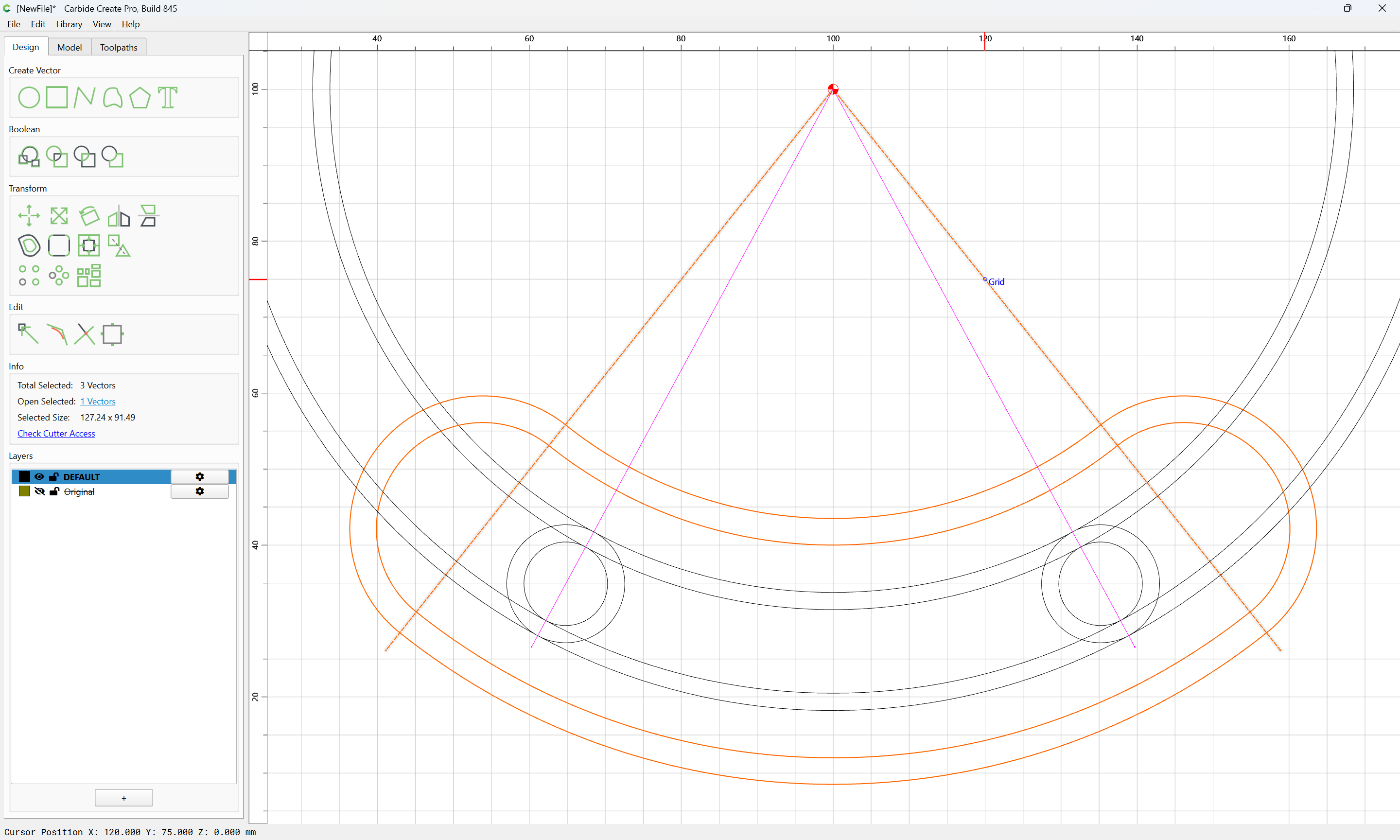

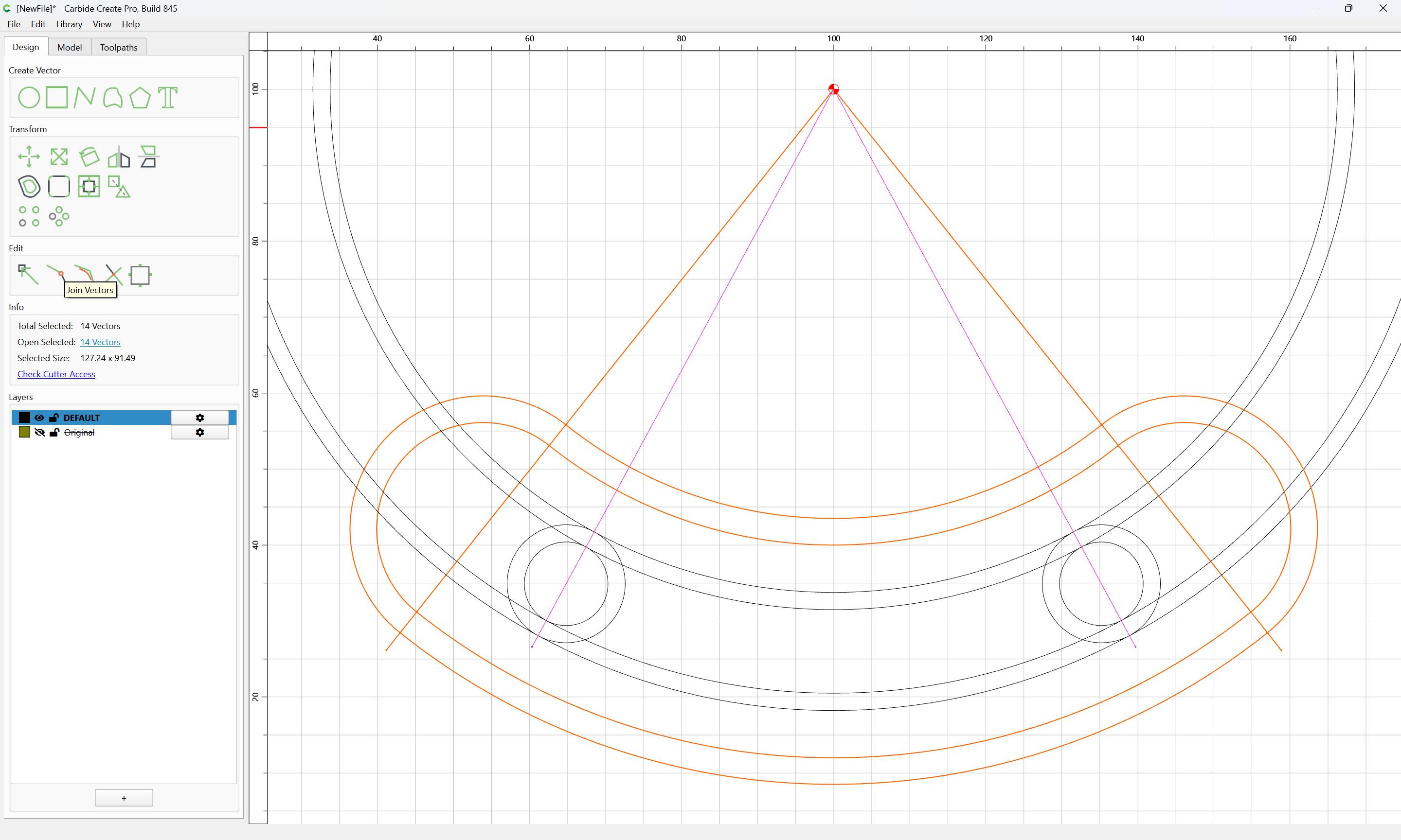

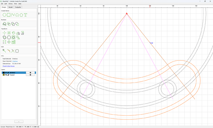

Select the desired elements:

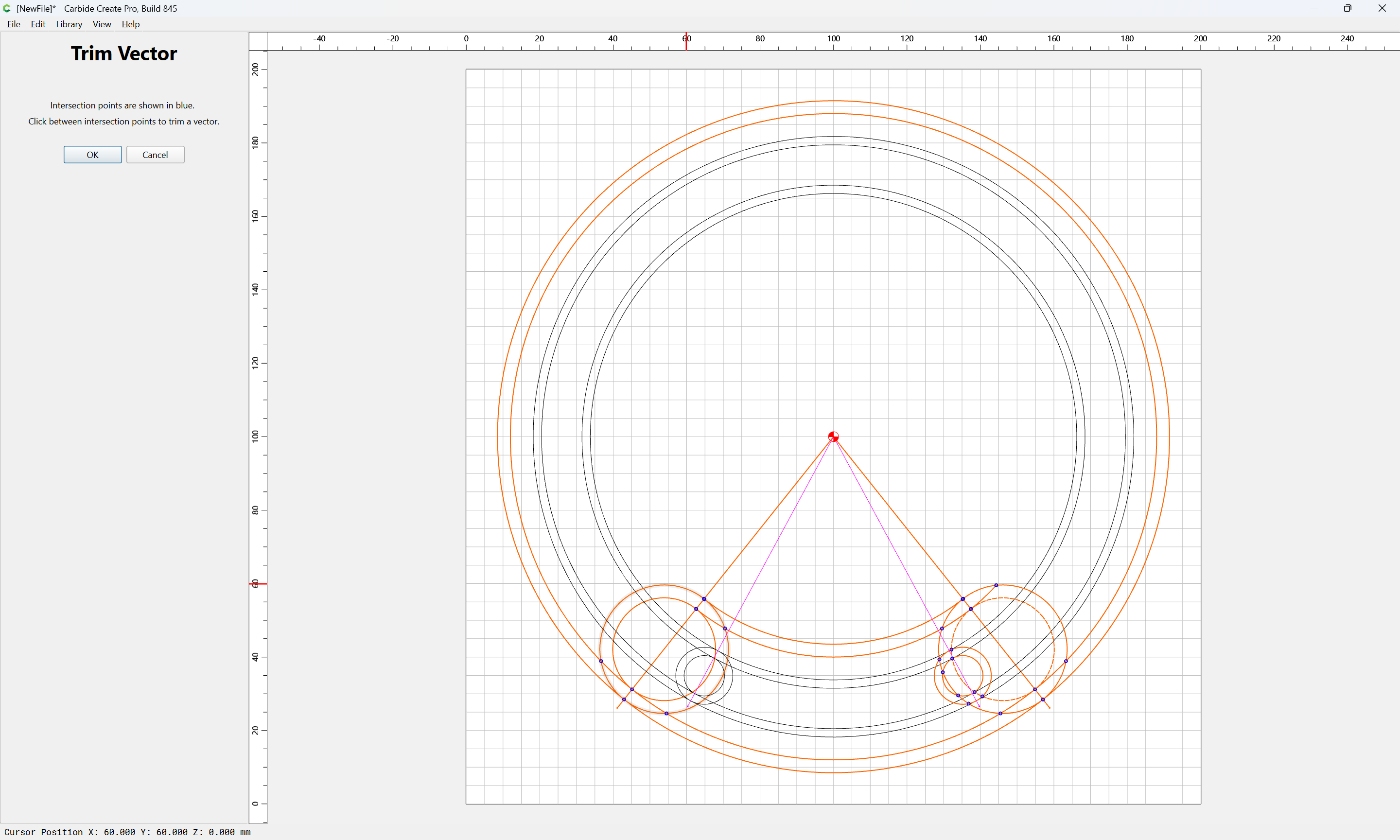

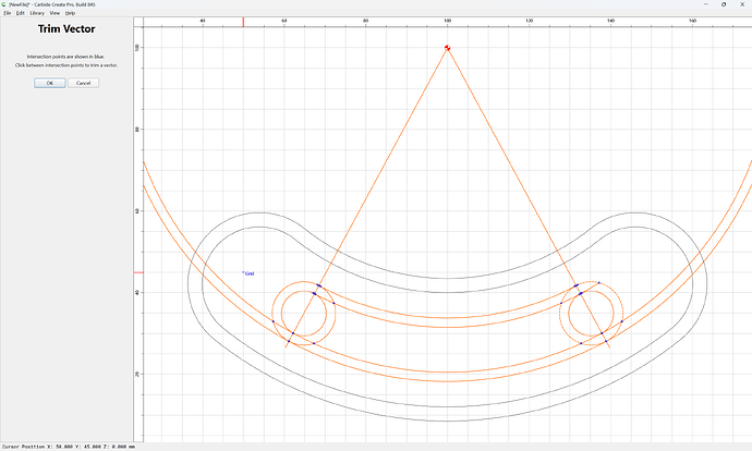

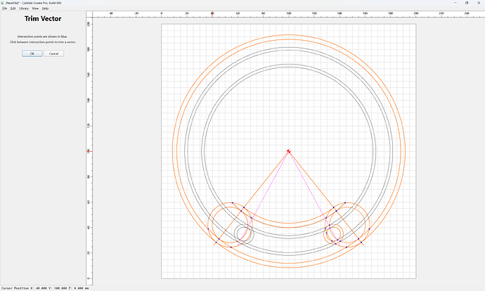

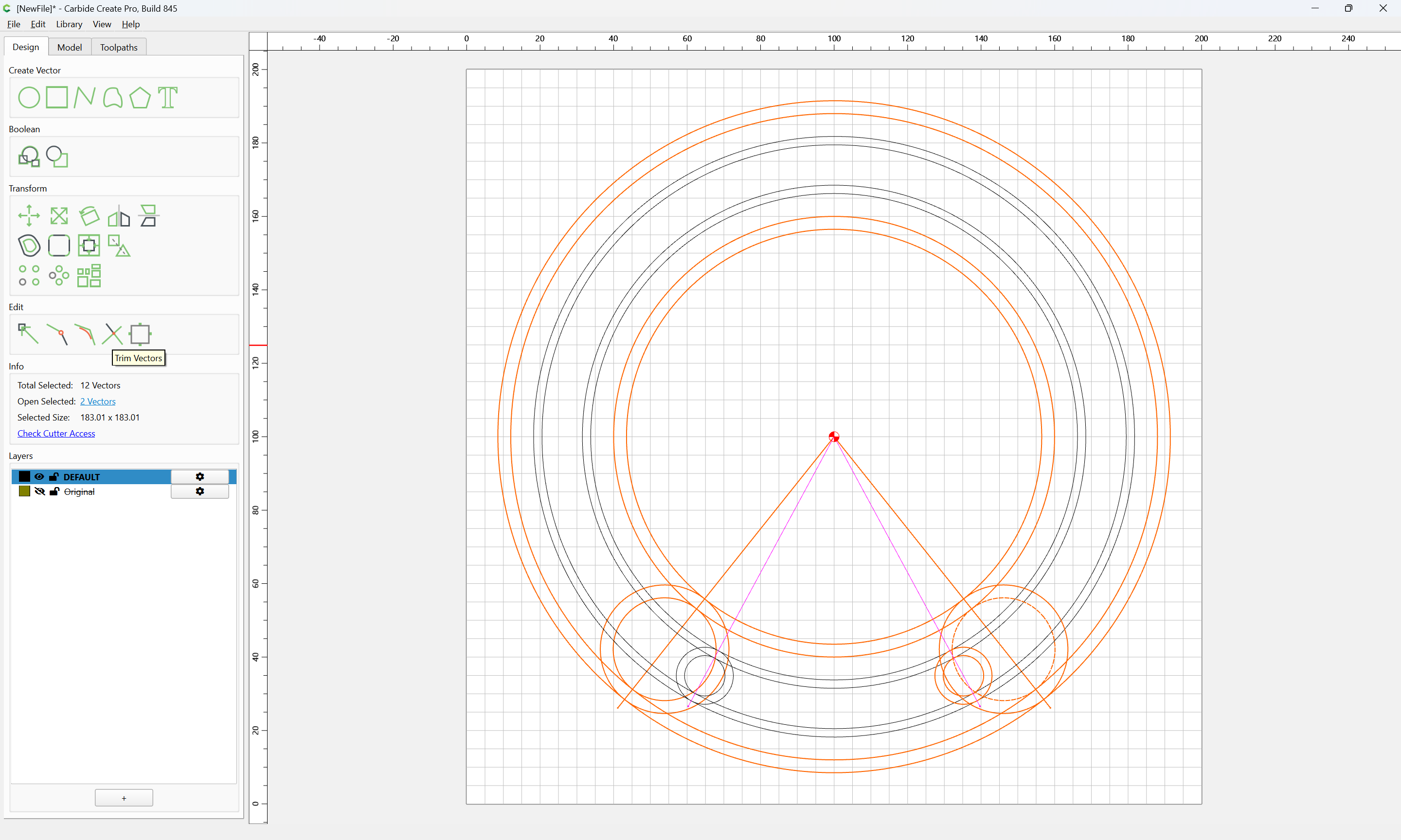

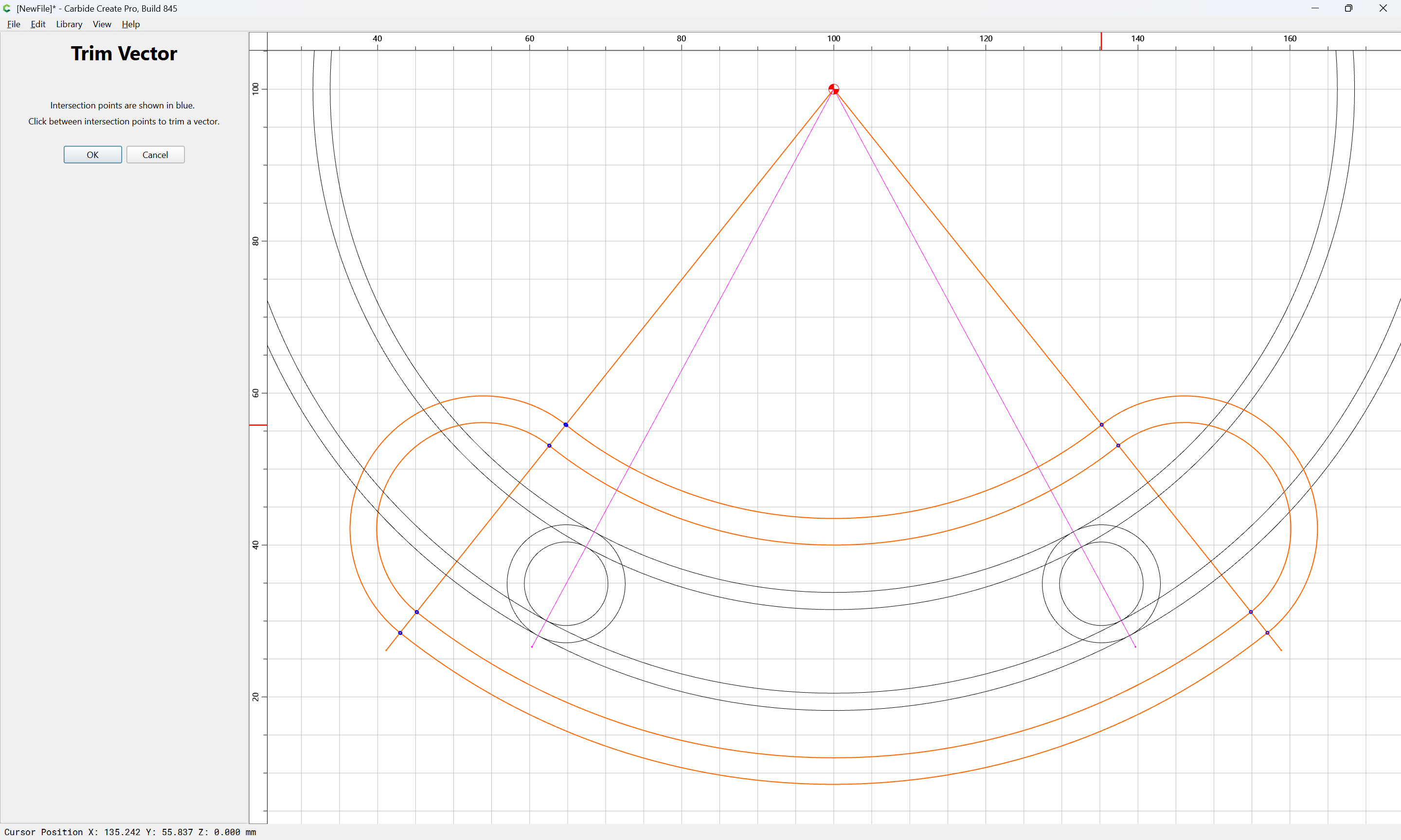

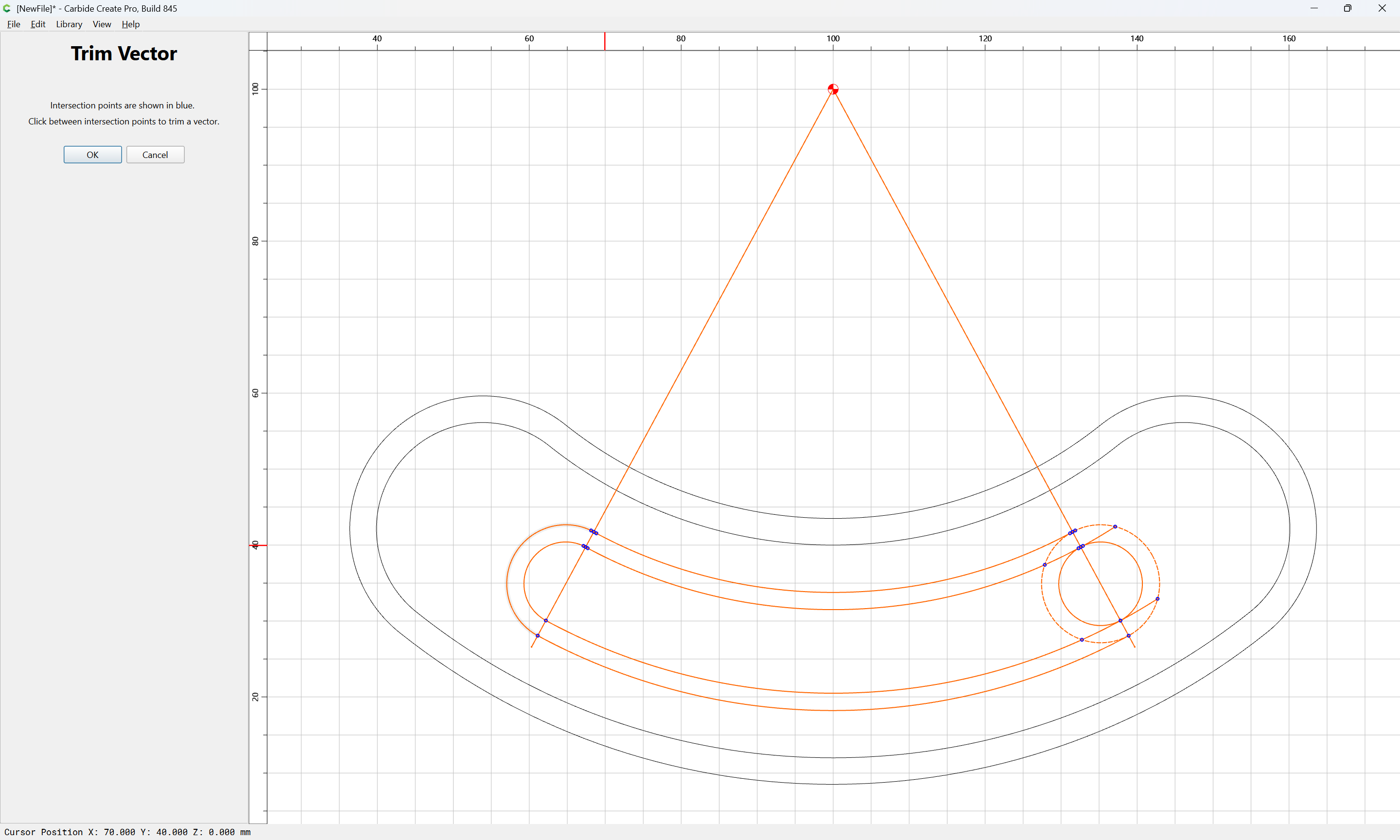

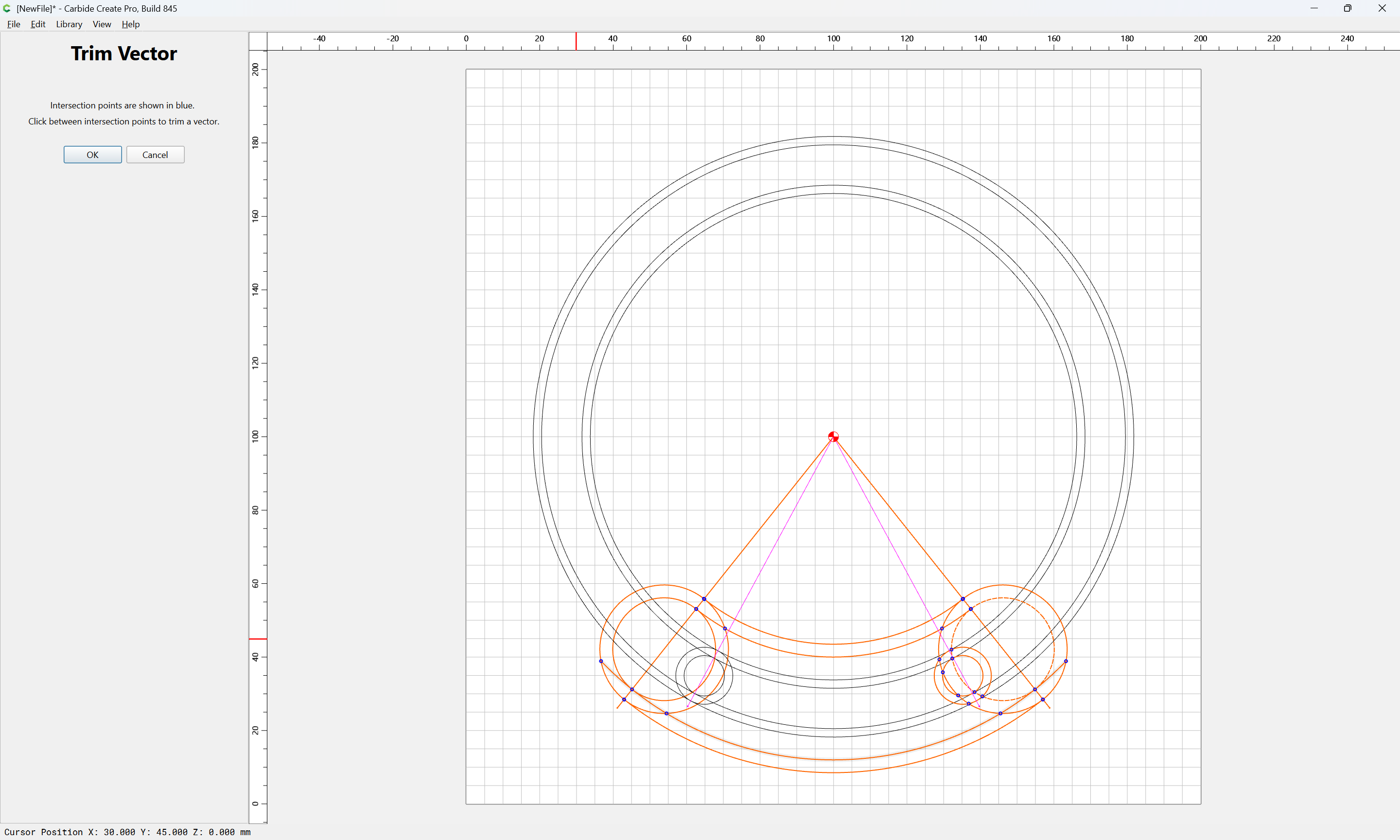

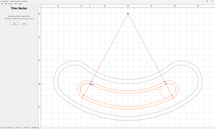

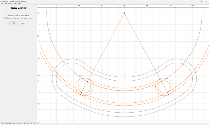

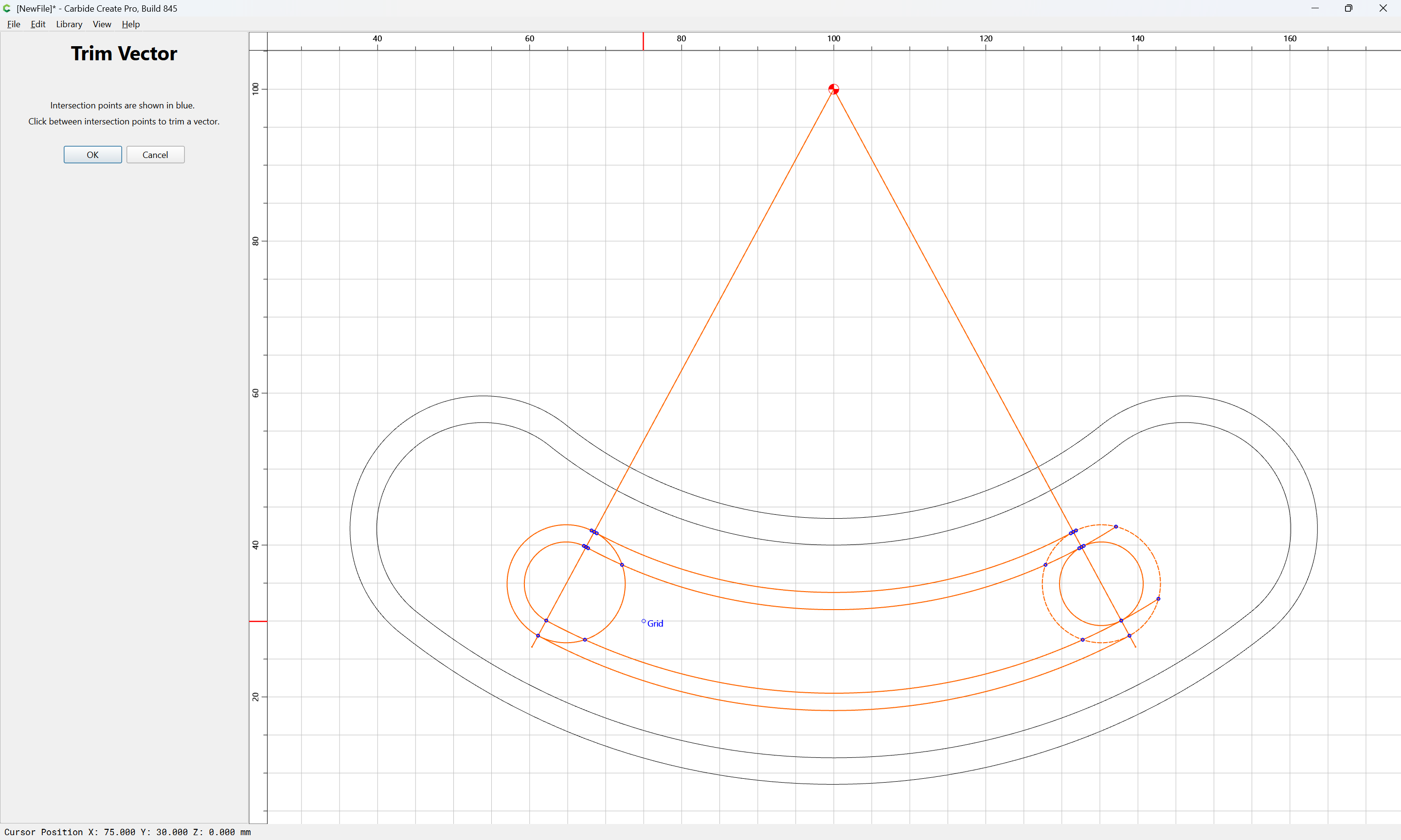

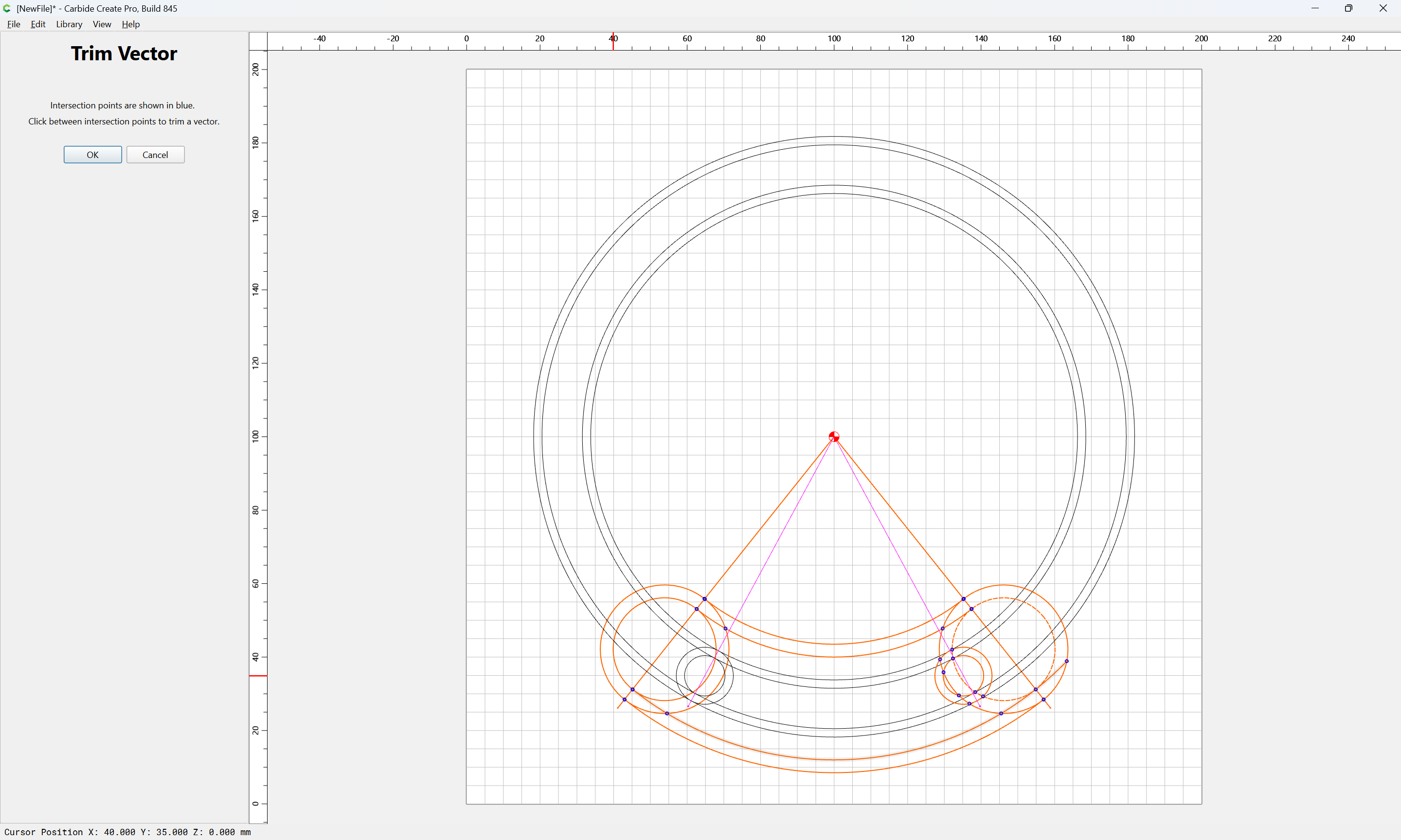

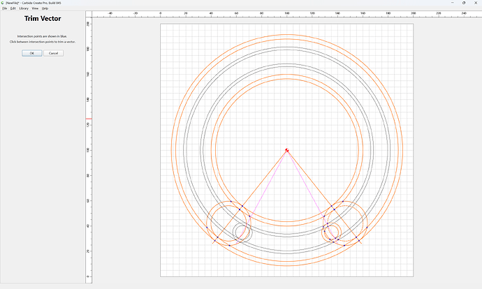

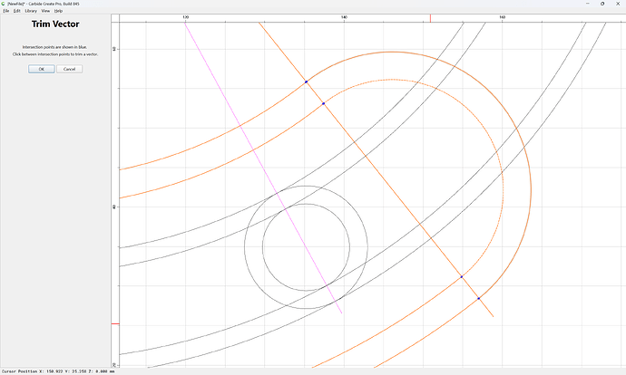

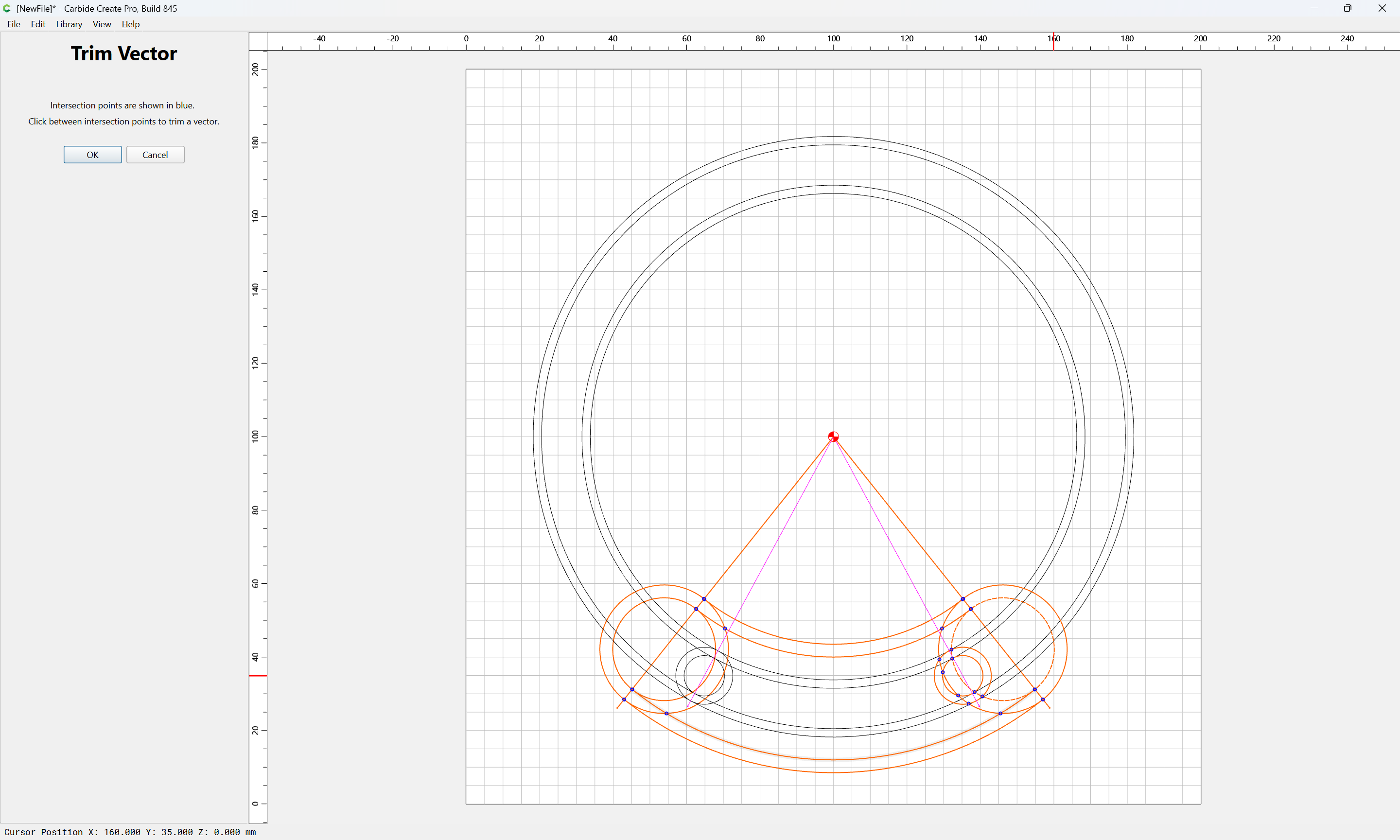

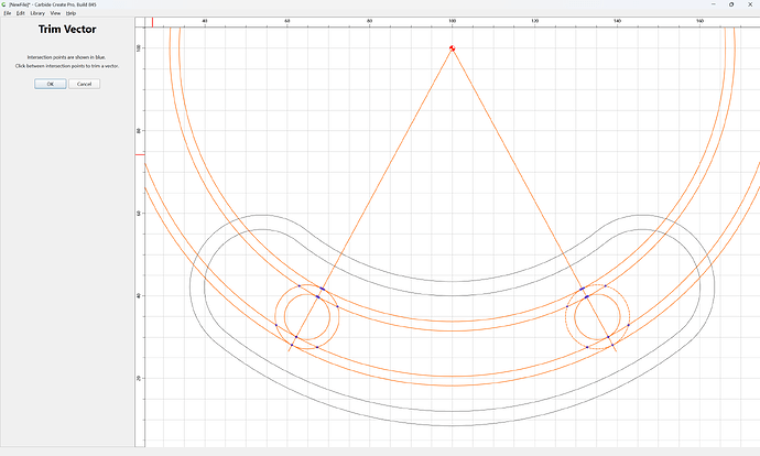

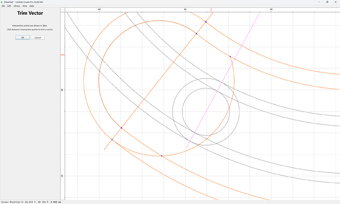

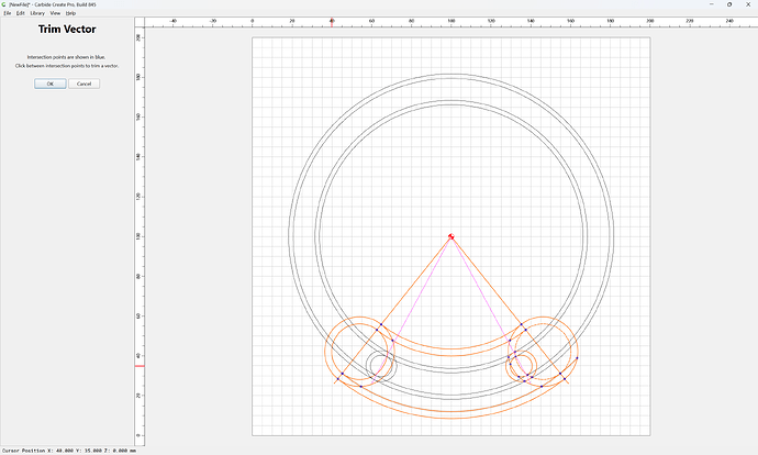

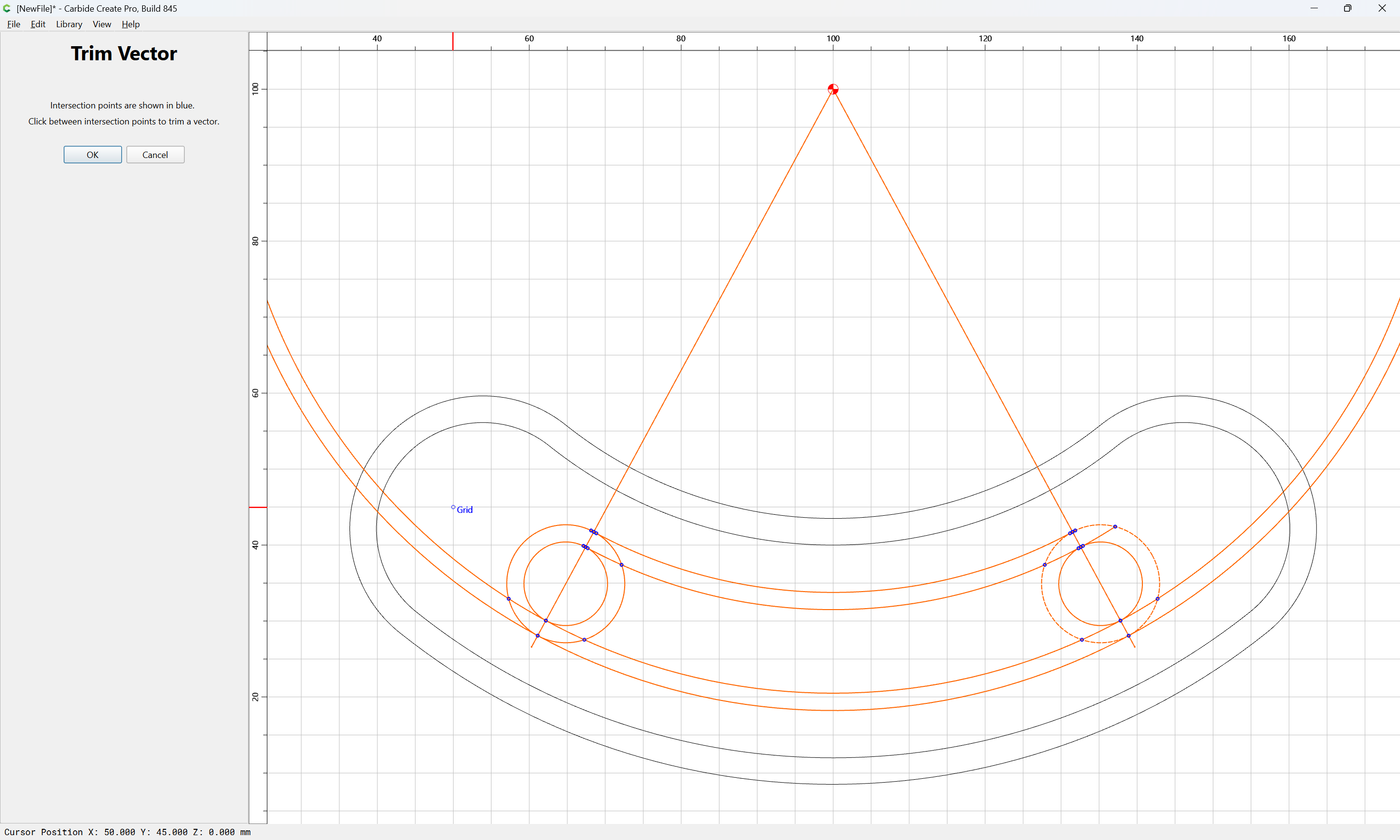

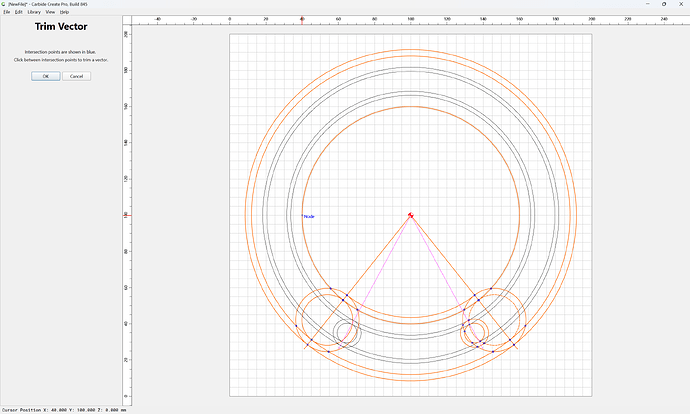

With a full set of geometry which is correctly aligned, then it is simply a matter of selecting each subset:

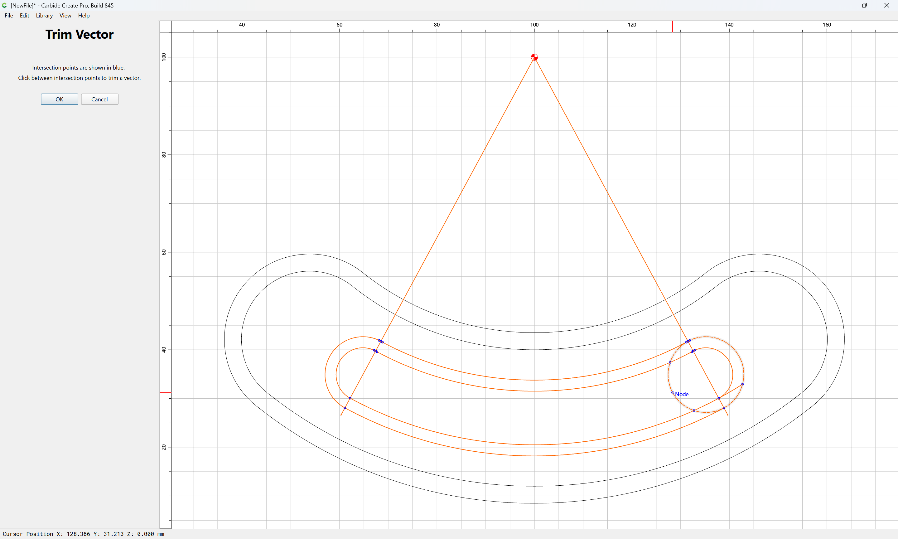

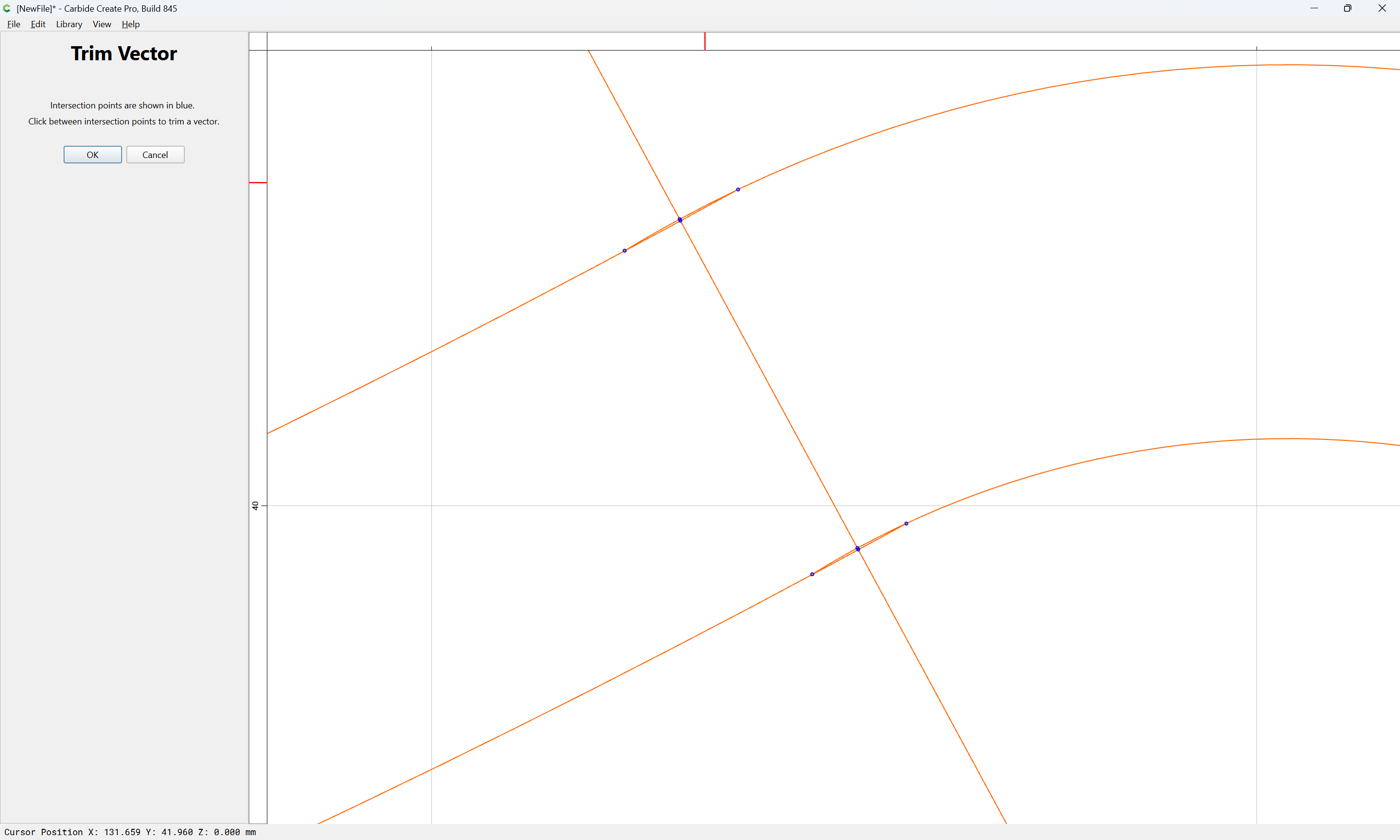

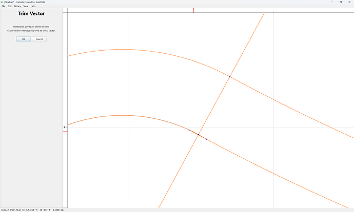

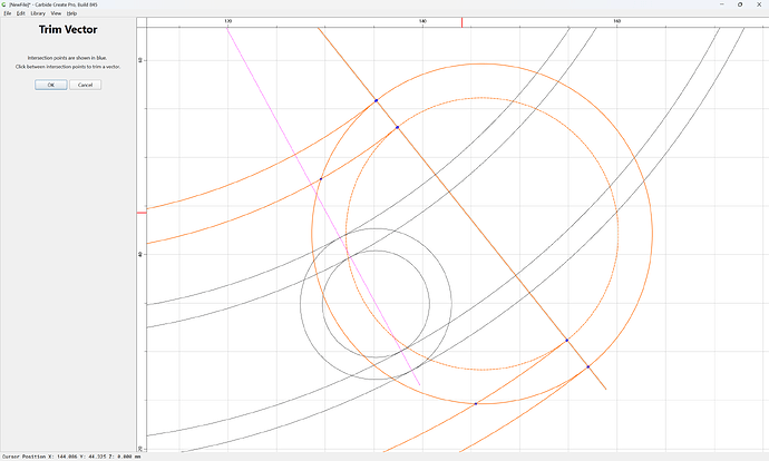

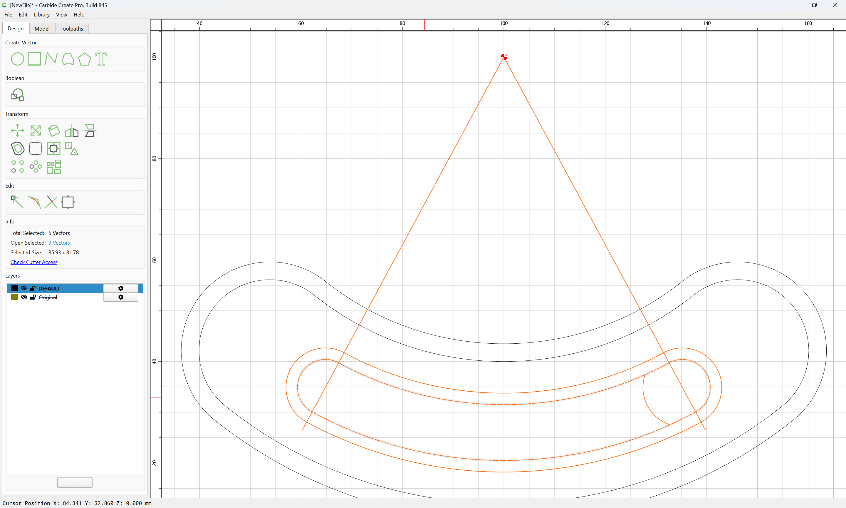

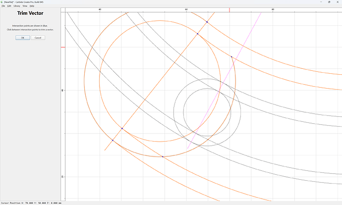

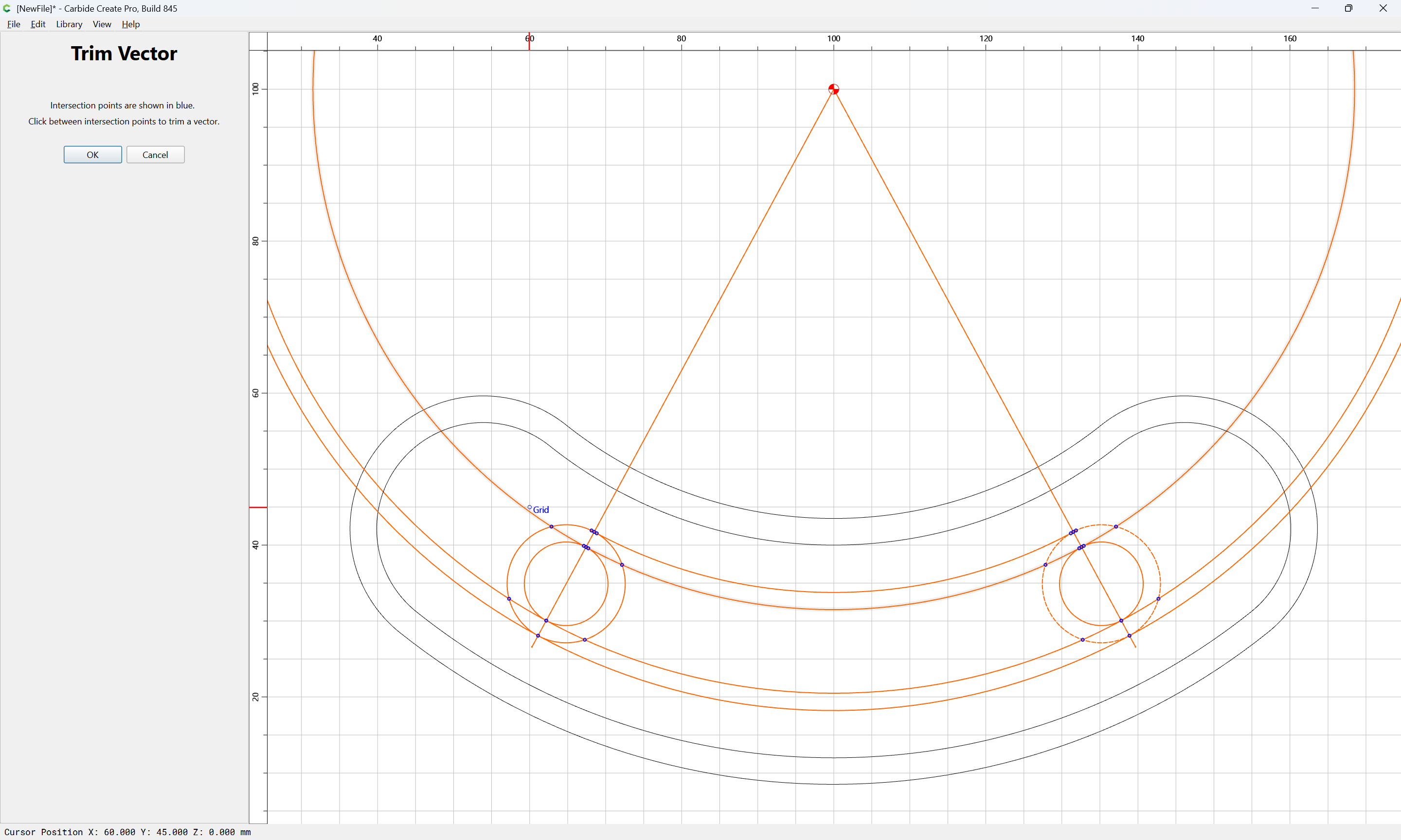

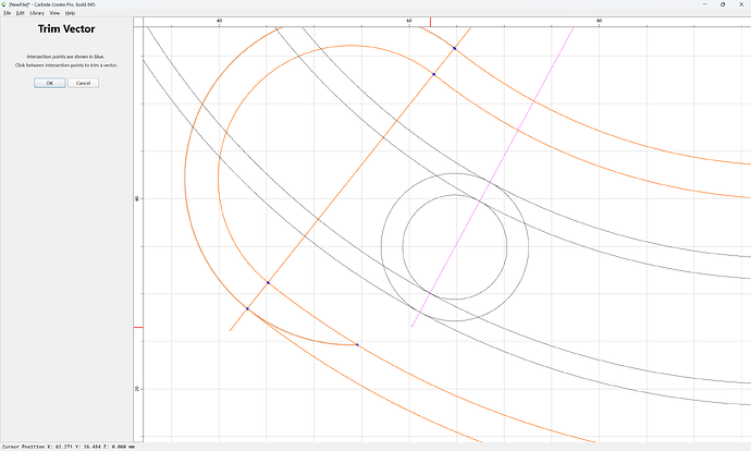

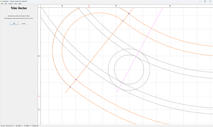

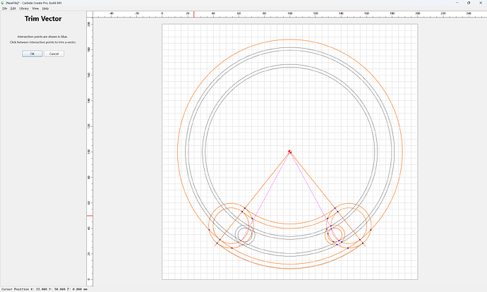

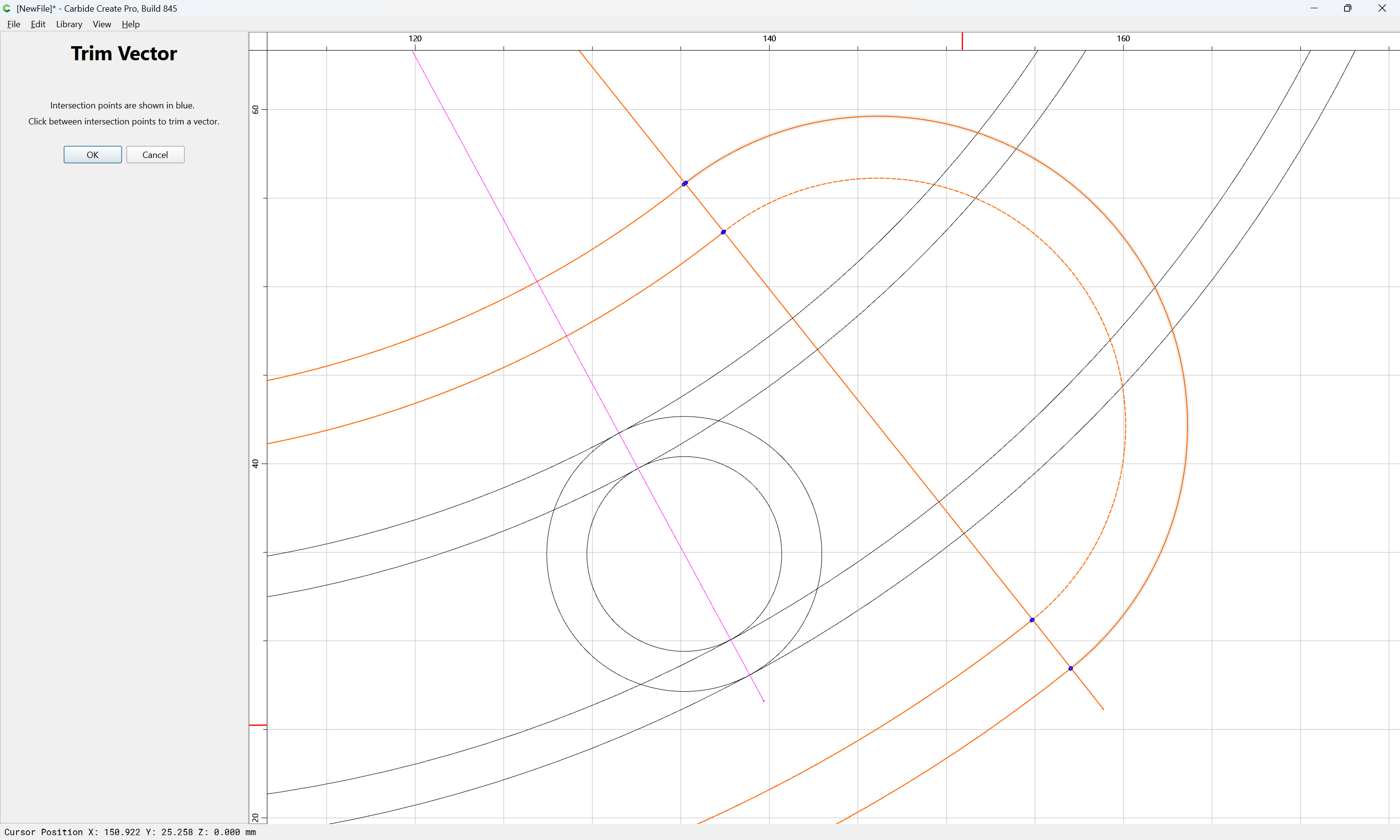

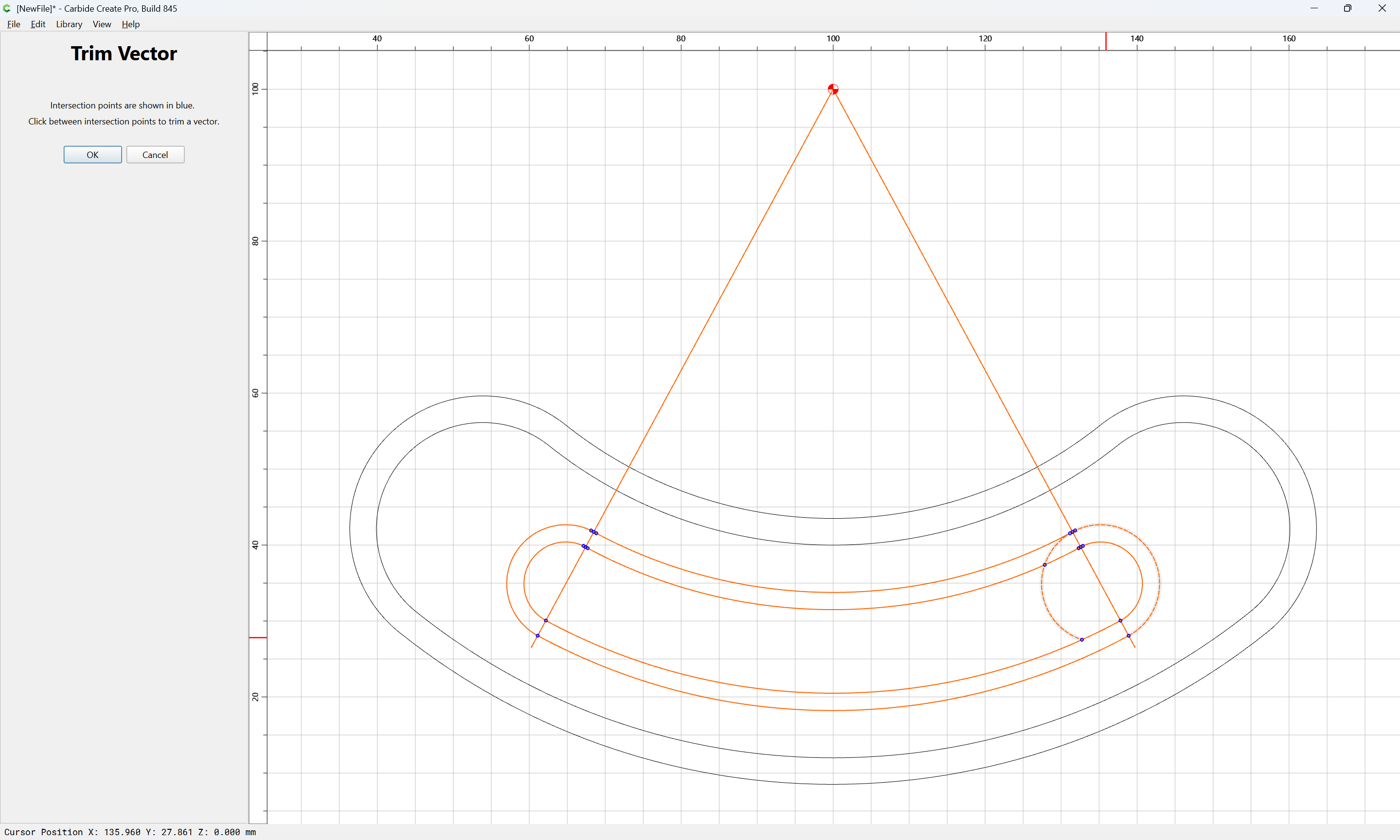

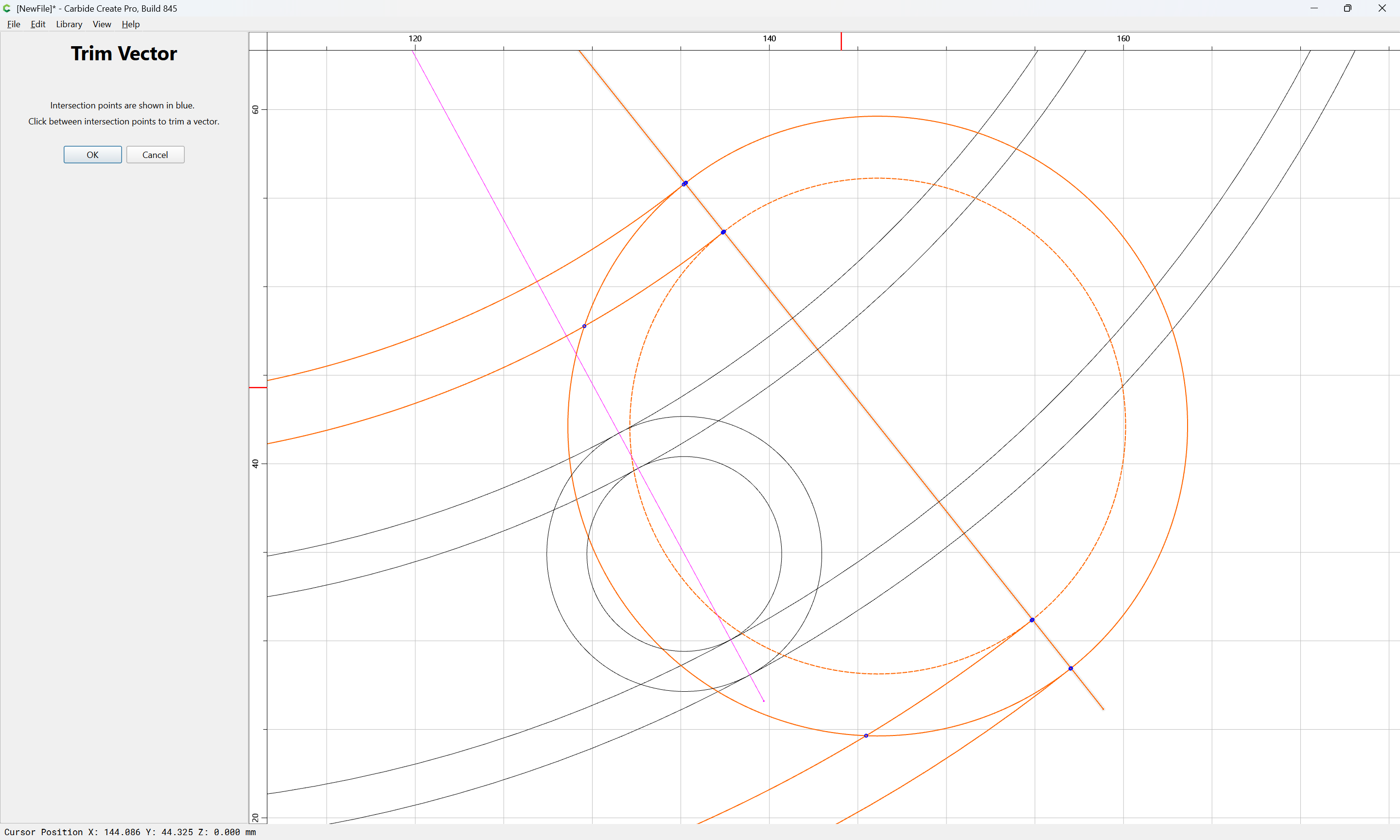

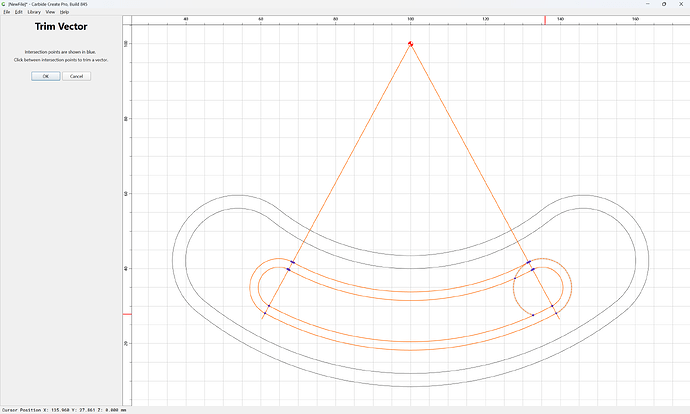

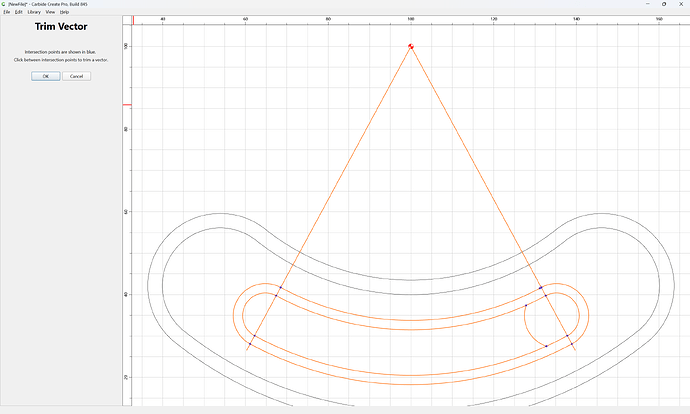

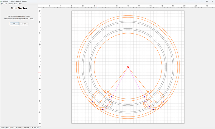

and using Trim Vectors:
to remove what is not wanted:

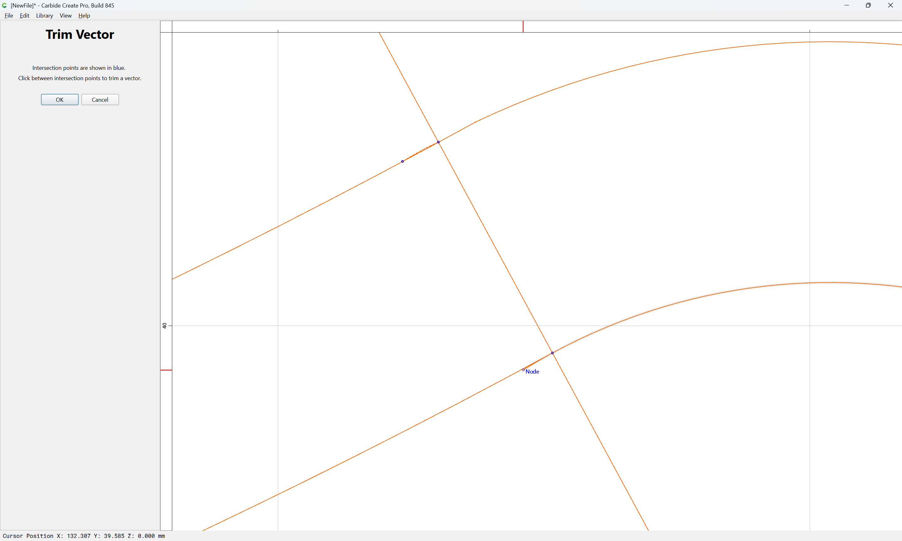

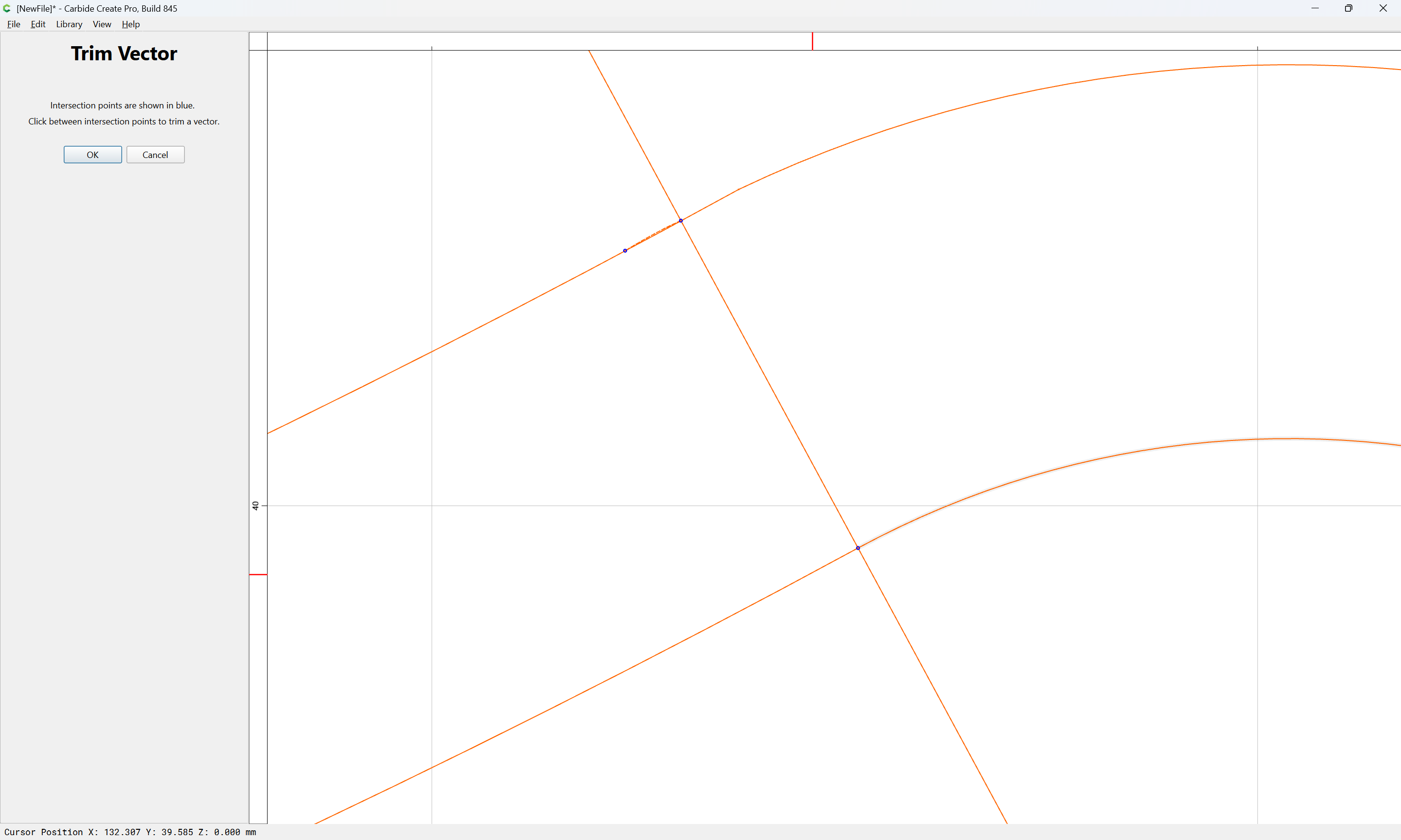

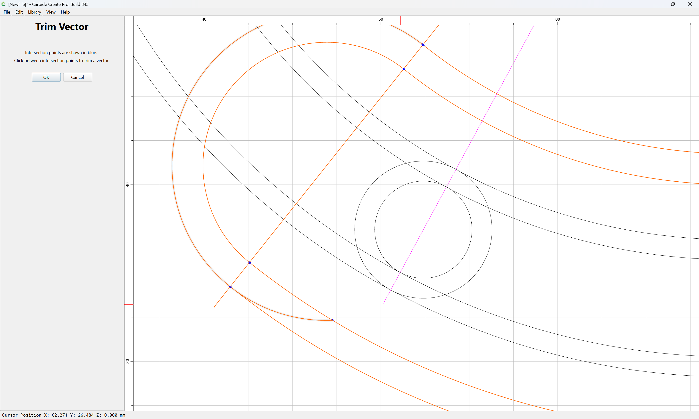

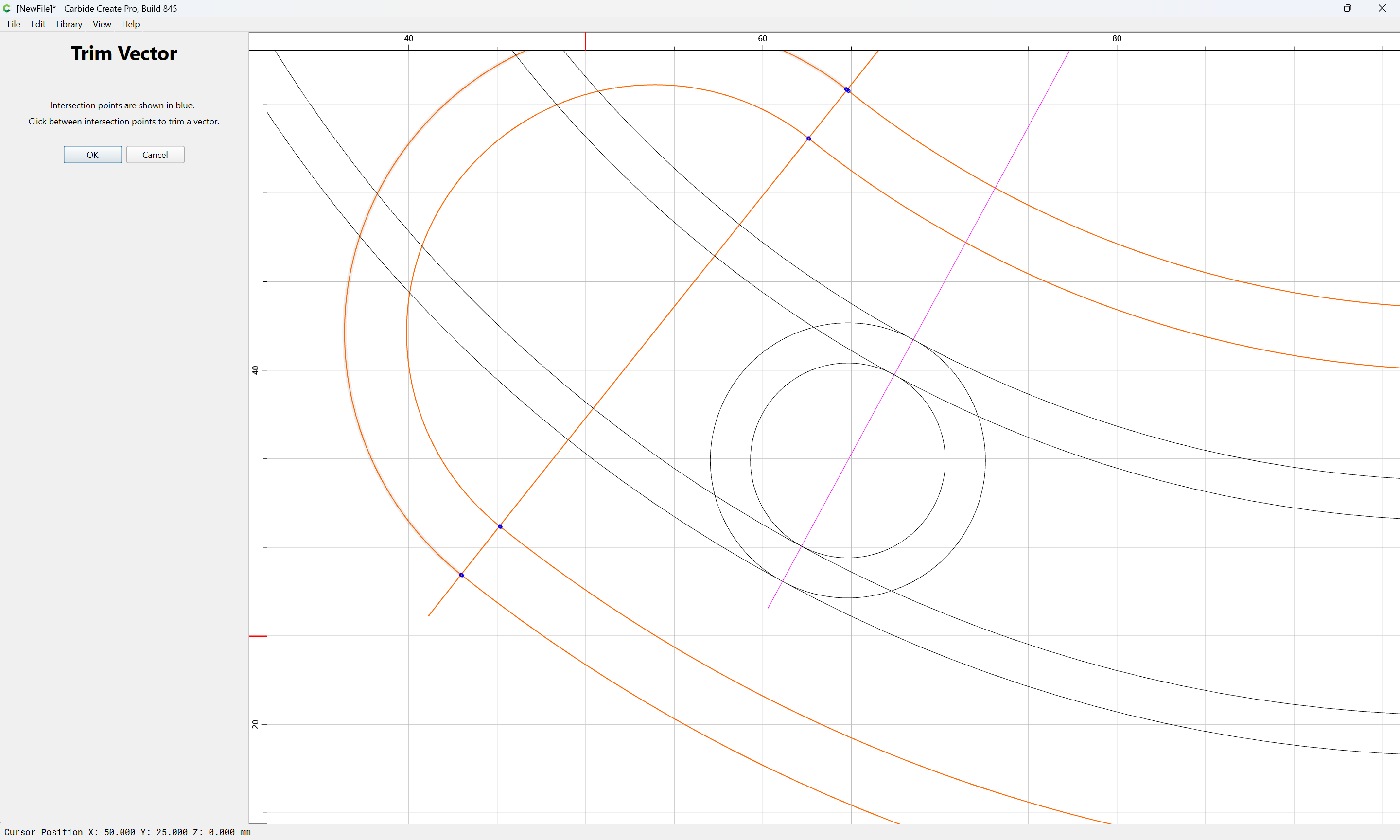

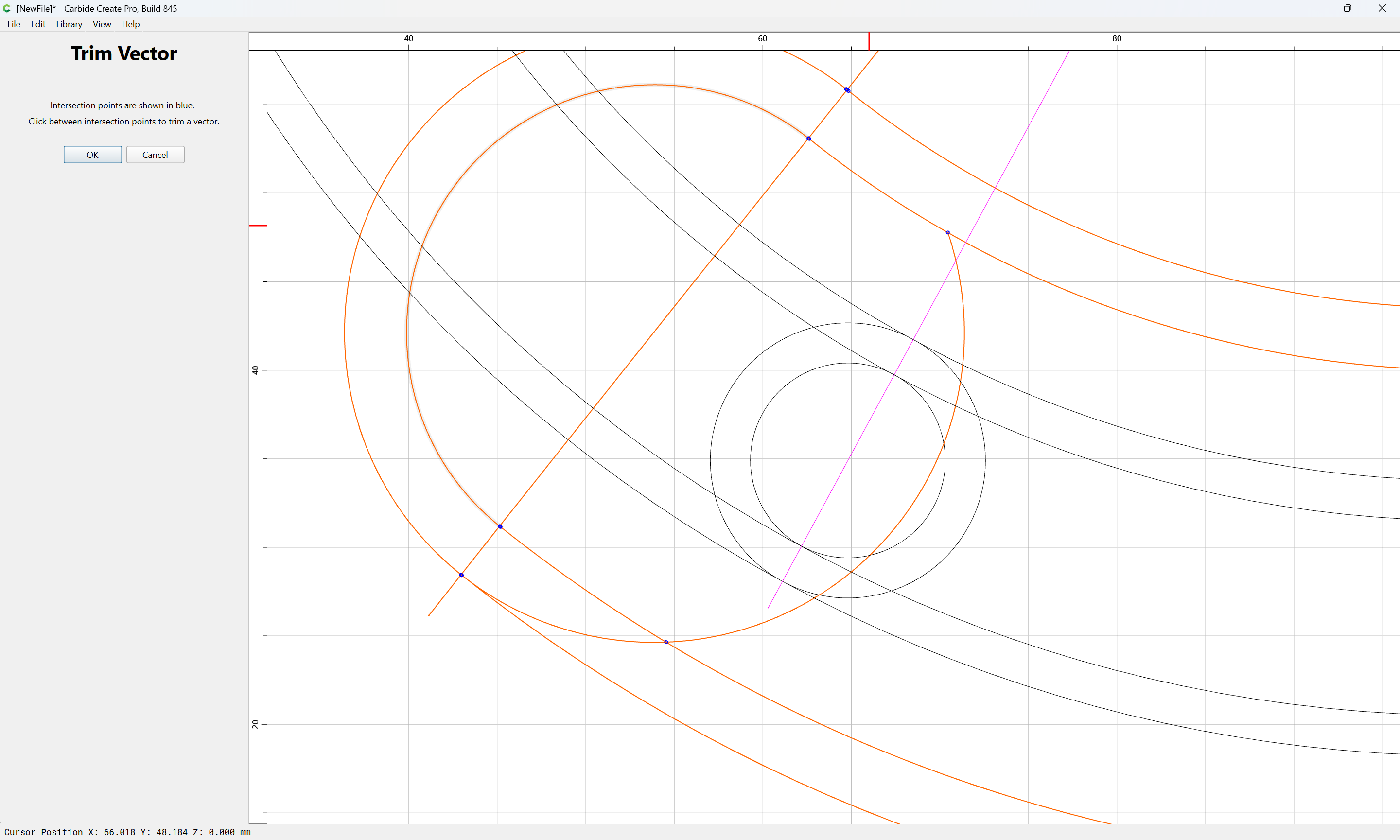

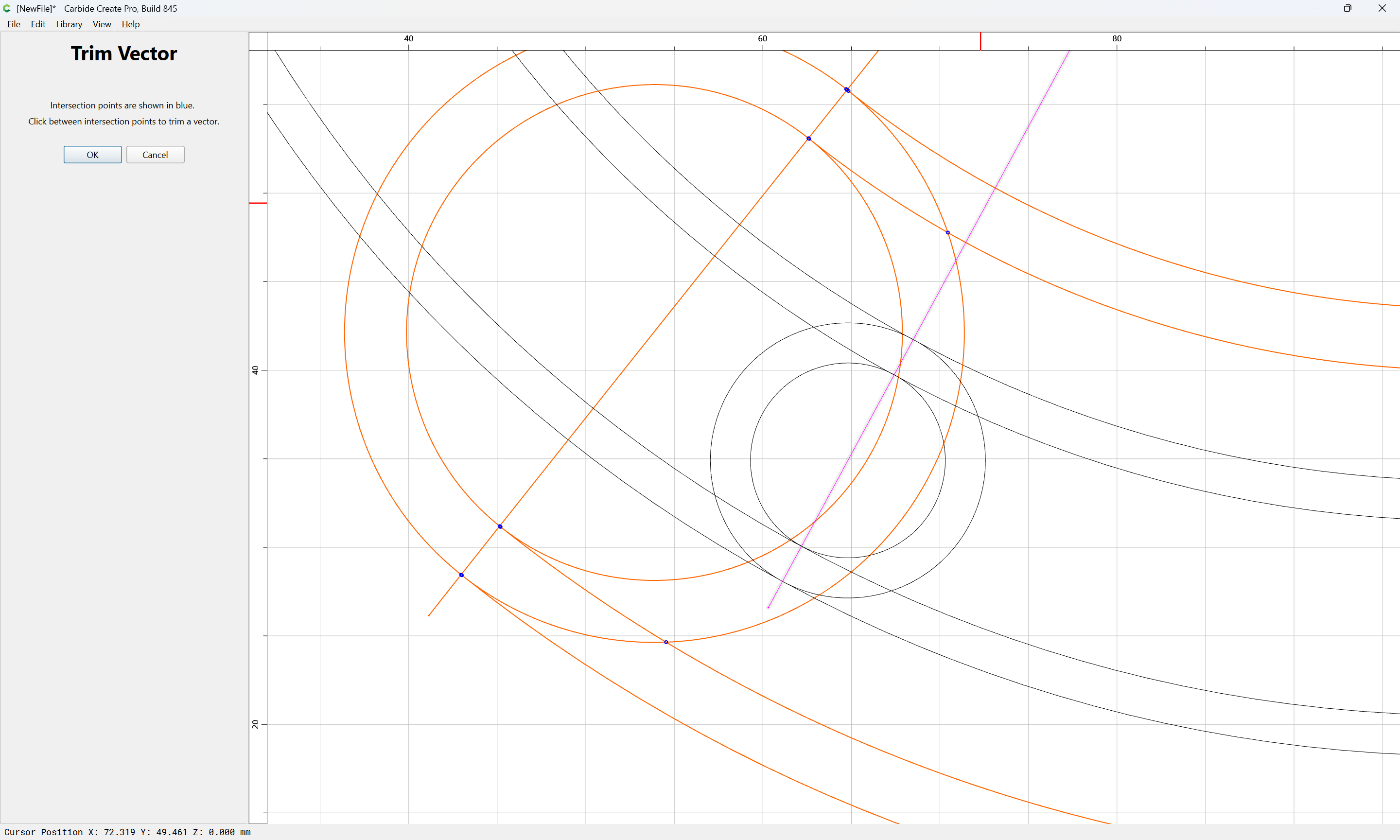

If need be, zoom in on an area:
repeating on the other side:

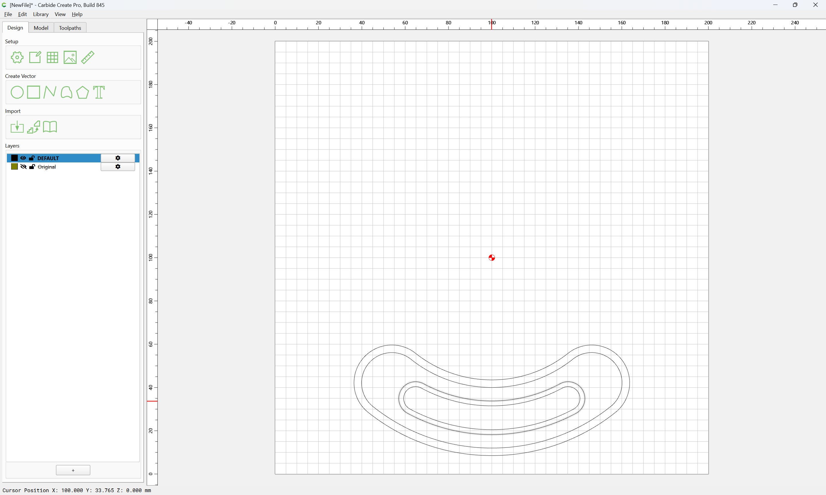

until one arrives at:
OK
Join Vectors:
Yes
shift-click to remove the finished elements from the selection:
and delete

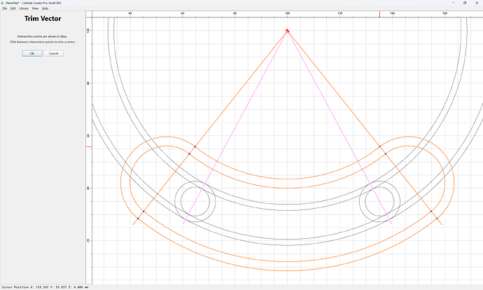

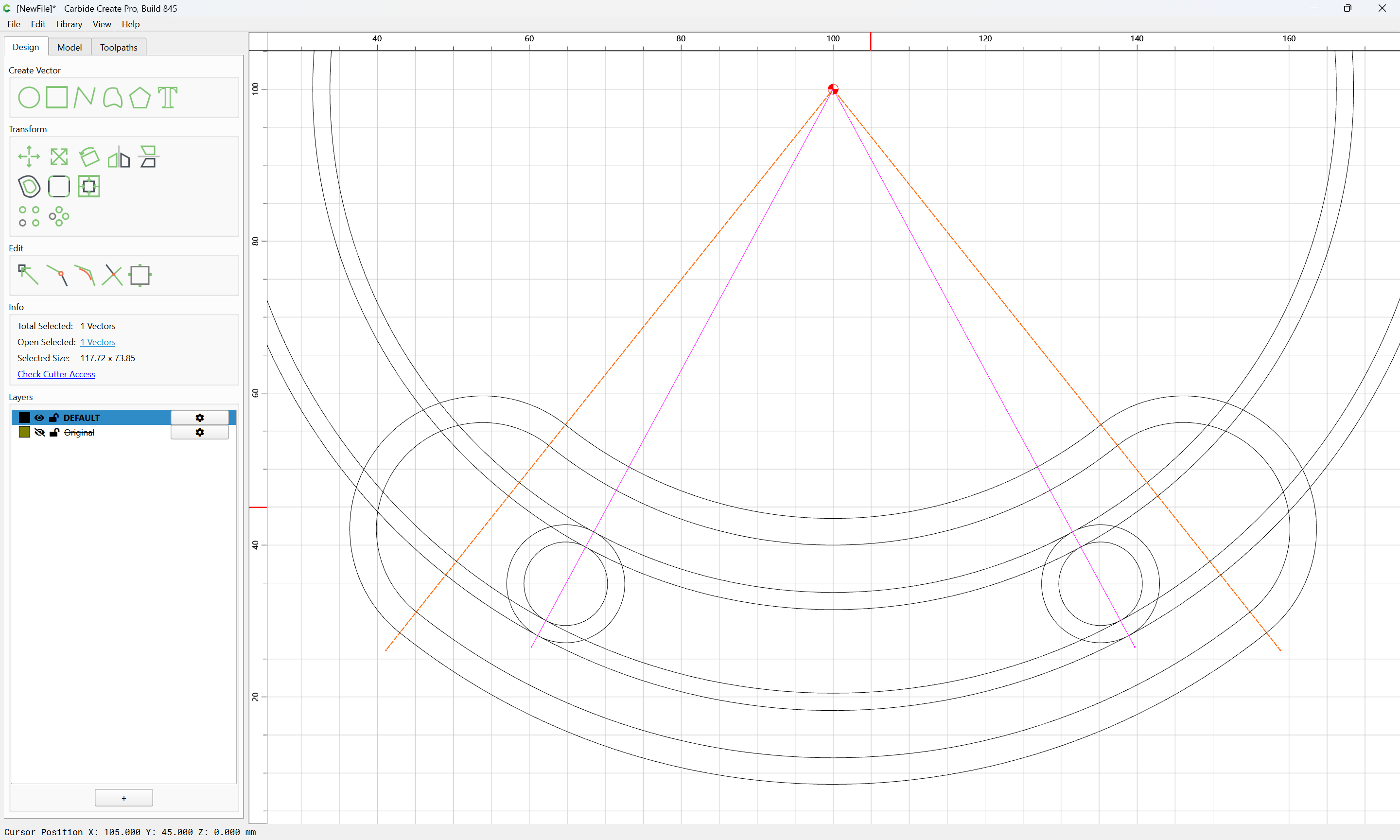

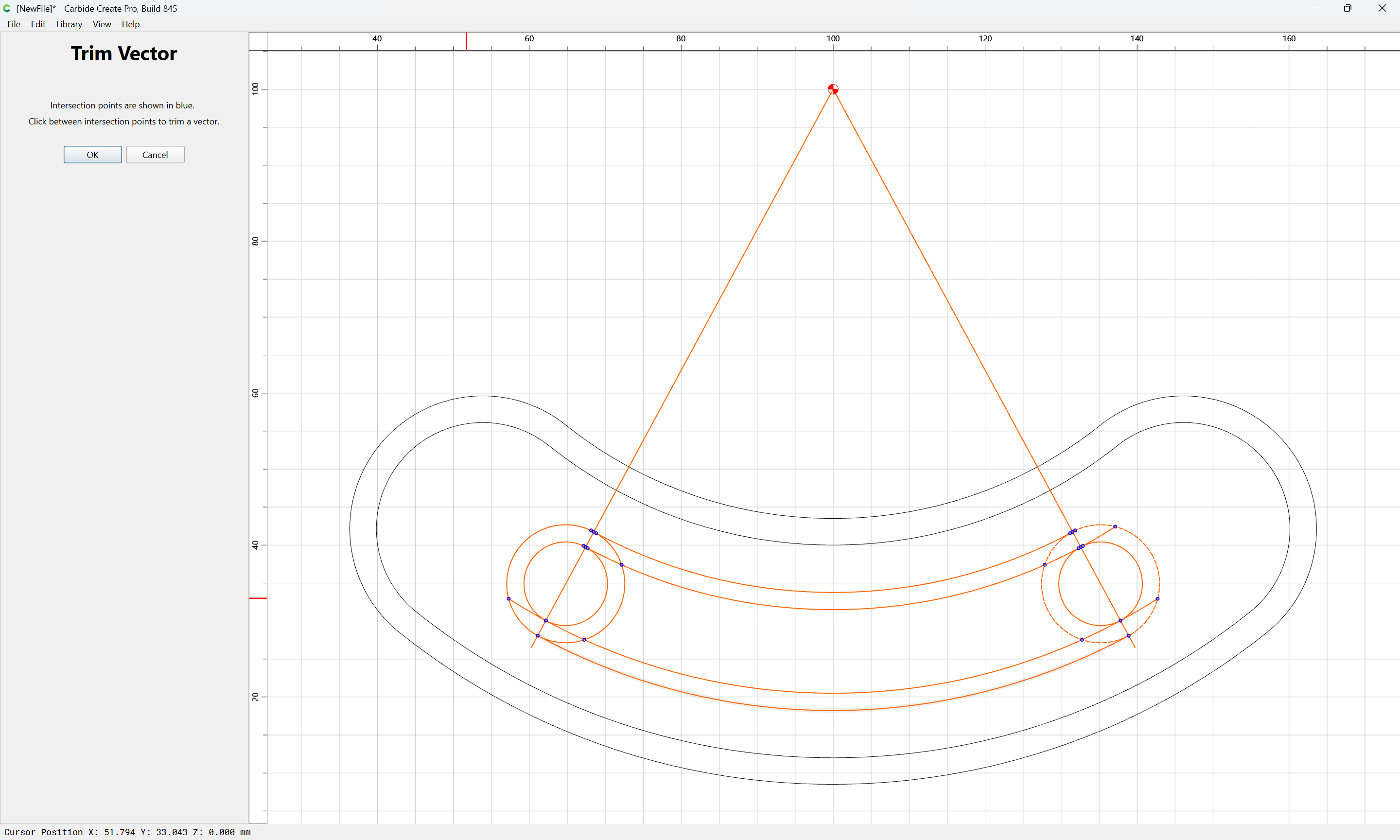

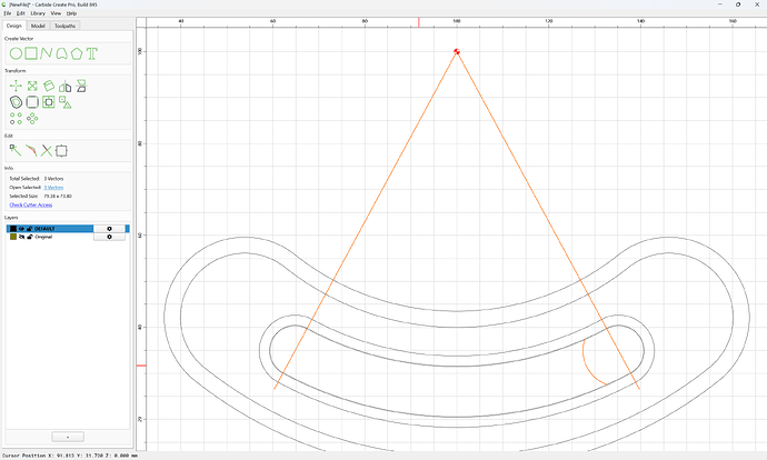

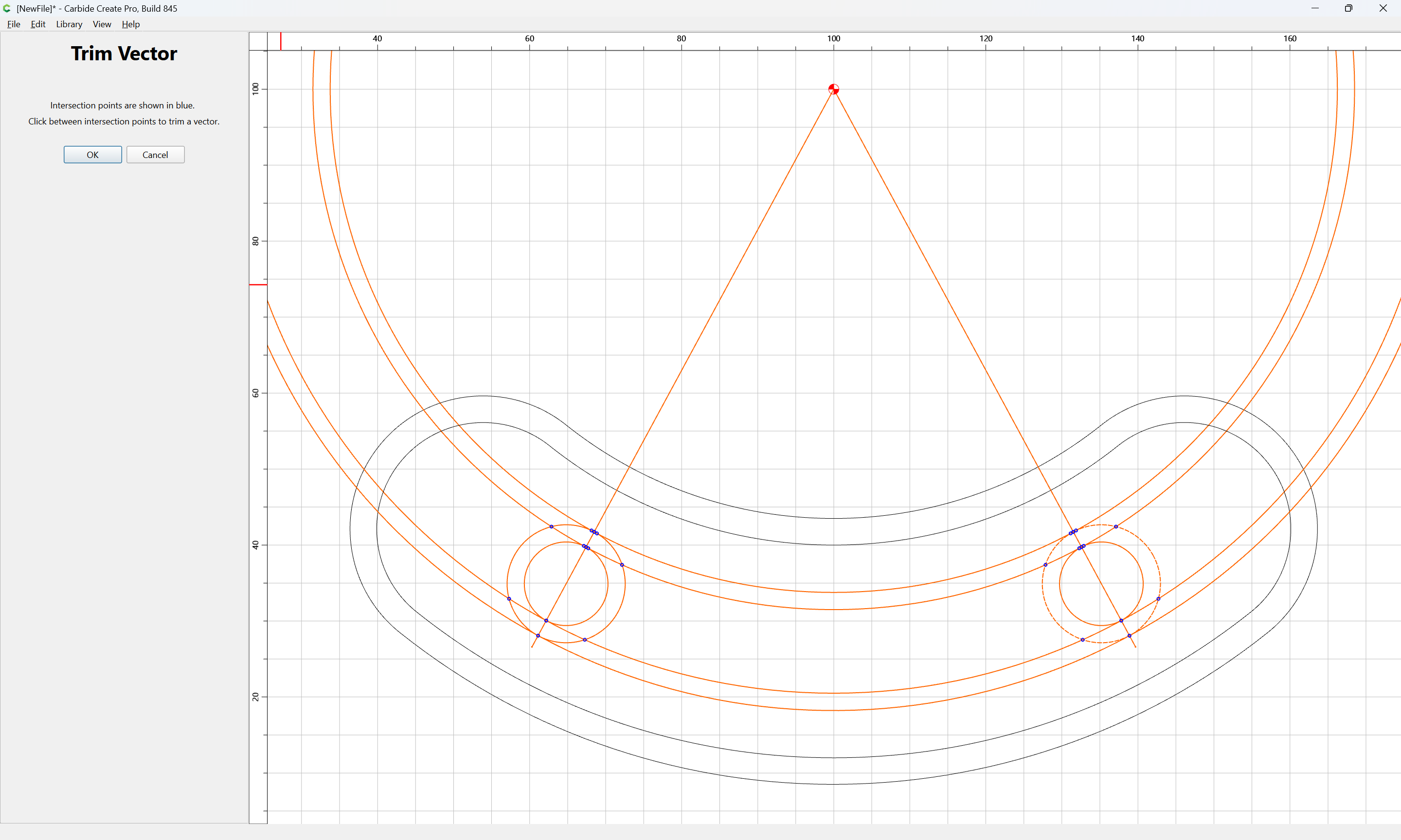

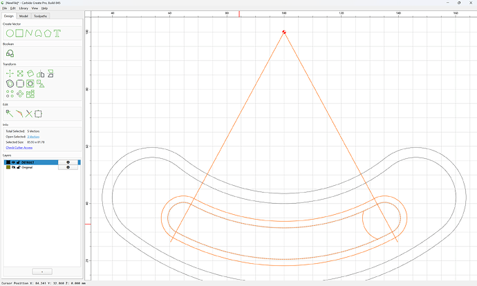

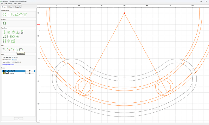

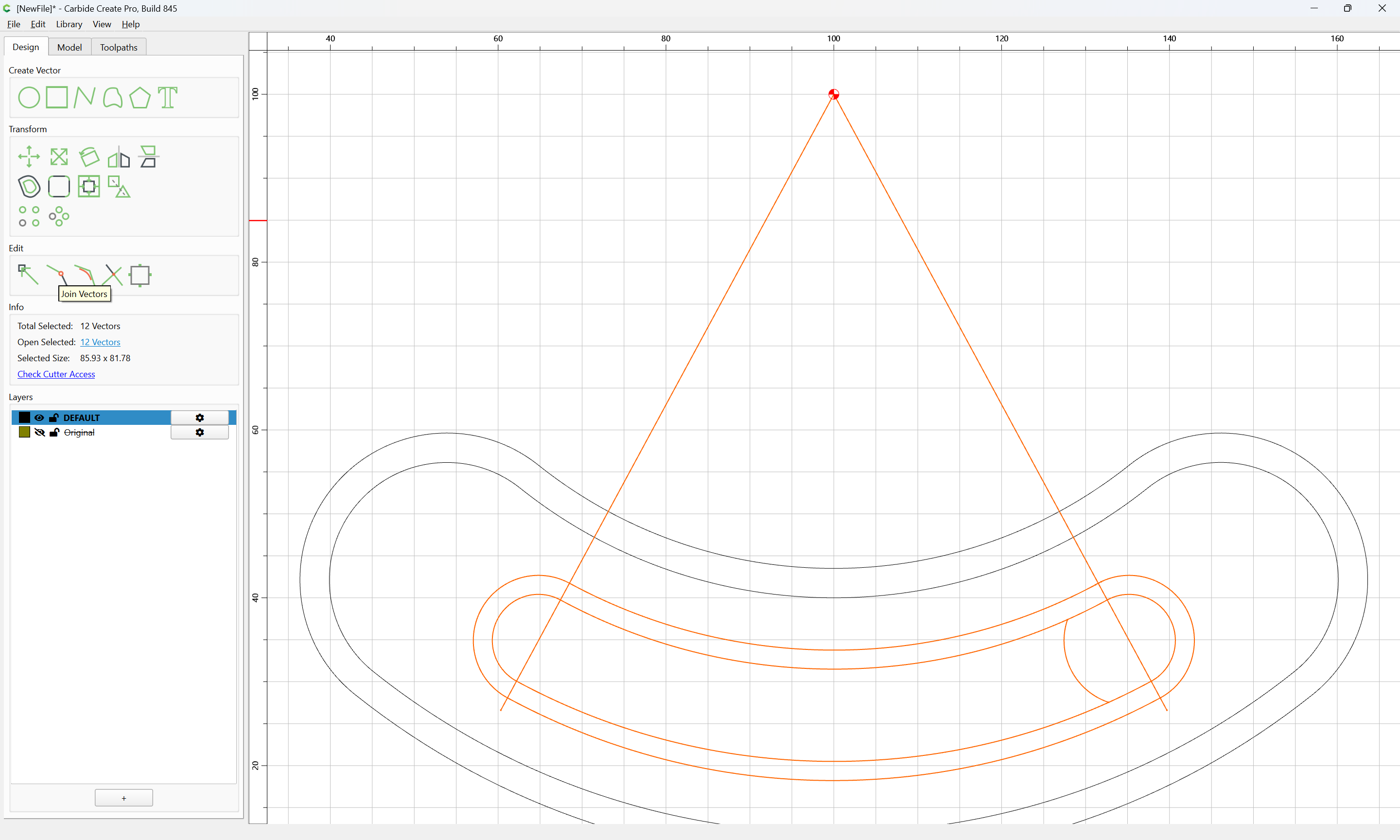

Repeat for the inner elements:

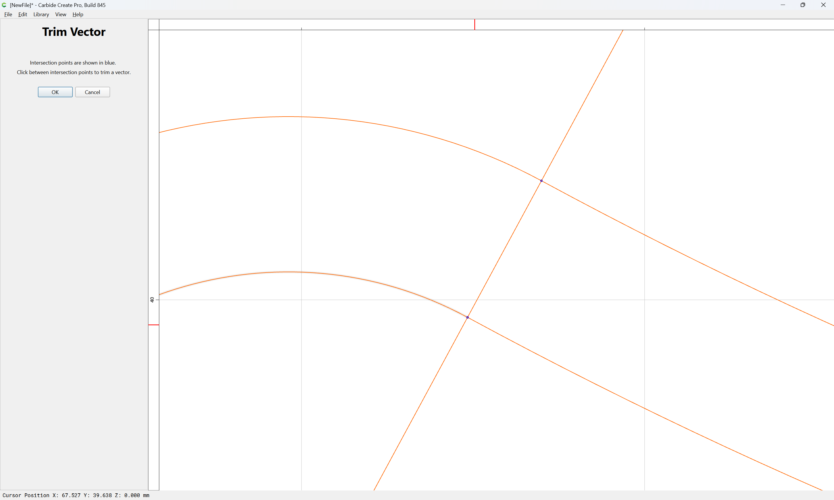

zooming in as needed:
(note that it is not necessary to remove all segments all at once)
OK

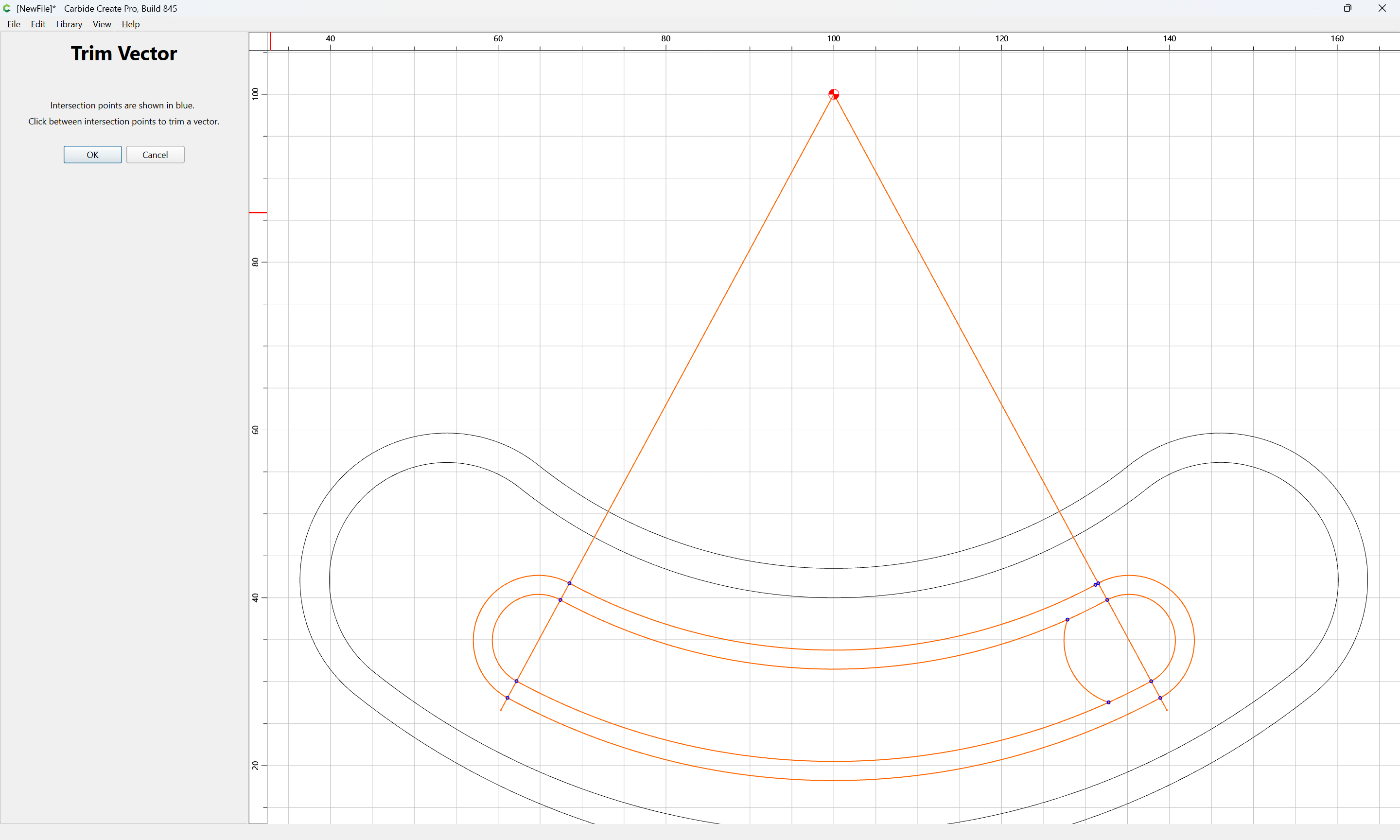

as before Join Vectors:
Yes
shift-click to remove what one wishes to keep:
and delete
thanks a ton William!
Appreciate you explained every step with the image.
Thnaks a lot.
It helps!
i followed & i got the results… :grinning:

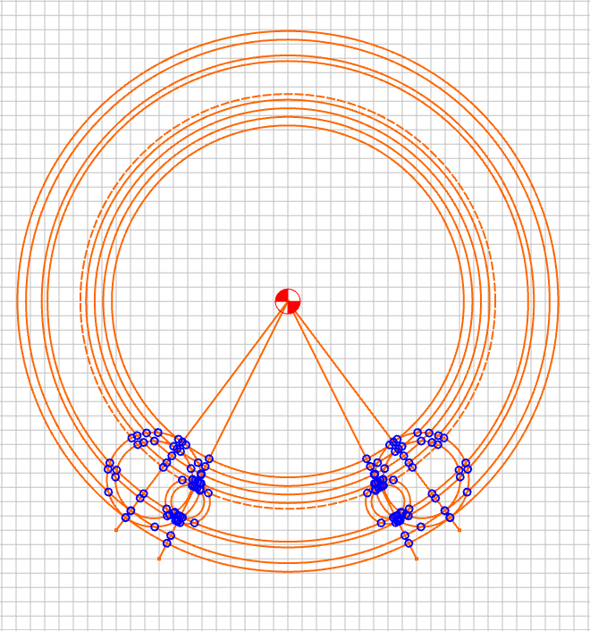

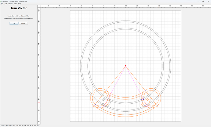

You have too many things selected.
For example, for the inner objects you want:

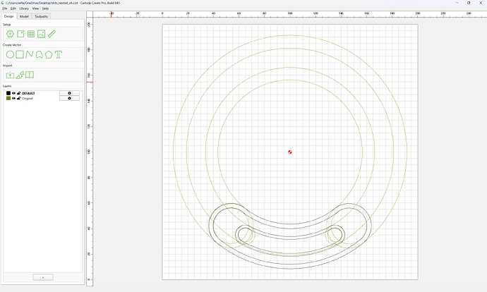

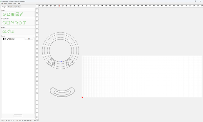

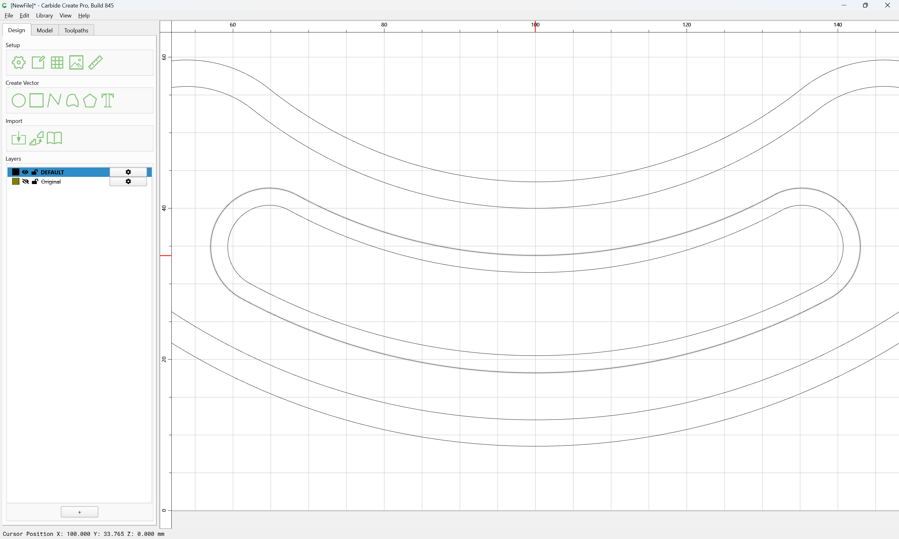

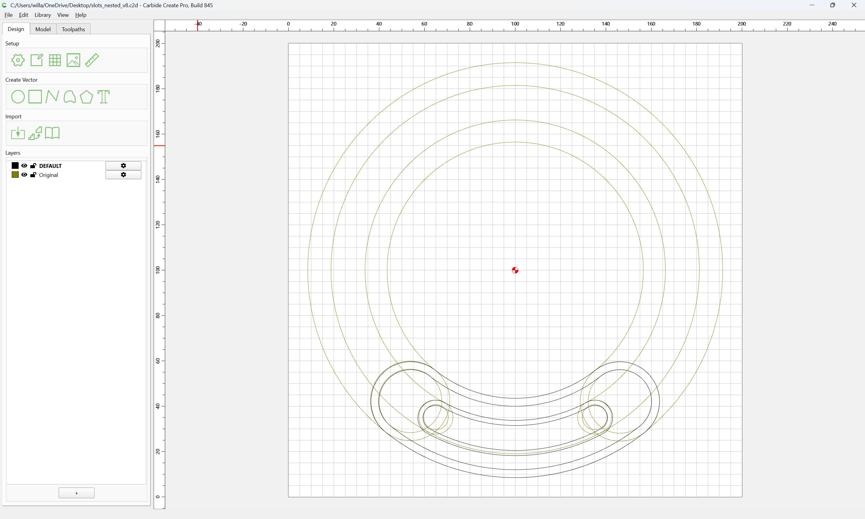

Here is the finished file:
slots_nested_v8.c2d (64 KB)
It was just to show how easy it is handle once the basic setup ready.
