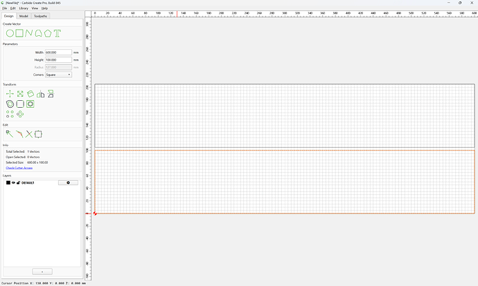

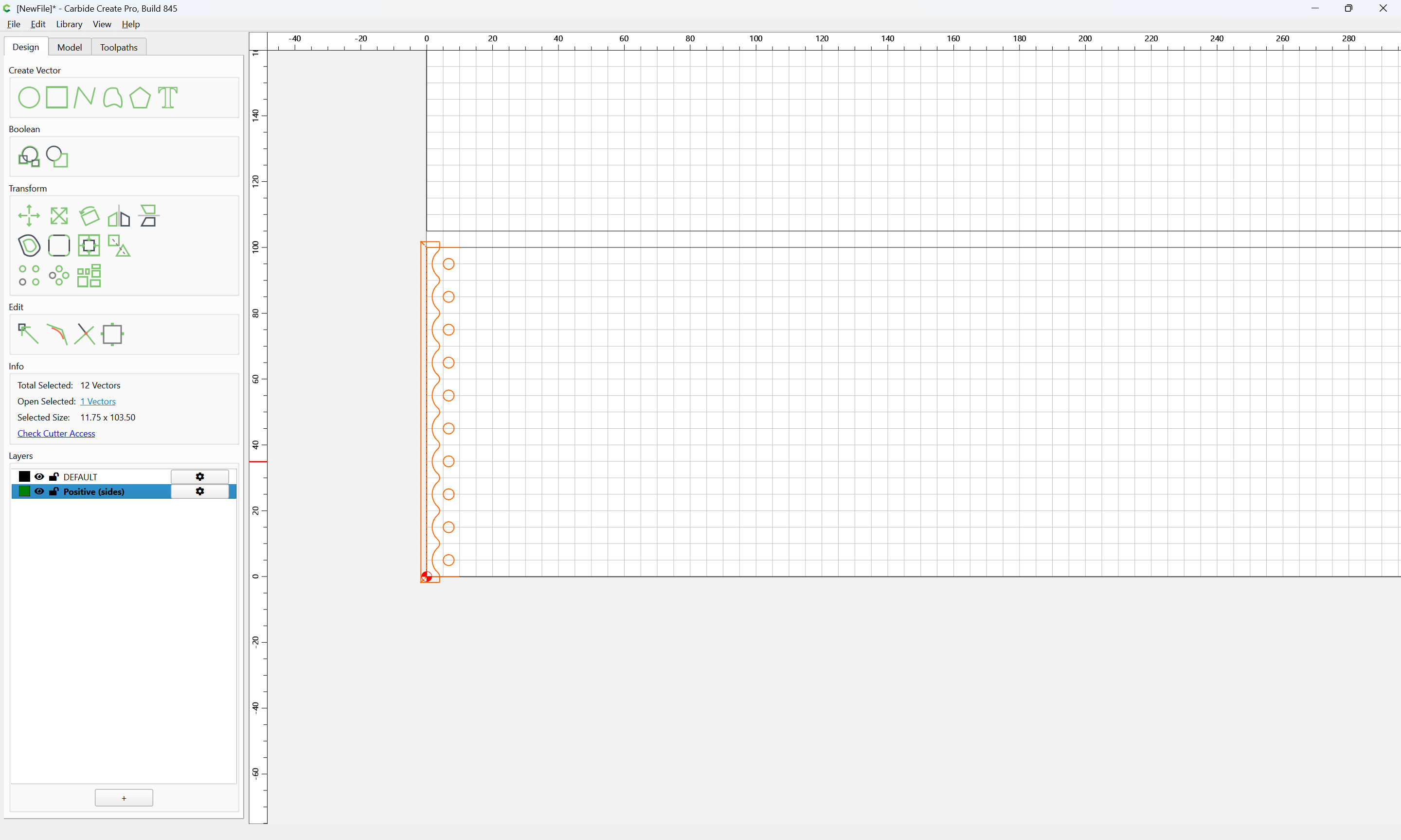

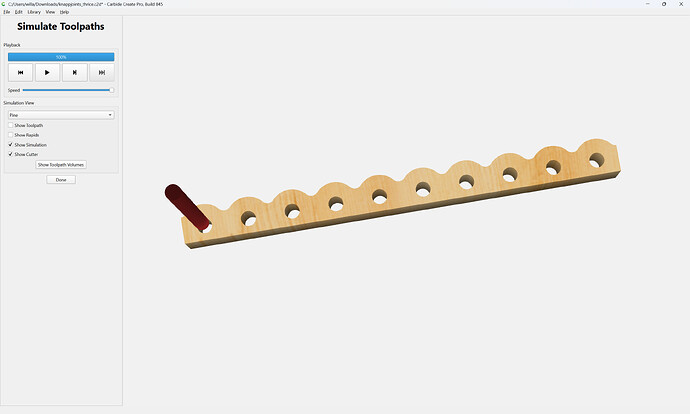

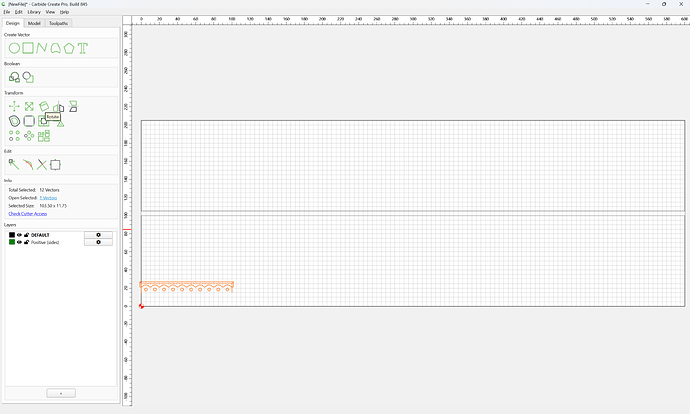

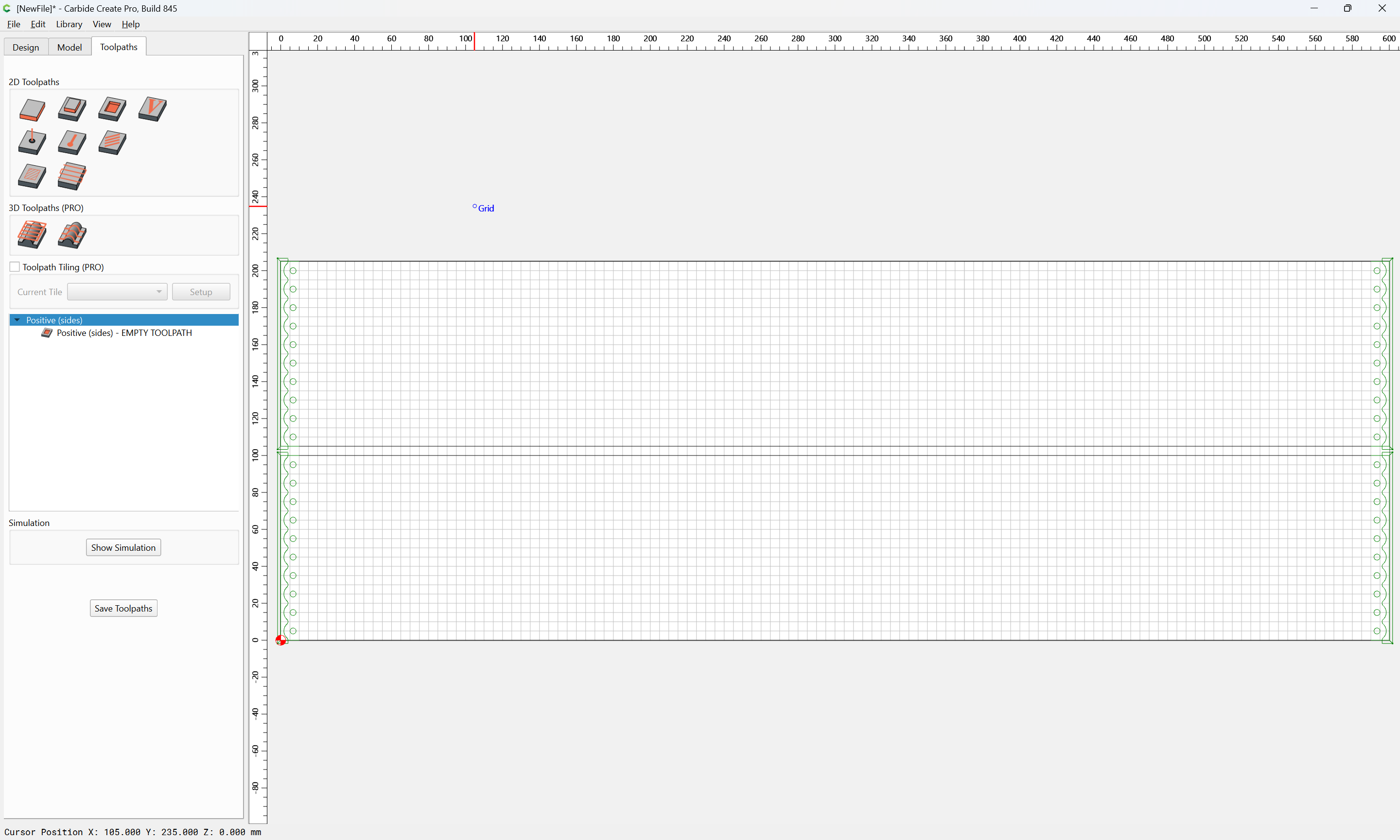

Knapp Joint with CNC

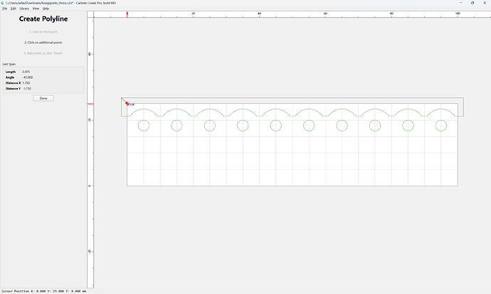

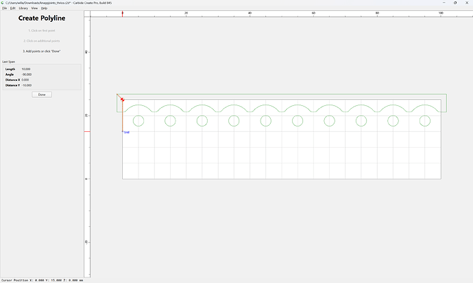

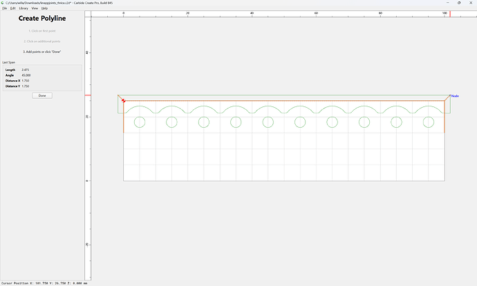

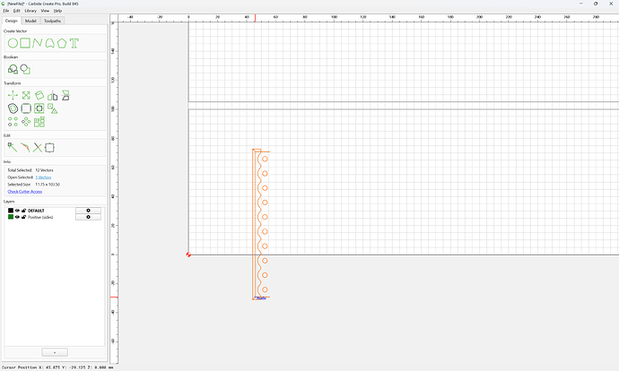

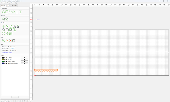

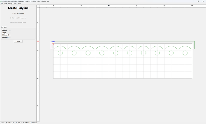

To make using the Positive geometry/toolpath easier, it will be helpful to have additional geometry which may be used for positioning it relative to the end of a board:
Done
which so long as it is open (unclosed) and the toolpath(s) associated with the layer are not Contour toolpaths, will not affect how things cut:

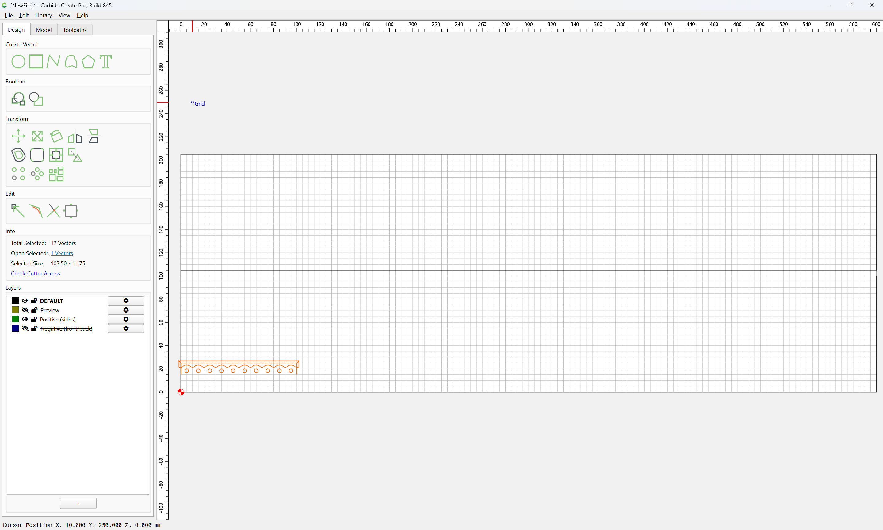

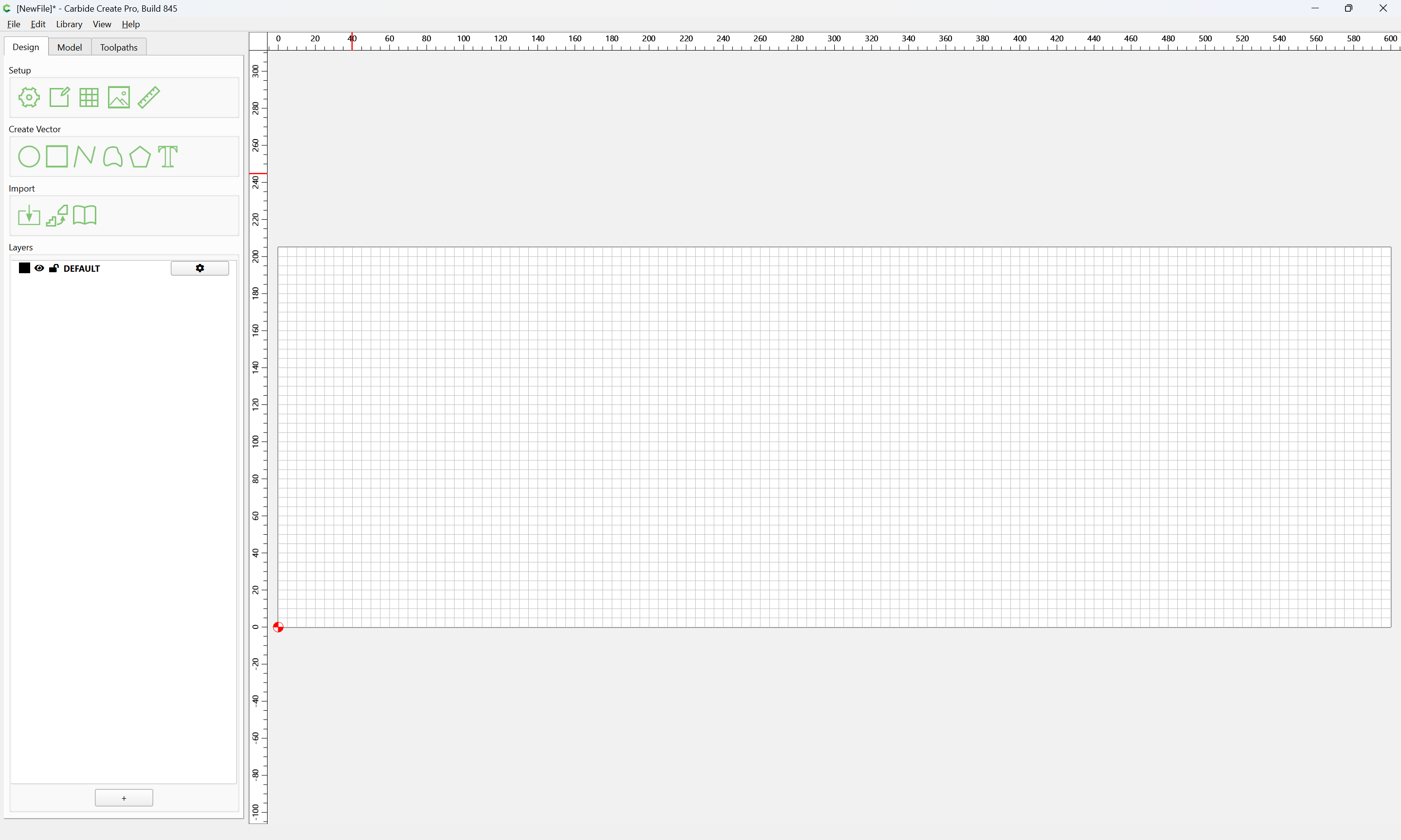

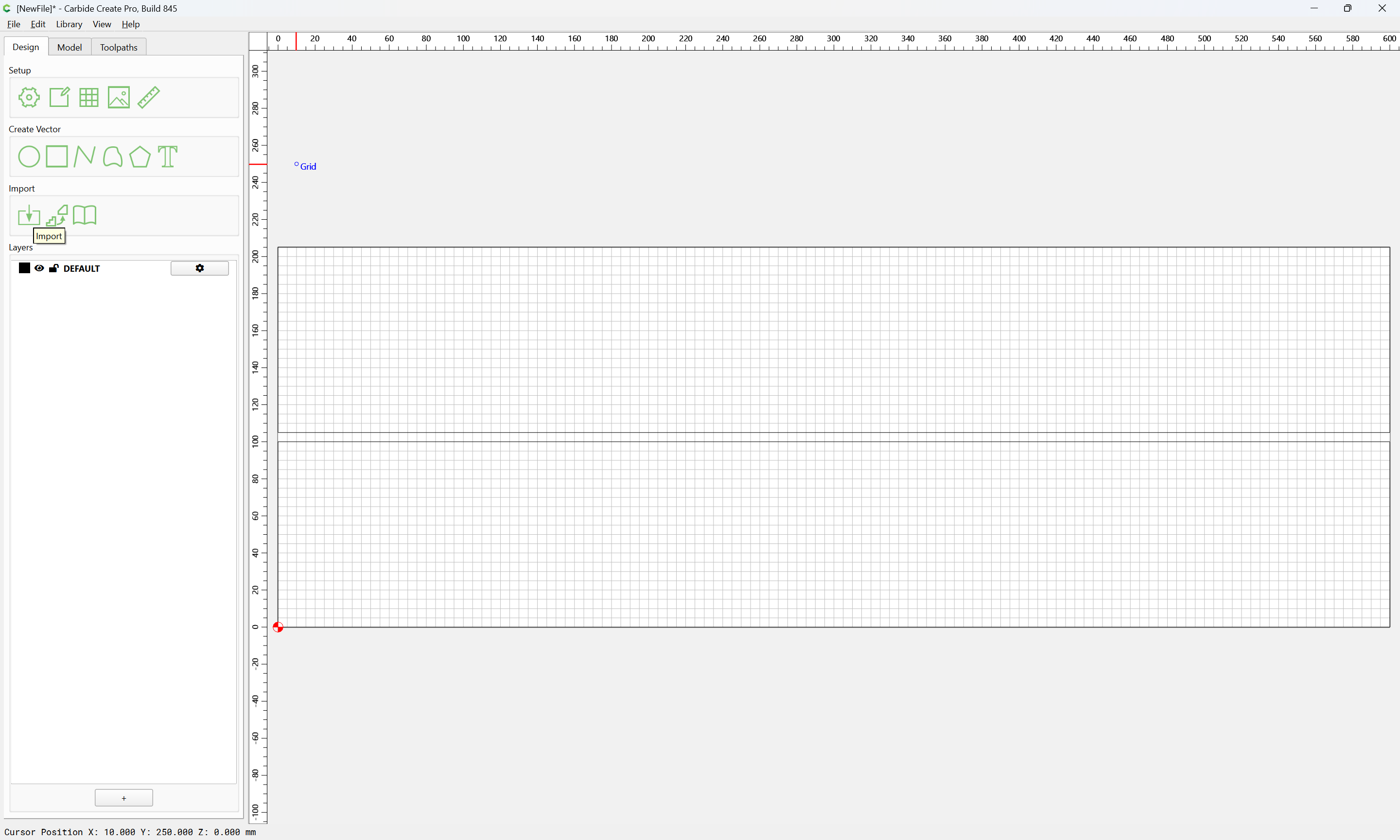

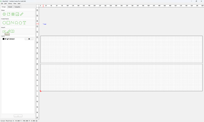

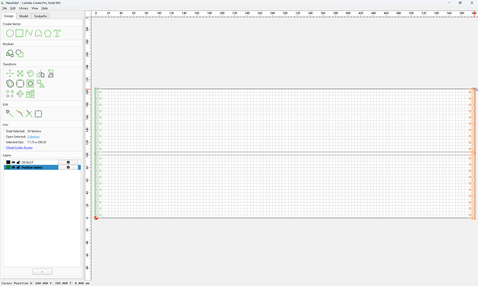

The file may then be imported into a file which has parts defined for cutting the parts for a box/drawer:
Import
(do not join the vectors)

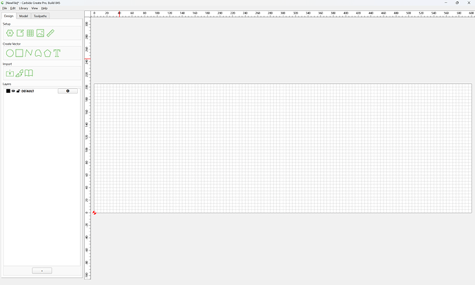

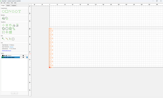

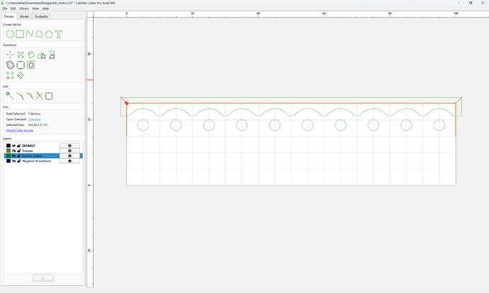

Clean up by deleting the layers which are not needed:

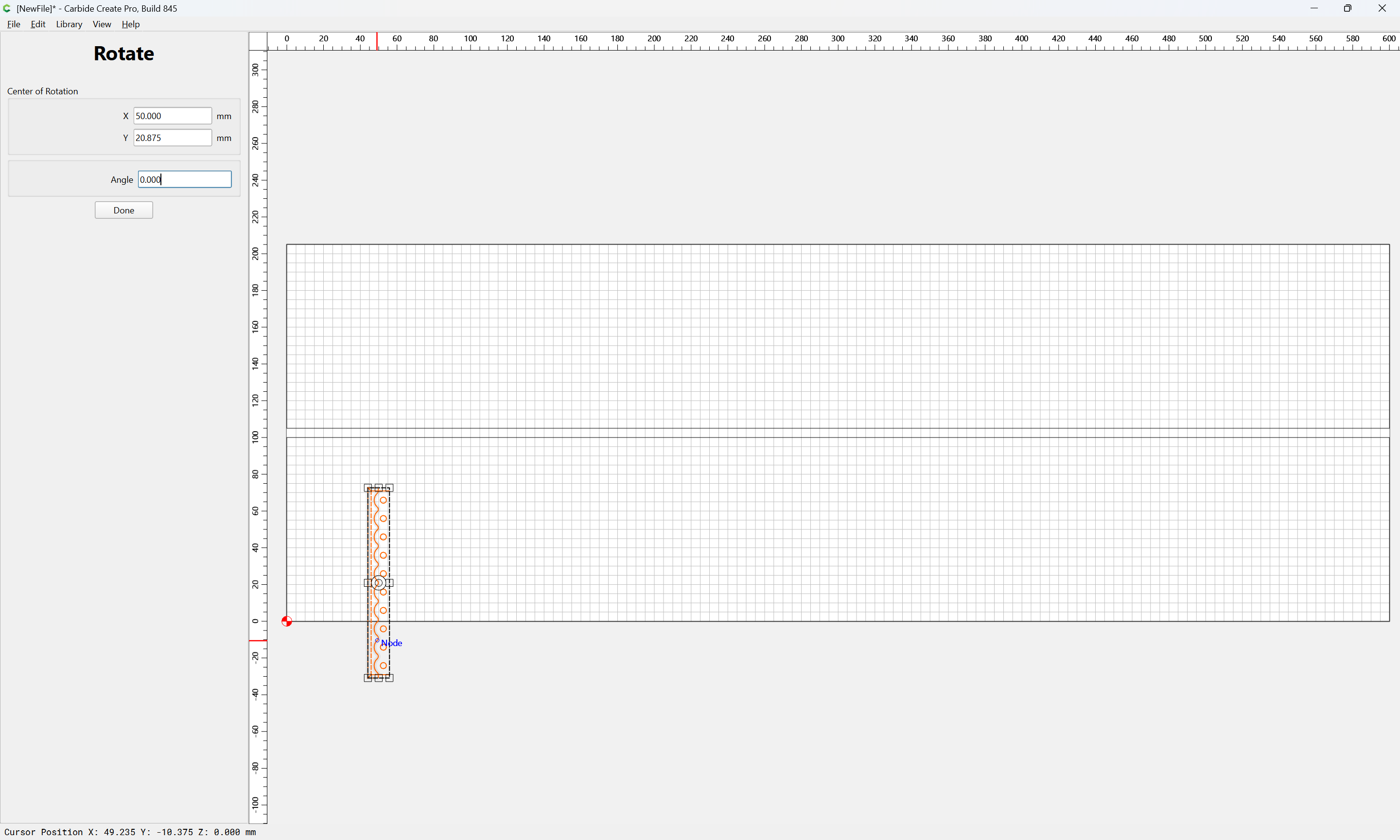

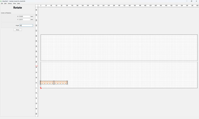

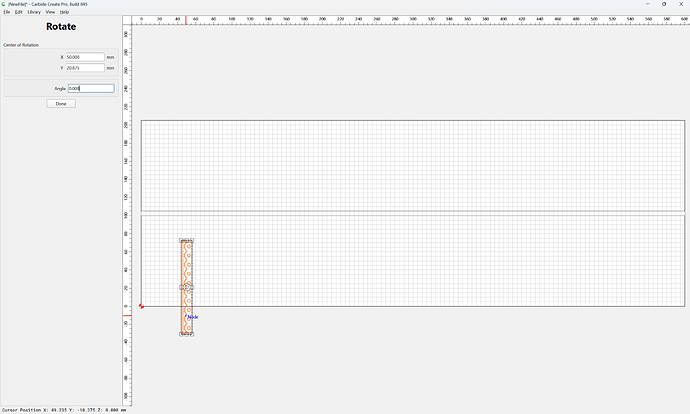

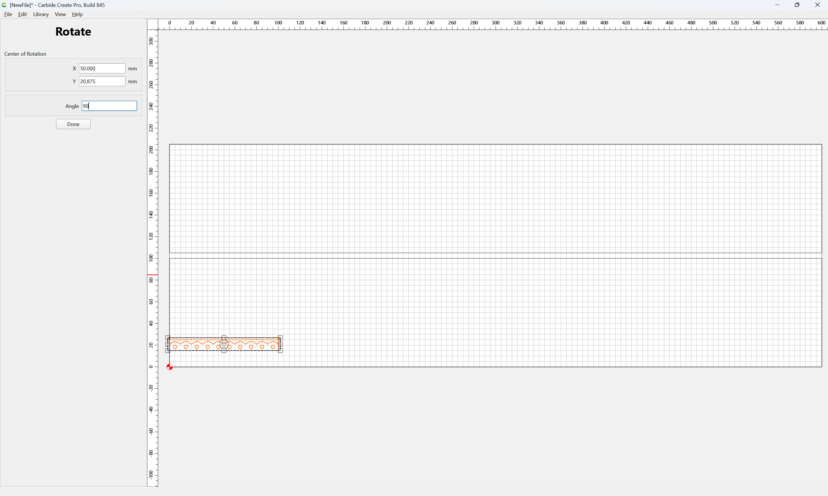

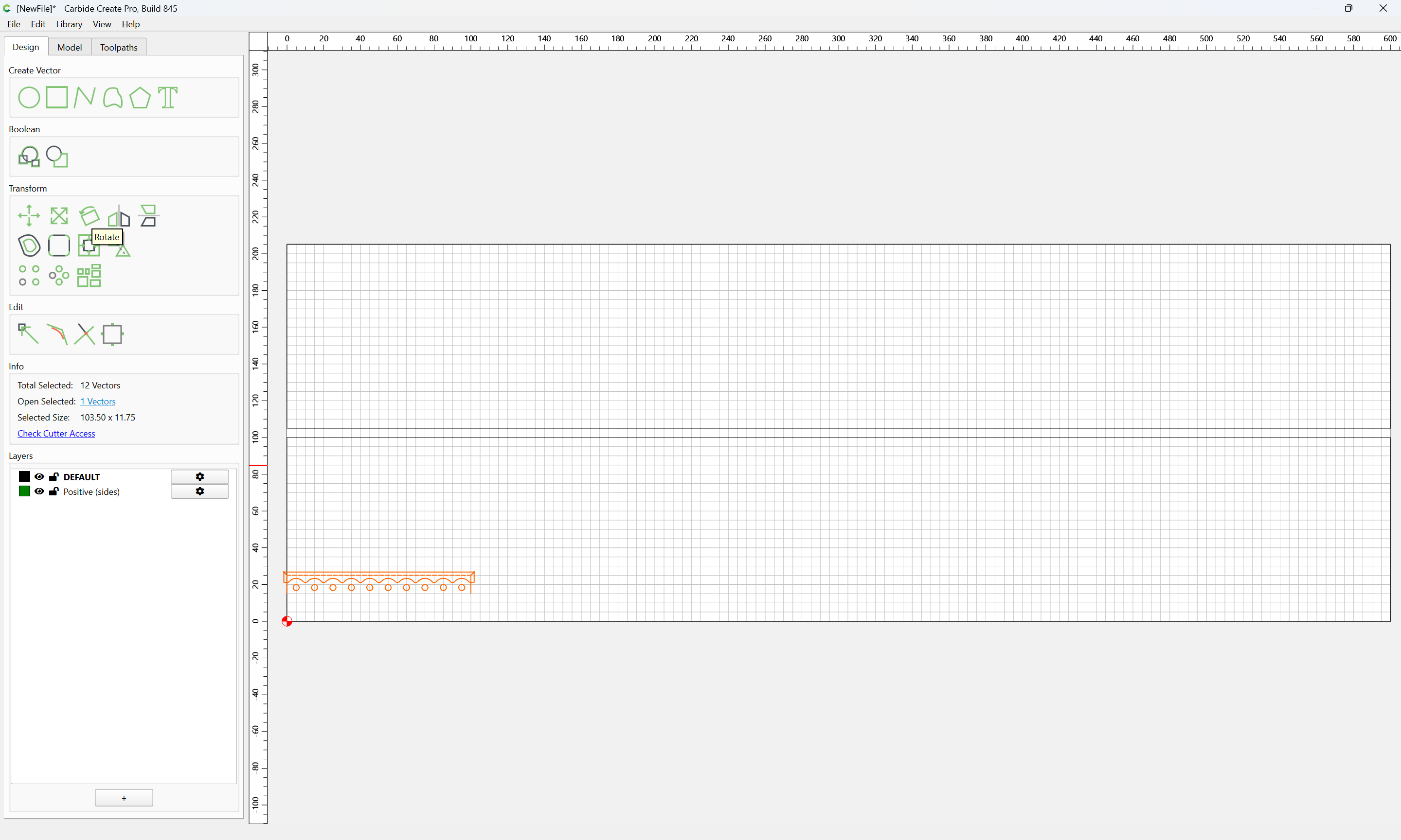

and rotate the geometry:
Done

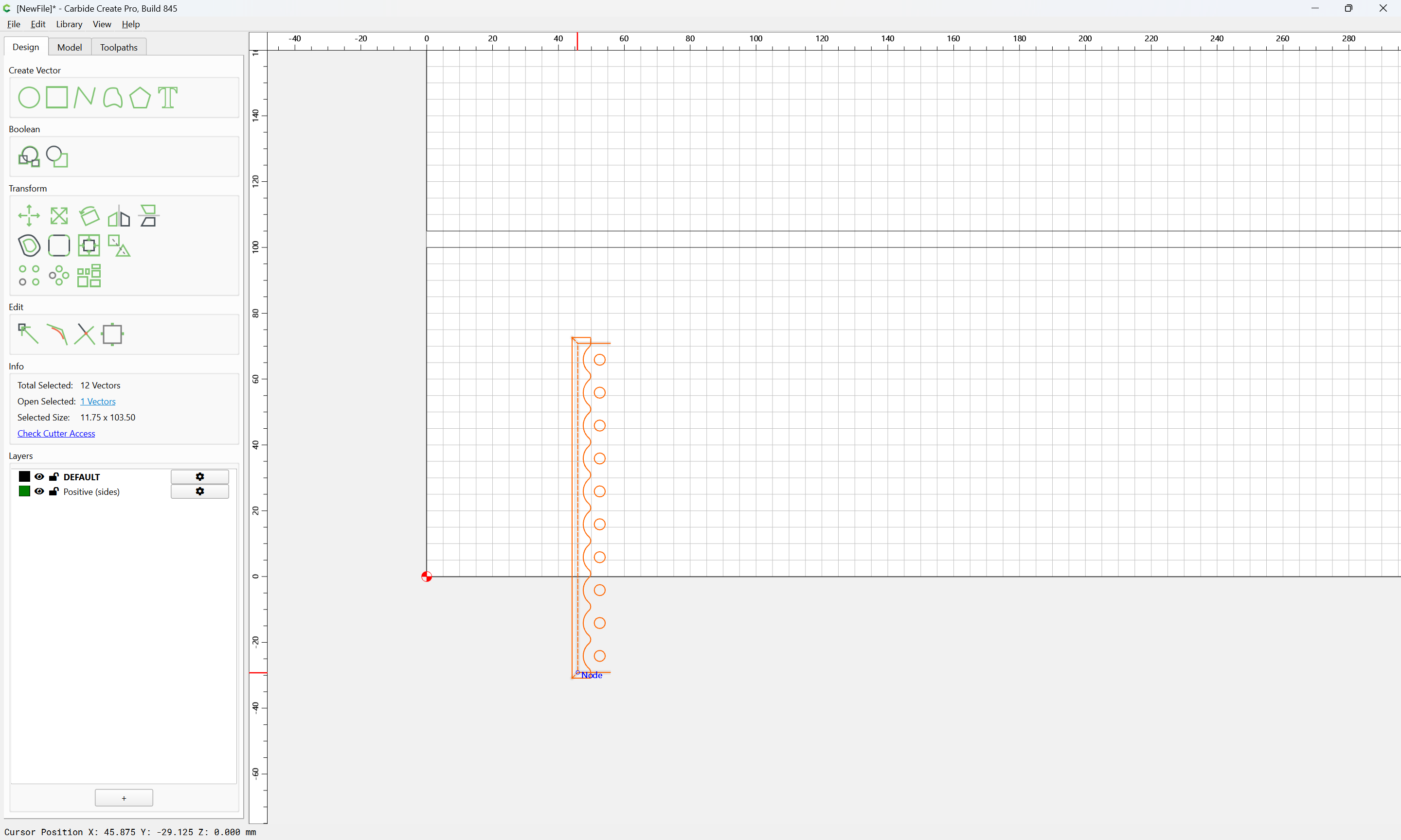

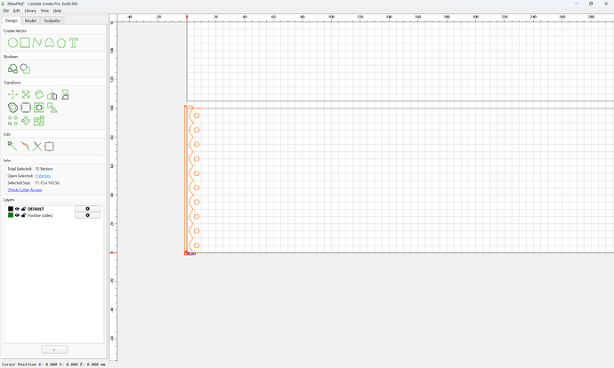

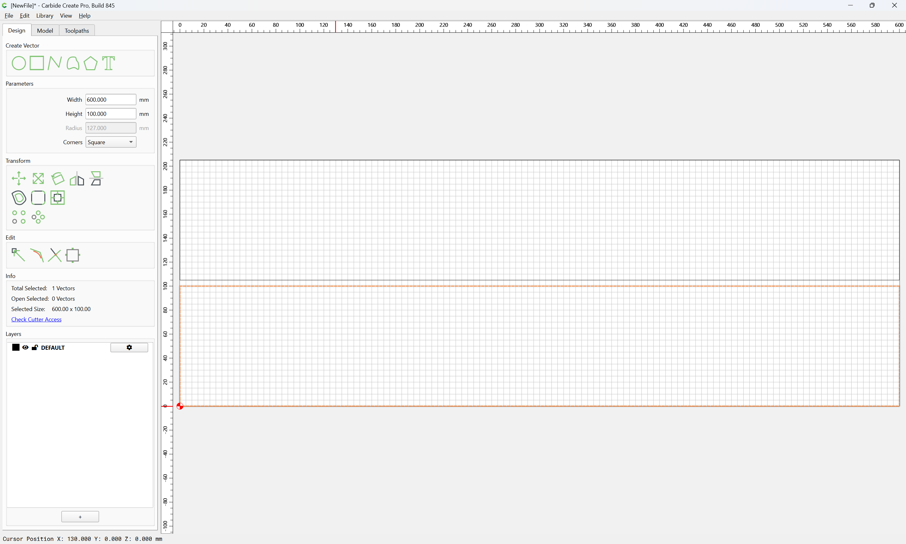

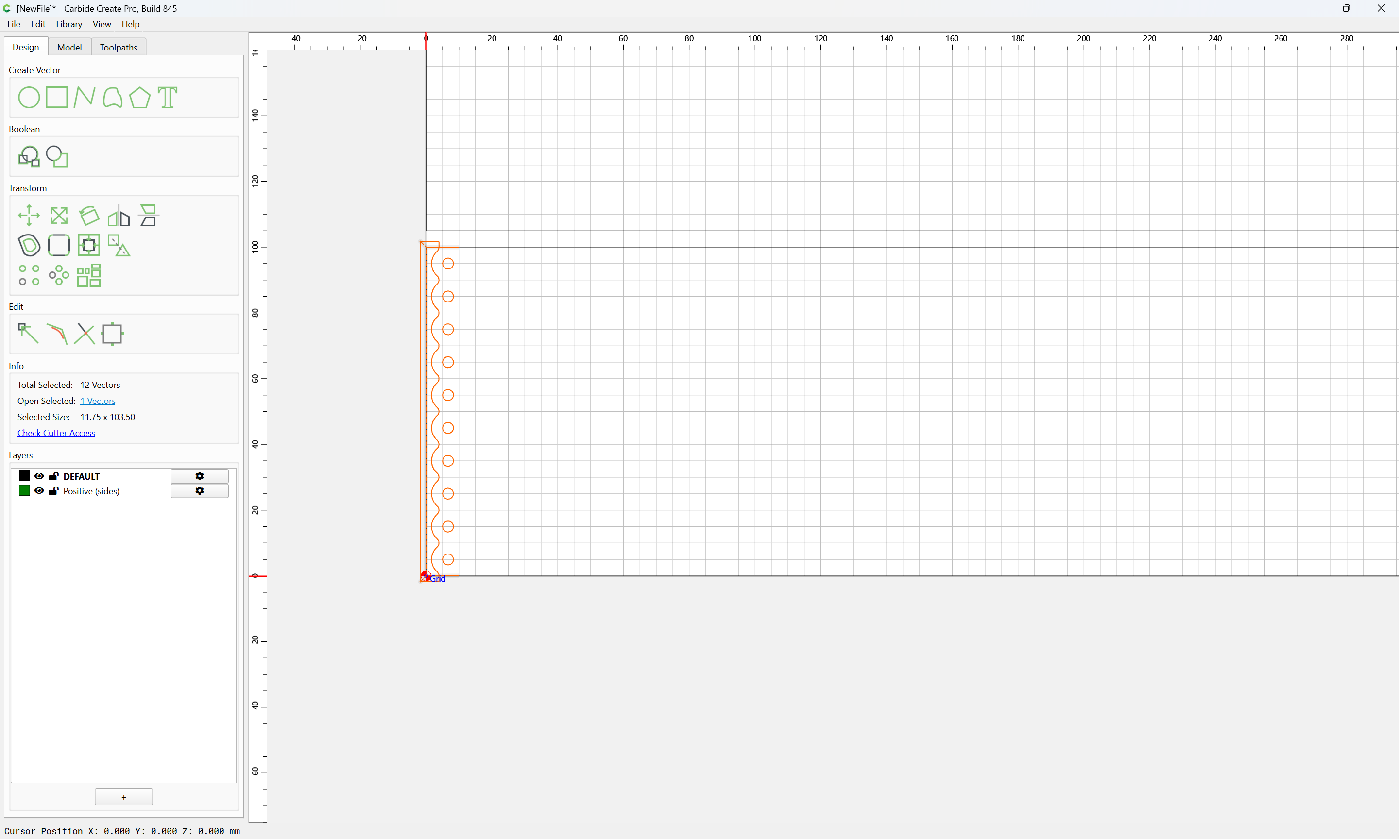

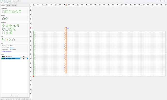

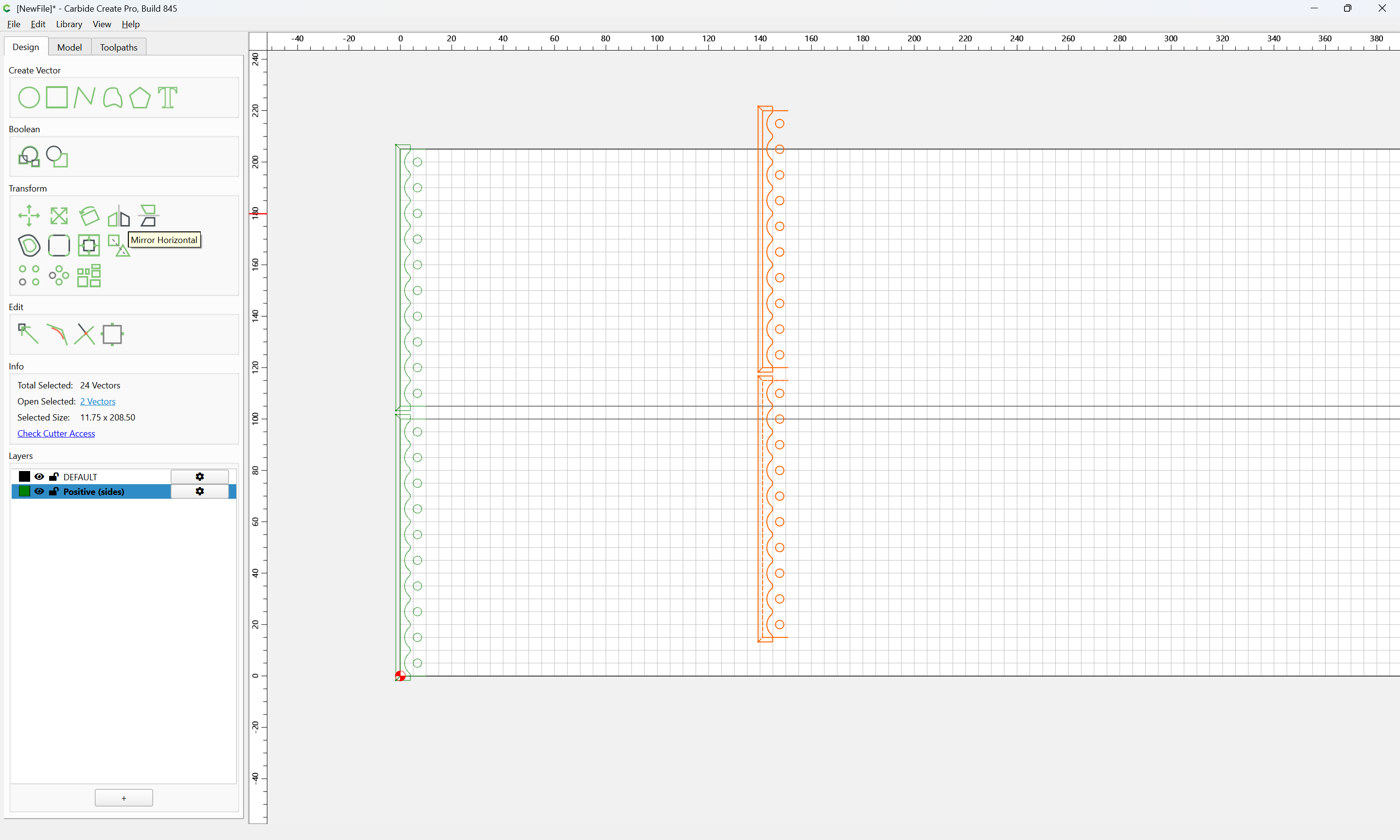

and drag it into position:
double-clicking on the layer to make it active:

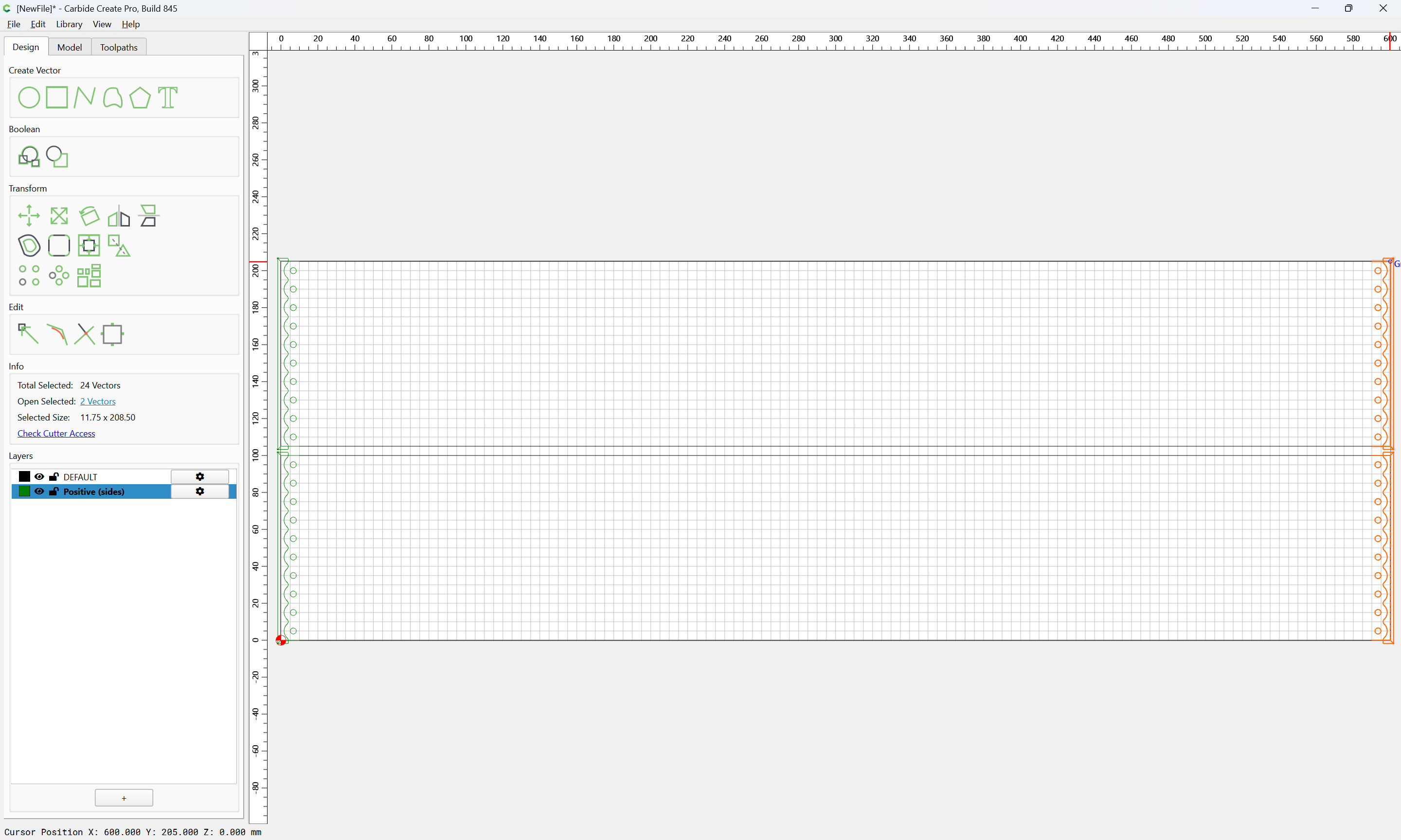

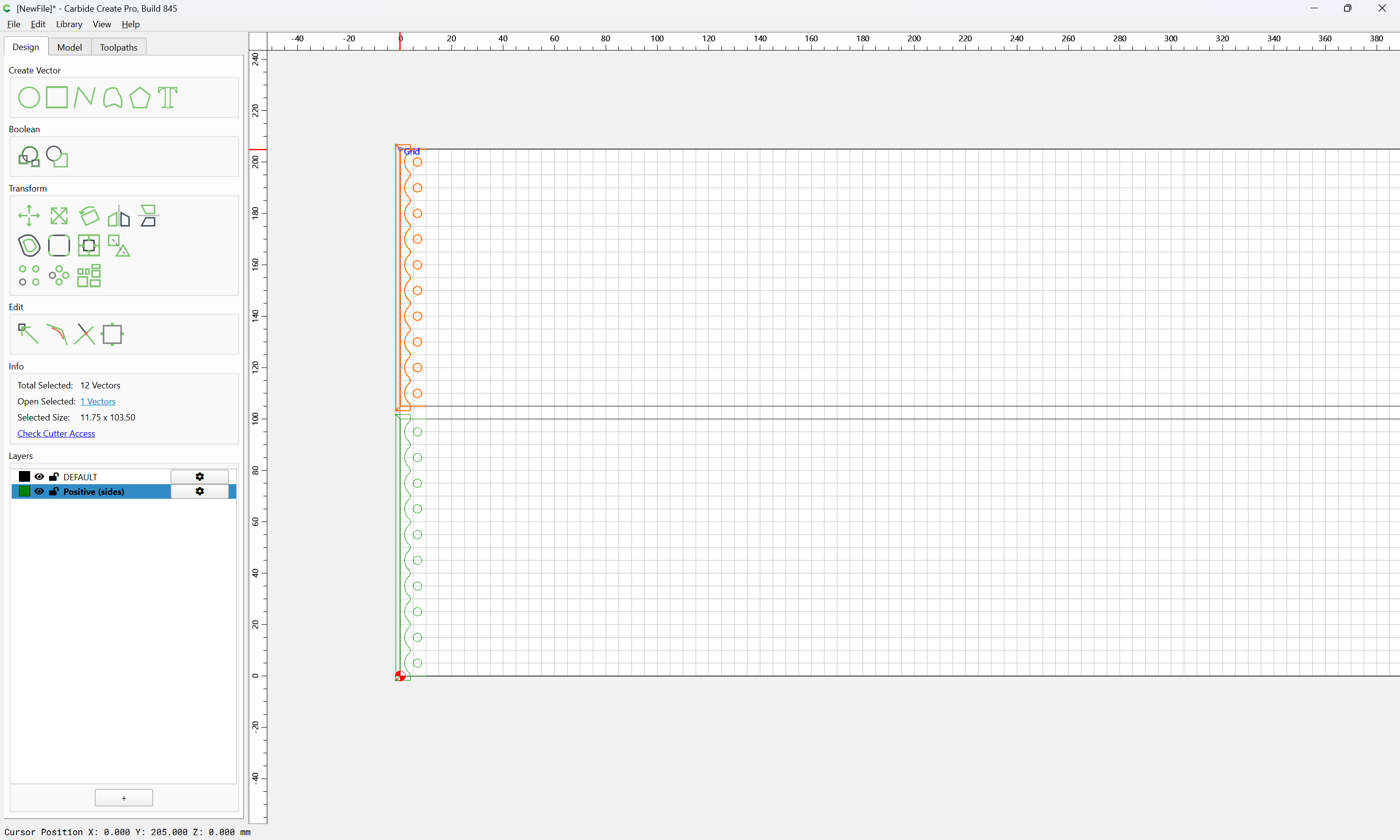

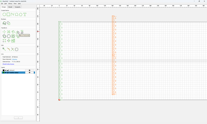

then duplicate and reposition:
and duplicate and mirror and reposition:

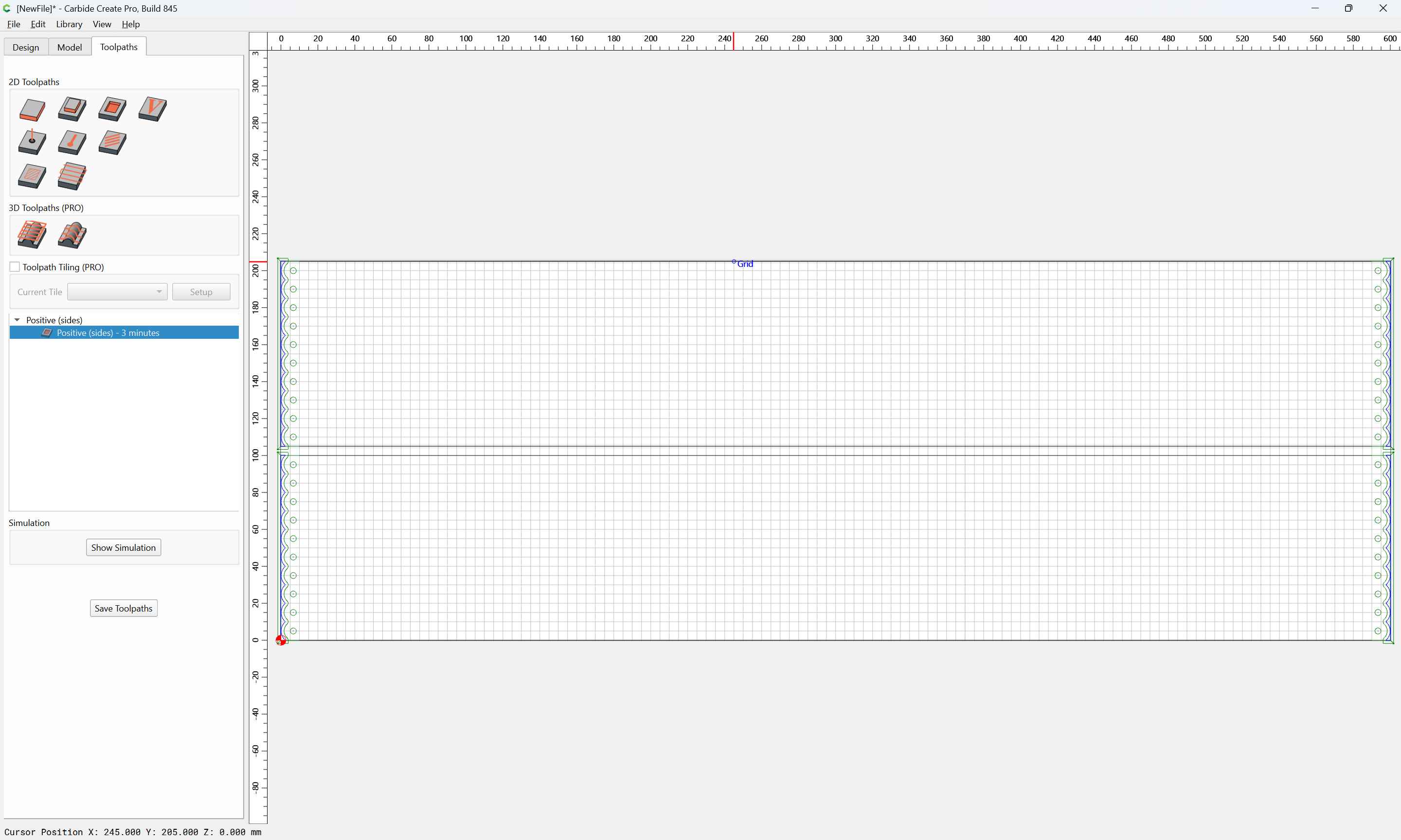

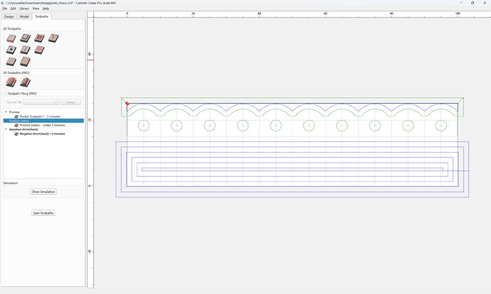

Clean up by deleting the unneeded toolpaths:
and edit the toolpath to fix the toolpath association to the layer:

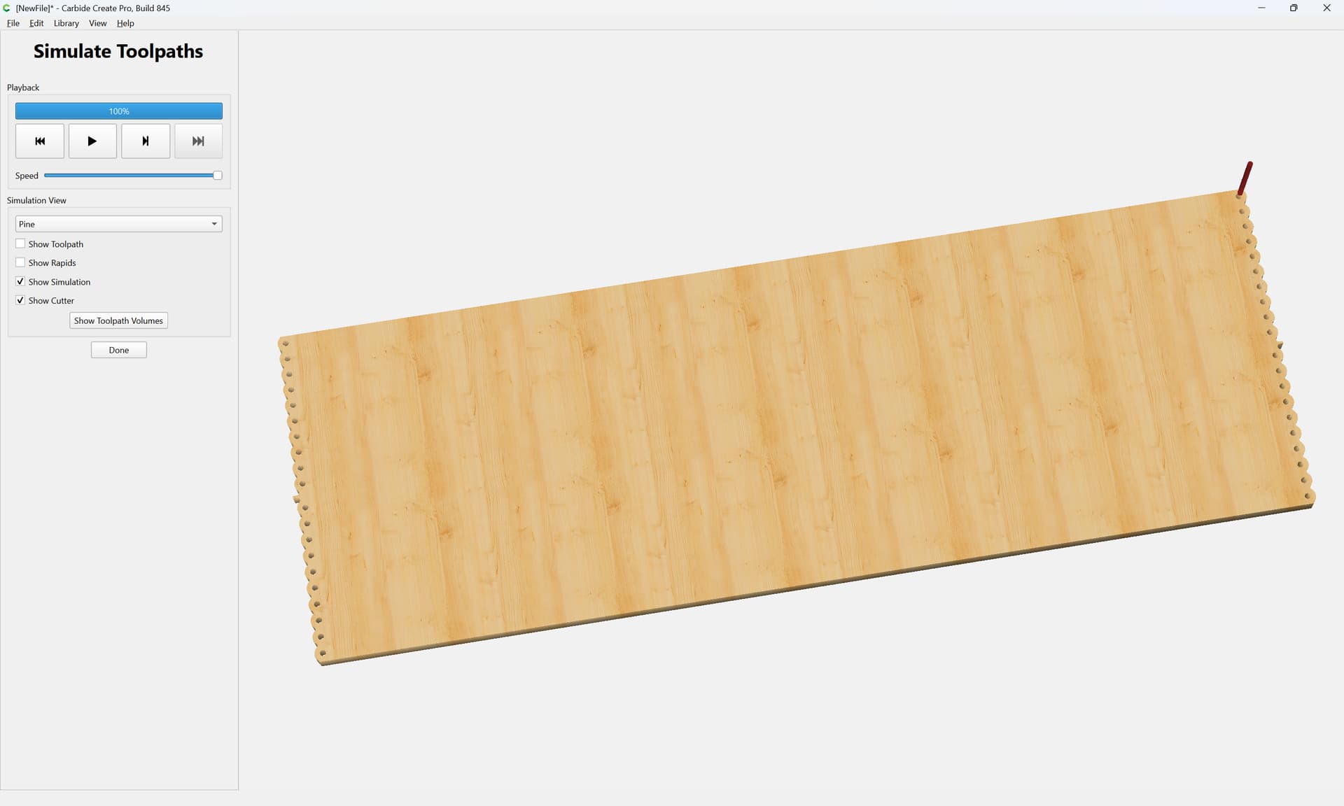

Geometry and toolpaths to cut out the parts along their edges are left as an exercise for the reader.
