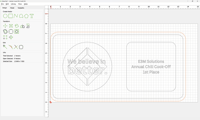

I am trying to carve a logo but the layers of the logo are messing me up. I am losing some of the letters that are over top of a symbol in the background. Is there anything I can do to not lose them?

In the meantime, it looks like you are cutting pockets instead of raised layers, so try making the 2nd path (Pocket Toolpath 2) only 0.010 deep. (Start Depth: 0.125, Max Depth: 0.135)

Check the job setup:
Select the surrounding geometry for the part:
Offset by endmill diameter plus 10%:

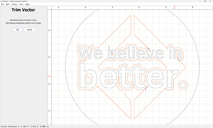

Select the geometry which intersects with the next layer:
and offset to the outside:

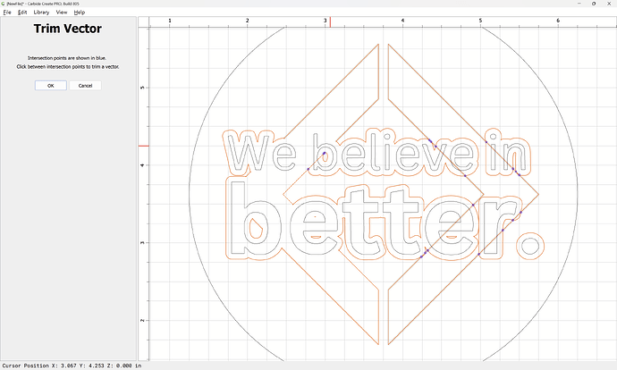

Add the intersecting geometry to the selection:
and use Trim Vectors to remove what is not wanted (all the interior elements):
Where necessary, zoom in:
until one arrives at:
OK
OK

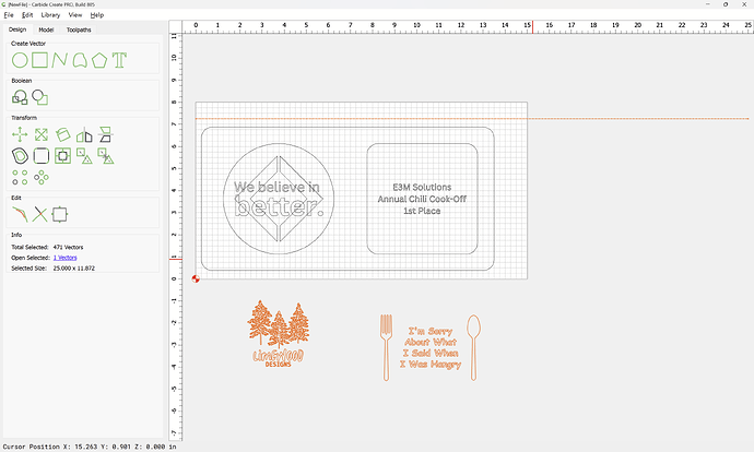

Select the interior elements which are not needed:
and delete
Select the elements for the next layer:
and assign a V carving toolpath which starts at the bottom of the preceding toolpath:
which previews as:
Attached as a v8 file.
3M Chili Cookoff-v8.c2d (384 KB)
